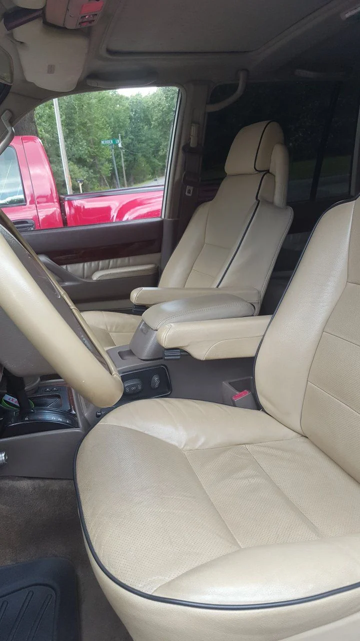

I just finished up my land Rover seat swap.
Those tan ones look great. I have yet to finish up the wiring for the controls on mine. How bad was it fitting the control wiring in the center console?
Was really easy. Being the lx450 it had a sub rather than the cup holder. Tons of space with that sub gone. Only things I used from stock seats was seat belt and power plug.

Yes Its an airbag. I removed and trashed it. Extended my stock belt bracket about 2 inch to bolt in that location. The brackets removed from Disco seat is just as low as cruiser. Rails are like 18 wide and cruiser is 14.5 I think. You need brackets to extend inward to bolt to factory holes. The front bolt bracket needs to have a bit cut out of it for Rover seat to be centered. I made all my brackets close to same size as cruiser for passanger side. Lower on drivers because that seat lifts a lot. It's kind of a pain holding seats to do all this but a friend and some beer helps.
I noticed how much wider the Disco was. Little over 16 inches. I am going to try to weld a plate across the two sliders and then weld the brackets to that. I really like yours though. I am taking that into consideration. Considering you made it work and it looks great. Do you mind explaining the wiring harness connection to the existing cruiser? I have all the harnesses for the Disco. I just need to know the sequence for the 4 wire lineup on the Disco vs. the 5 wire lineup on the Cruiser.
