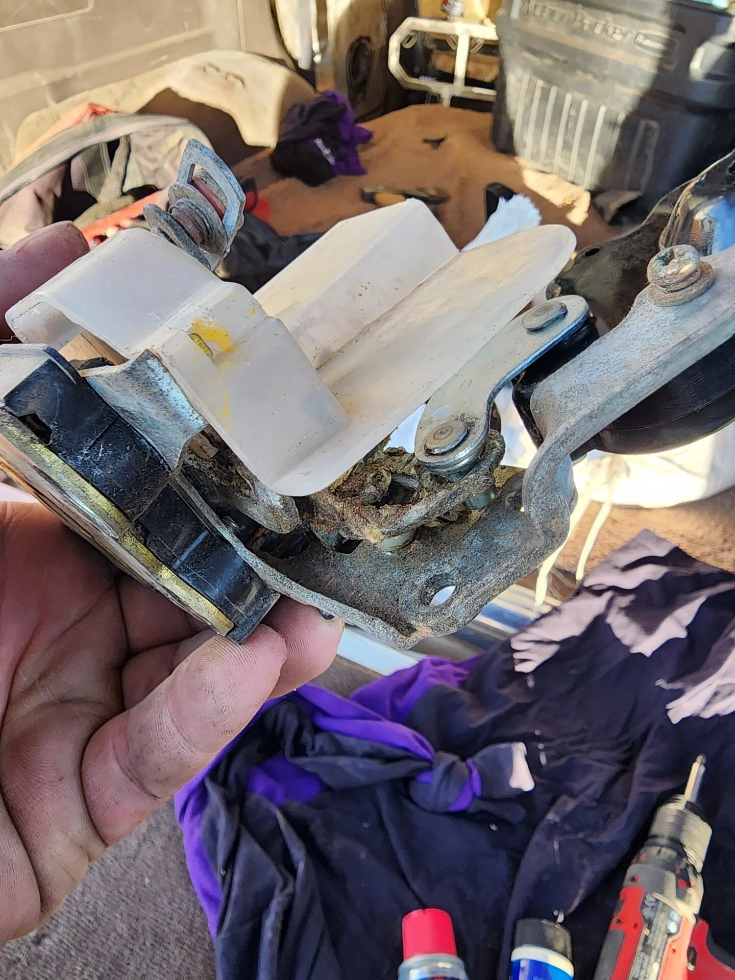

I decided to swap a lock actuator to try and fix a broken lock.
After getting the assembly out I am not sure the actuator is entirely at fault. The lock mechanism is stupid crusty and sticky. I was thinking of spraying it out with some brake clean or carb cleaner followed by a spray of lube.
Who has cleaned and lubed their lock assemblies? What's your process?

Yep, new actuator is installed and locks work now. I just want to clean and lube the assembly before I button up the door.

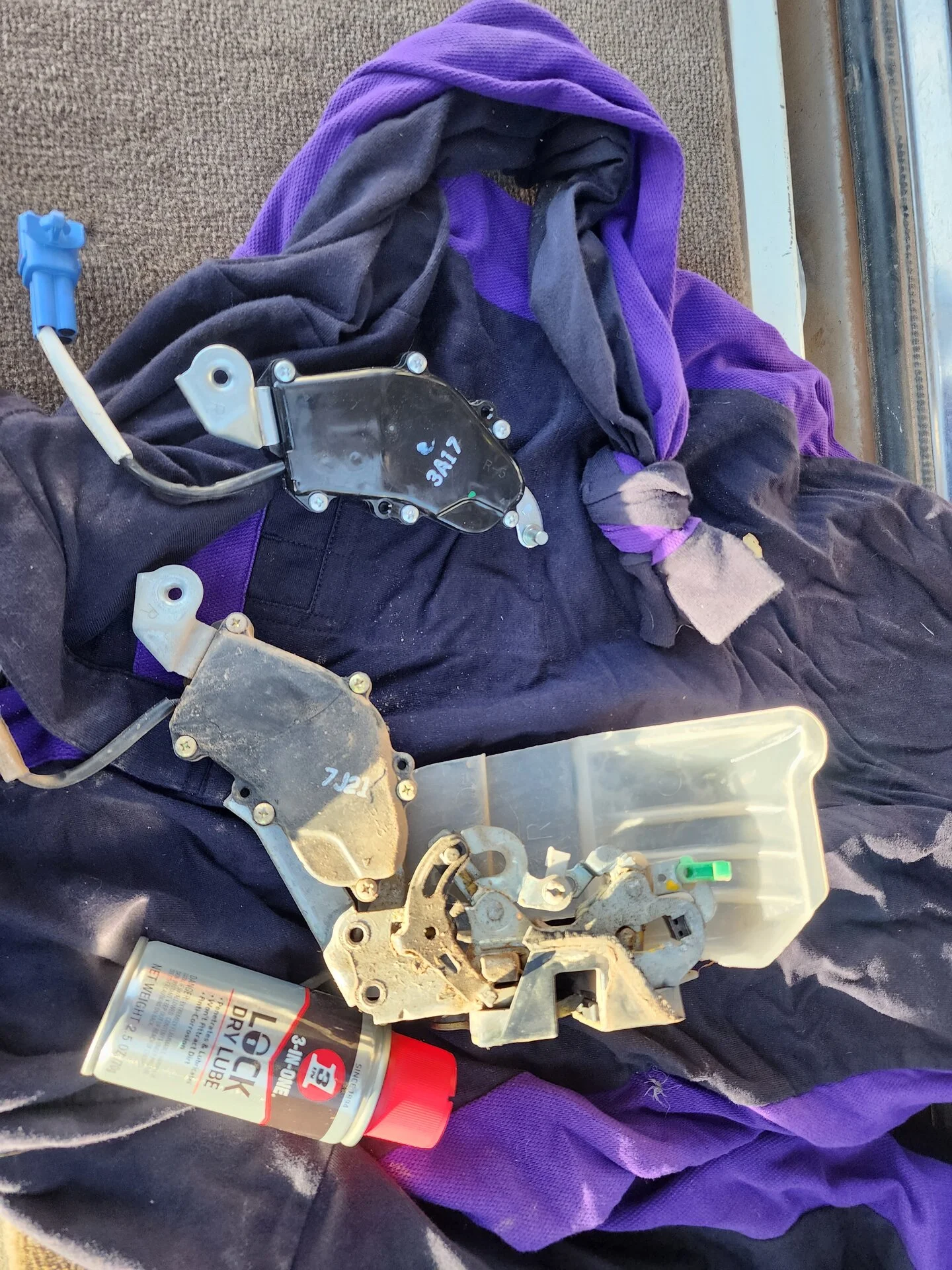

Well after removing the one lock assembly I got it cleaned up pretty good with some picks and brushes and I lubed it up with some lock lube I had on hand.
I re installed the lock assembly with the new actuator and It worked good enough.
After holding the assembly in hand I wouldn't worry about plastic safe cleaner if your actually removing the assembly from the door.
It seems the proper maintenance would include removing the lock assemblies and cleaning them with a de greaser of your choice and relubing the assembly with a grease of some sort.
