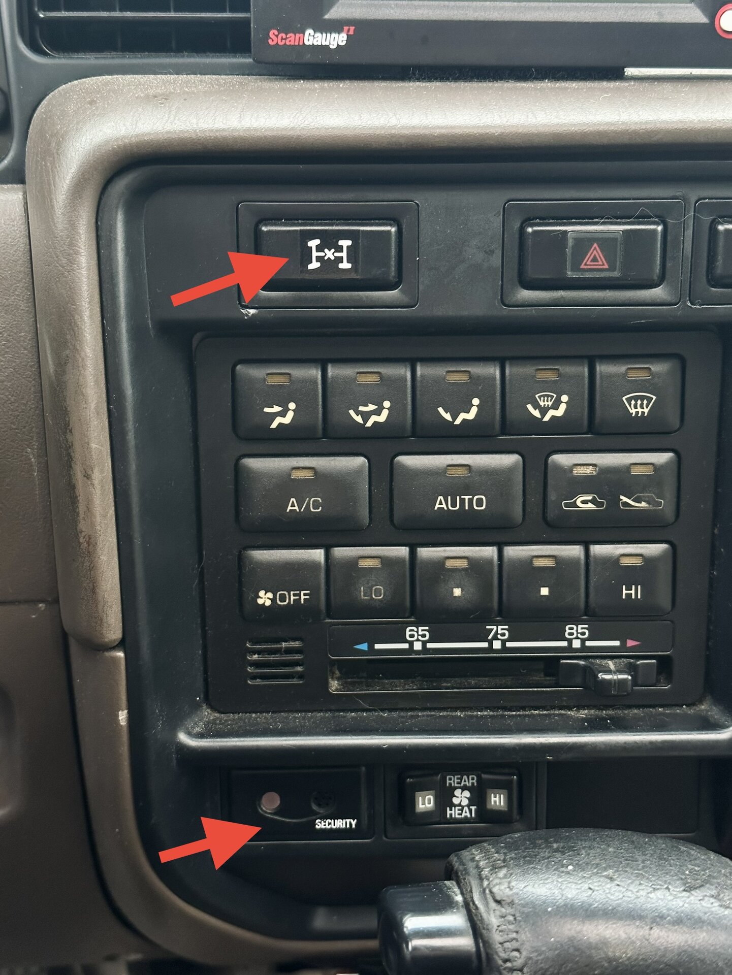

Super easy to add the switch. Only a little bit to take off the dash/climate control assembly. Once you get behind it, you'll find a loose white plug with a cap over it, and some foam. You will typically want to relocate the alarm light to the bottom where there is currently a blank (if you have an alarm), and run the CDL switch up top. It is plug & play. Your exact dash configuration may vary.
You can use an actual CDL switch, but it's the same as a hazard switch, which can be had for cheaper. I bought a hazard switch for $20 and made my own CDL icon for it.

Old thread but it's what came up in the search. I bought a CDL button from a 01 4x4 4runner and a spare hazard switch from a 96 LC. I swapped the labels like in the photo. Works great.
I love these cross–pollination finds!
Oh, and fix your louver. ;)
