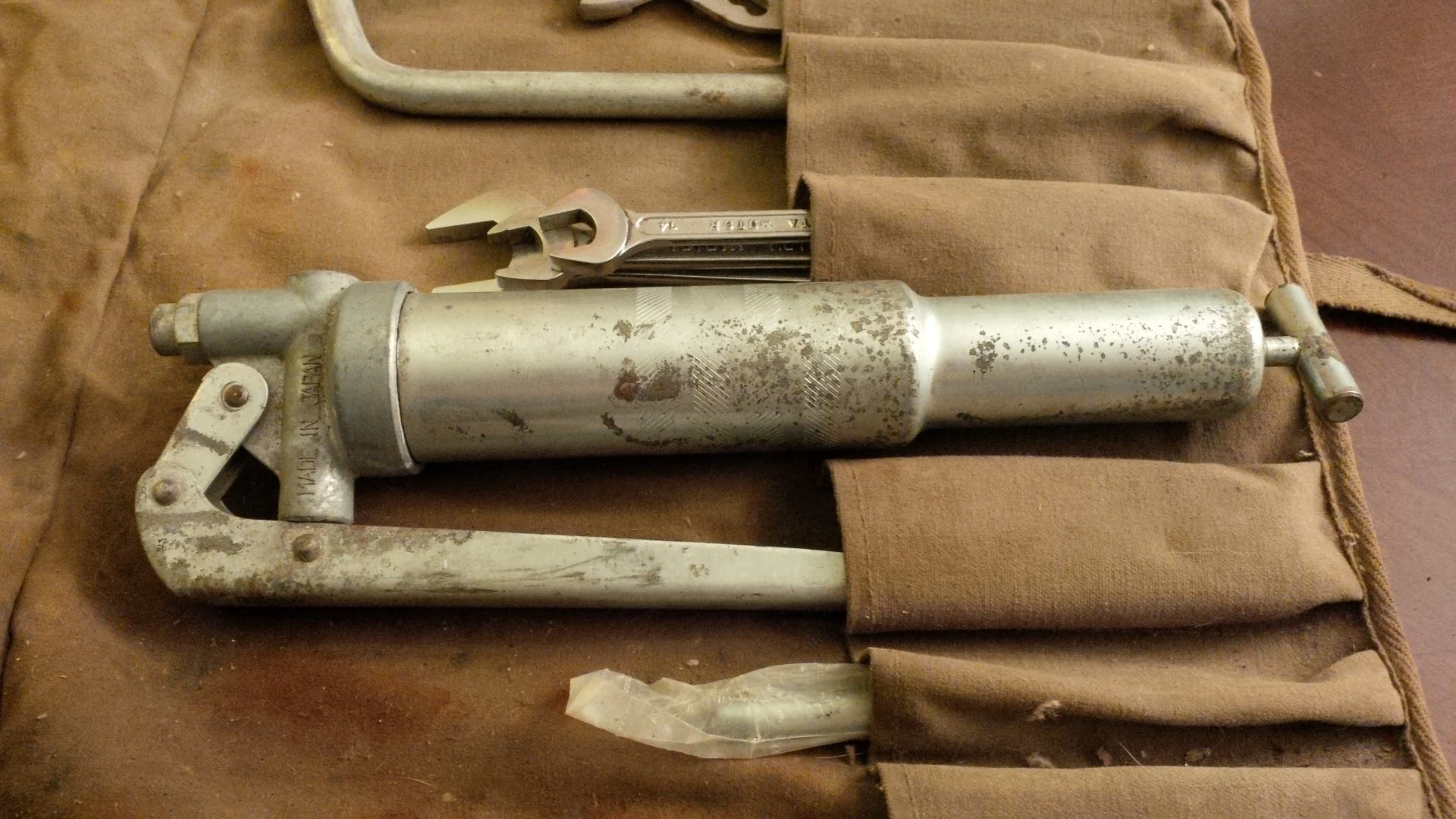

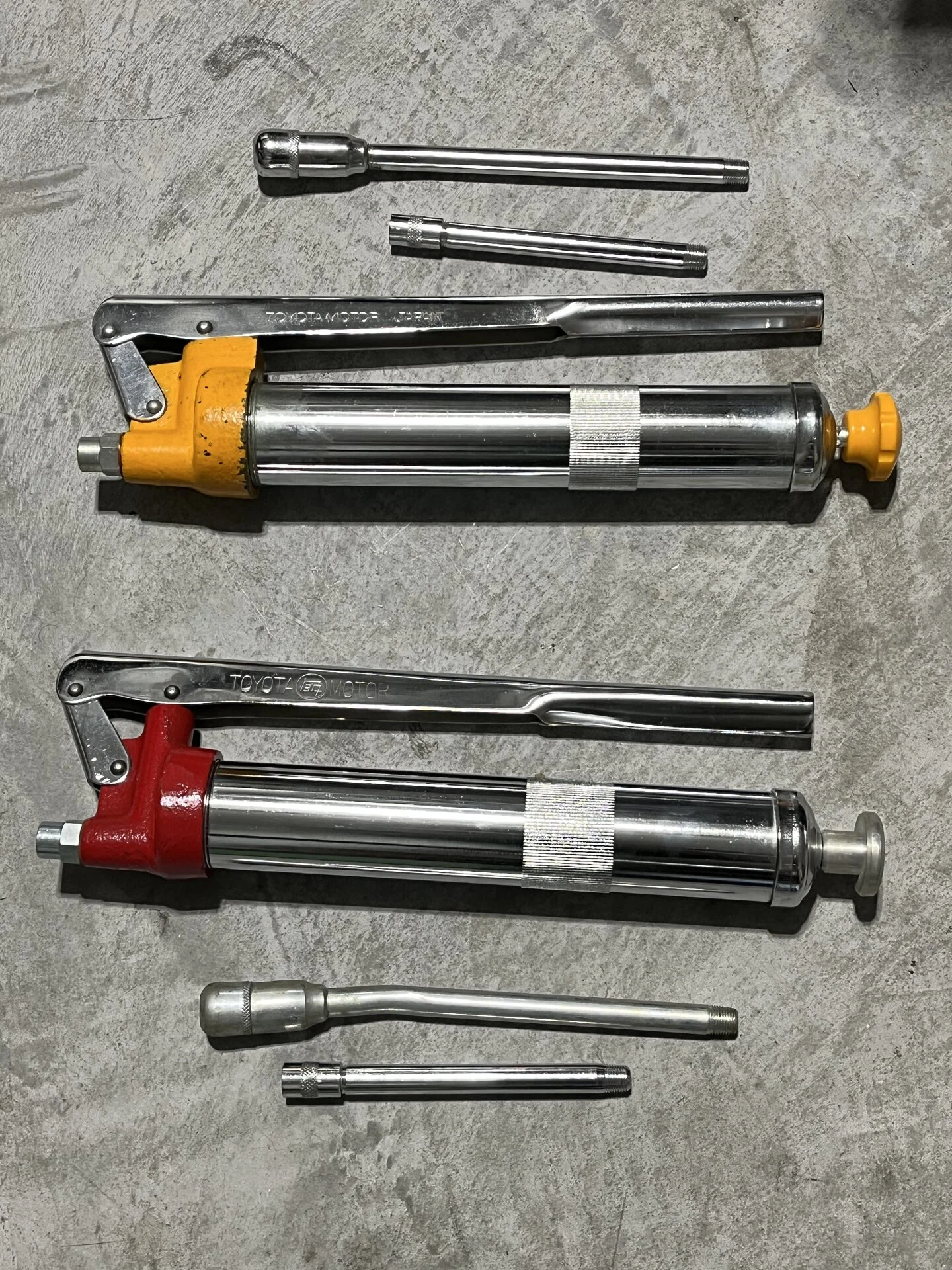

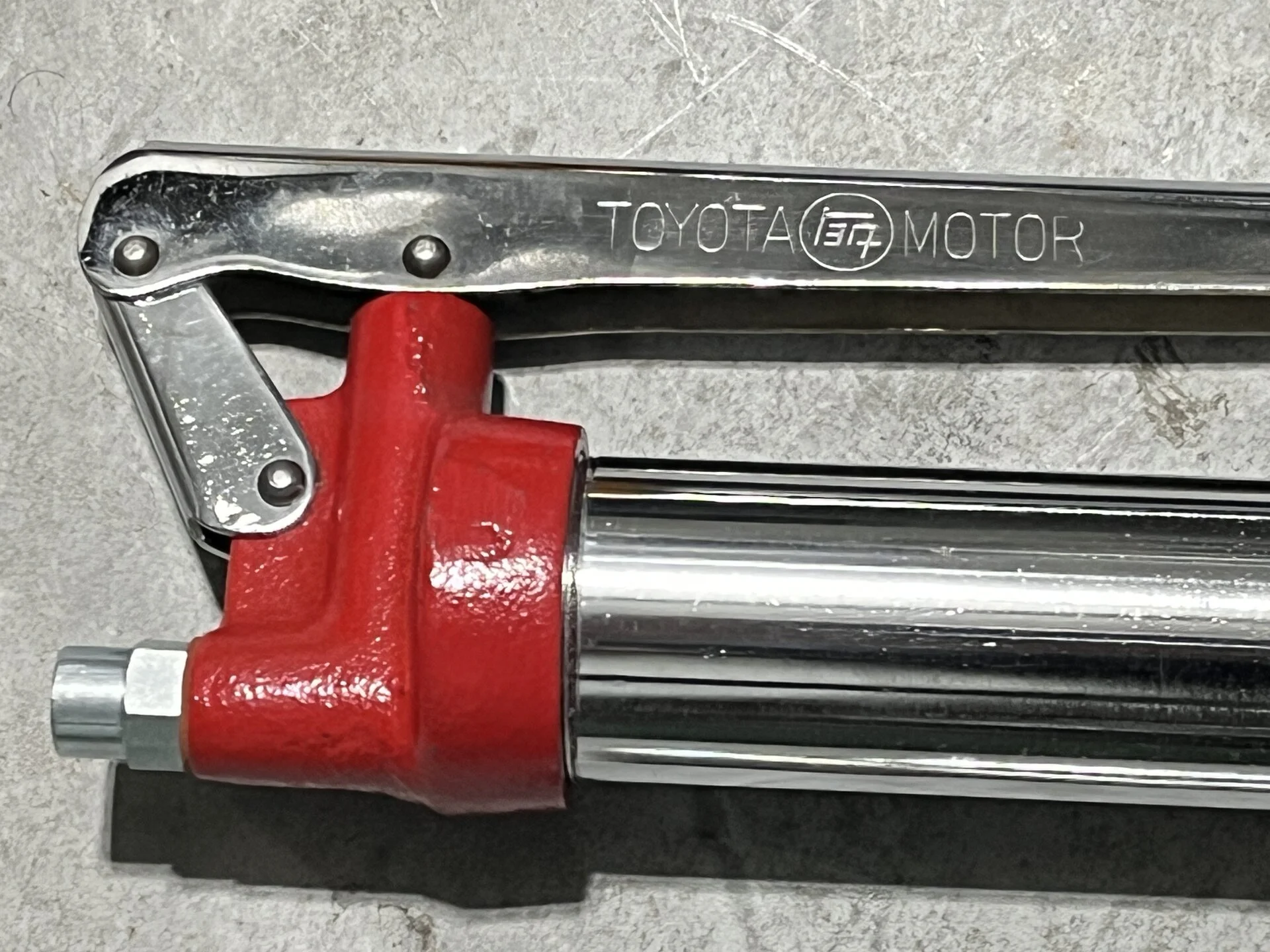

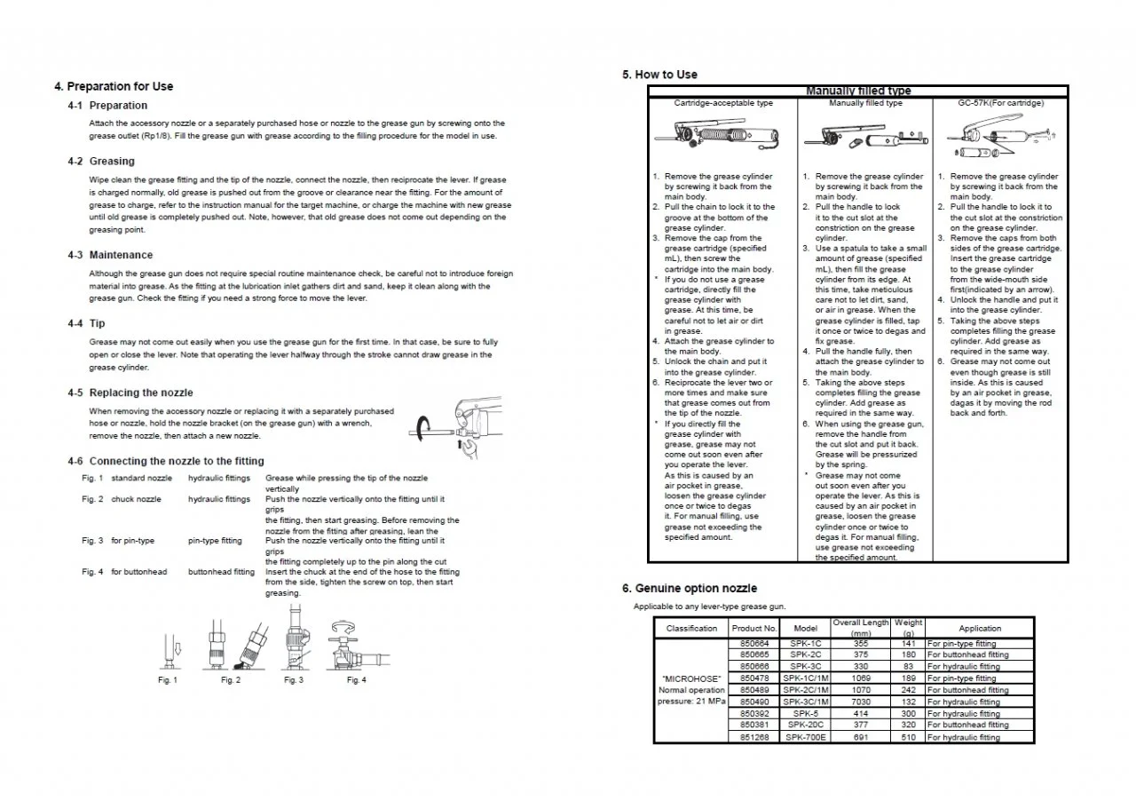

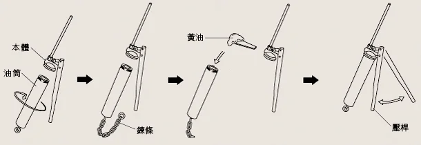

when is the last time you pumped a Generous Amount of the TOYOTA Presidents AWARD into every single ZERK on your power train and chassis ?
if you can't recall , or know you don't know what i refer to here , then that time is today , right now .......
then test drive , and report back here all the 411 you experience even in the slightest way shape or form ? ....
the below tech videos TECH is same in kind to your 60 series ....fyi
THIS IS THE WAY .........

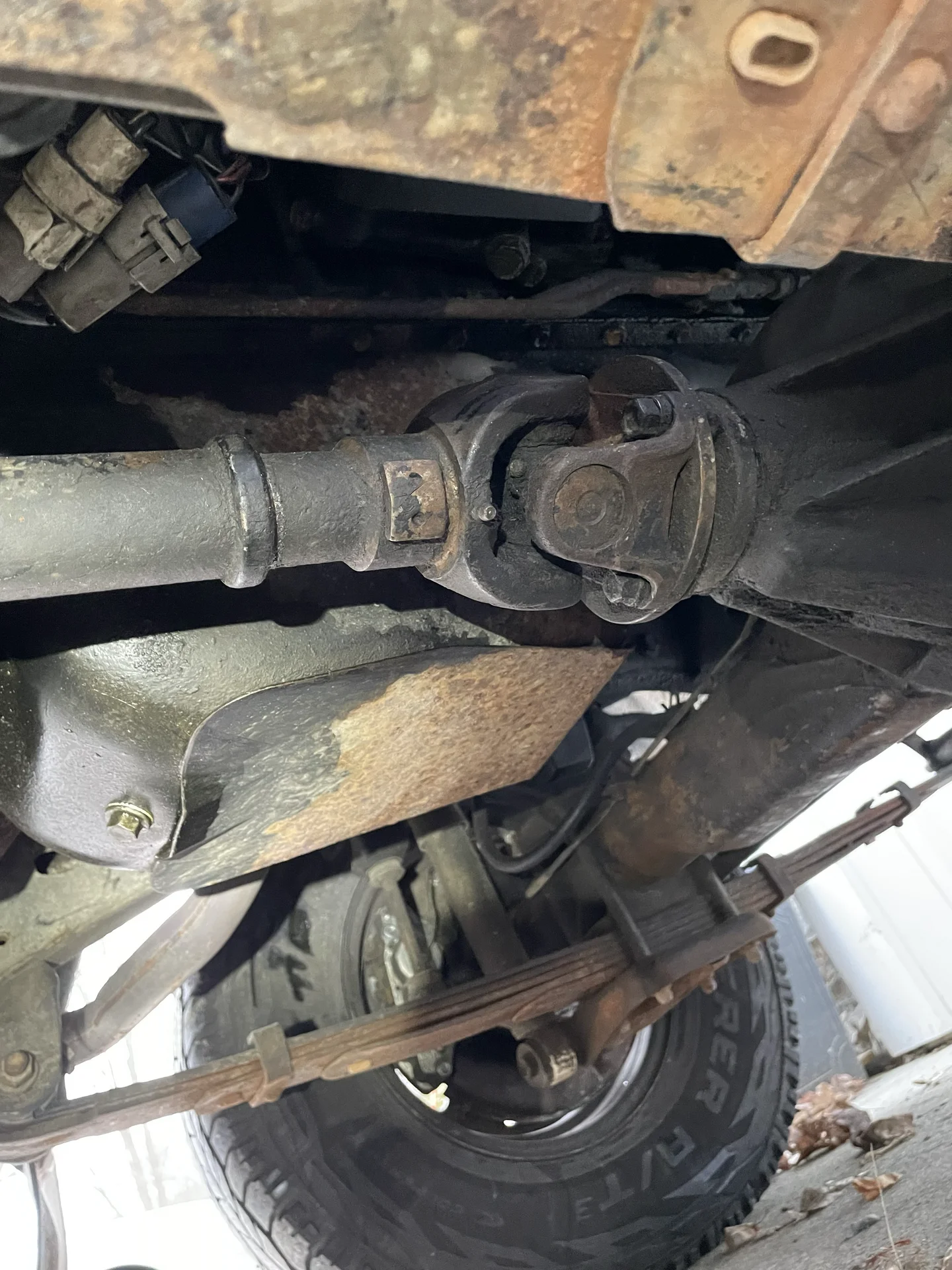

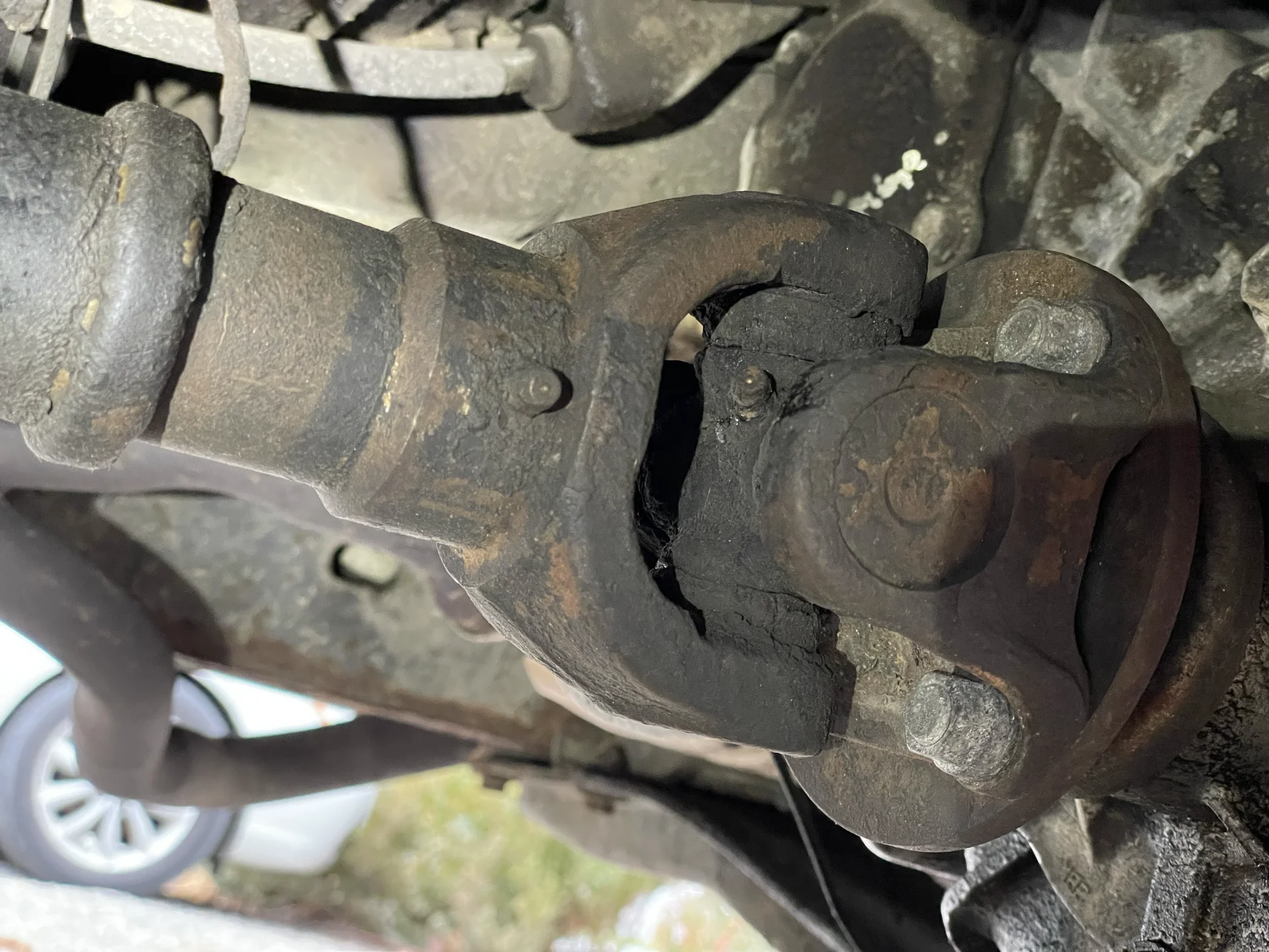

.View attachment 3521478
This'll be fun to see what's under there. Last time I looked it was so caked with spattered grease. Will report back though.
Things look pretty dry. Is this really the sort of thing that could cause the "clunk" when releasing the accelerator from decent revs at the top of 1st gear? As I said it doesn't happen in any other gear so only when funder high torque I guess.
