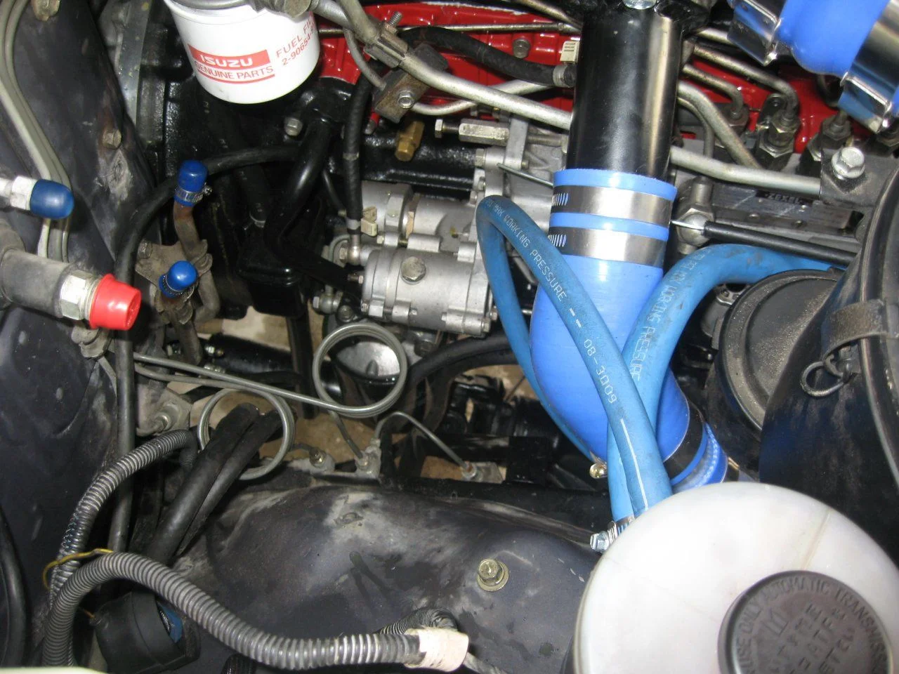

If you can find one, the stock Isuzu 4BD2tc catch can has worked well on the engine I swapped into my 60. It's small, uses 3/4" hose, drains collected oil to sump and vents to the atmosphere. Lot's of these trucks and engines around, maybe a truck bone yard near you?
The CC is the black rectangular plastic piece. It;s about 4.5" W X 2.5" D X 3.5" H
Sorry, best pictures I have.
