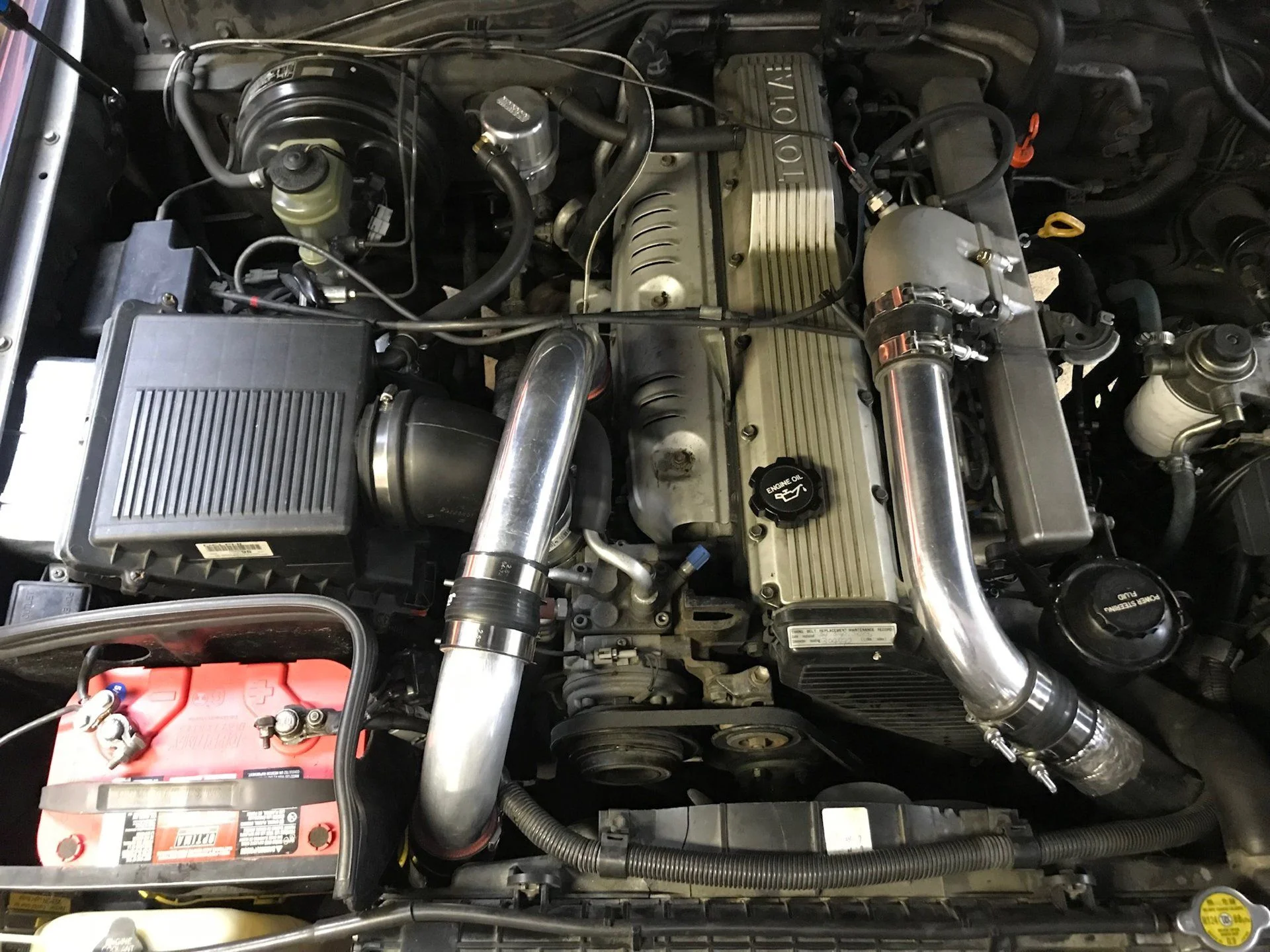

Yes it is and works well. I had to shave the bottom to fit under the hood and then just used self tapping screws to mount to the top of the fender. I’m sure there are s few write ups on this on Mud. I believe it used the same size panel filter as all the expensive aftermarket air boxes. I bought it off craigslist with the pipping cause I wanted the 6” elbow coming off the box.
Ran my vent to atmosphere and did my normal route to the cabin. The turbo does feel ever so slightly less responsive. I'm not sure why. It is still much better than it was with the stock airbox.

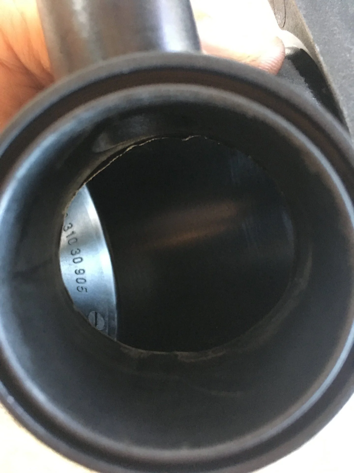

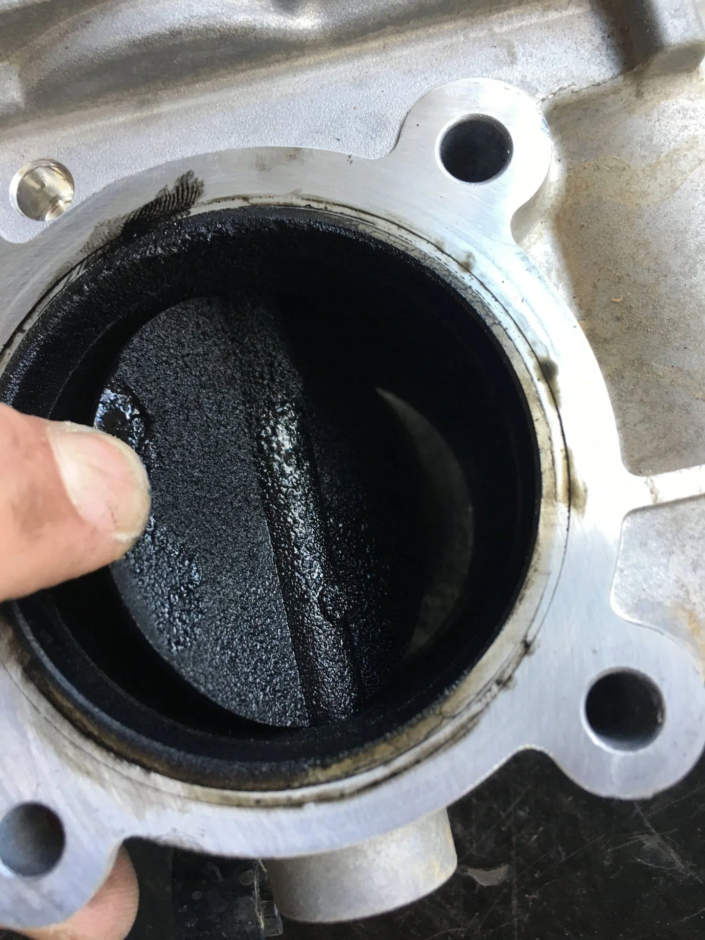

My Hilux has 65,000km and has had a provent 200 since new, I stripped down the intake to inspect it and found the throttle body coated in gunk and intercooler saturated in oil. I’ve since disabled the egr but I still want to eliminate the oil residue as it’s fouls up the multiple sensors in the intake and the intercooler.
I’m thinking I’ll modify my provent the same as Dougal did, but I’m also wondering if an oil cooler plumbed in line before the provent would help condense any oil vapour out of the air stream.
IMHO, feeding blow-by waste back into the intake is never good. Results like the pictures above are standard and cause problems. I've read about Dougal's Provent mod, and many have found good results. I'd try it and see what happens after a few thousand mile/KM's.

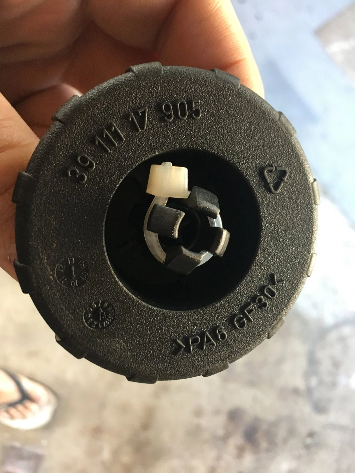

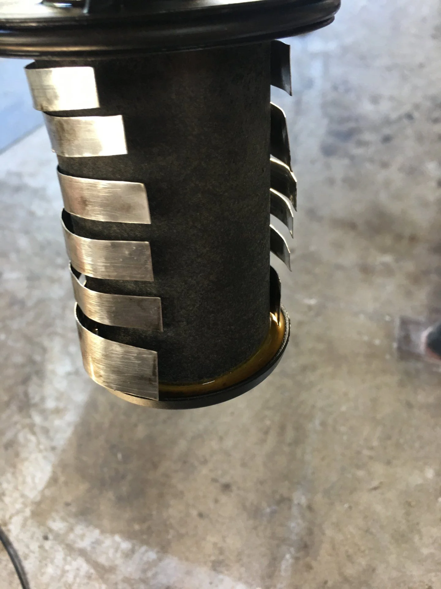

Well the mods done, now time will tell how well it’s worked. I posted these photos up on a local Hilux forum and got berated for being an idiot who thinks he’s smarter than a German engineer. You just can’t please some people.
Chopped out the valve seat.
Locked the valve open with a zip tie. (Ghetto I know)
And a ghetto fab baffle plate just because.

You’re completely right about the drain port being on the wrong side.
My *guess* is the provent element gets over-saturated with all the oil flowing through, and once blowby reaches a certain point it vents to atmo through the overpressure valve. Still seems to keep the odors down at idle and the majority of oil out of the engine which is all I care about so happy to run it in its stock, questionably-designed form.

As Dougal has explained, the drain port is on the wrong side of the filter, oil has to be forced through the filter to get to it meaning it has a chance to turn back into a vapour. The return port is also near the bottom meaning all the oil sitting in the drain port and the bottom of the unit can vapourish and be sucked right back into the intake.
If reverse flowed the captured oil at the base of the unit has to try and get through the filter and out the port at the top of the unit.
