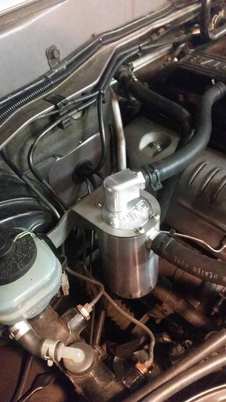

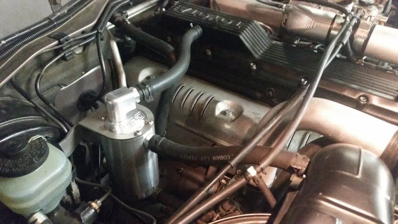

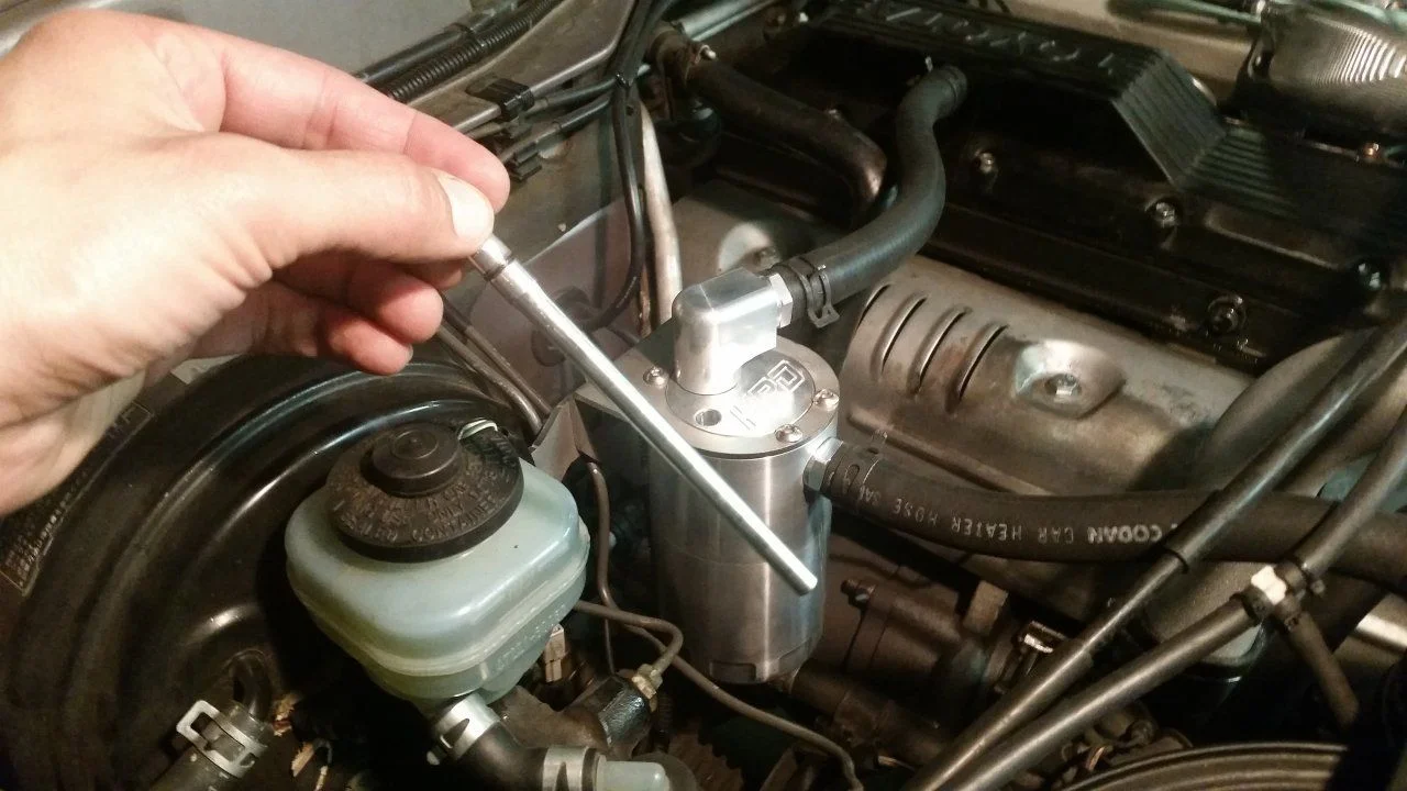

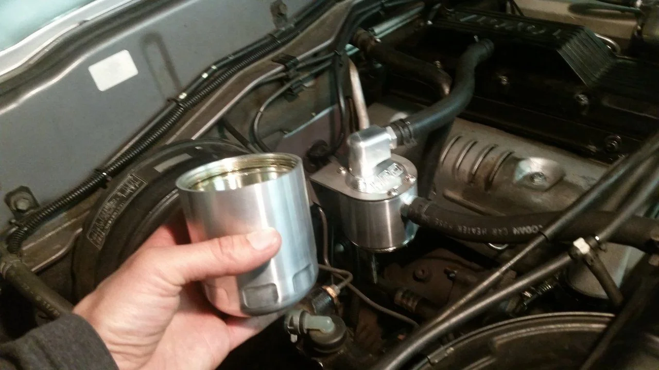

As requsted:
A little pricey but very blingy and worth the money IMO to protect my investments. No point letting a new intercooler get gummed up with oil. Super easy install. Takes about 15 minutes. Comes with nice bracket, hoses, clamps and fittings. View attachment 1267055 View attachment 1267057Has a handy little dipstick for checking oil levelView attachment 1267059Plus the bottom unscrews making it very easy to emptyView attachment 1267064
Is there enough room behind that catch can bracket for a clutch master cylinder? Looks like it could be tight.

really cool thanks for the pictures for the catch can. quick question is this the 2 bolt bracket or the 4 bolt bracket version? im just on hpd website and almost ready to pull the trigger!!!
Mine is the 4 bolt. As in 4 bolts hold brake master cylinder to brake booster. The bracket itself only uses two of those bolts. I'm guessing the bracket for the two bolt master cylinder uses both bolts but is obviously configured differently. Just check which MC you have
I will check the measurement for you when I get a chance
Yes, there is

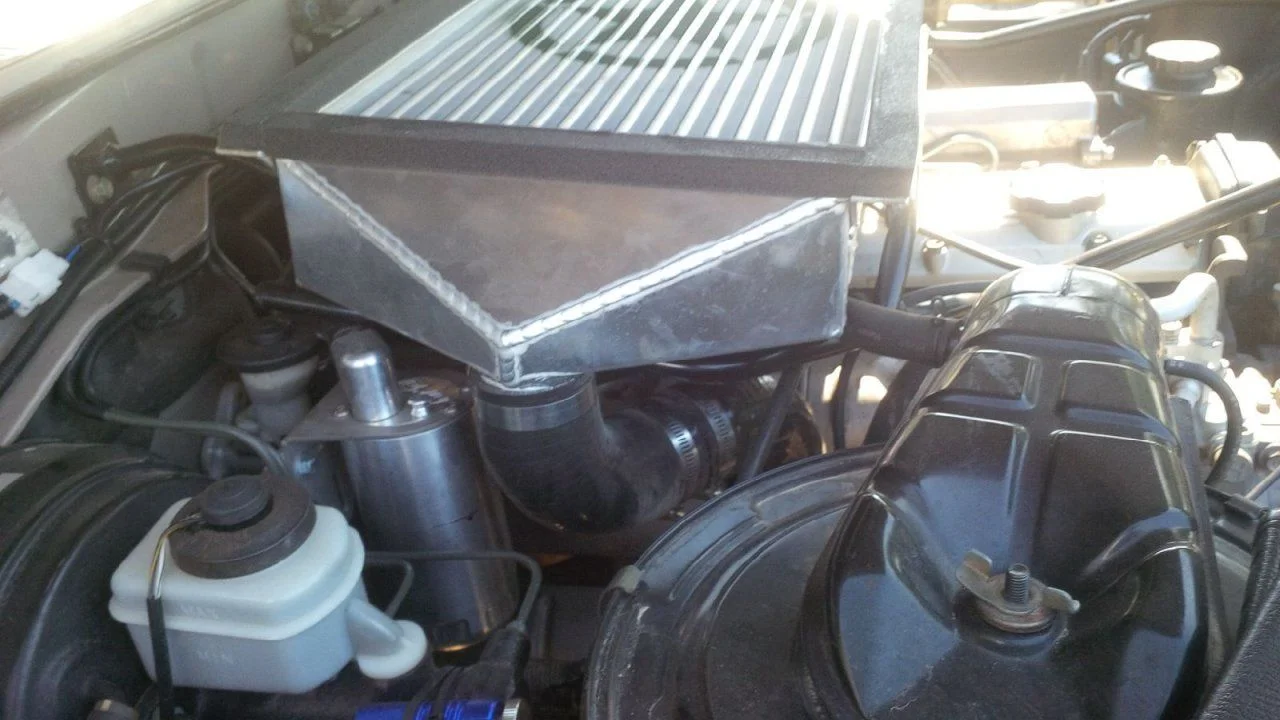

@Malahki great job on the write up. Looks like a really decent kit, particularly for a bolt on kit.
My only comment is it looks like they could possibly have gone a bit larger with core?

I was able to squeeze a 3/4" tranny cooler between my Intercooler core and AC condenser but man is it a tight fit!!
Yes 2" & 2.5" OD
If it's 2.5" OD, it's got to be more than 2" ID. It's not quarter inch thick walked pipe. Probably just over 2.25" ID.
