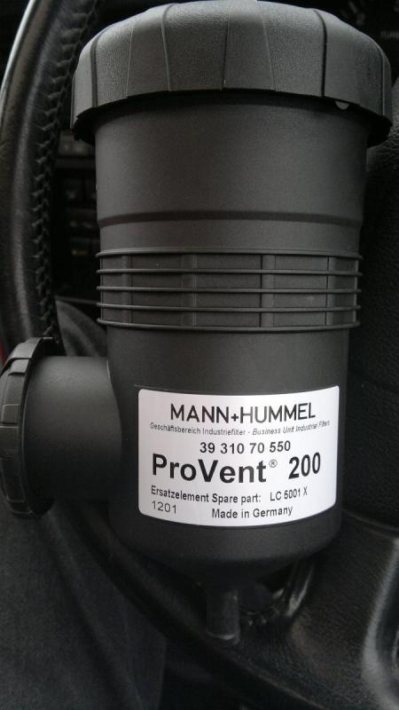

I just bought a Provent 200 oil/air separator, like the pic below. I got a question for members who installed/familair with this system. Is the round valve by the exit port adjustable? It is referred to in the manual/spec sheet as the "Pressure Regulator" or "Control Valve" which gives the impression that it is adjustable.
I tried to turn it but it took a super-human force to turn just 1/4 turn and then no more. I could see a small gap between the valve and the exit port (see second pic). I don't really know if it should be there, and if so, how much should I adjust it for.
I hope I didn't ruin it by forcibly trying to turn the valve..
Any suggestions??!!

That is the "self regulating" outlet valve. The intent is it closes more when intake vacuum increases to limit the airflow and stop vacuuming out the engine crankcase.
The cap isn't supposed to turn, it clicks in place and is actually two pieces.

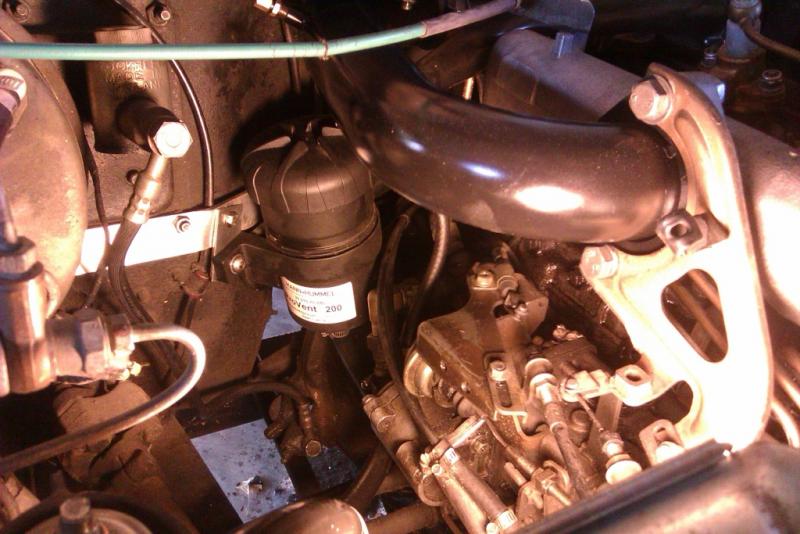

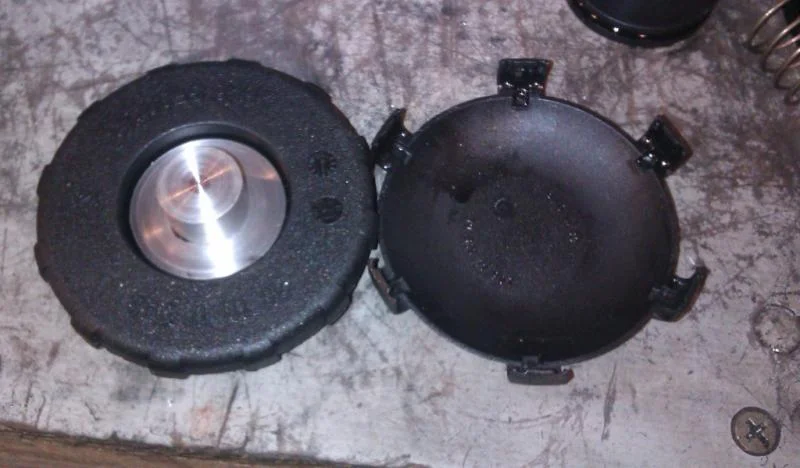

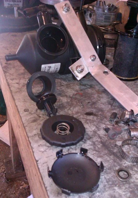

Here are the pictures of the changes I made.
The oil consumption was roughly half a litre an hour, which would be roughly what I expect to go through the oil seperator. Keep in mind this engine from the factory had an external seperator, it doesn't seperate the oil in the rocker cover and leave it inside like most other engines do. It seperates it externally and drains back to a barb on the sump.
Provent on the bench. The lower hose (return to the intake) is a clear pvc hose which is black on the inside from all the oil leaving the wrong way.

First cover of the pressure compensating valve open:
attachment.php
The valve parts spread across the bench:
attachment.php
I machined two aluminium blanks to seal up the cap. With black RTV to ensure a seal:
attachment.php
And here is where it is installed:
attachment.php
