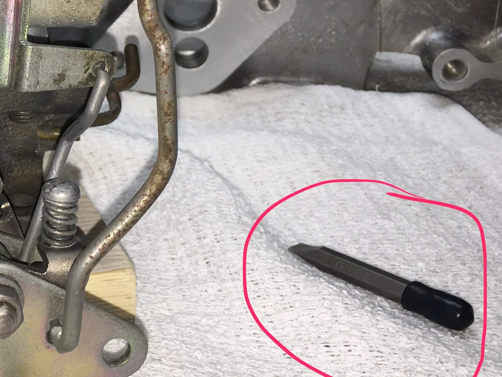

This is the tool I use so I can do lean drop with the air filter housing on. Flat head bit with a vacuum cap for grip.
Brilliant. I was pondering a right angle bent thing... some reason a paint can opener always comes to mind but I have one and it def doesn't fit the bill. That looks perfect. Thanks for the share!
