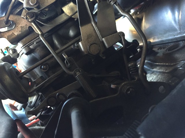

The second pix. And honestly unless it's the angle so it's blocked from view, I don't see the horizontal spring??? @FJ40Jim....

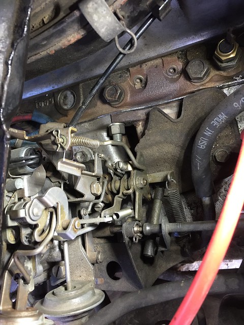

Ok here is a bit better pic with more light. Storm is coming in so pretty overcast right now and windy..
I think you are referring to the spring that is almost dead center of the pic..

Just a thought, have you checked the adjustment on your choke cable? Maybe it is tugging slightly on the linkage.
That too. My bracket was bend to s*** and thankfully I was able to pull my old bracket and swap it.
Ok but why would the choke cause that to happen? Should I disconnect the choke cable to see if it still does it?
It's just a hunch, far fetched at best. Idk really. Have you discussed it more at length w/ Jim?

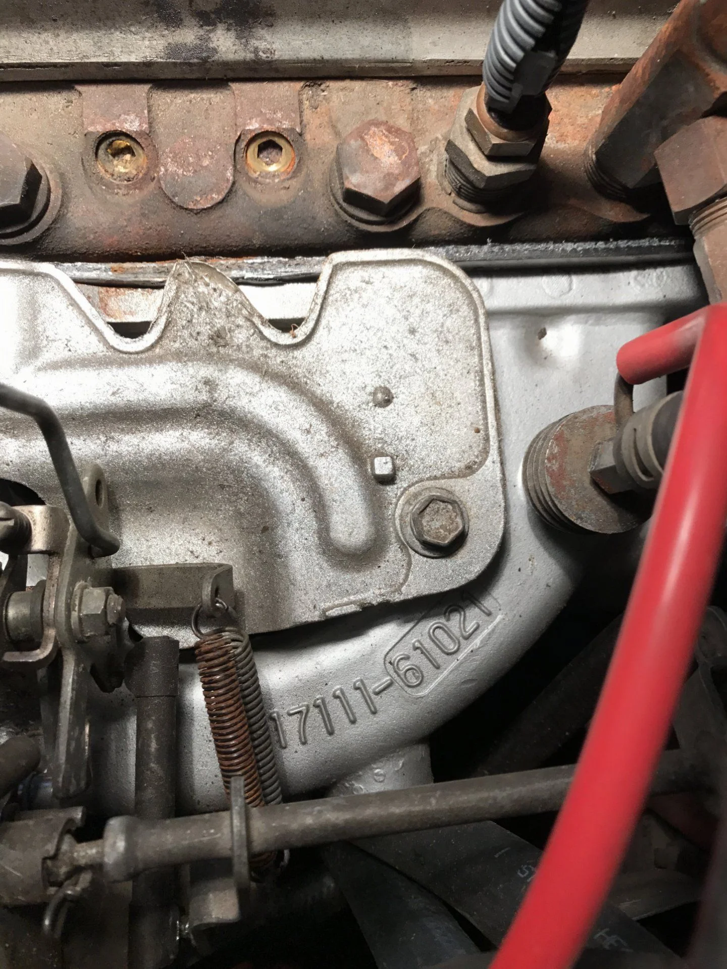

The one bottom right.
In the photo below you can see my helper spring I added.
I had the truck idling and was pushing on linkages to see if the idle would lower the rpms. You could detach the choke to see if that is holding the carb from returning to a complete idle.
Hope that helps. That would be a pretty simple fix vs tearing into the carb.
Helper spring. Interesting. Why not just replace the spring?
The choke cable pulls on the linkage and causes the RPM to raise. If there isn't enough slack in the cable, maybe it is causing it to raise the idle just a little as you described. There is a clamp on the valve cover side of the carb that holds the cable housing in place and it is adjustable.
Loosen the Phillips screw pinch section on the bracket and pull the knob out all the way to adjust where it's being pinched, then tighten. Definetly can take some fiddling.
Choke opener is hooked up, operating properly is a different question.
