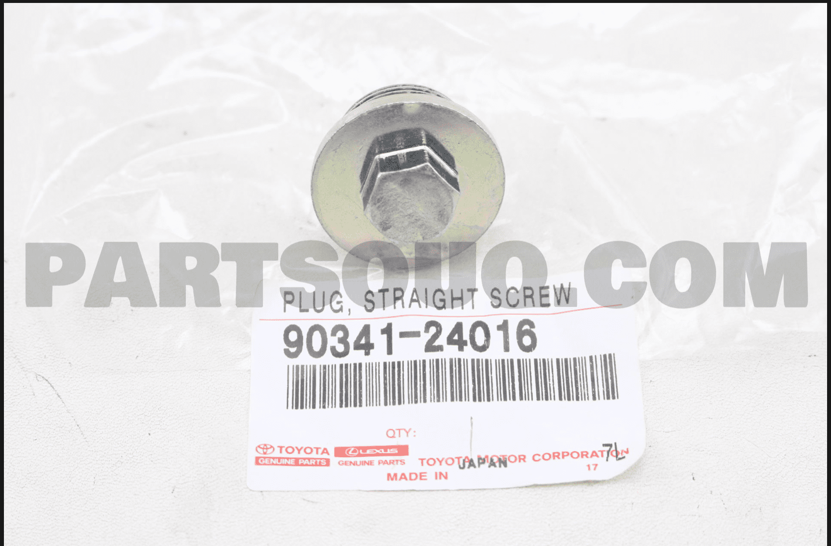

I replaced my drain plugs with the hex bolts to make the socket fit easier

BTW this is what I was talking about for hex plugs. First change on my diffs and tcase I swapped these out
90341-18021-jpg.791532

i swapped it for this oneView attachment 1958913
