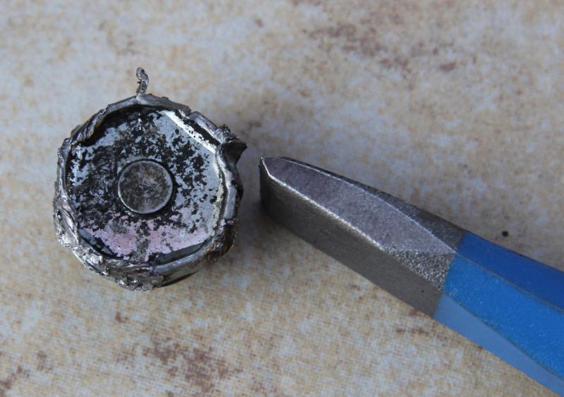

PO of my 94 LC must have stripped/rounded the diff bolt-head over torquing it on, leaving me with the headache, thanks to this thread, gave me a few options.
First option - chisel's a great idea - https://forum.ih8mud.com/images/smilies/idea.gif .... for future info, I attached a pic of the conquered bolt. Used an impact gun/wrench with the chisel. Took 14 seconds.
