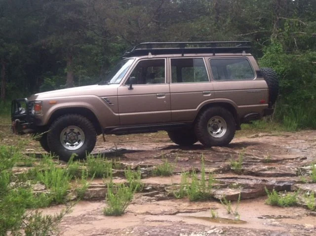

What @CaptClose said. I have 33/10.5 BFG ATs and in flat S. Texas where nothing (to wheel) is closer than 5 hours via highway, it is the most practical set up. Can't imagine Kansas being much different.
This is about as offroad as mine gets.
