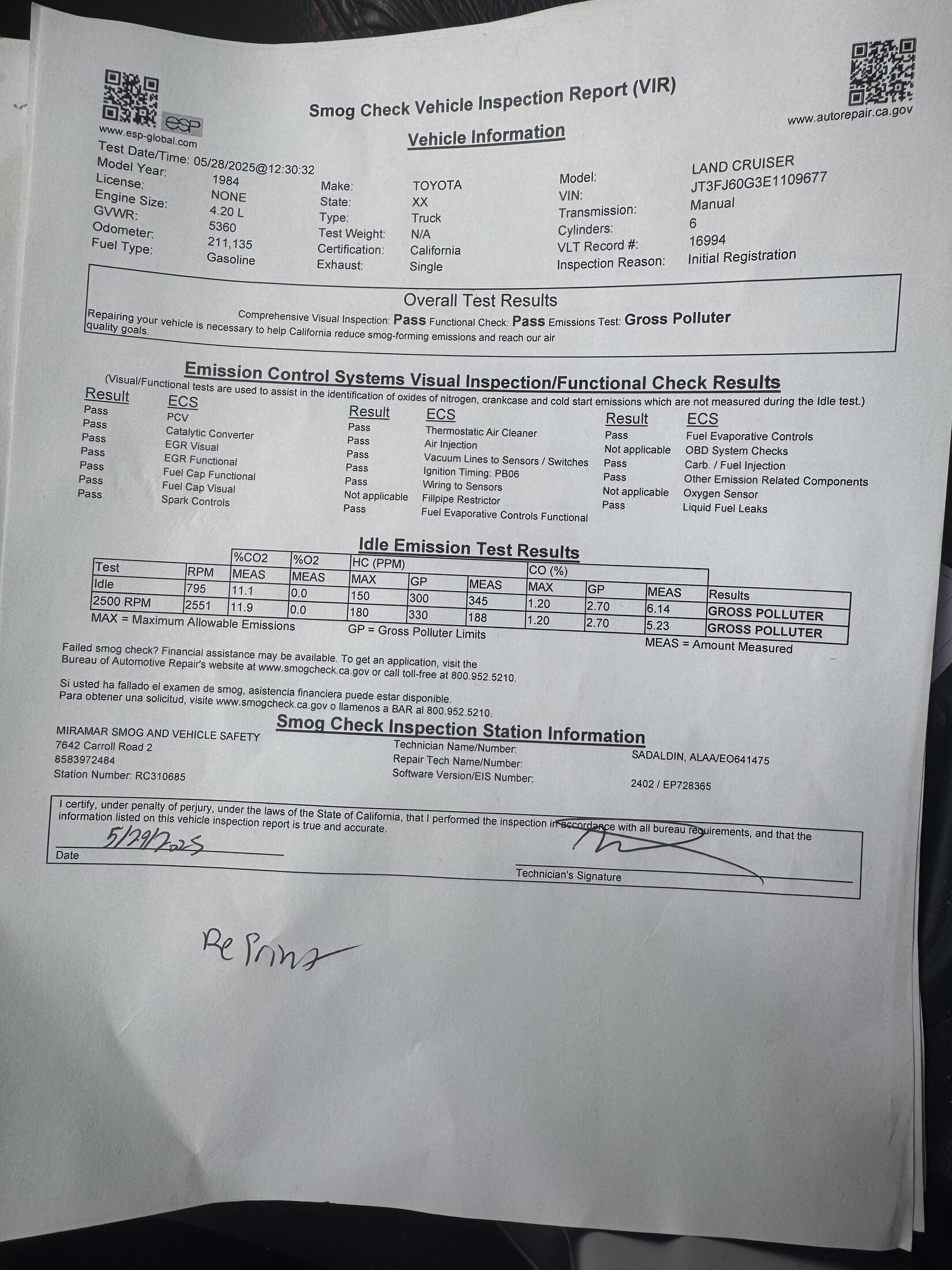

1) %O2 is zero, does this mean the air pump isn't working? I assume that this will make HC high given the idea of the air pump is to promote further combustion of unburnt fuel which should also improve CO?
2) Do you know what your timing is at?
Okay, here is the smog report. I’ll take pictures of the engine bay this evening.
Is this a loaded test (Dyno)? Your reading is just as bad as mine but you don't have a Nox reading, my CO readings are very close to yours but my HC are borderline line failure. I rebuilt the carb about a year ago and I could not get the readings below 5%.
Your O2 is zero. This is a fairly common problem. Air Injection is not working and that affects the other systems. Air Injection is the smog pump, air rail on the head, and that mass of valves on the driver's fender and hoses. First thing to tackle.

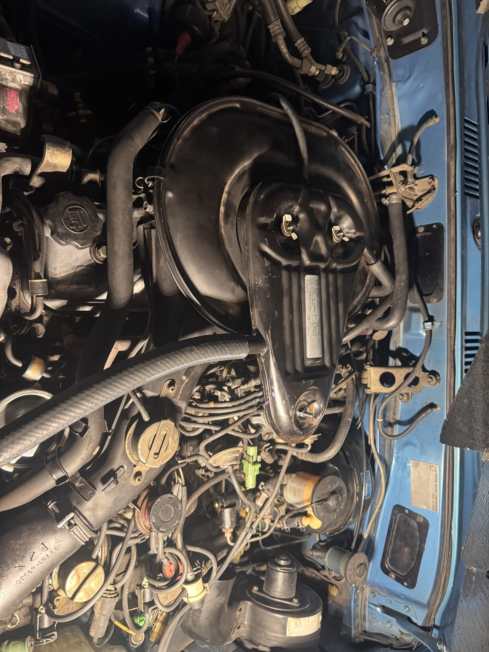

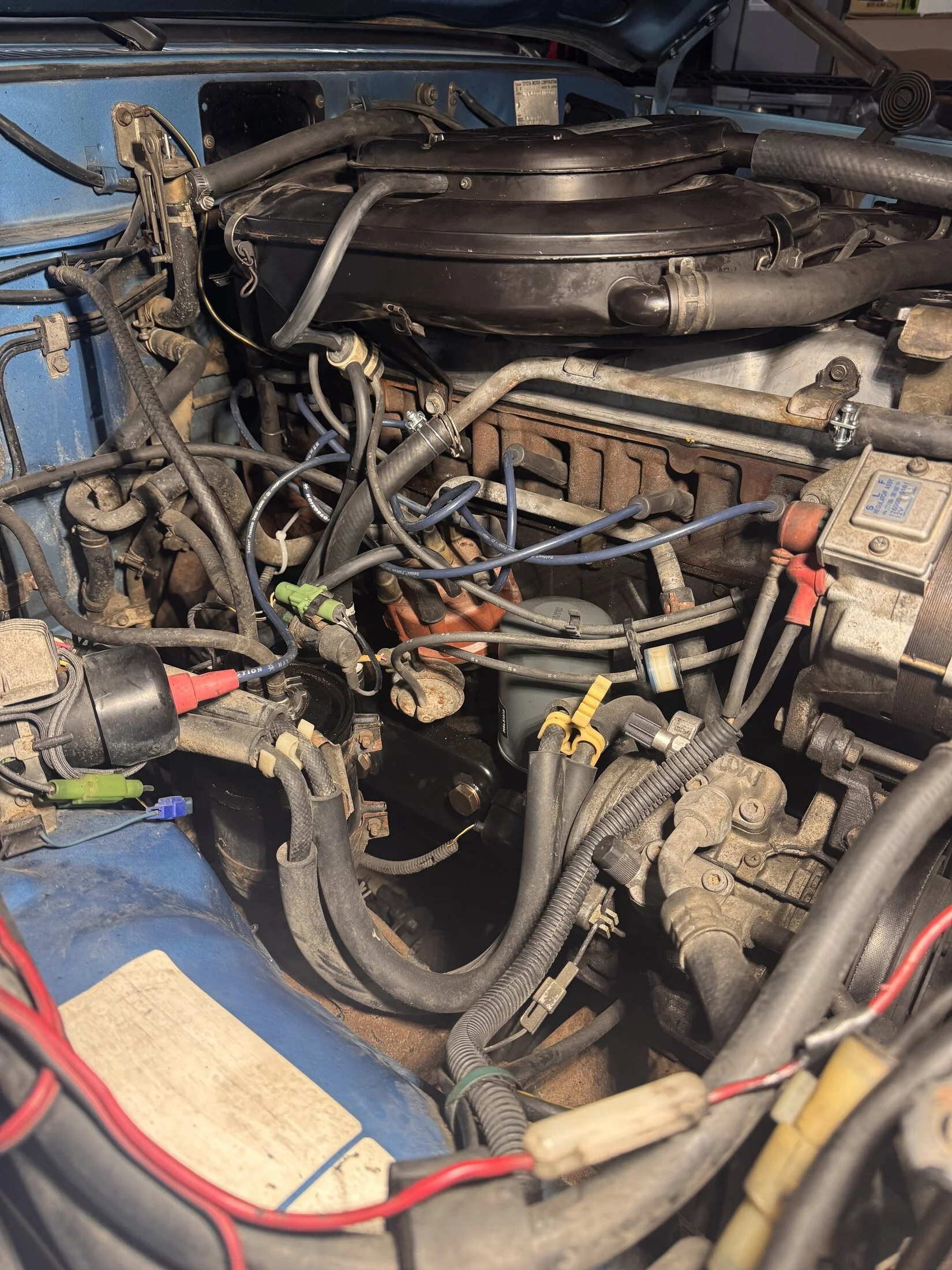

The good news is it looks like you have a nice complete unmolested FJ60, in the engine bay at least. Ah, the beauty of looking at that almost incomprehensible mass of wires tubes and valves!
However, and this is not a small thing, you need to get the correct hold-down wing-nut for the air cleaner, above the carburetor. That nut is letting in a surprisingly large amount of unfiltered air as well as moisture into the carb. Also, I can't quite tell from the pic, but the rubber gasket that goes around the top of the carb and the opening of the air cleaner is either missing or not installed properly. That, too, if it's missing, lets in unfiltered air.

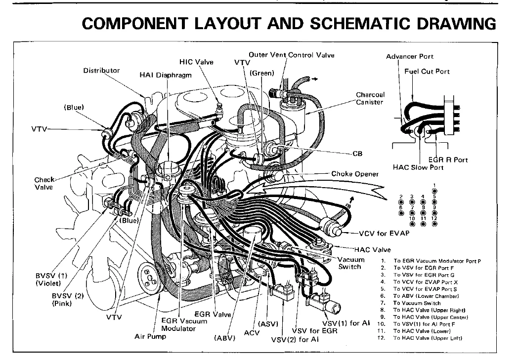

As far as emissions go, you have to start by figuring out why the O2 is at zero. That's an 'Air Injection System' issue. Below is a link to the FSM you need if you haven't already found it:
As Spike mentioned - your air pump/smog pump (Air Injection System) is not working.
If it was, you'd see some O2 in the exhaust and yours had none.
If the AI system isn't working correctly - you aren't going to pass.
The catalytic converter needs oxygen to work efficiently and the way it gets it is from the air injection system.
The air pumps definitely don't last forever. Your issue -could be- as simple as replacing the air pump. If its the original pump, its 41 years old. Sometimes when they die, they seize (while you're driving) and cause biblical mayhem in the engine bay.
Since you're in CA and you likely don't have a record of an air pump replacement, I'd replace it anyway just for peace of mind. Also it will take one unknown variable out of the equation.
Just a guess here, but that carburetor looks too clean, and the foil sticker on the diaphragm looks too clean, to have not been replaced with a factory Carburetor sometime in the last 10 years or so? I would not be surprised if the cap over the mixture screw is still there.
First thing, without question, is to get the AI functioning and check for correct functioning of the ABV assembly. Then, see where the other parameters land and go from there.
