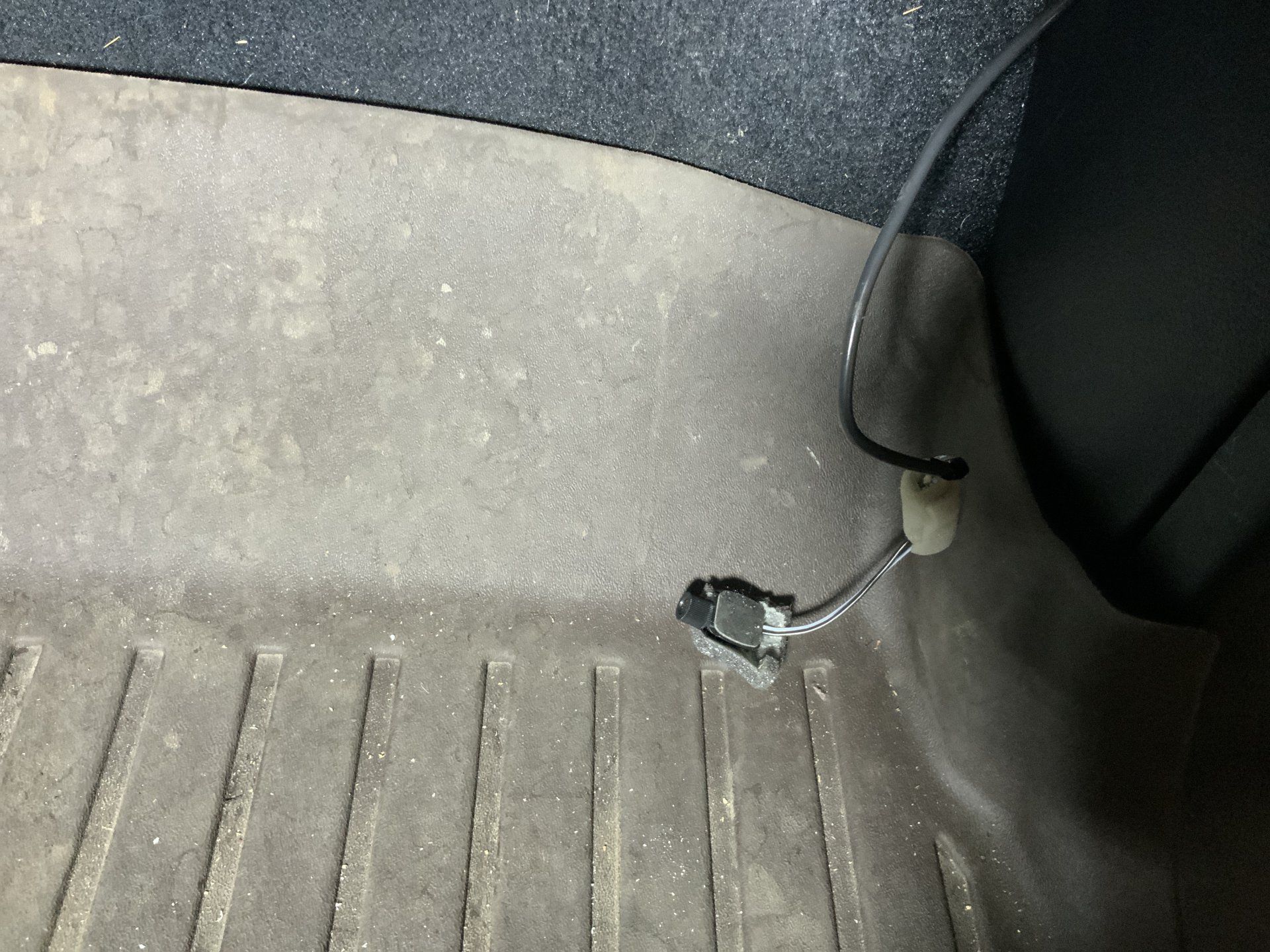

Does anyone who has done this repair know where this alarm microphone goes on the passenger side under dash?
Thanks. I'll look further. The original dealer that did the damage to the door did further damage trying to fix it last year. Stripped screws and this wire hanging around were among that damage.

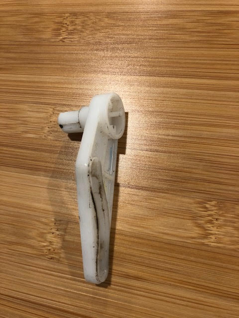

Question for this group...especially those who have ventured into fixing this issue.
After realizing that my recirc door was not functioning, I realized that the right side pin was actually missing. When taking the access door off below the glove box , low and behold the pin fell out. Any experience on how to reconnect? Easy fix? Luckily my door hinge doesn't look broken, so if I can get this reconnected I hope I'll be back in business.
The good news is the pin-lever is intact. If the parts that this pin connects with are also intact, then it should all go back together in good order.

I was able to re-attach the pin to the flap by only removing the access panel. I might have used a long screw driver to line things up, but there are no special tools required. It took me about an hour. Inspect the holes where the pin is attached to, along with where the flap should be (according to the switch on the dash), so you know exactly how it should all fit before you begin.
You’ve likely figured this out long ago @Sandroad but for others, that wire sits on top of the lowest panel removed from under the glove box. There are two secure locations for the wiring to be placed, one at the end and one where the foam is wrapped further up the wire.
There is also another shorter wire connected to the passenger footwell light in that panel too.
That is if my memory is correct from the last time I was in there.
