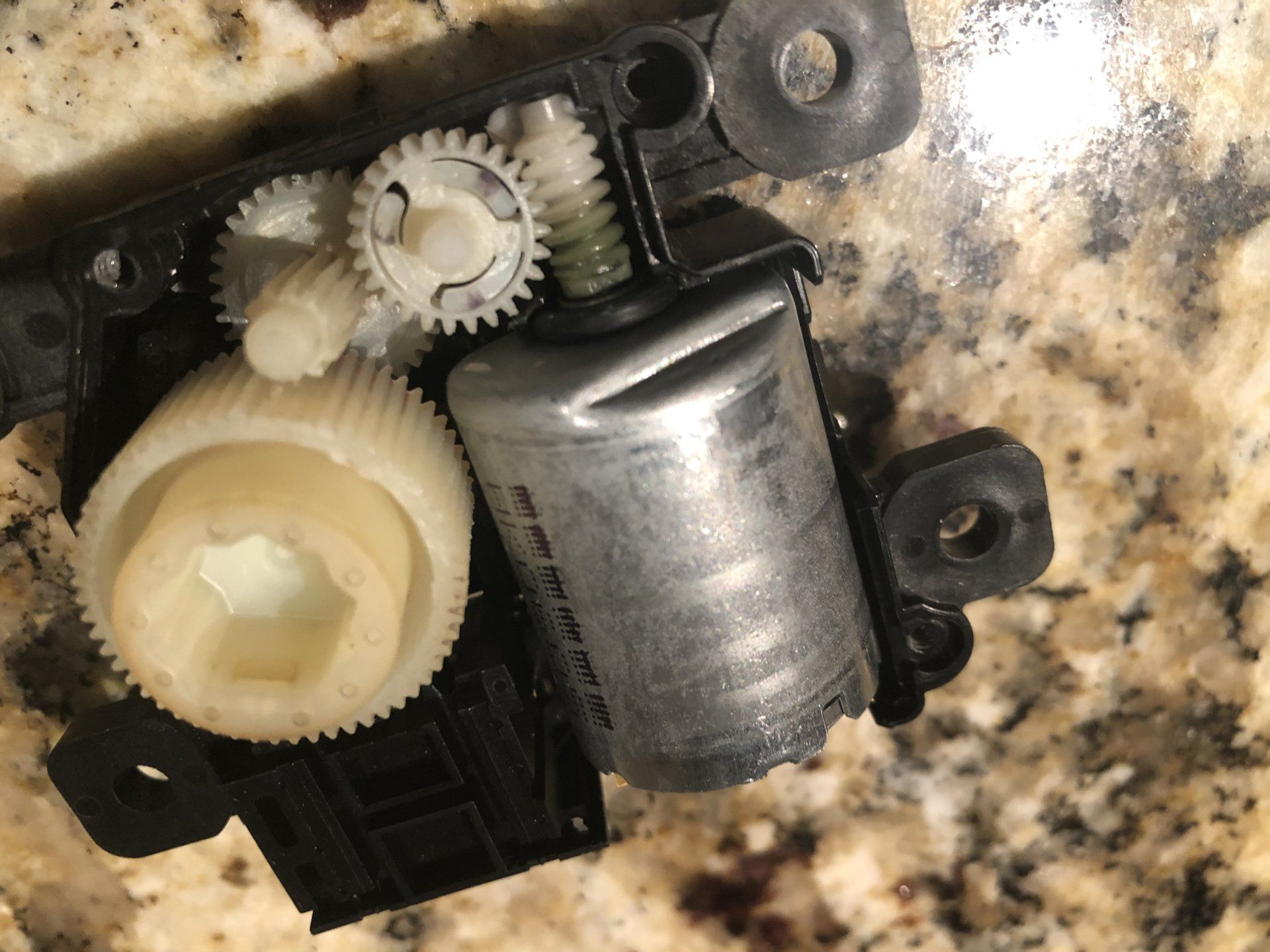

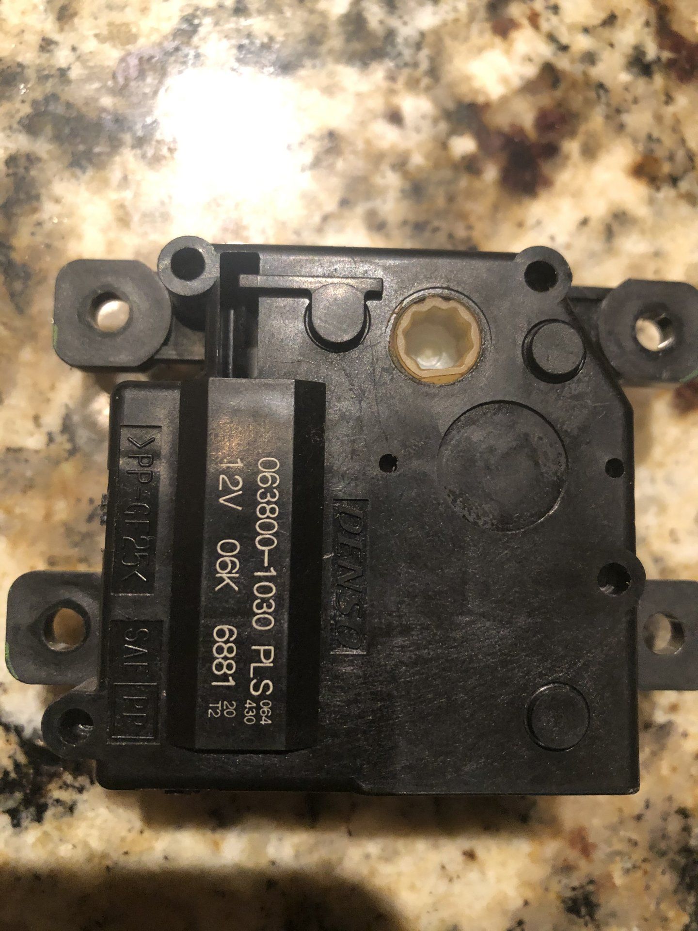

Excellent write up, thank you! My linkage wasn’t broken, but it was popped out. After putting it back together it still wouldn’t cycle properly like it was binding somewhere. I decided to pull the actuator motor and sure enough there was a stripped gear inside. Inhad to remove the NAVI drive and some other assorted brackets to reach it. I bought a replacement part off eBay and now we’re good. I put a “NO TOUCH!!!” label on the access door so hopefully they’ll keep their greasy mits off of it at the dealer.

Agreed, not a Denso issue. The motor was fine. It’s from untrained Techs jumping in and forcing the door open. In my case the actuator being disconnected the way it was forced the motor to turn beyond binding up and eventually chewed the teeth out of the drive gear.
