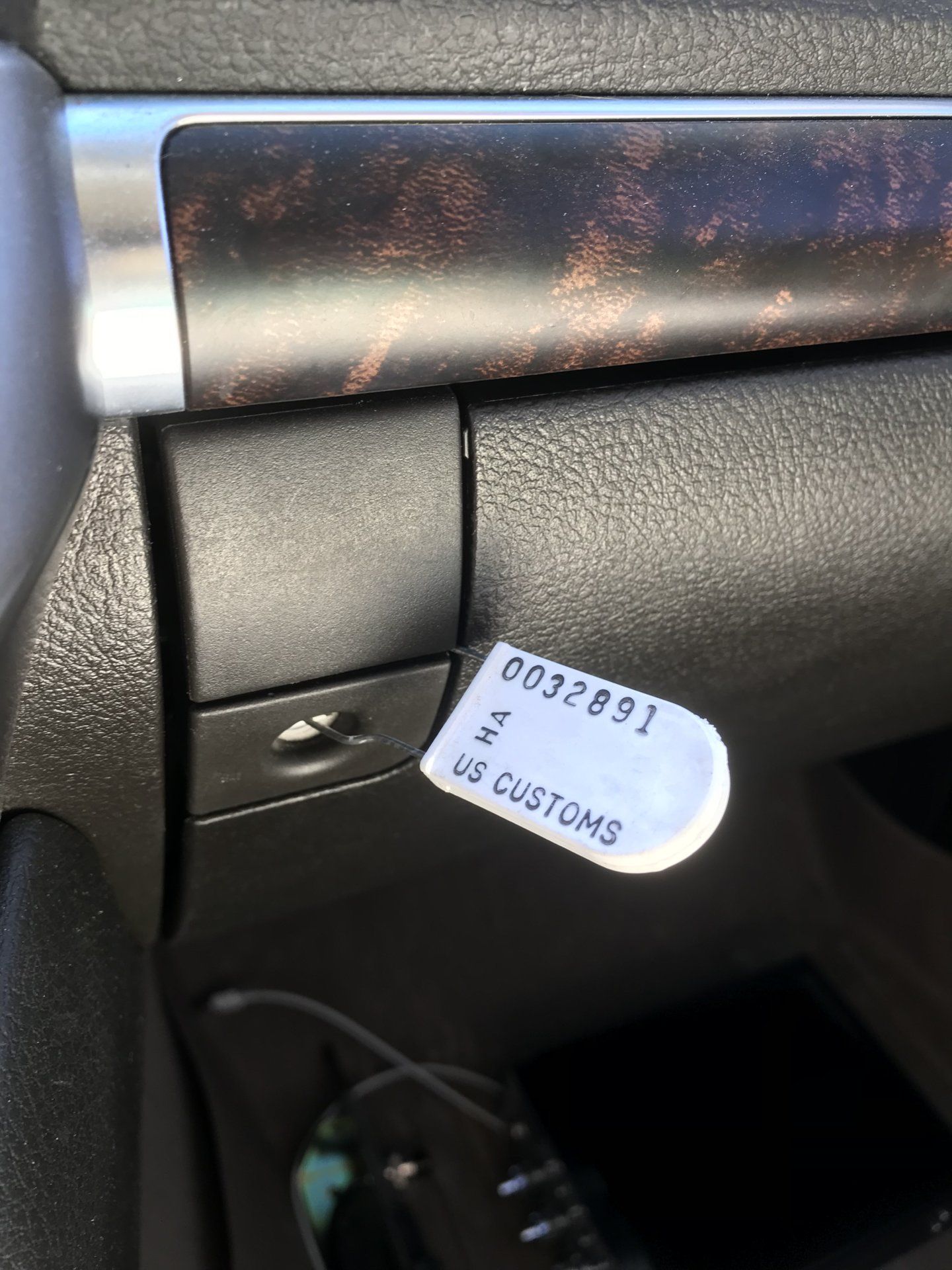

I locked the glove box and installed this before I dropped it off for the recall. I asked them not to do anything else, not even a free wash. The security lock was just cut, bent and stuck into the lock and U.S Customs may have helped. It did it’s job, they still pulled the wheels to ck the brakes and 50 other things but did not mess with the glove box.
That's a clever way to keep them out.
I tell the service writer I do not want them to touch the cabin filter (they note it on the ticket). I also lock the glovebox, and take the physical key part of the fob with me, so they can't open it. That seems effective too, in case you don't have access to tsa/customs lockout tags.
Bears repeating... Someone here has created a warning label that is infinitely better than the factory one. I dont have a pic but when I took my LC in for the seatbelt recall, I had the warning label, blue masking tape over the filter door with FILTER IS FINE. DO NOT OPEN in bold black sharpie, locked the glovebox, and another even wider piece of tape on the outside of the glovebox.
Yep, it is a great label. I bought one and put it on the filter access door. With any luck, no dealer tech will ever get that far.
Although I love the label, and it makes me feel like I have taken action, I have 0% confidence that that would even slow most techs.
Lock the door, don't leave a physical key, and don't lose sleep.
Still, a customs seal would be very cool
