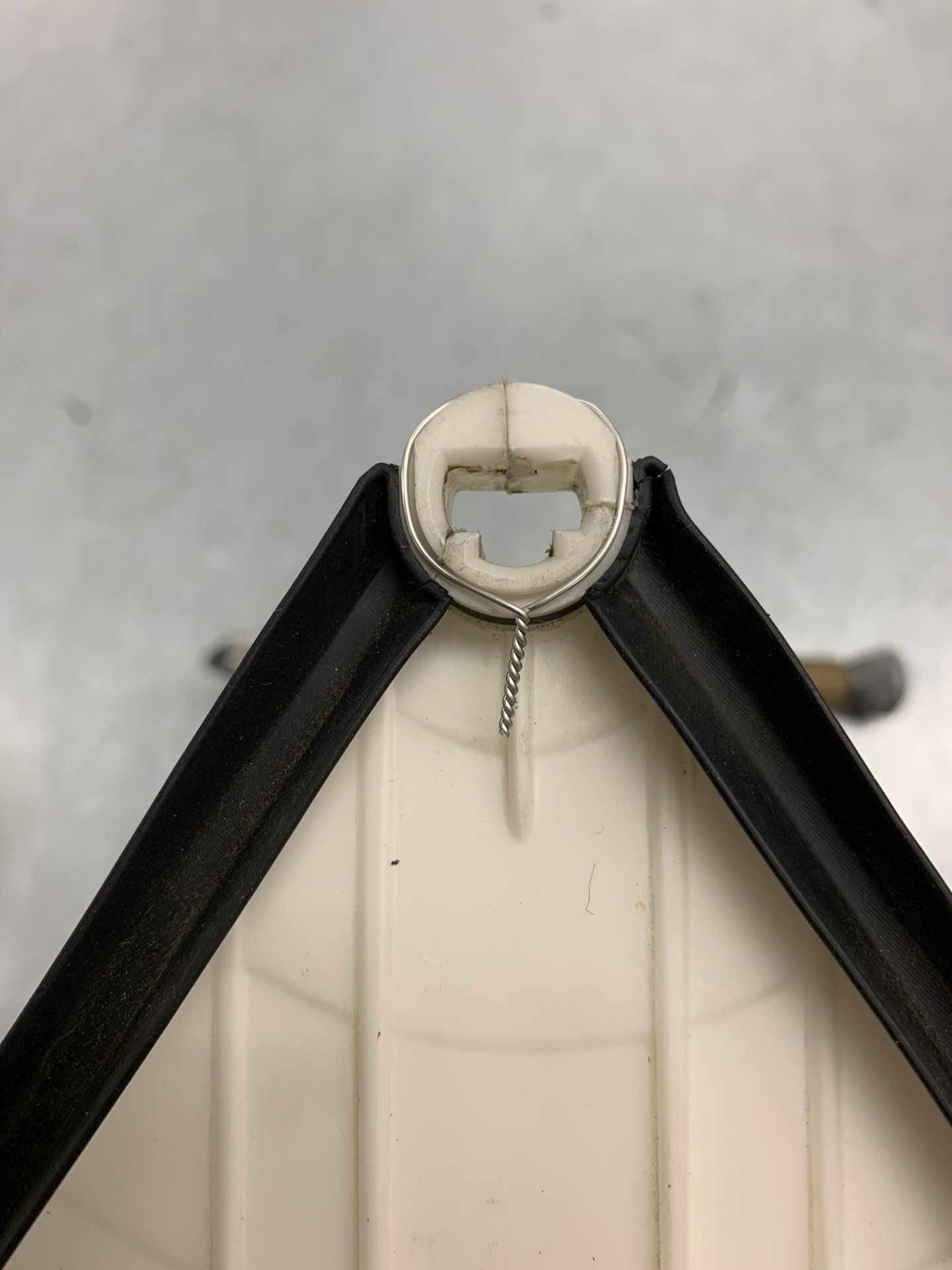

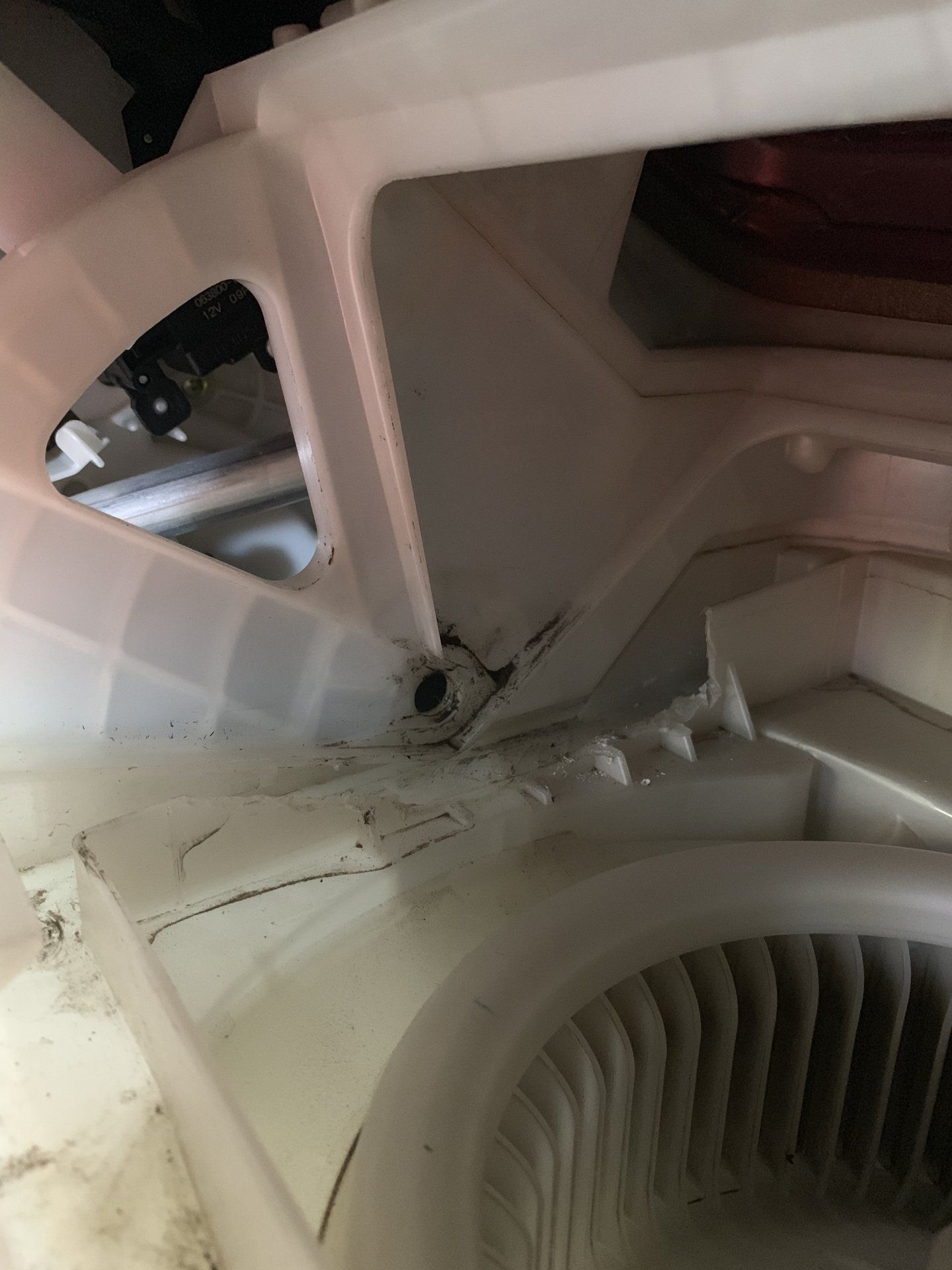

3: The inboard hinge pin is OK, but I cannot see any way to remove the door from the blower housing without taking the whole darned thing out of the dash. I have tried carefully prying on the interfering part (to the right of the leaf) and there is no way I can flex the parts enough to get the pin to clear.
It is possible with patience to get the door out of the assembly without removing the whole assembly (doing it by the book requires removing the dash). I did it. I couldn’t get enough flex either, so I took a fillet knife, heated it with a propane torch, and cut/melted away some of the blower housing and made some clearance.
After getting the flap out I glued and safety wired it back together.

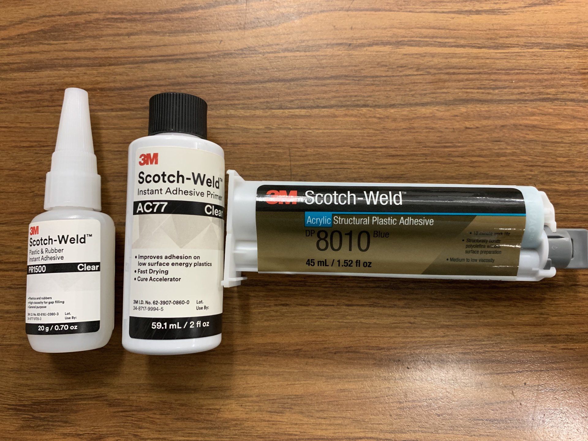

The glue I used came from 3M. Through work I know a 3M adhesives application engineer. He came over on his lunch break and walked me through the two products he’d recommend and then helped me glue it all back together. These are the products he recommended. He and I used the 8010, but he said the other two products used together should be fine too. Epoxy and JB weld won’t stick to the low surface energy plastic Toyota used for this part. These products will. This type of plastic is also easily weldable if that is appealing.
Getting the door back in was the hardest part. Eventually I folded in the seal and just pushed the whole thing straight in the housing window. I tore the seal slightly. Some lube might have helped.
HTH, Ken.
It is possible with patience to get the door out of the assembly without removing the whole assembly (doing it by the book requires removing the dash). I did it. I couldn’t get enough flex either, so I took a fillet knife, heated it with a propane torch, and cut/melted away some of the blower housing and made some clearance. View attachment 2064087
HTH, Ken.
Does cutting up the housing like that allow air to bypass the filter?
Not that that fact would disqualify this from being a good option..
It would, unless you do something about it. Glad you asked. I wondered if anyone would notice that I left that part off.
While I was working on the project I was planning on making a part to glue back in place of all of the little pieces I’d removed to gain the clearance. Once the door was back in place I realized the door itself was now in the way and would prevent most reconstruction possibilities. I thought for a moment, took a piece of nice quality duct tape, made a couple of strategic folds in it, and taped up the open space between the housing and the frame for the air filter. The air can’t bypass the filter now. The action of the fan and location of the tape leaves the tape in a suction position not a pressure position. If the tape was under pressure, I’d have a slight more concern. And the piece of duct tape is way too big to get drawn through the hole and into the fan, so suction isn’t a concern.
I’ll never let a tech in there again unsupervised, so the tape shouldn’t ever be a problem. I might have to replace it when I replace the filter element. Not a big deal. It’ll probably be my permanent solution.
HTH, Ken

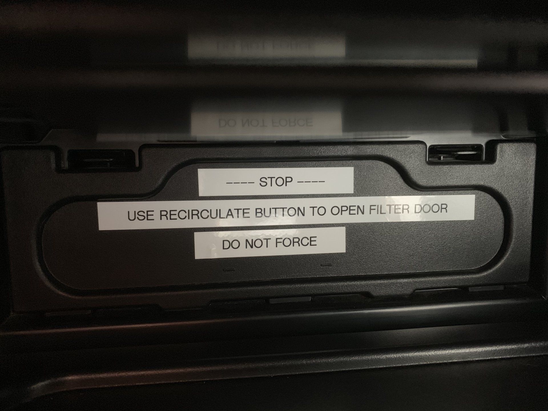

Wasn’t someone making signs for that and selling them?
The threads on this topic had me nervous. So I did this before my appointment this morning. Thanks for the heads up!
Might already be in this thread but another option is any time you go in for service, lock your glove box and keep the key blade with you.
Mine has been jacked up by service departments TWICE....fortunately it was repairable. As I typically change my own filters I’ve started locking the glove box whenever someone else is working on my truck, just as @bloc suggested.
