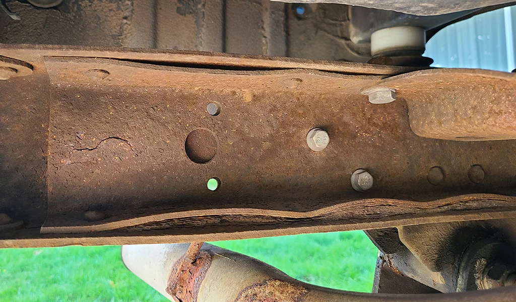

While I was under my 62 on Sunday draining my tank to mess with the fuel levels, I saw my C channels are looking really rough. This side is the worst of the two, but the right hand side isn't much better.

If the consensus is that these need to be done, I'll get a set and with any luck I can pull off the extended range fuel tank next spring (wanted to this spring but couldn't make it happen financially) and take care of the C channels and tank swap at the same time, hopefully making my life a little easier. Regardless, I am NOT looking forward to grinding those rivets out....

They look better then mine did before I decided to box them in so I could ignore them forever

interesting...did you remove the old ones or just treat the s**t out of them and then Cask of Amontillado them in?

Just left them in there.

Any clearance issues when boxing? What size plate? I was thinking of going this route as well.
I used 3/16". My only reason to box the frame back there was so I could put my frame-side shackle bushing thru the frame. Should be some pics in my build thread. look around April/may 2018

Cut an x in the rivet head with a disc, chisel off the four pieces of the river head then use a steel drift and sledge to punch them out through . Just be careful when they let go they can shoot.
Or be boring and use an air chisel
It’s not as hard as some people make it seem

An air chisel is by far the easiest and cleanest way to remove the rivets. Its worth buying to tool for the job. Turns it into only a hour or two job and is much cleaner. Plus it won't grind away part of the frame you're trying to keep. there are still welds to grind at the front and on the rear corners.
