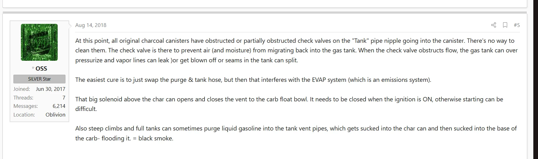

Think I might have found something.... I had a full tank when I started the climb....
Frank

The link I posted contains a post by OSS that mentions that steep climbs on a full tank can cause this and I was making a steep climb when most of the issues occured.
