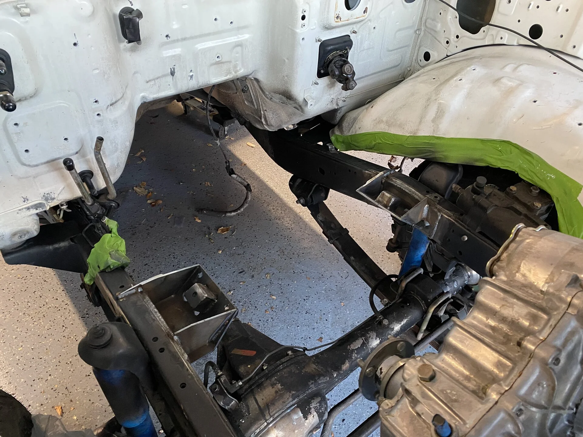

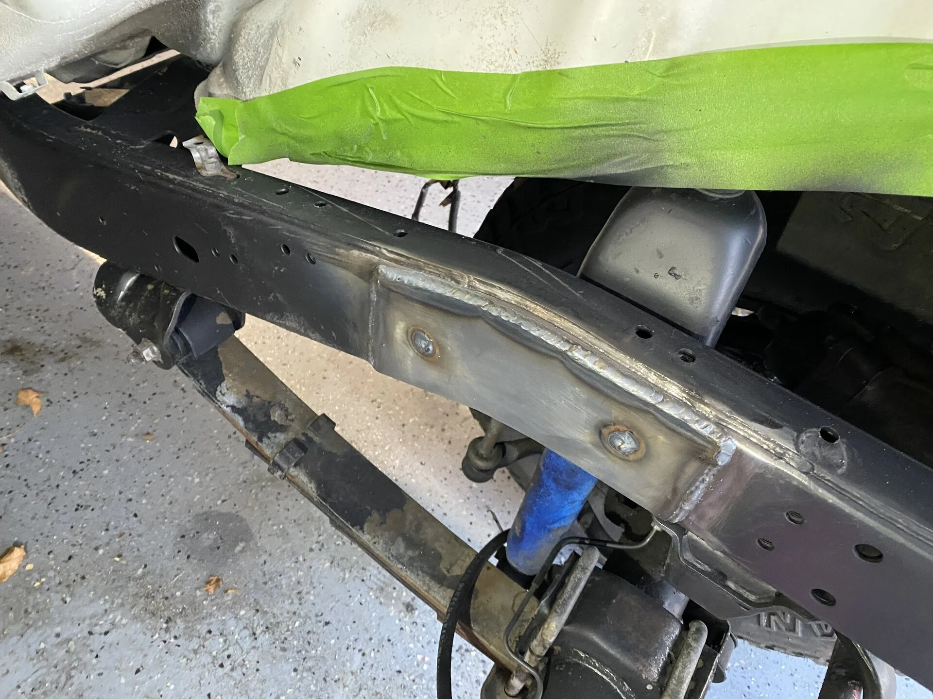

Trying this stuff out based on some interesting videos and such. It lays down amazing. painting the insides of the plates where it was bare metal. In theory this stuff is weld through, but I’ll clean it bare before burning it in
View attachment 3522454View attachment 3522455
Its weld through in the sense that it will strike an arc. The weld will not be pretty though. Youre doing the right thing welding it bare metal haha
I think I remembered how to MIG maybe halfway through getting the plates on…. eh they are hot and worked fine. Added two rosette welds cause my engineer brain said to. Hopefully tomorrow will get the engine placement finalized and mounts burned in.

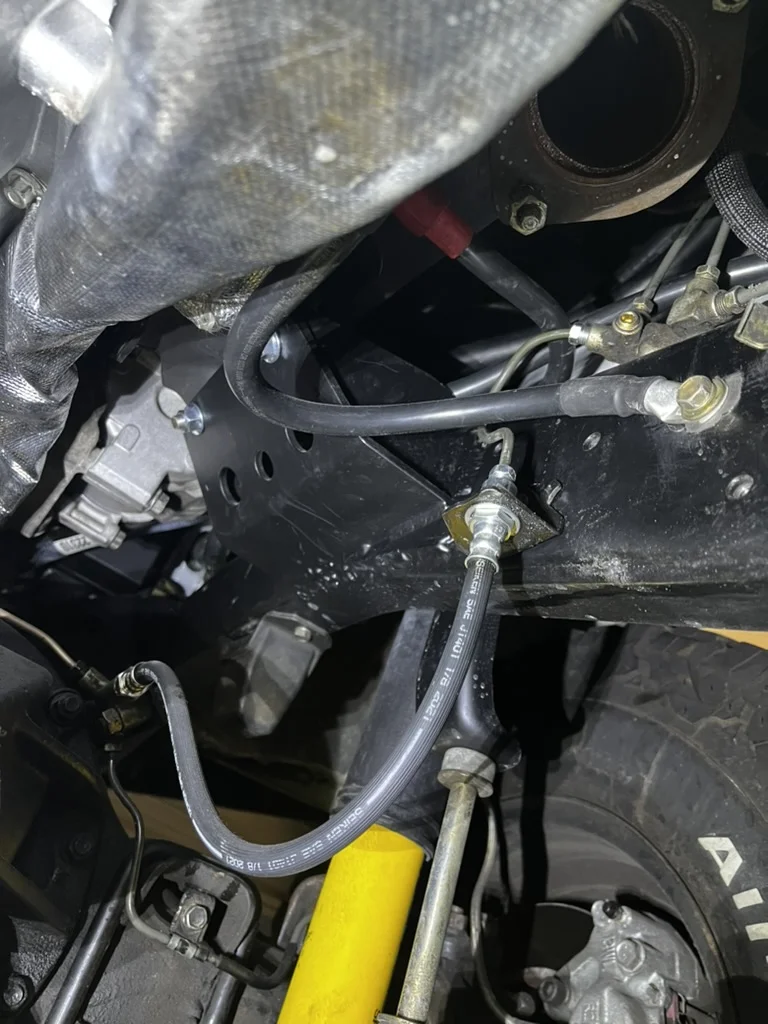

I was going to ask how you do the delete? Do you need full new hard lines? theres a lot going on back in front of the fuel tank line-wise
I ended up deleting my LSPV as well. Here are a few pics of what I ended up with. Once you get under there and look around it will make sense. I added a manual wildwood proportioning valve up near my master cylinder. Pretty sure @dbbowen told me that he modified an LSPV to be always at a set front/rear distribution, too. Can't remember exactly.
This is looking towards the rear passenger drum/frame rail from in front of the rear axle.
Looking up at the capped tee and new hard line
Oh yeah, on my firstgen 4runner I cut the rod to be about 6 inches to a foot off of the LSPV and disconnected the side from the axle and threw it away. I used an adjustable turnbuckle with an eyelet on one end and a jaw on the other to make it adjustable. I basically drilled a hole in the floorboard of my truck, put a rivnut in there and bolted in an eyelet. I attached the jaw end to the eyelet attached to the floor of the truck, and then i put the rod in the eyelet and welded it so it wouldnt move.
Once thats done you can just turn the body of the turnbuckle to adjust how much bias goes to the front or the rear of your brakes. When you find a good adjustment you like, just put some loctite on the threads of the turnbuckle or tack weld it and it will never change ever. All together it cost me like $10
The one i used was similar to the second one from the left, just like way way way smaller

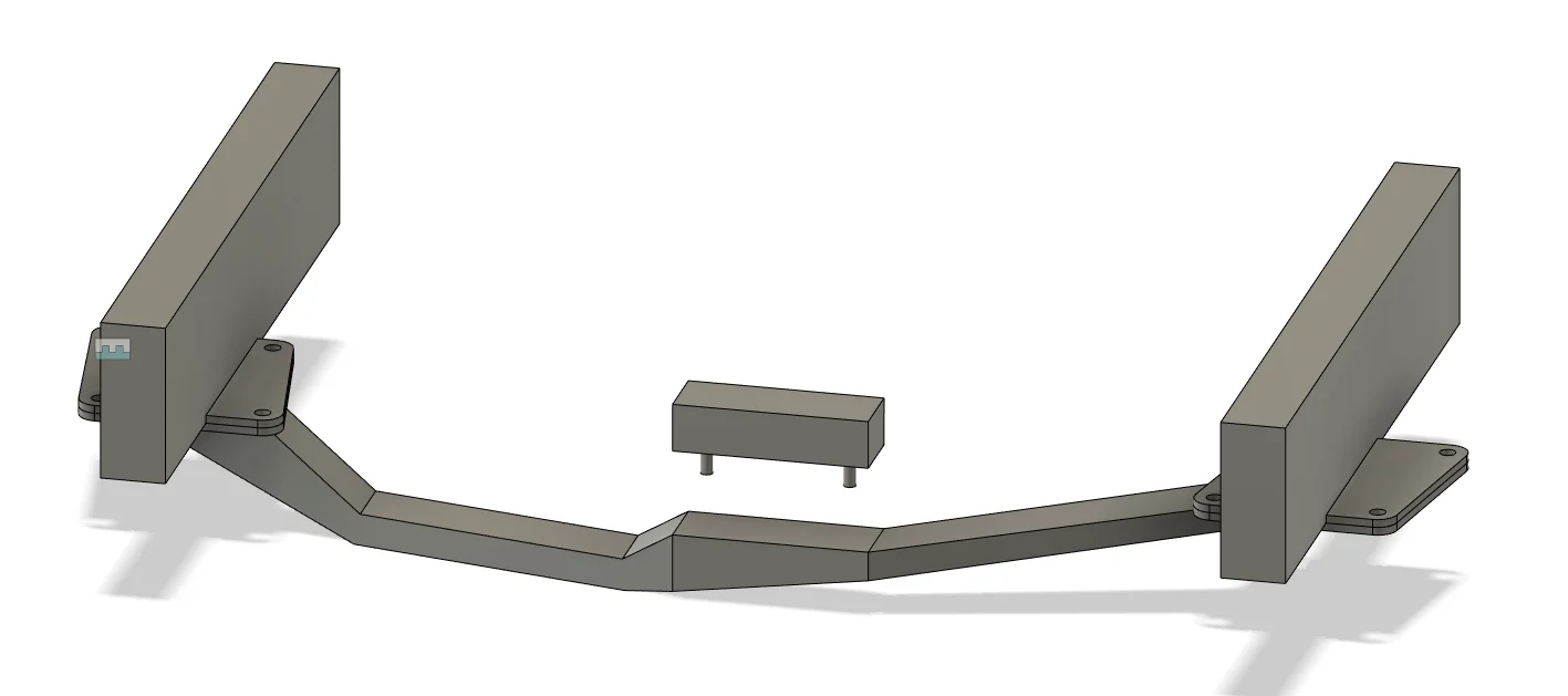

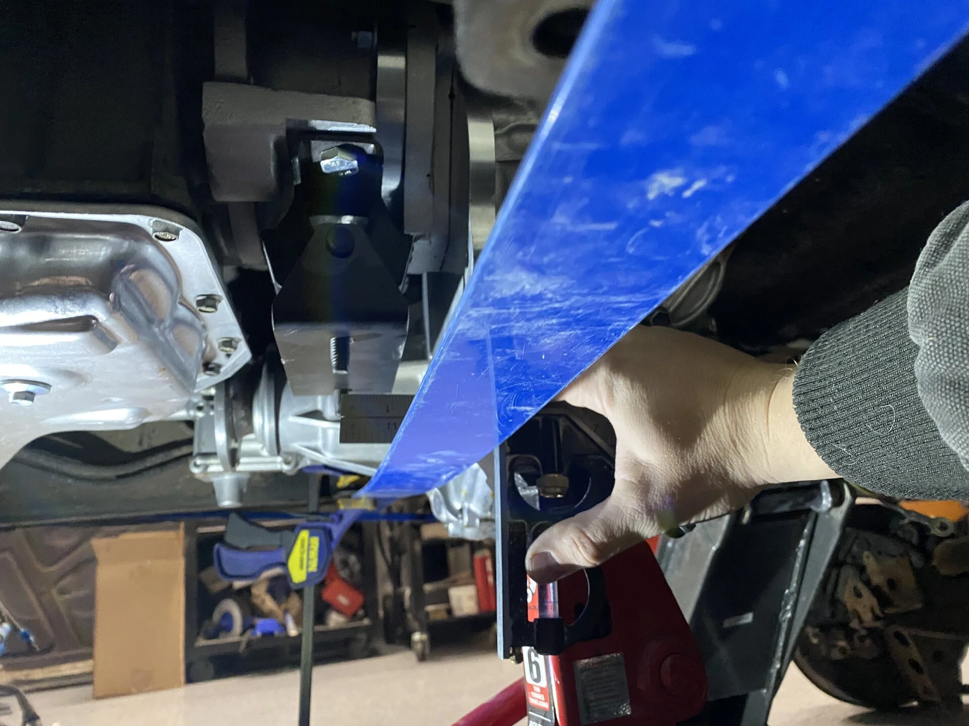

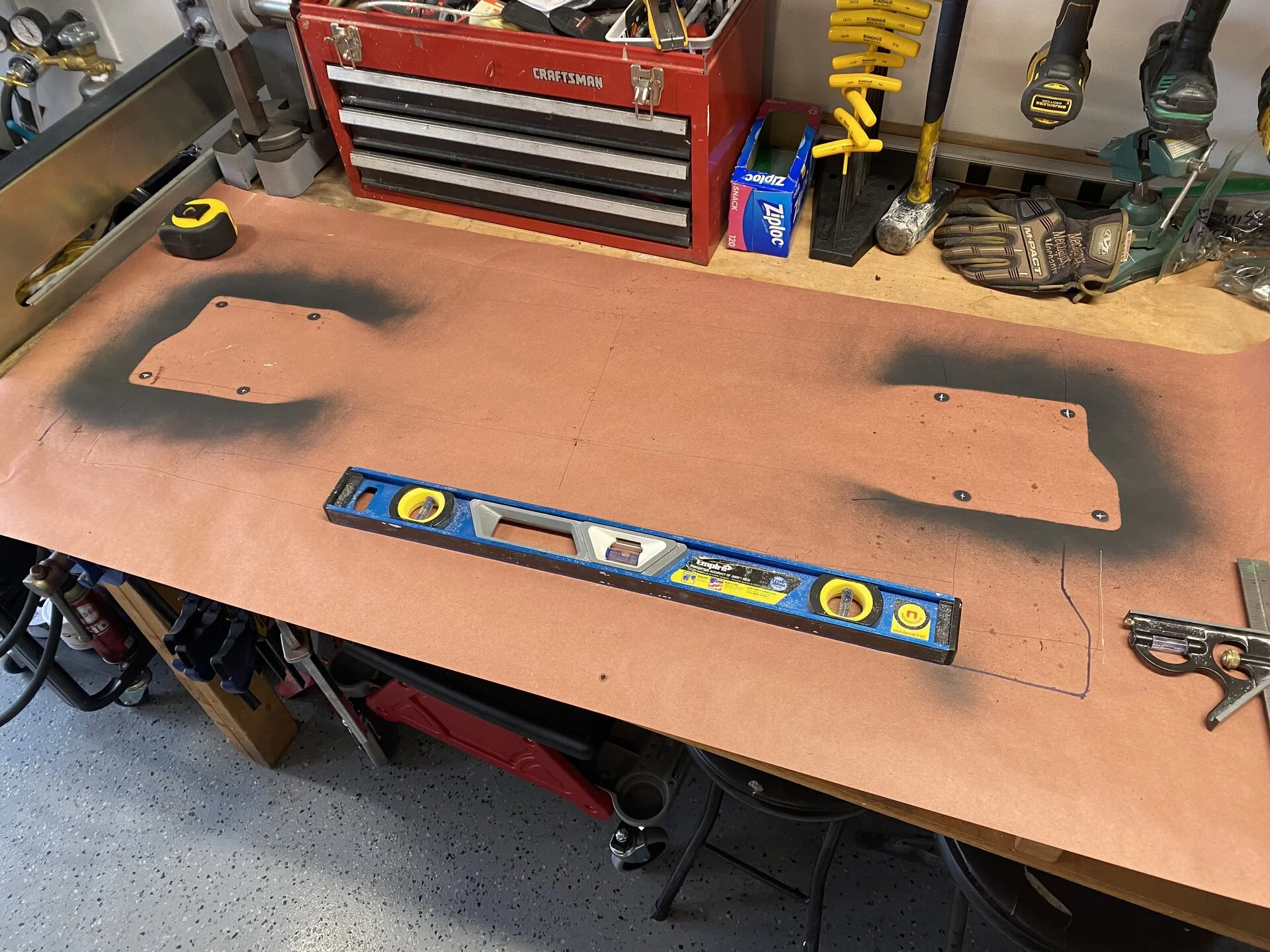

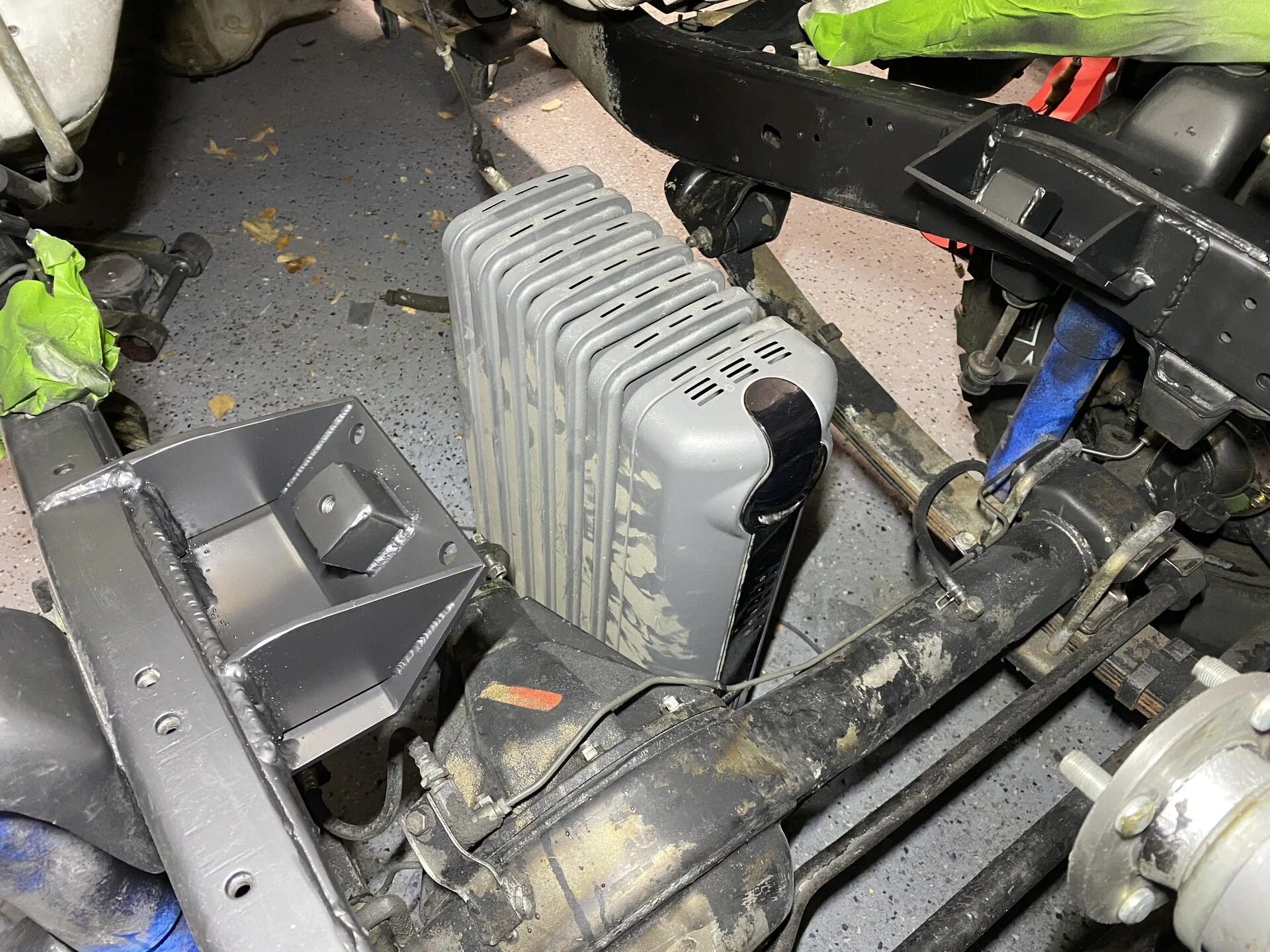

Why not just use the stock crossmember with the plates I already make? Accomplishes the same thing and will be way more slimmer.
Also, what’s with the boxed-in center tabs on the motor mounts?
I just like designing stuff. This one drops the same as the factory one. I may end up bailing on the idea but this is what I do in my day job. I'm also brain storming tie-ins for skid plates, etc also.
The box-in was me using an excuse to add minor stiffness where its not even needed to practice my terrible welding skills ;)

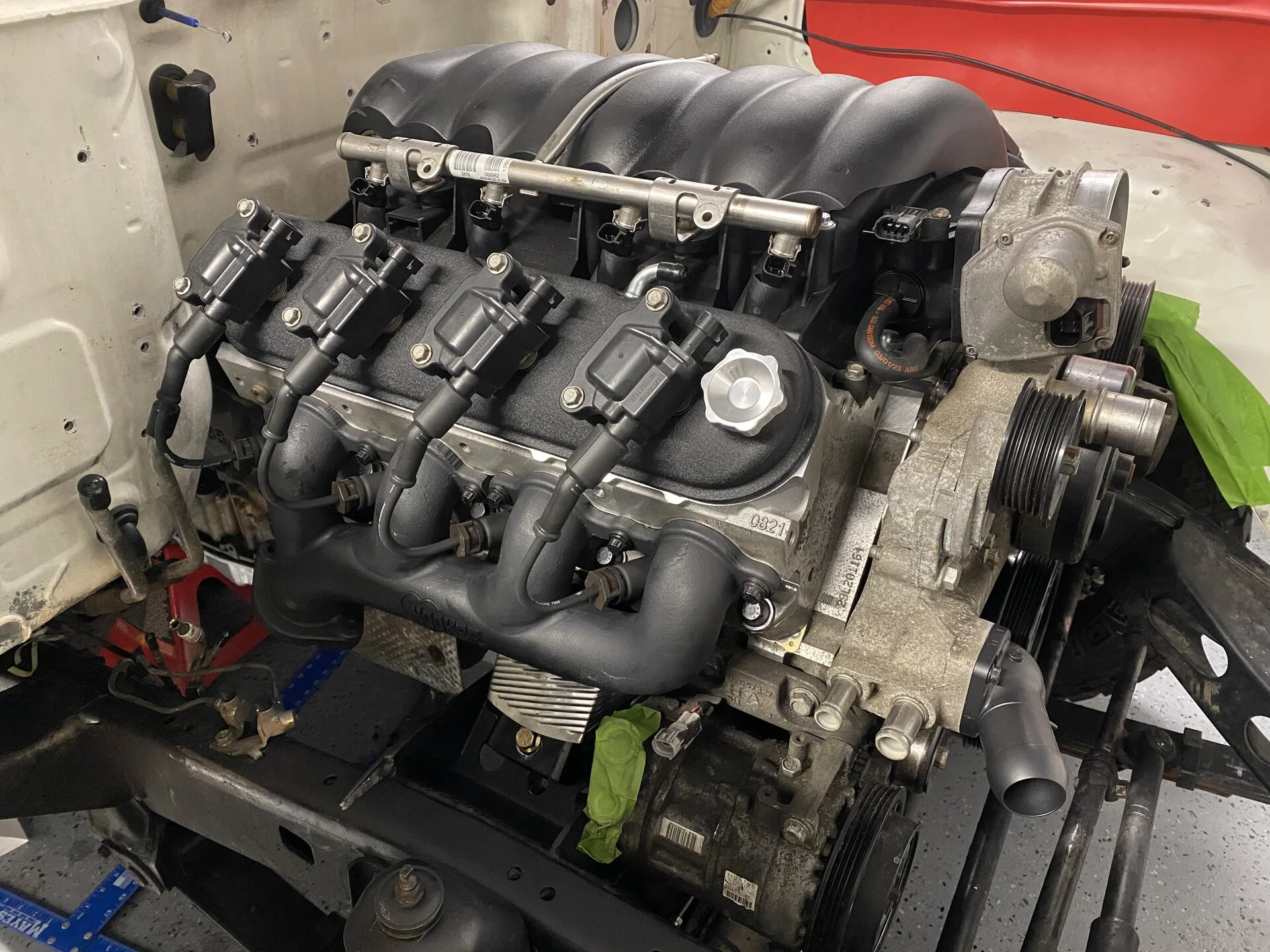

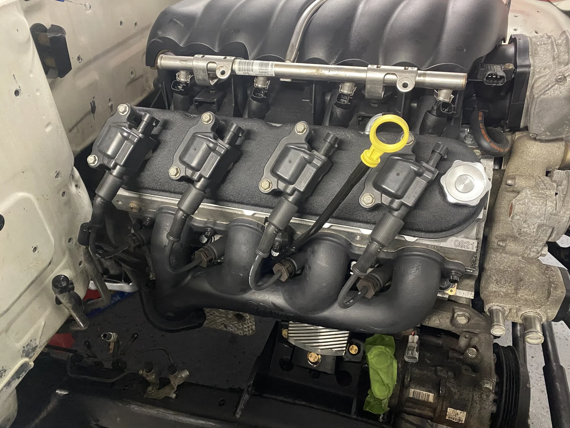

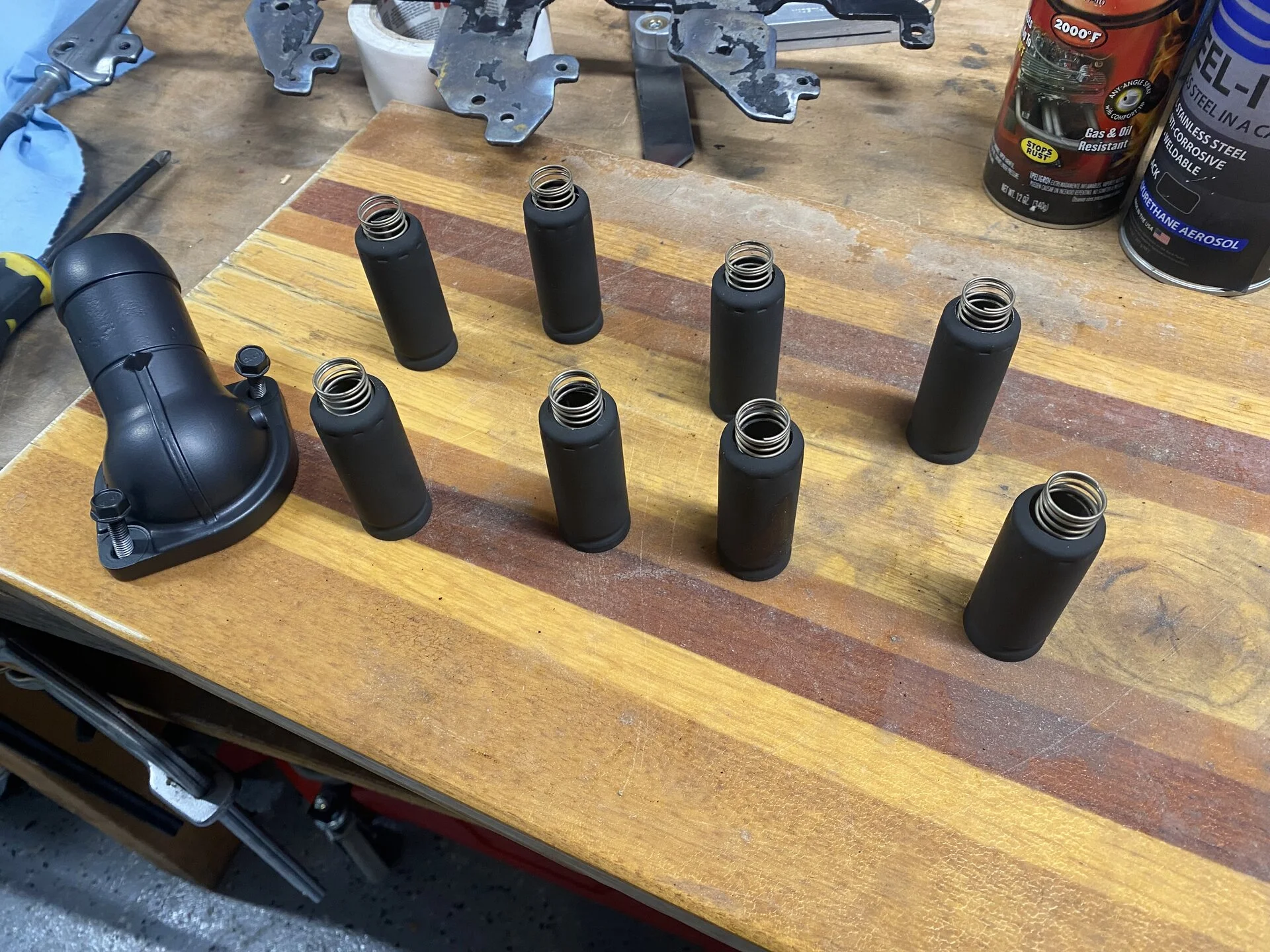

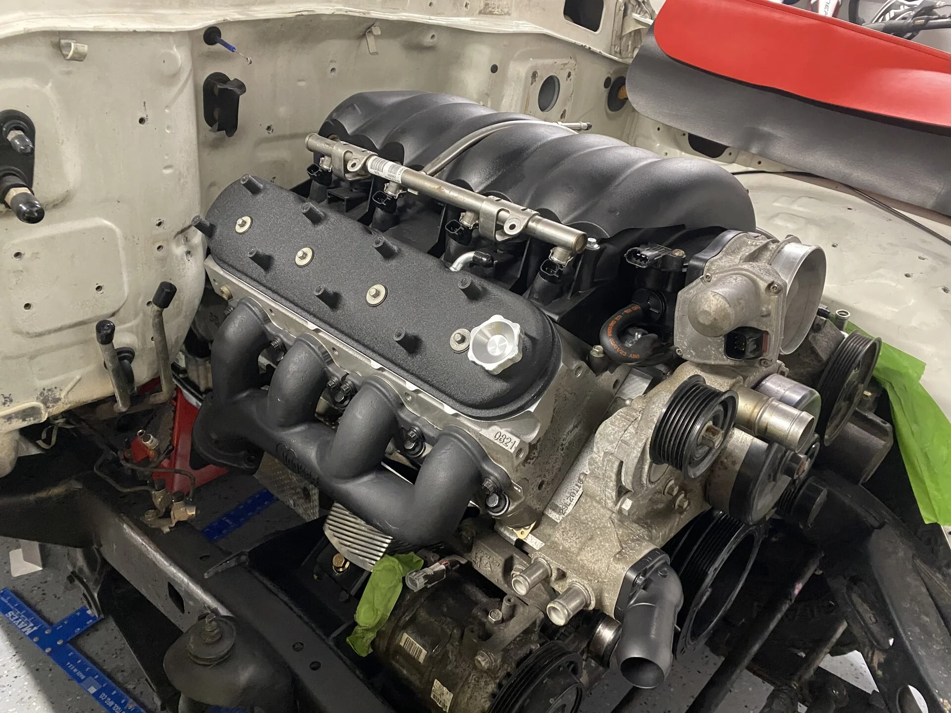

Summit, but probably should have gone Holley. I didnt like that the powdercoat on the Summit was in the oring groove. Maybe Holley doesnt do that. If it leaks I'll worry about it then though
It’s still in the groove on the holley. Ive had zero issues with it.

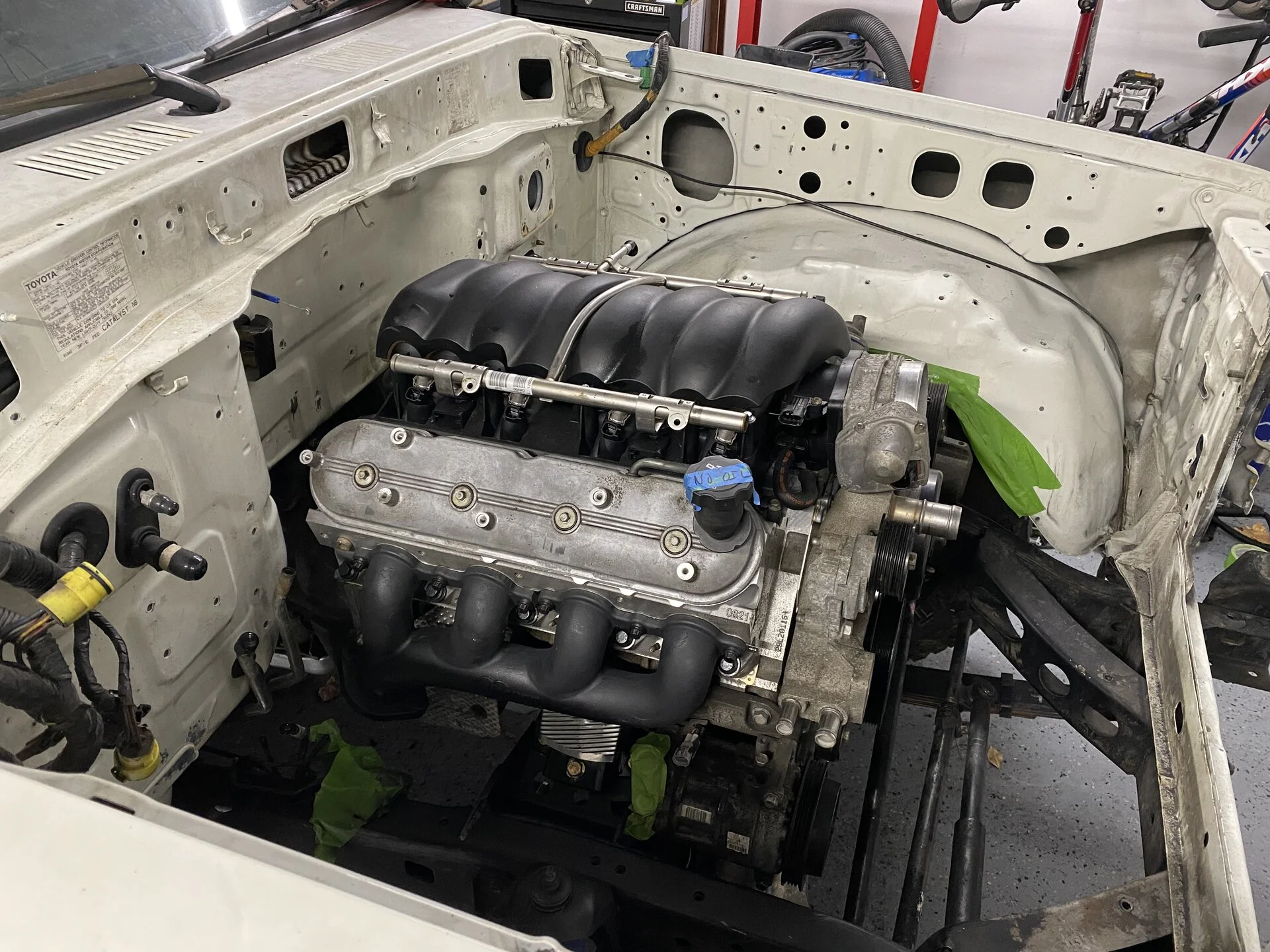

I’m actively ignoring electrical so I’m painting unnecessary things
And was then tired of old valve covers and brackets being dirty enough that I just bought some
Those look exactly like the holley ones I have too..
All black everything under the hood. Its the only way. I was trying to find someone to Black anodize my radiator and shroud but no one locally in Memphis could do it because it was too big
All black everything under the hood. It’s the only way. I was trying to find someone to Black anodize my radiator and shroud but no one locally in Memphis could do it because it was too big
100% anything I can reasonably get to bare metal and cleaned up gets prepped and painted. It’s the only way
Thats lookin tidy. I like the mechanical look of leaving the coil packs exposed. depending on which wire harness you bought. wiring is not that bad. more or less just plug and play.
Figured out that with this pan kit you have to knock out a freeze plug from inside the oil pan. So that came off and now we have oil level.

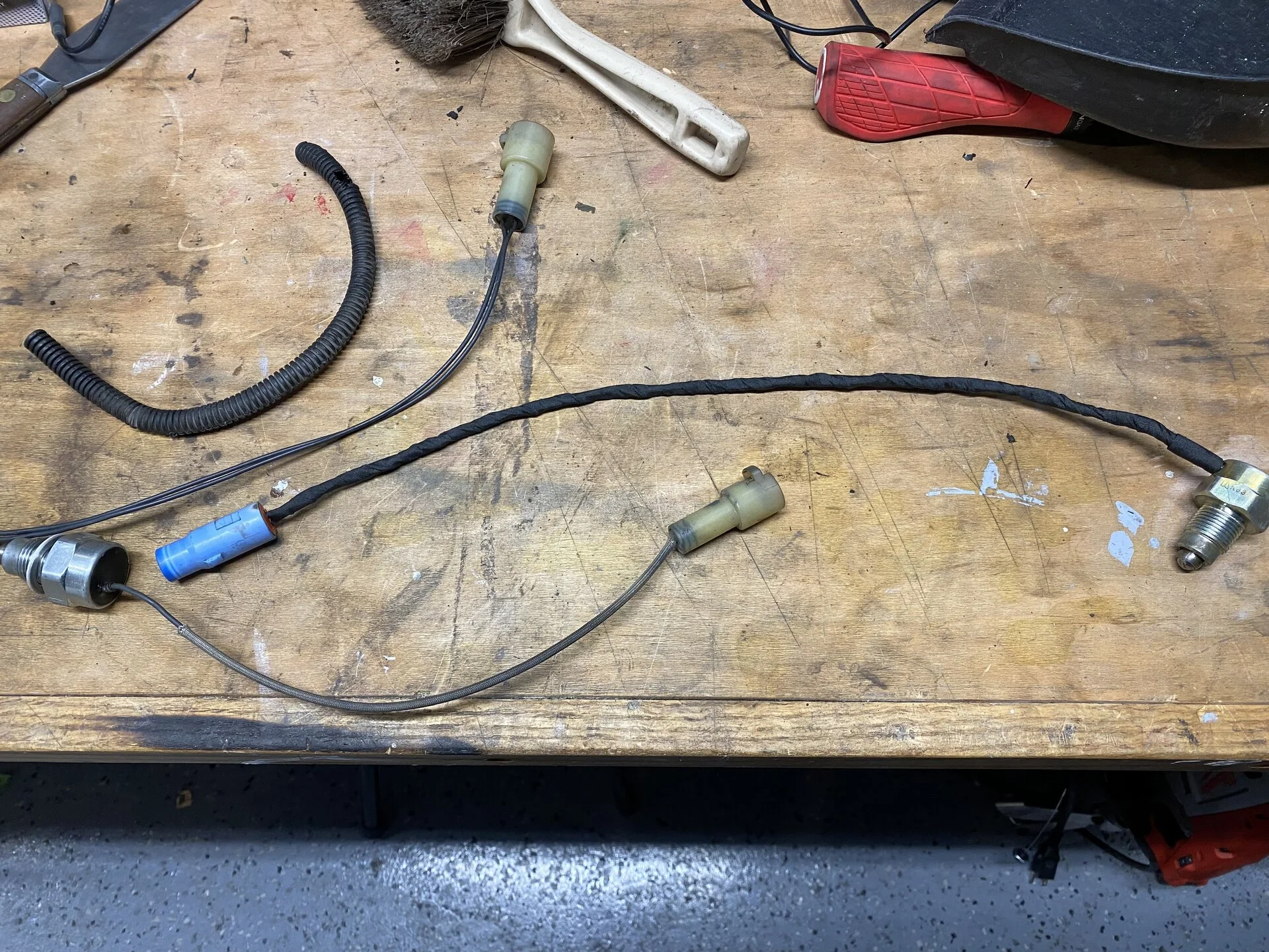

Dipping my toes into electrical. Cleaning and re wrapping the t case sensors in Tesa tape
