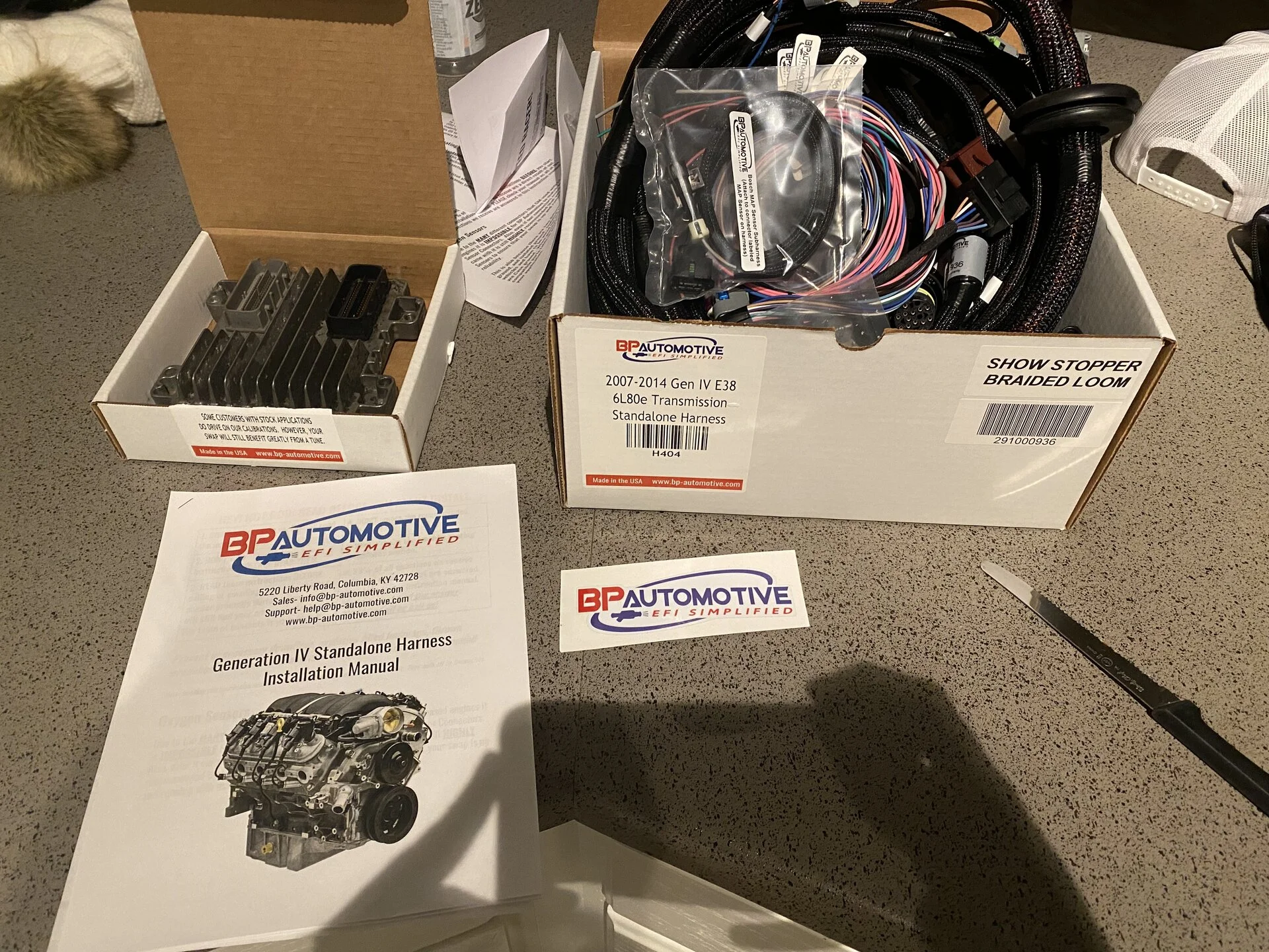

Went with BP based on feedback from a a few people. plus they had a nice Black Friday discount. Base program put on the TCM and ECM

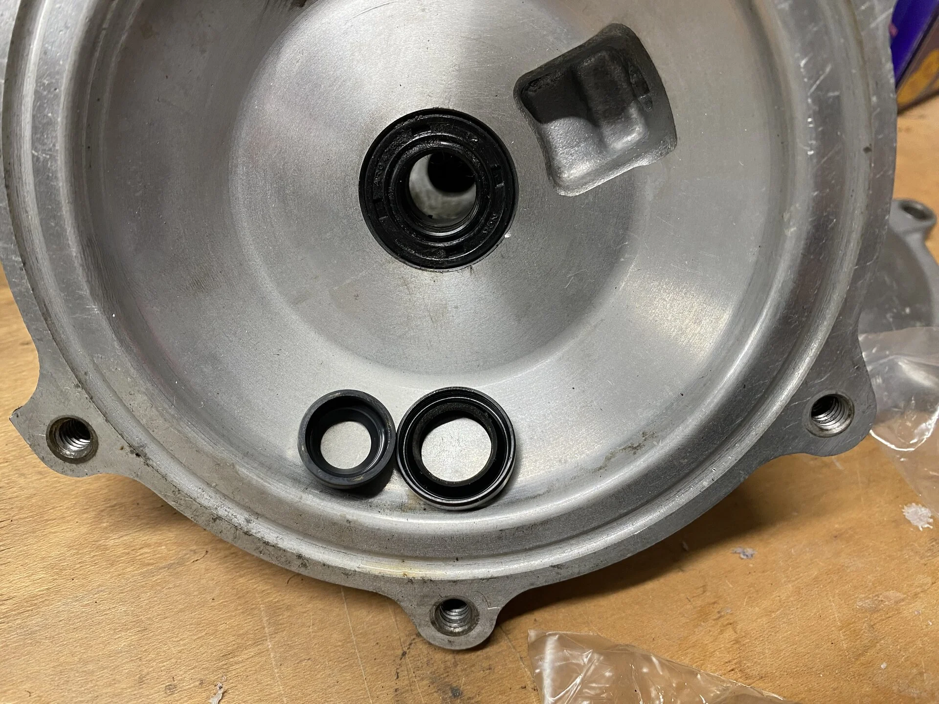

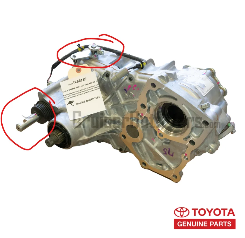

@cruisermatt question on the 62 Tcase parts. Is this seal part of the kit normally? i have one that seems similar but not exactly the same. I think it’s for the shifter shaft

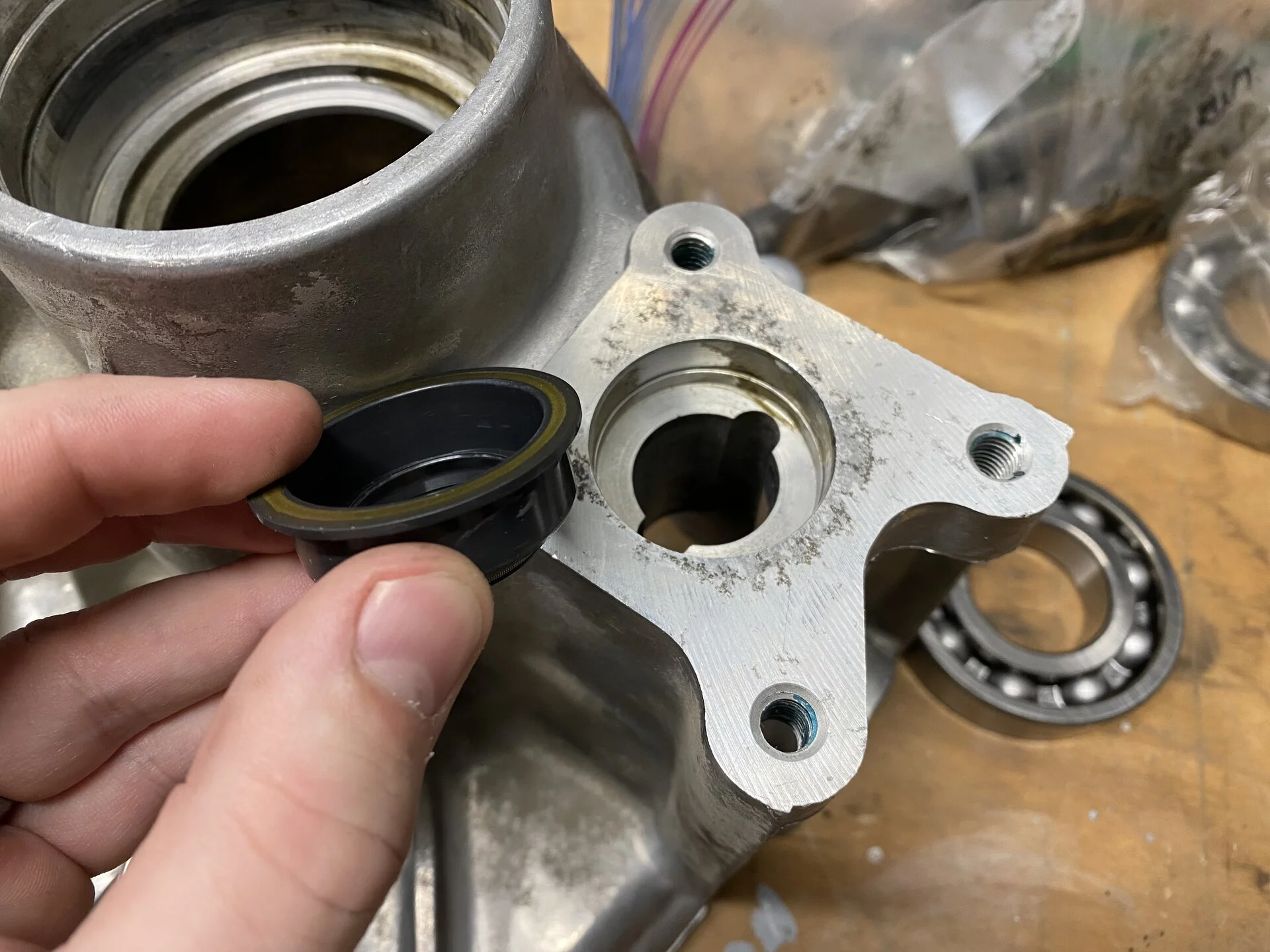

This one too? The flange seems odd
I can’t find a ton of info where people took these apart, maybe I should have left it alone ha!
@cruiseroutfit question on the 62 Tcase parts. Is this seal part of the kit normally? i have one that seems similar but not exactly the same. I think it’s for the shifter shaft

The round one with the gold ring in the second photo should not sit flush, it has a lip and you tuck a rubber dust boot unrer the lip if i remember correctly. The rod that goes through the boot is for the 2wd-4wd lever arm and has a little square notch cut out of it.
I believe in the first photo the smaller one is for your H-N-L rod thing that goes down into the transfer case on one end and attaches to your shifter arm. The smaller one im not sure of.
That being said, this is all for a manual shift tcase. Ive never rebuilt a vacuum shift one
Remember you bought the transfer case kit from me, not CruiserOutfitters. The first two are for H/N/L rod and inside the speedo bullet. The seal in your second pic doesn’t get used for vacuum shift.

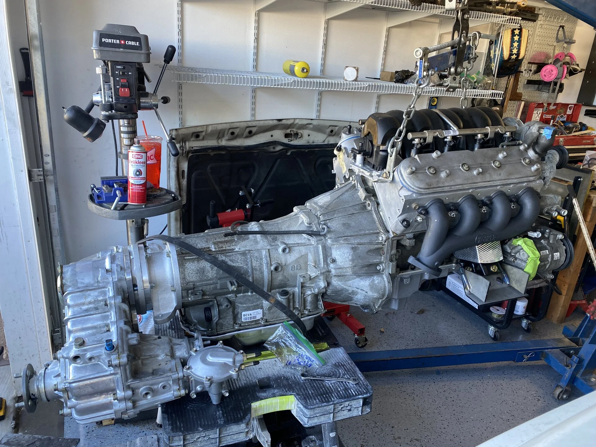

Looks good, why is the H/N/L lever missing?

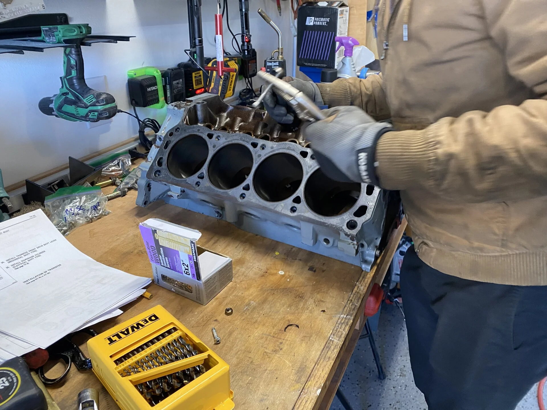

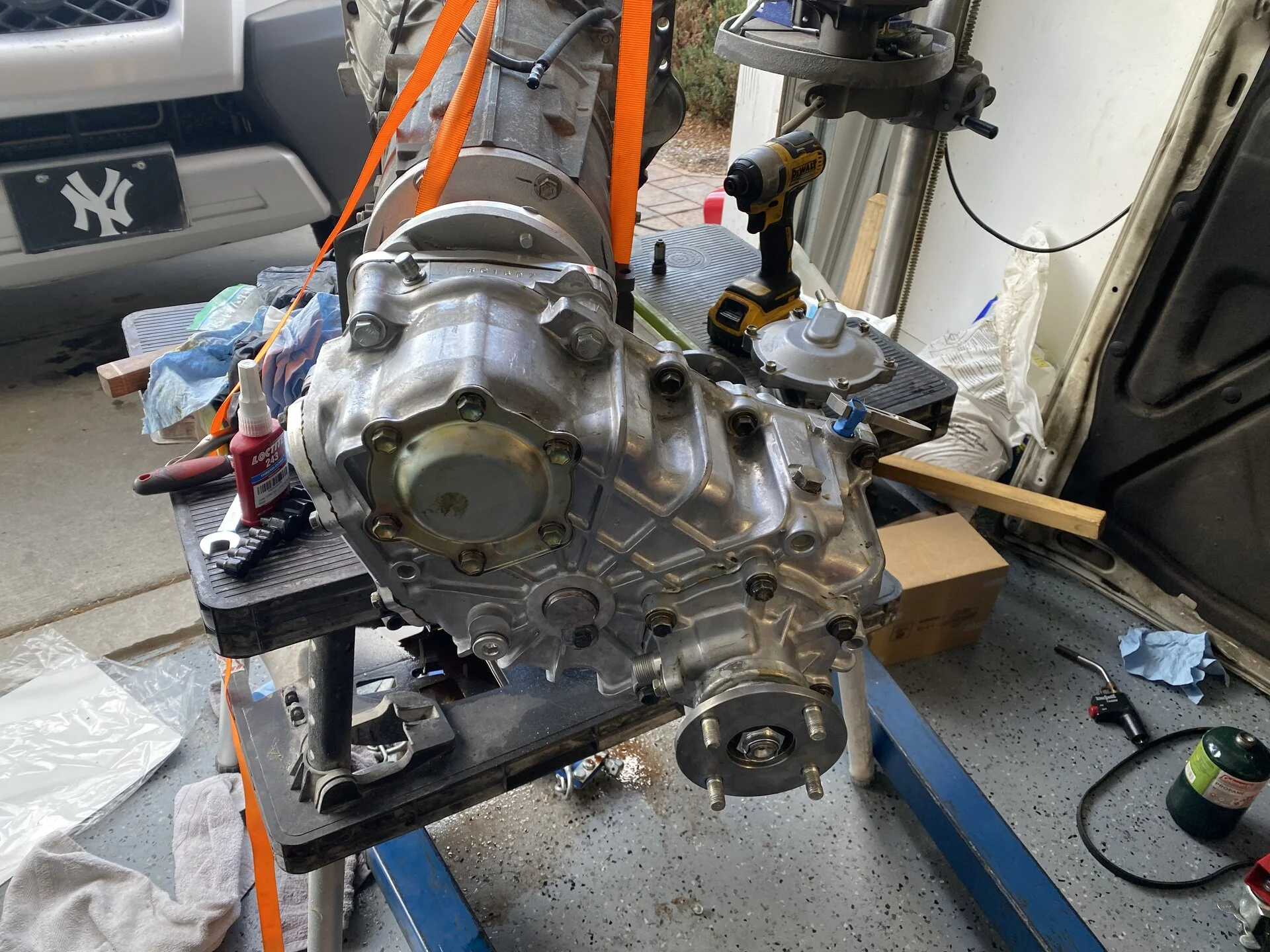

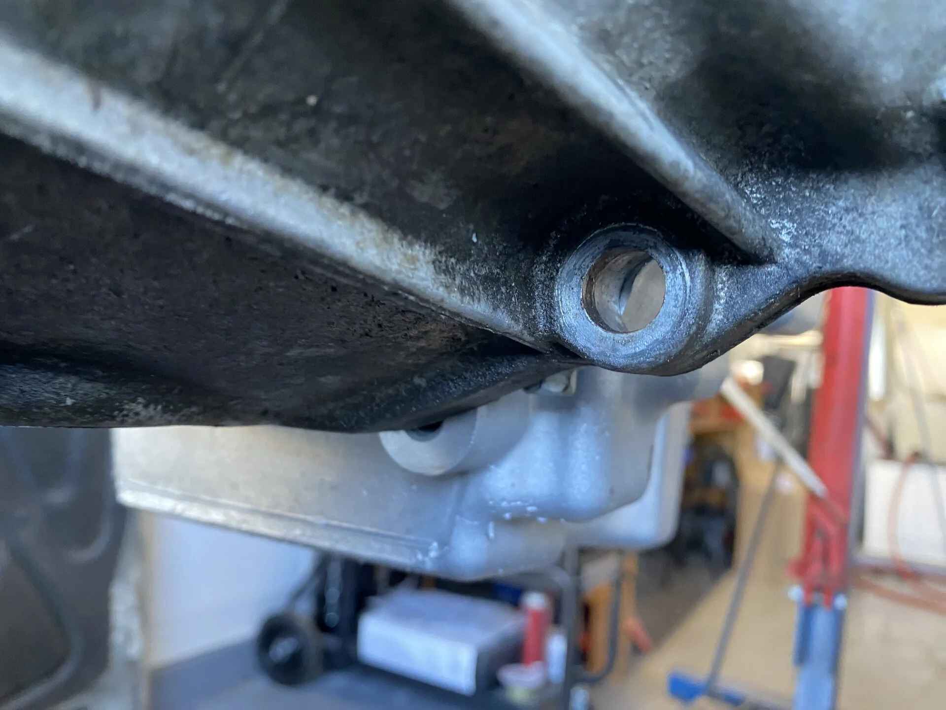

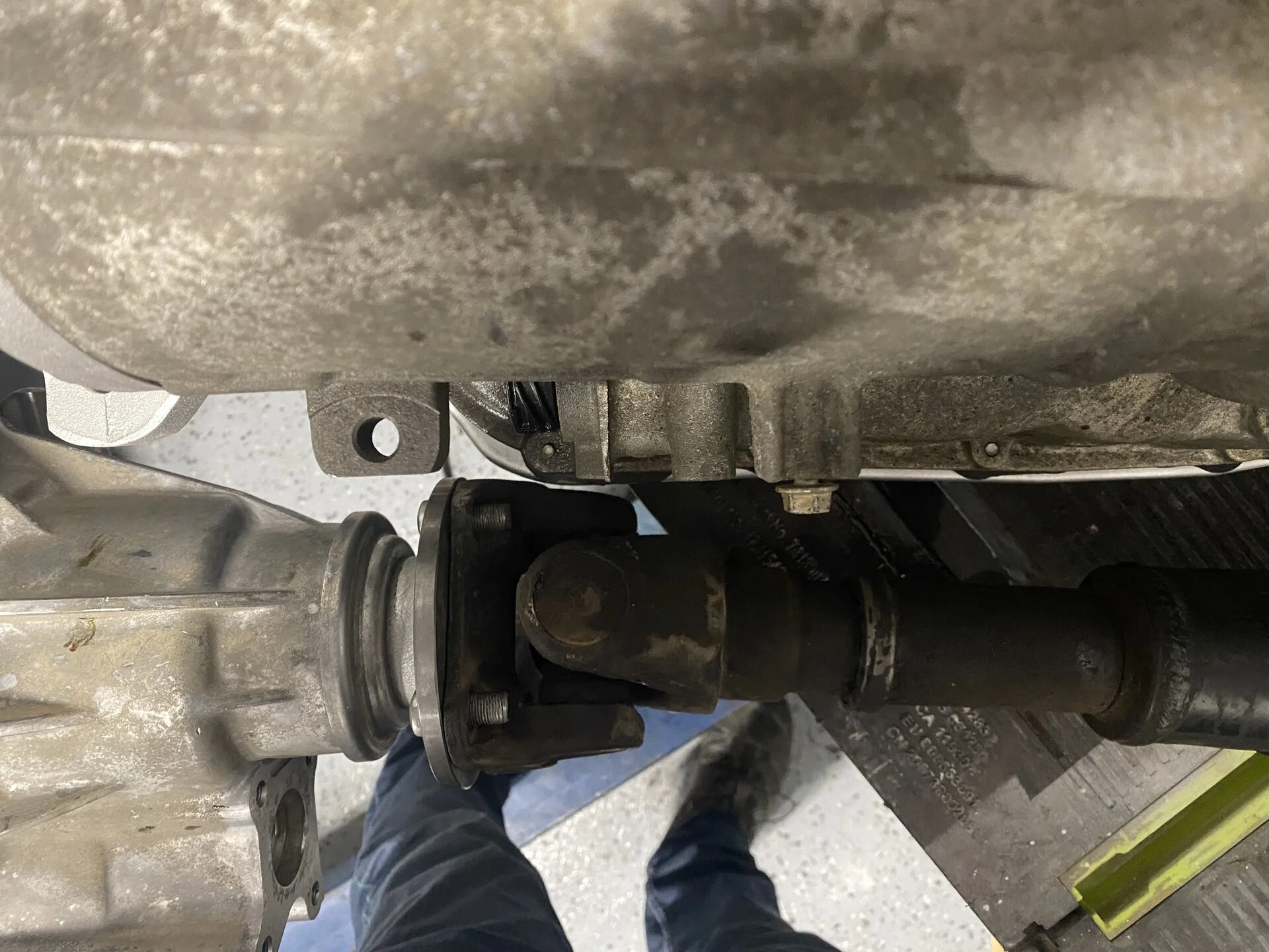

Helped my buddy pull some freeze plugs out of his 302 block then got the drivetrain assembled for test fit. Only one bell housing bolt doesn’t line up with the H3 pan. Were still gonna send it

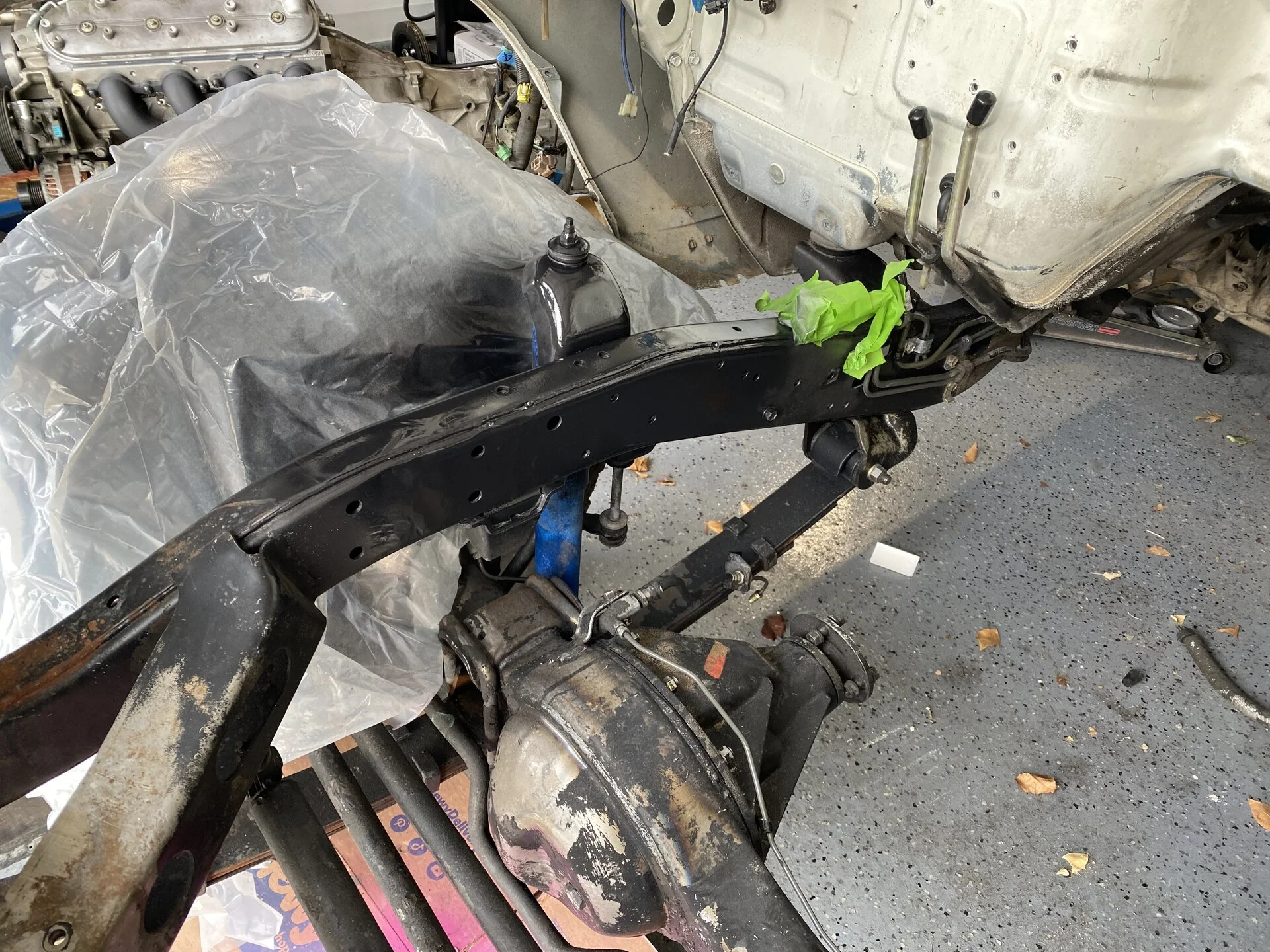

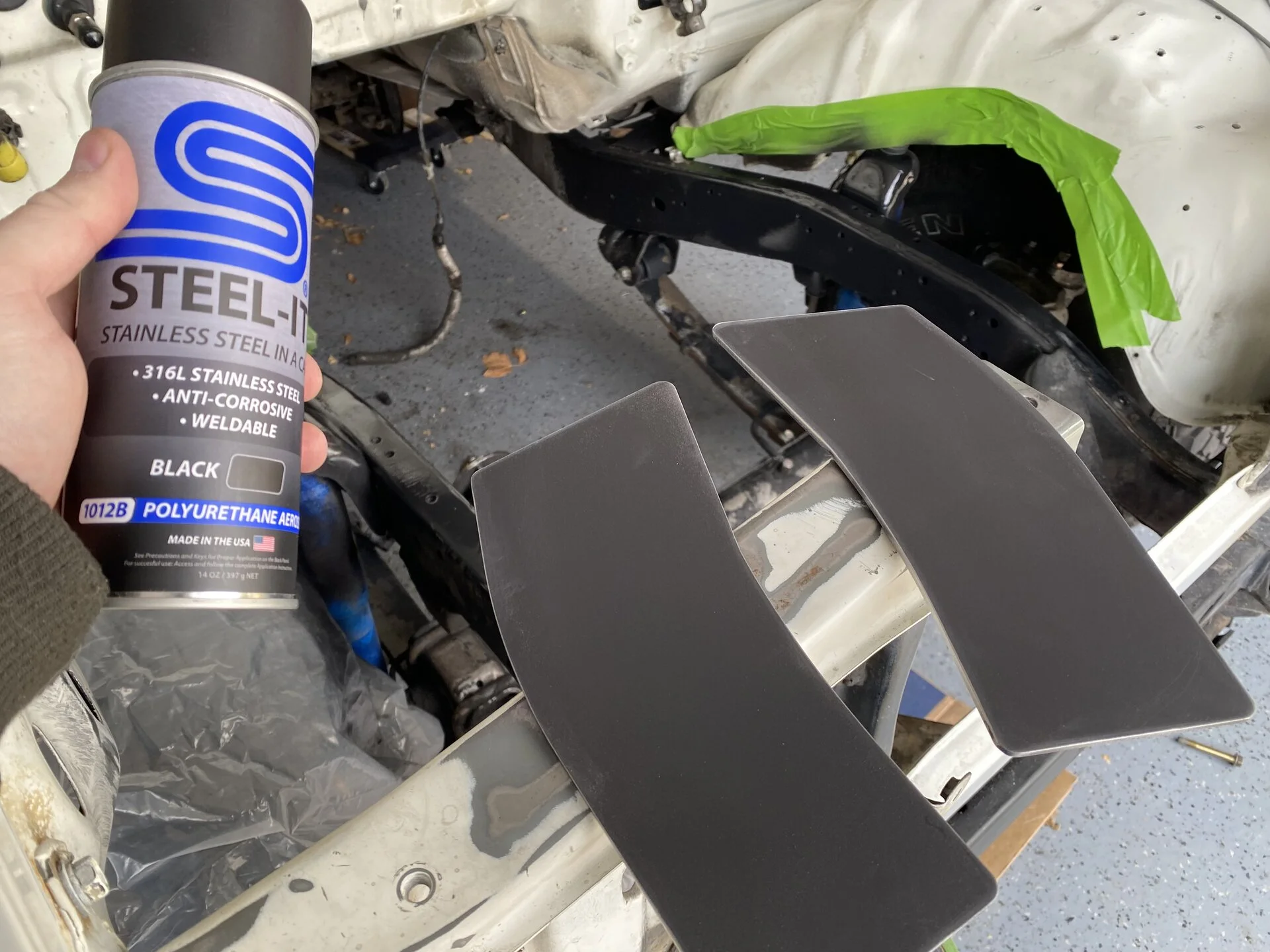

Dont forget the frame plates.

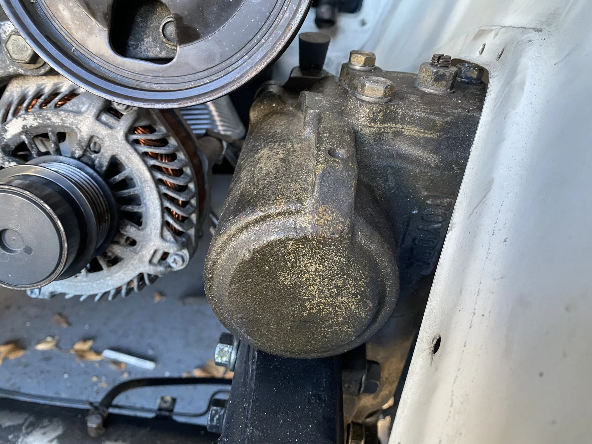

You’ll need to make a new hardline from the Tee to the front axle soft line clip. Usually we just weld that clip to the frame in front of the motor mount.
Good time to delete LSPV as well.
