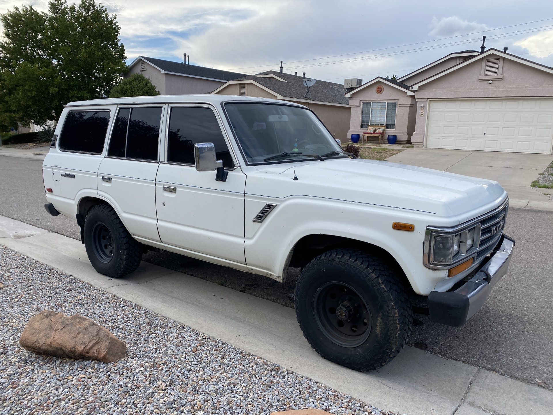

Hey All,
Decided to start a build thread on my FJ62. Picked this one up last week for a good price, 250k on the dash.
This is the V8 Swap build for "Hoss"
Good/Great:
  • Body has very little rust, just a few spots under back window and front rock chips
  • Body has no damage, so little to no bodywork anticipated.
  • Frame, almost no rust, little bit of surface rust on the rear leaf springs.
  • Rides really good
Bad/Needs work:
  • Confirmed the emissions guy wont even test it, smokes a tiny bit and smells.
  • Rear main leaks, and front too
  • Auto trans doesnt like to shift well, have to let off the throttle to shift up. I tried adjusting the kick down cable and the "party trick". Still sucks
  • Interior upholstery and plastics need help, as expected

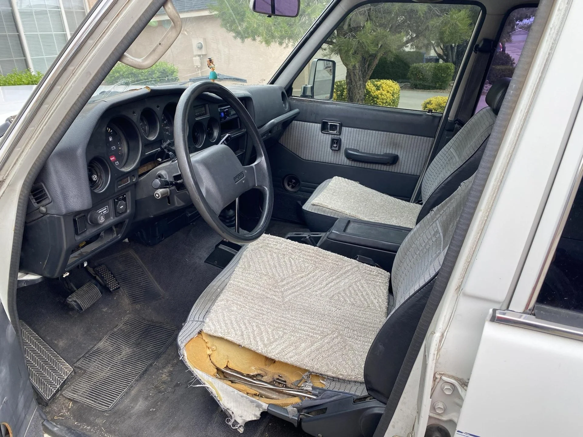

    • Seat first, half the foam is gone
  • Shifter needs replacement handle and its very loose
    • Fixed as below
  • Speedometer doesnt work after last transmission service a year ago
Expected:
  • Brakes are ok, feels like my old jeep
  • Steering is loose ish, again feels like my old jeep

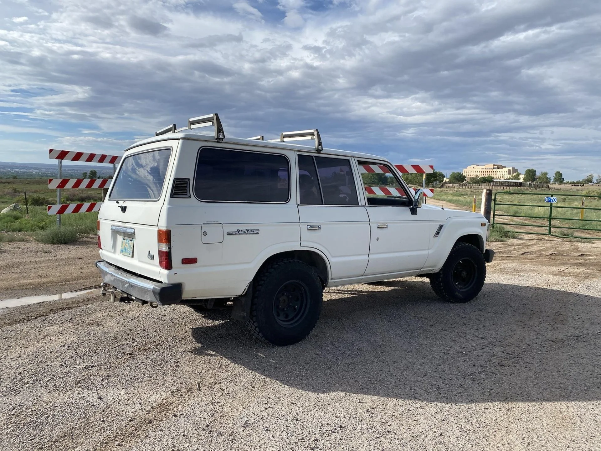

First order of business, removing the crusty ski rack.

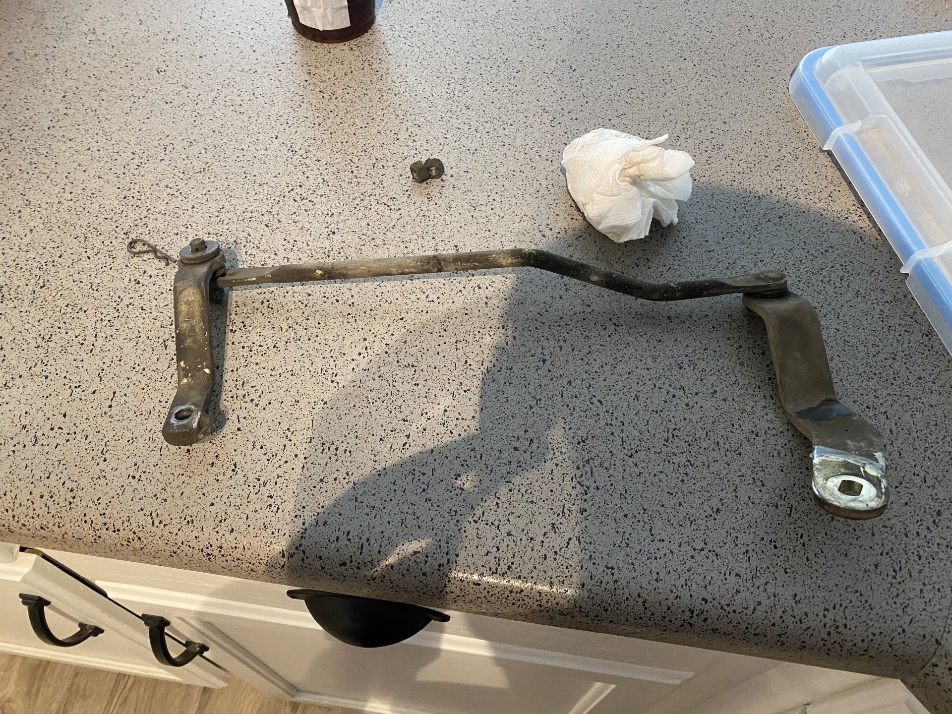

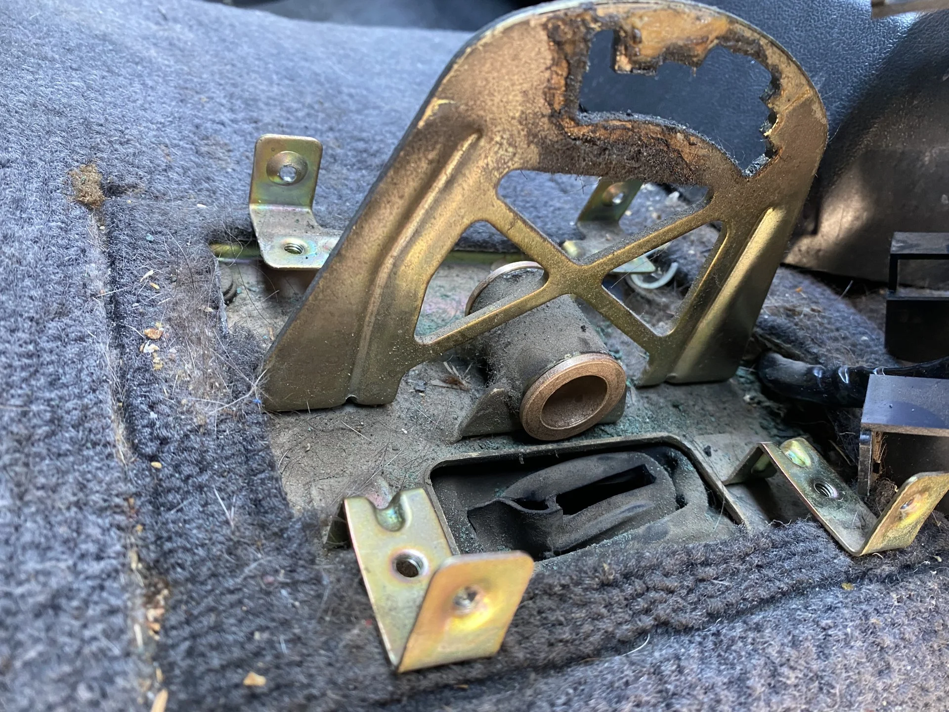

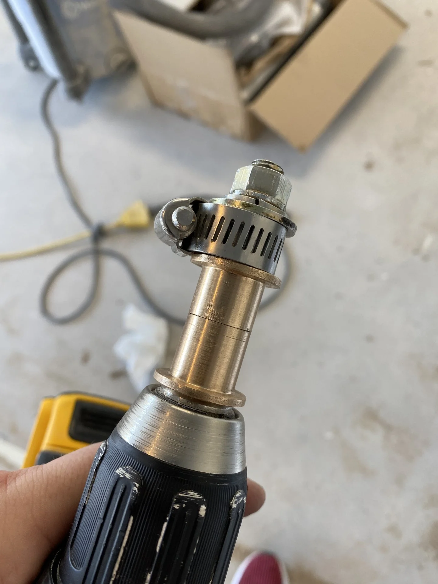

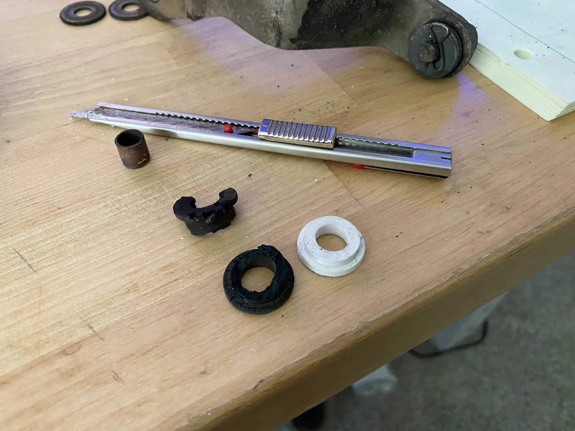

Next was the sloppy transmission shifter. (if anyone has a source for a T-handle i would greatly appreciate it.
Ended up using the Hillman 882995 bushings. Had to lightly file the pivot shaft to get it to fit, then heavily file the OD of the bushings to get them in the truck.
Note you likely will have to cut them a little
Shorter also to sit flush. Cost about $13
Also went underneath and the bushings were shot there also

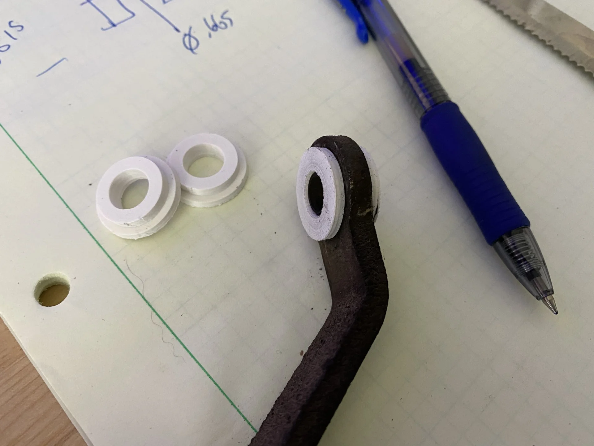

3d printed some out of ASA and that helped some, still some slop in the D holes, but I don’t think that’s fixable without the welded fix that’s on here.
Last pic of the installed bushing
Remember kids, when 3d printing, perimeter thickness trumps fill % every time.

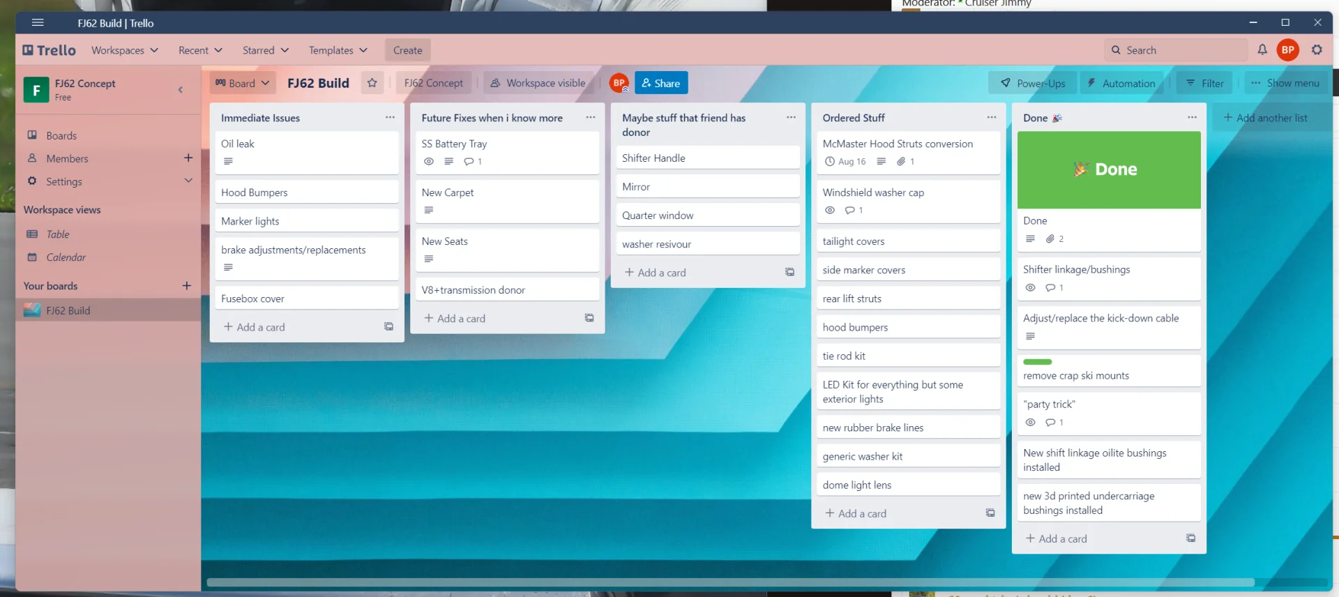

Lastly, I have been using a tracker app for tracking my progress. Trello breaking up all the stuff into sections. Seems to work well

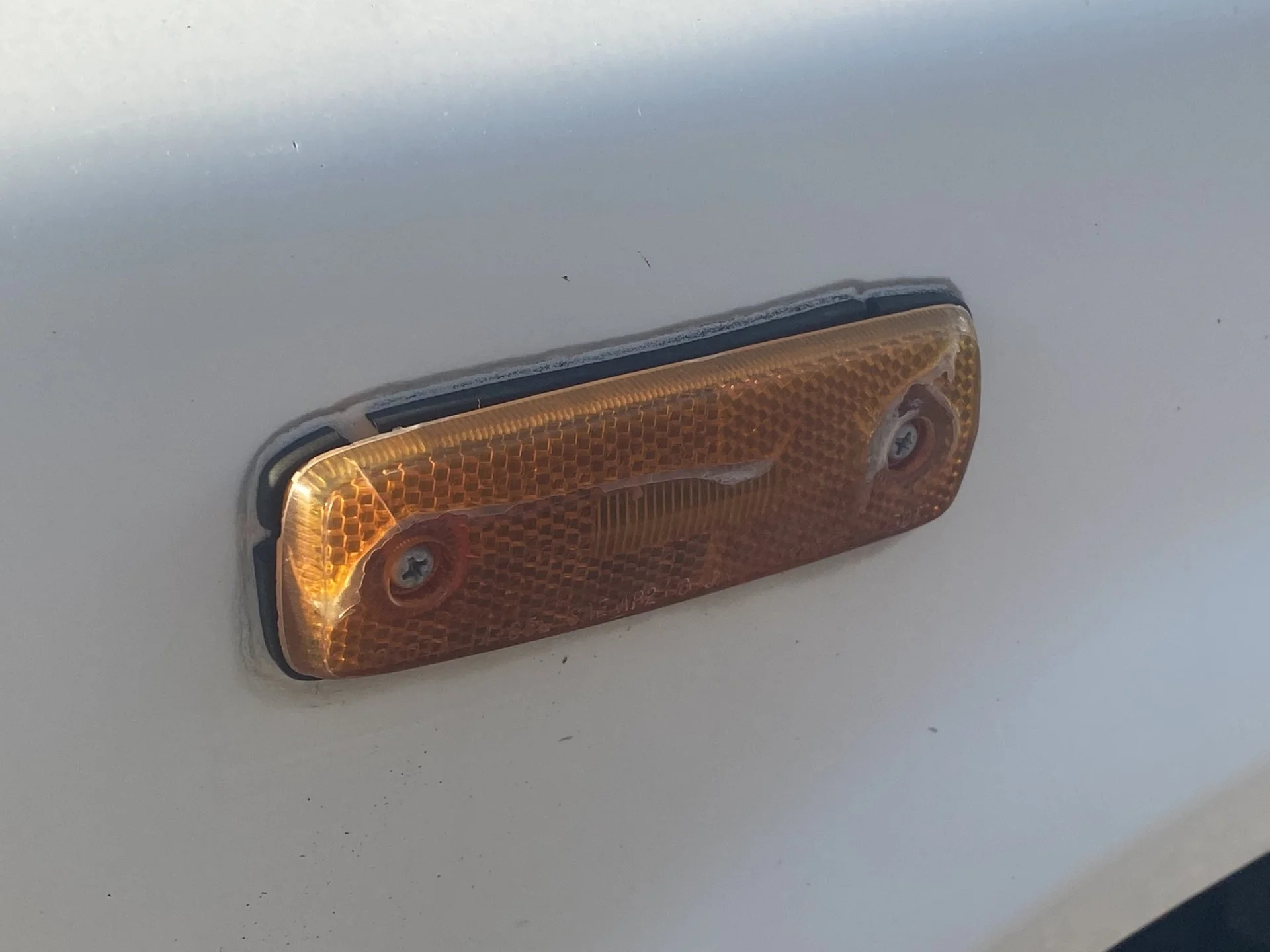

Tiny update. Marker lamps were cracked and broken, new ones have arrived. I’ll probably wait till the body is painted to install? Not sure yet

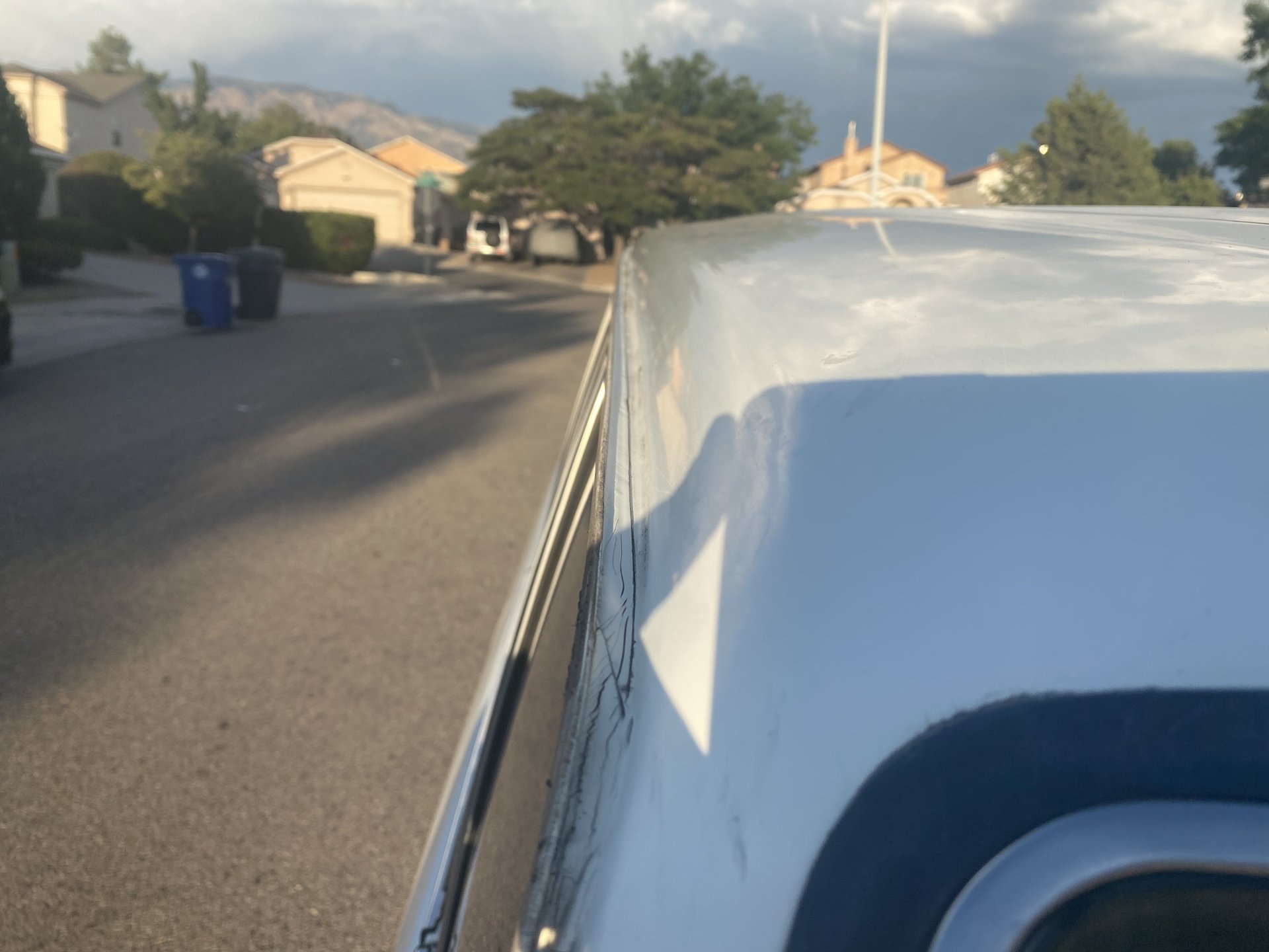

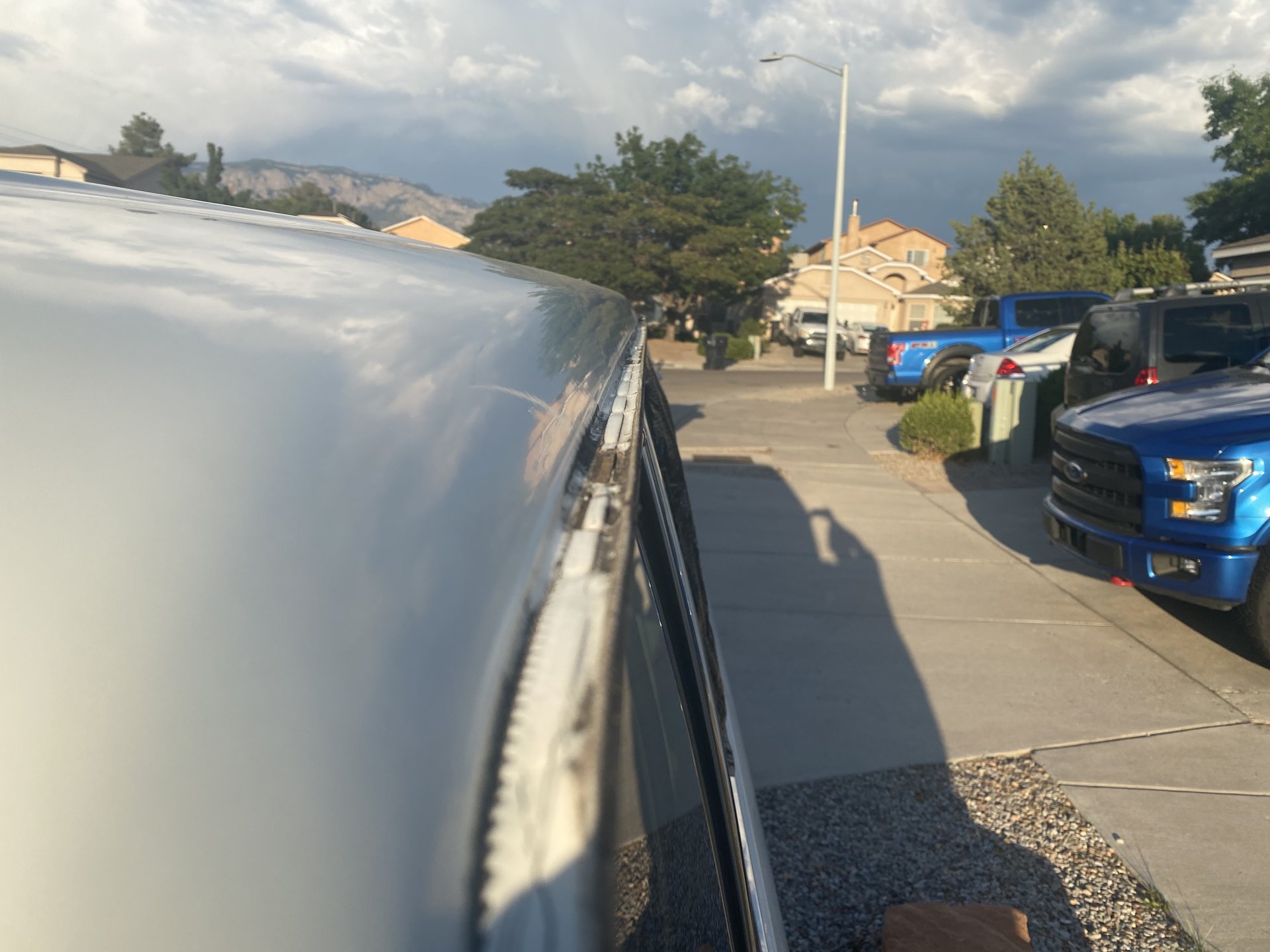

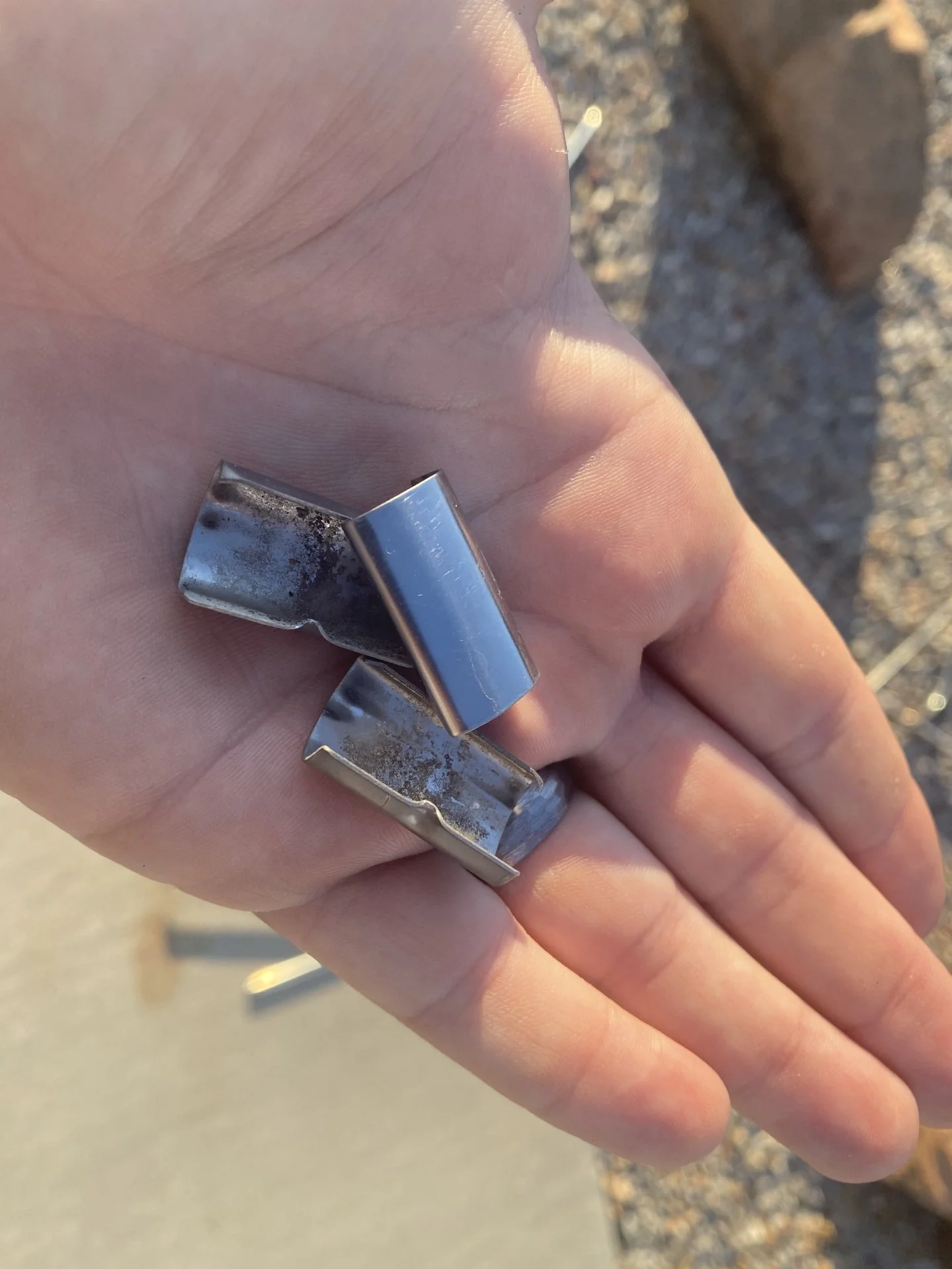

Next one is the beginning of a controversial topic. De-chroming. I pulled the gutter trim partially to check for rust but mostly cause I’m not a chrome guy.

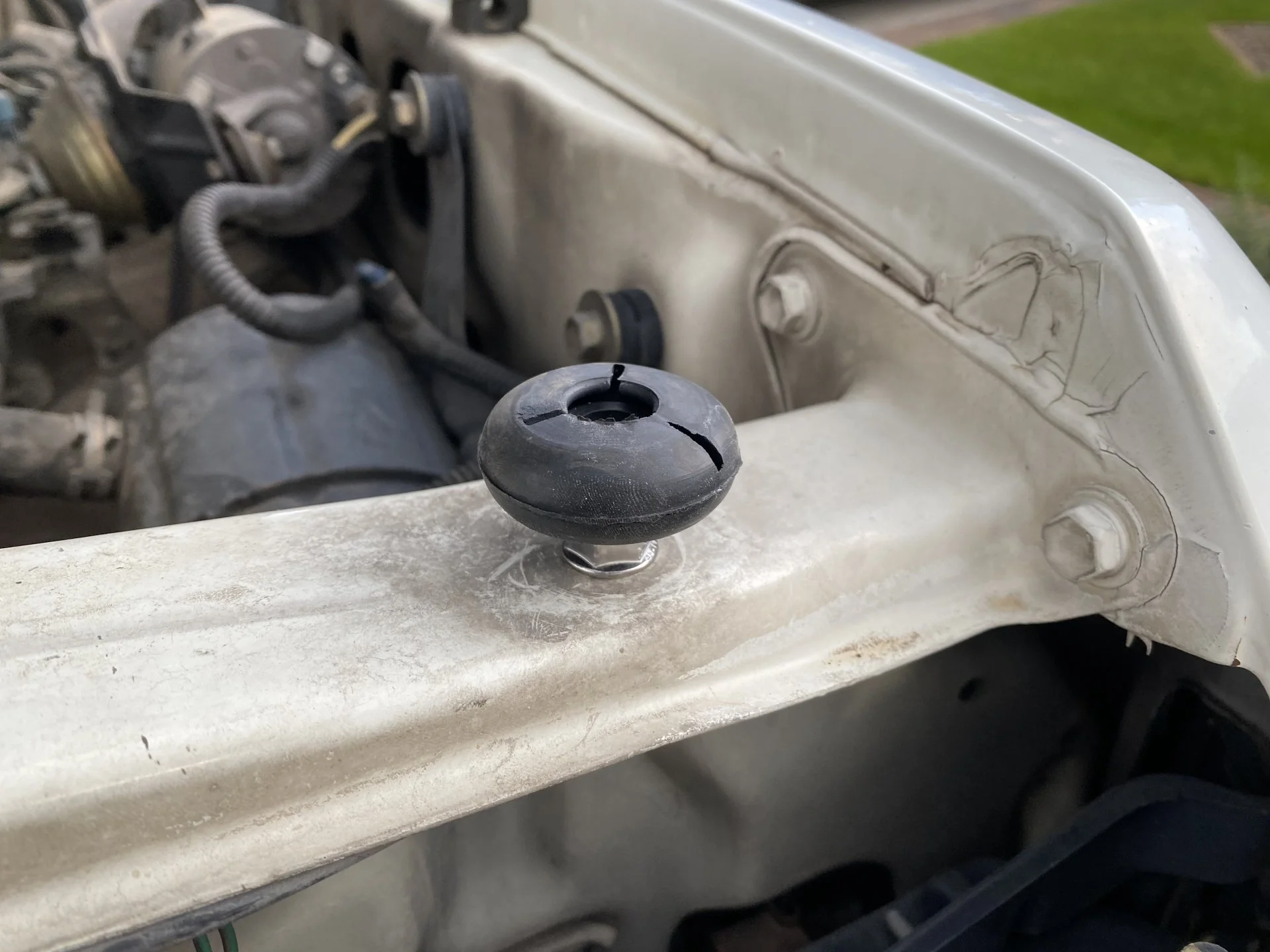

Small update, new hood bumpers cause the old ones were nonexistent

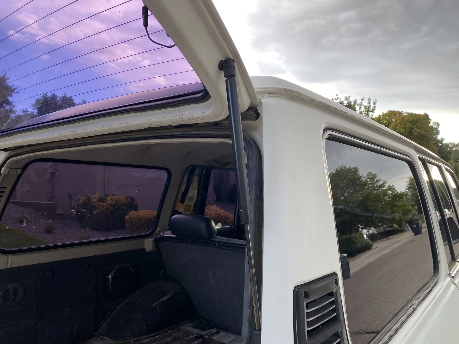

And the Amazon lift struts for the rear hatch, cause my head hurts from it dropping.

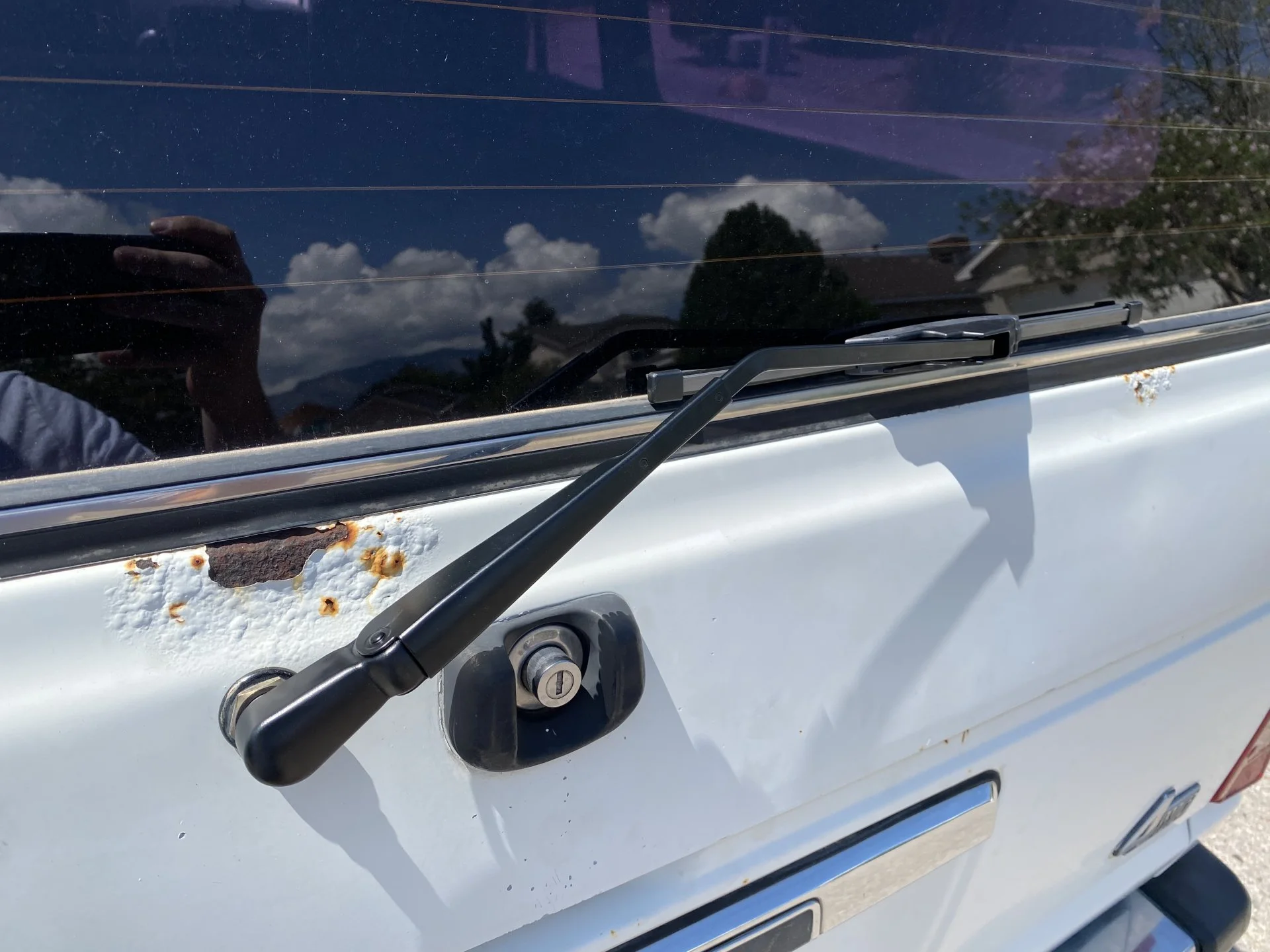

FJ80 rear wiper arm and 13” wiper “upgrade” installed. Needs the oem rubber boot still.

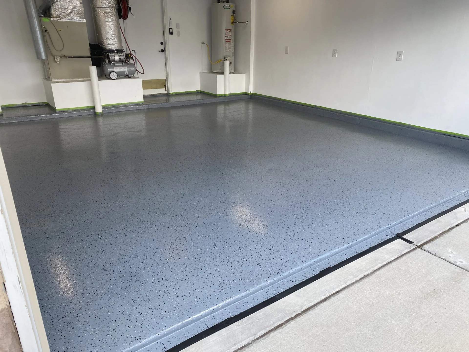

Still waiting on primer for my floor, UPS lost the same package 2x in a row from the vendor. 3rd time charm?
