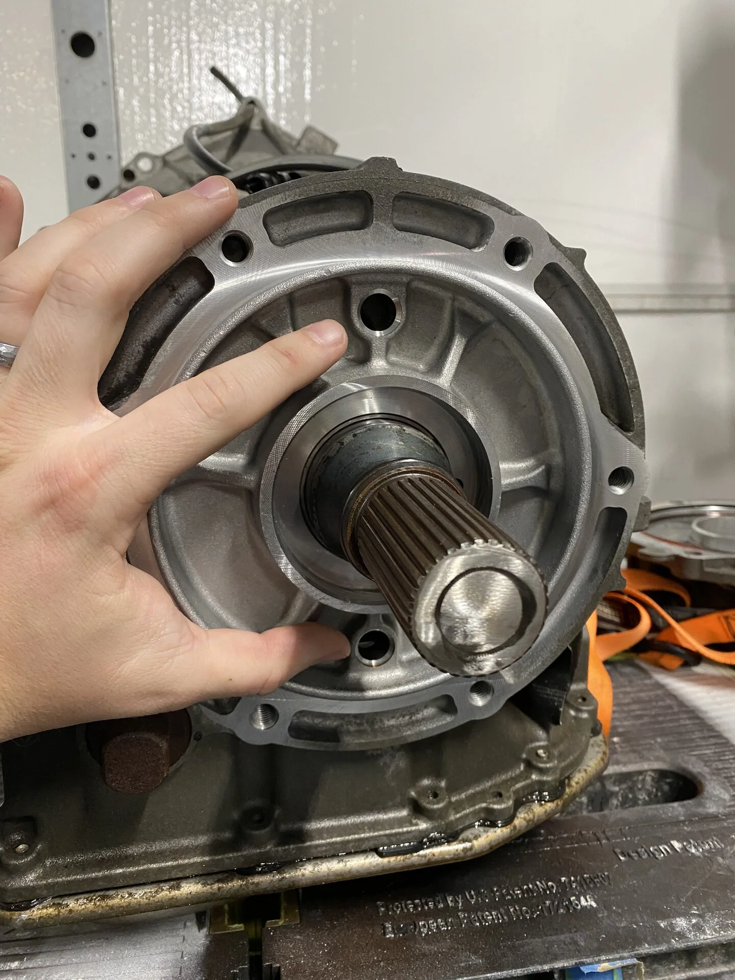

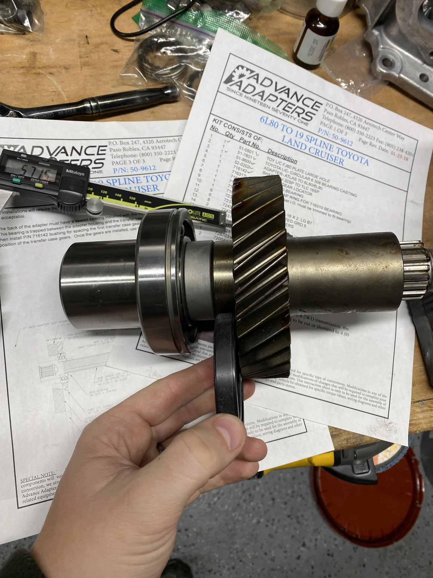

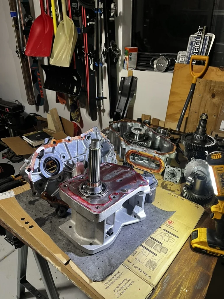

Hoping to get some feedback from smart people here. Called AA to ask if their intermediate bearing (between adapter and tcase) can run dry. They said yes. Seems odd no?
if done per their instructions the 2wd 6l80 gets its rear holes plugged and a seal around the shaft like the 4wd version. So no trans fluid in the adapter. There is also a double lip seal after the adapter and bearing that seals the Tcase. So I. Theory no fluid of any kind.
Do pack it with grease??
AA datasheet shows both the 716317 open bearing (one i have) and the 716310 sealed bearing (diagram) being used.
Thoughts from guys that did this? @cruisermatt @Dubs2017 @dbbowen @TRAIL TAILOR @tmxmotorsports
if you packed it with grease i feel like it would just spin out. Sealed would be the move. I see you have found yourself in the twilight zone of Advance adapters well thought out and suuuper helpful accurate instructions.
Bro I called AA twice, and both "experts" were confused and ended it with "dry should be fine".....
Mine was the unsealed, as that was what came in my kit. Buuuuut now that I have it broken down I might switch it out, as I'll take @TRAIL TAILOR 's insights to the bank.
They wouldnt even really talk to me about anything for the 4l60e kit the guy just said we dont really do troubleshooting hah
weird! i used the same adapter kit as you but mine came with a sealed one. Mine was an old off the shelf one though. had to do what i could to get one during covid while they were sold out

anyway Im going to call them and see if they will swap or sell me the sealed, if not I’ll find an equivalent koyo or timken
Open bearings like that need lubrication. Running dry will cause it to wear out. Run the sealed version or you'll have it apart again in the future to fix it.
Worse directions ever... That's so "your interpretation" VOIDS any warranty on their end.
Call me I'll get you a sealed one.

Sounds good I’ll take a look today!
Yup, my spidey senses were tingling and it didn’t feel right
Thanks to all for the help, it’s massively appreciated.

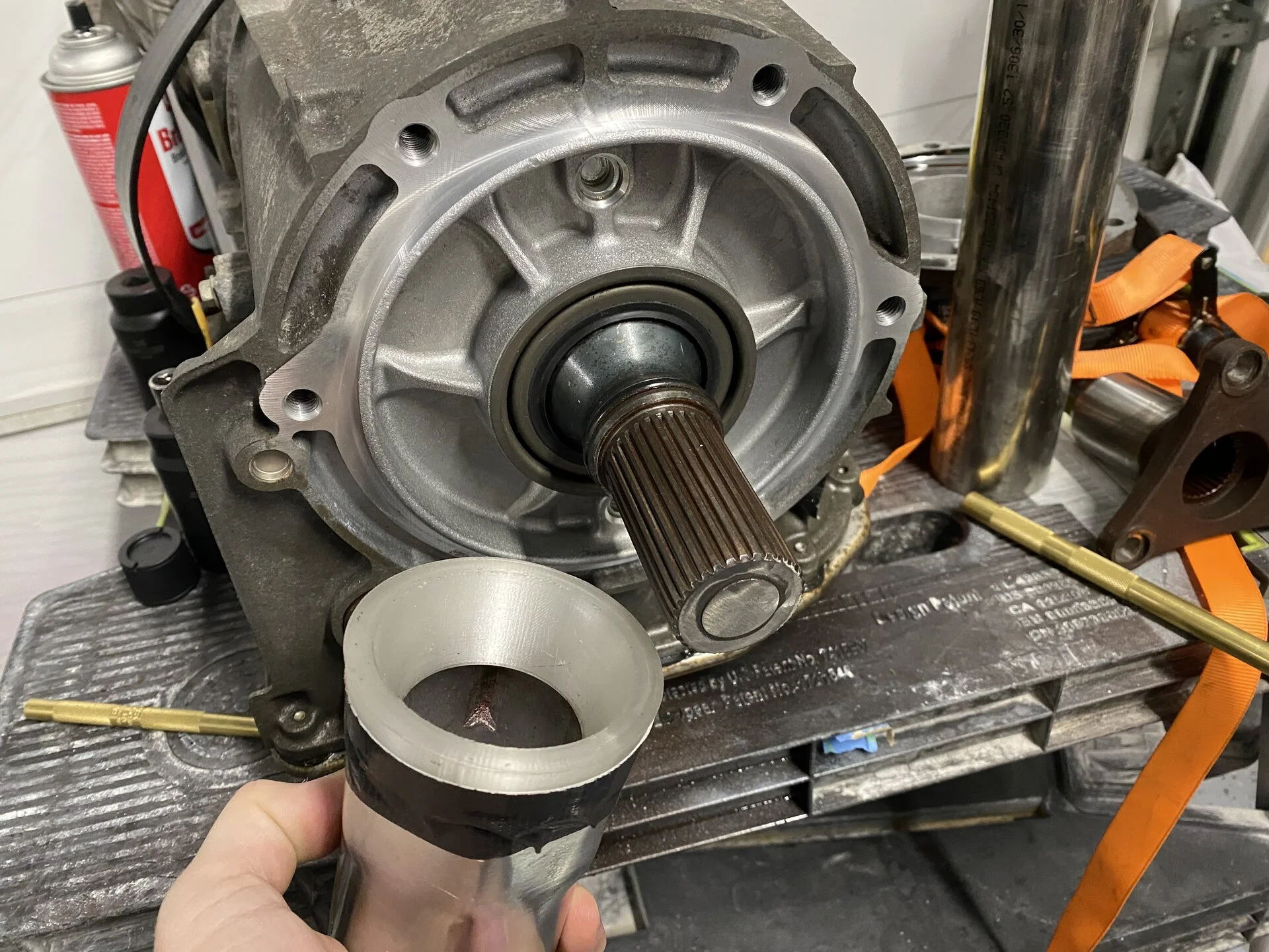

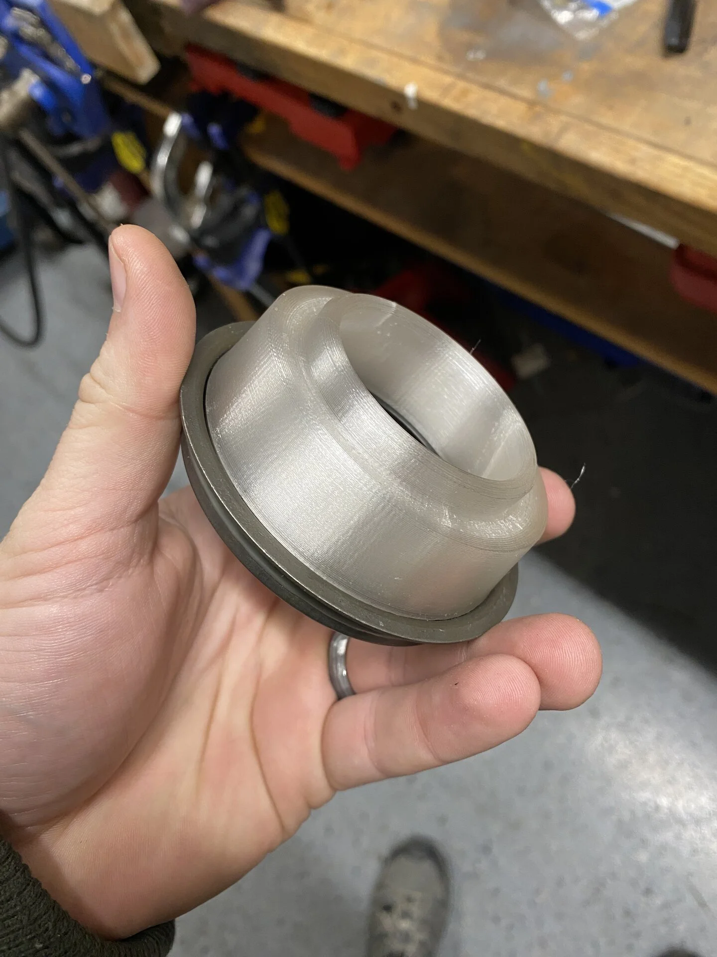

While we wait for the right bearing I 3d printed an adapter for the output shaft seal since it was a royal pain in the ass. 5 min of modeling and 90 min of printing, nice tool to have. Freeze plugs installed also

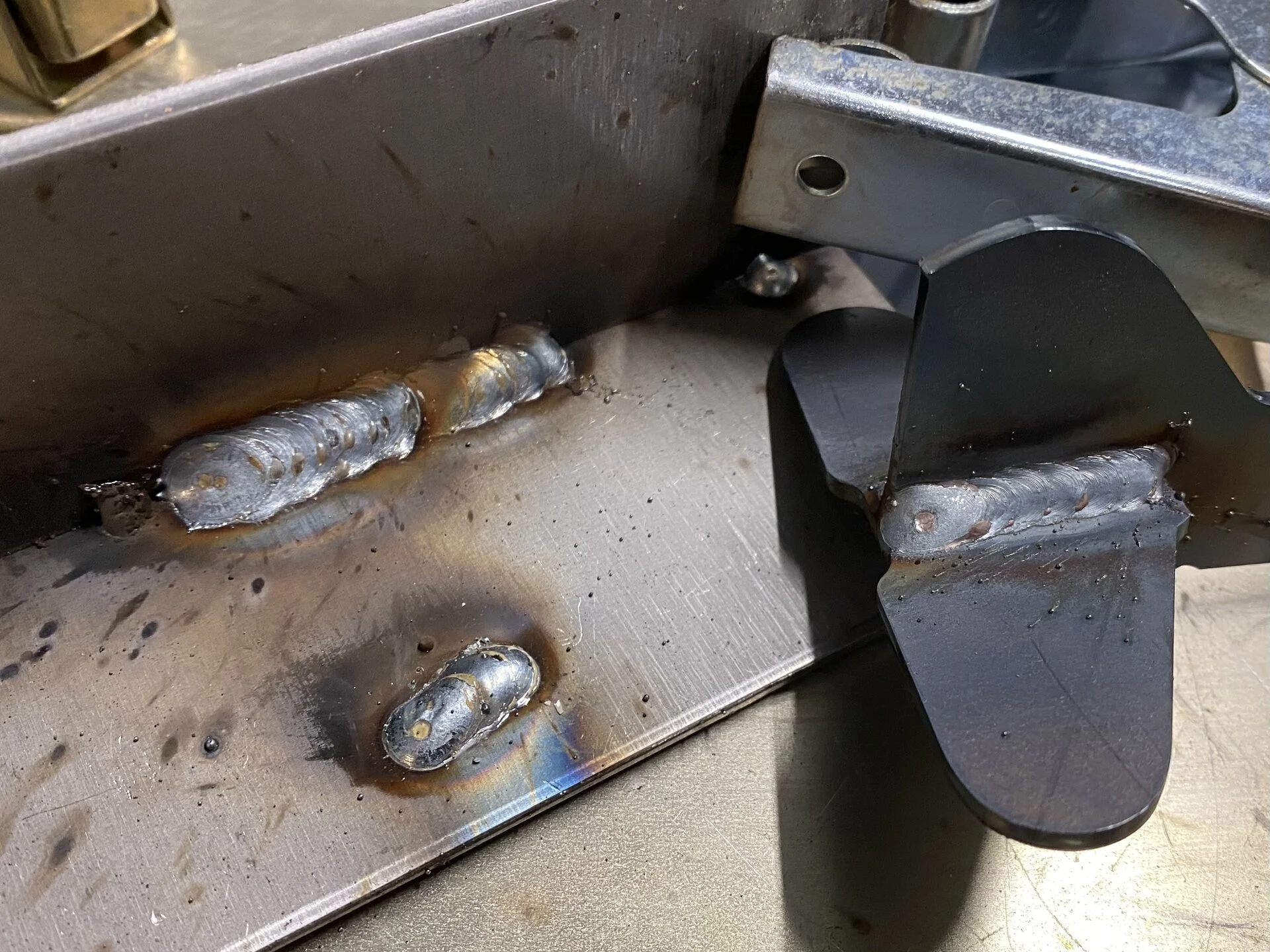

Also figured I would practice some welding, since I hope this motor will be installed permanently this holiday break….. we shall see

Remember kids, when 3d printing, perimeter thickness trumps fill % every time.
