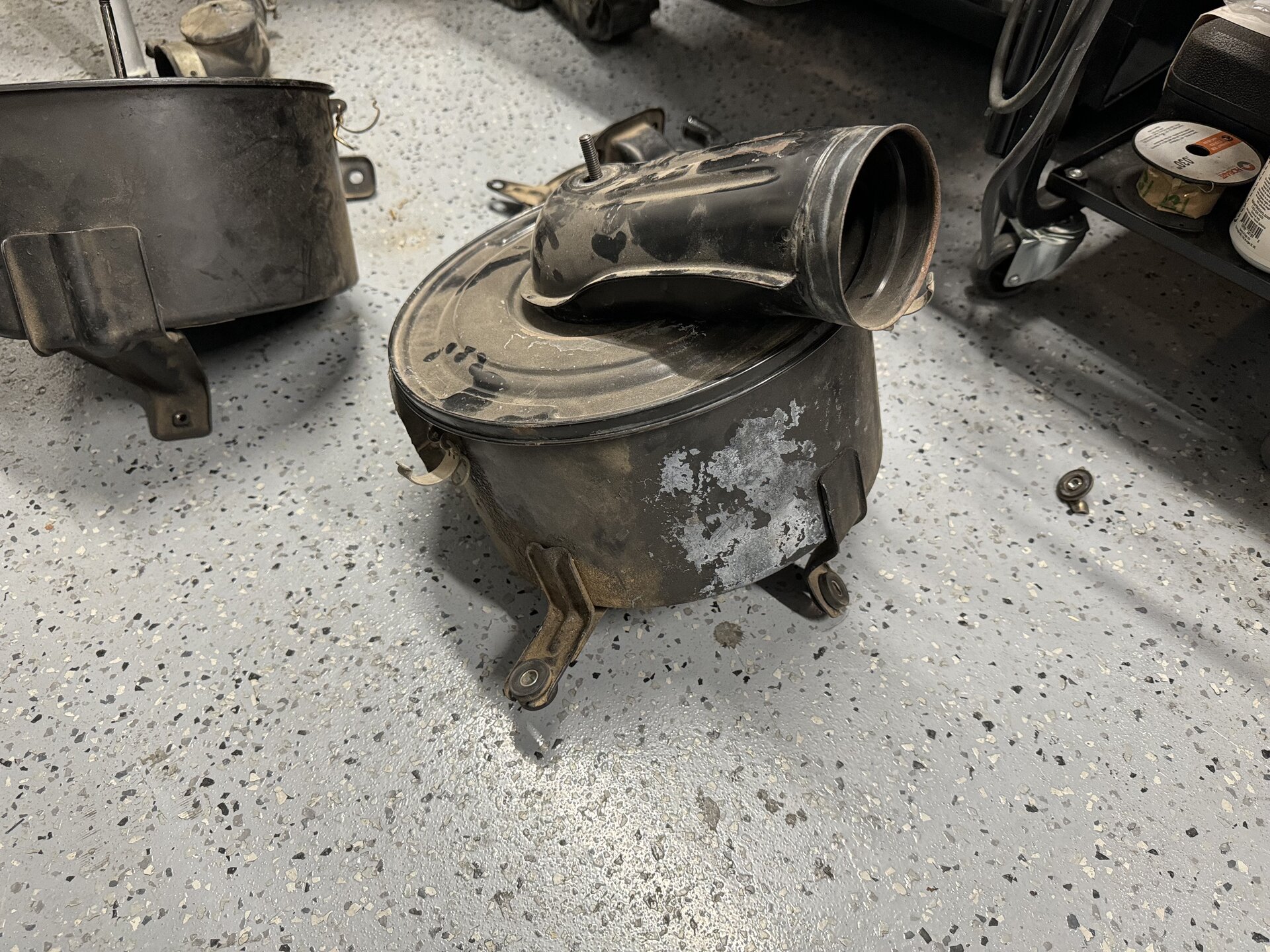

Picked up a few goodies and small progress. Thanks to Will for the 80 air cleaner

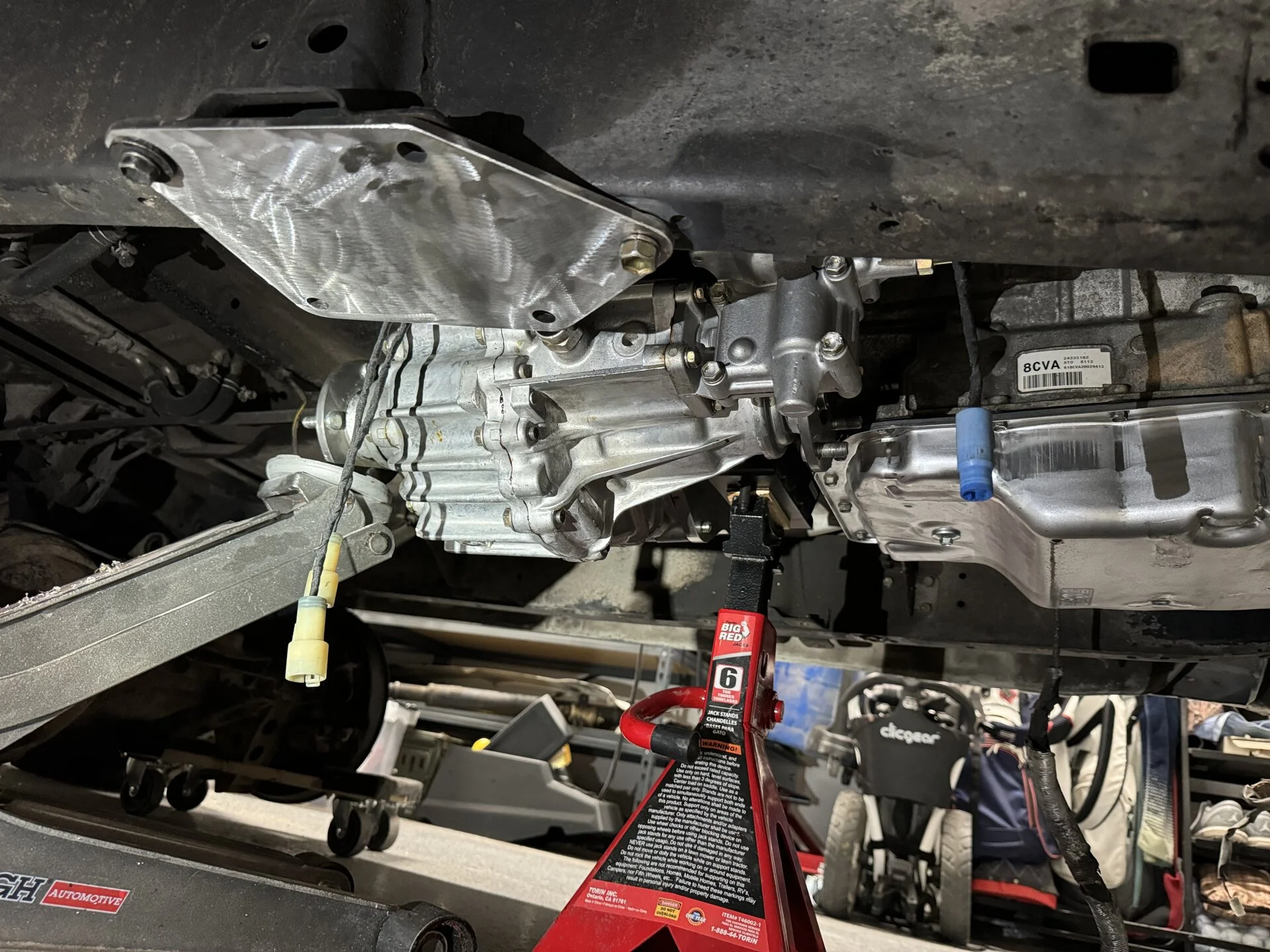

Got a few parts for the x-member. Extended the stock mounting location forward with a welded in flange nut

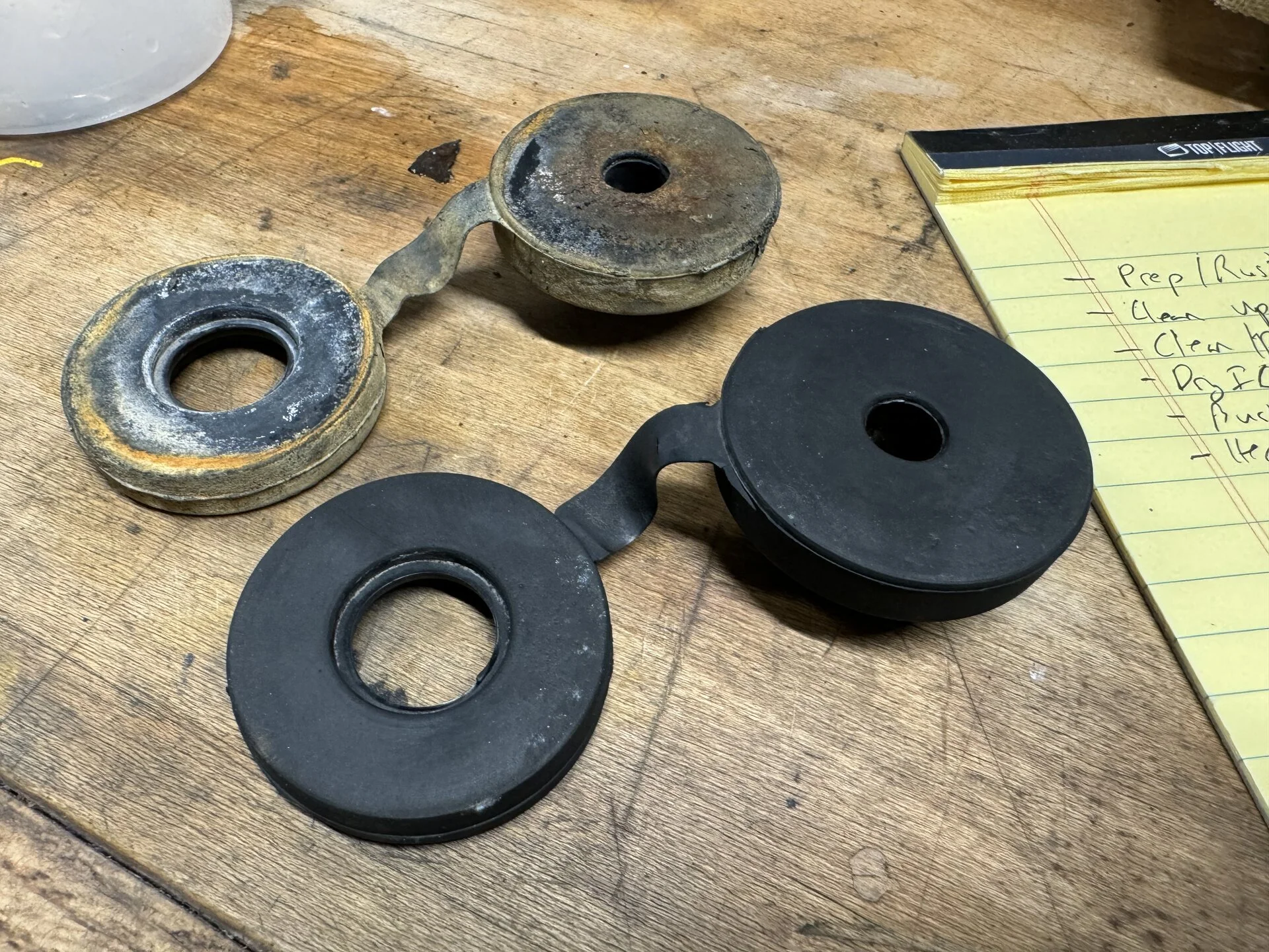

Started cleaning up radiator rubber parts

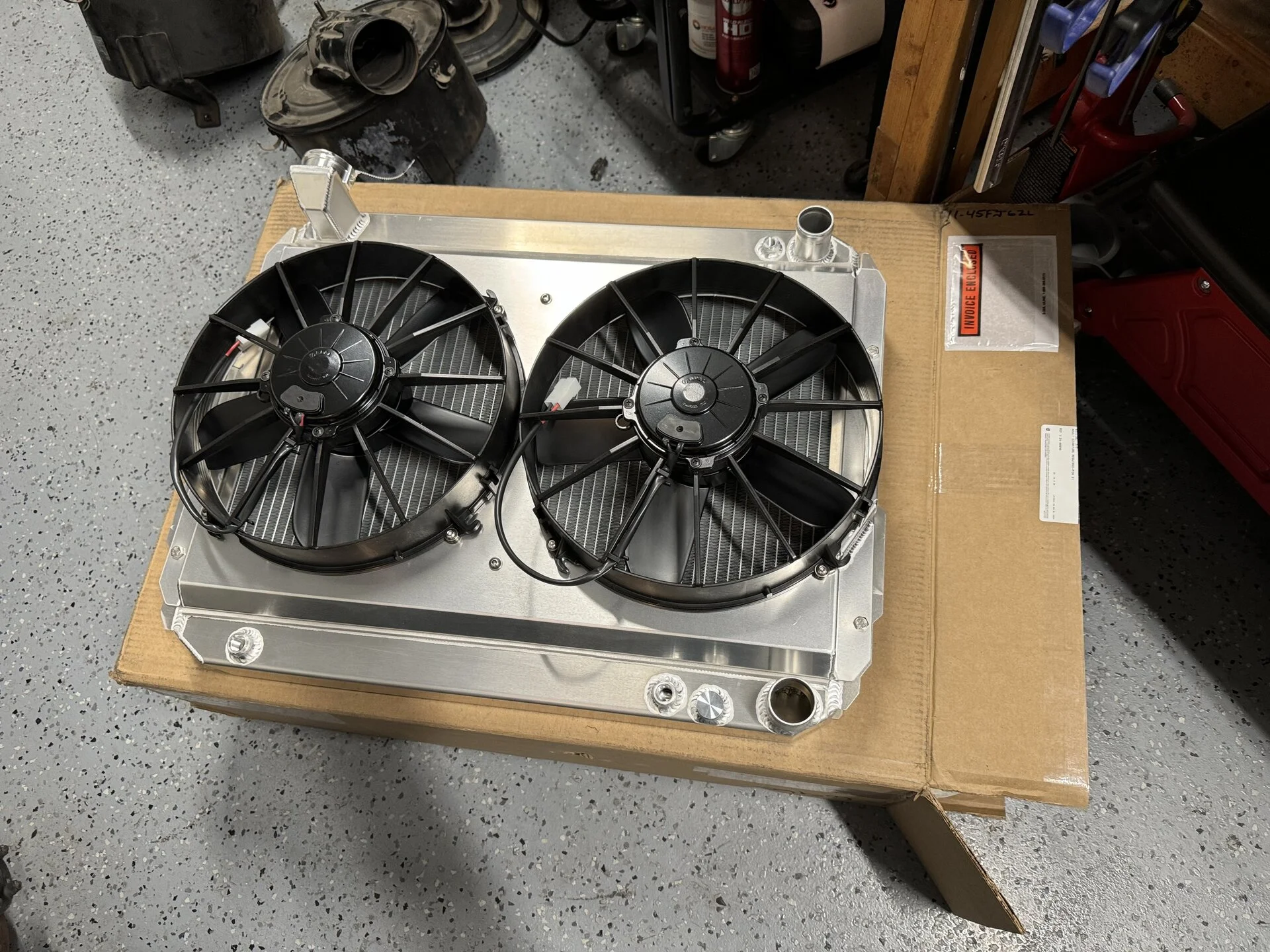

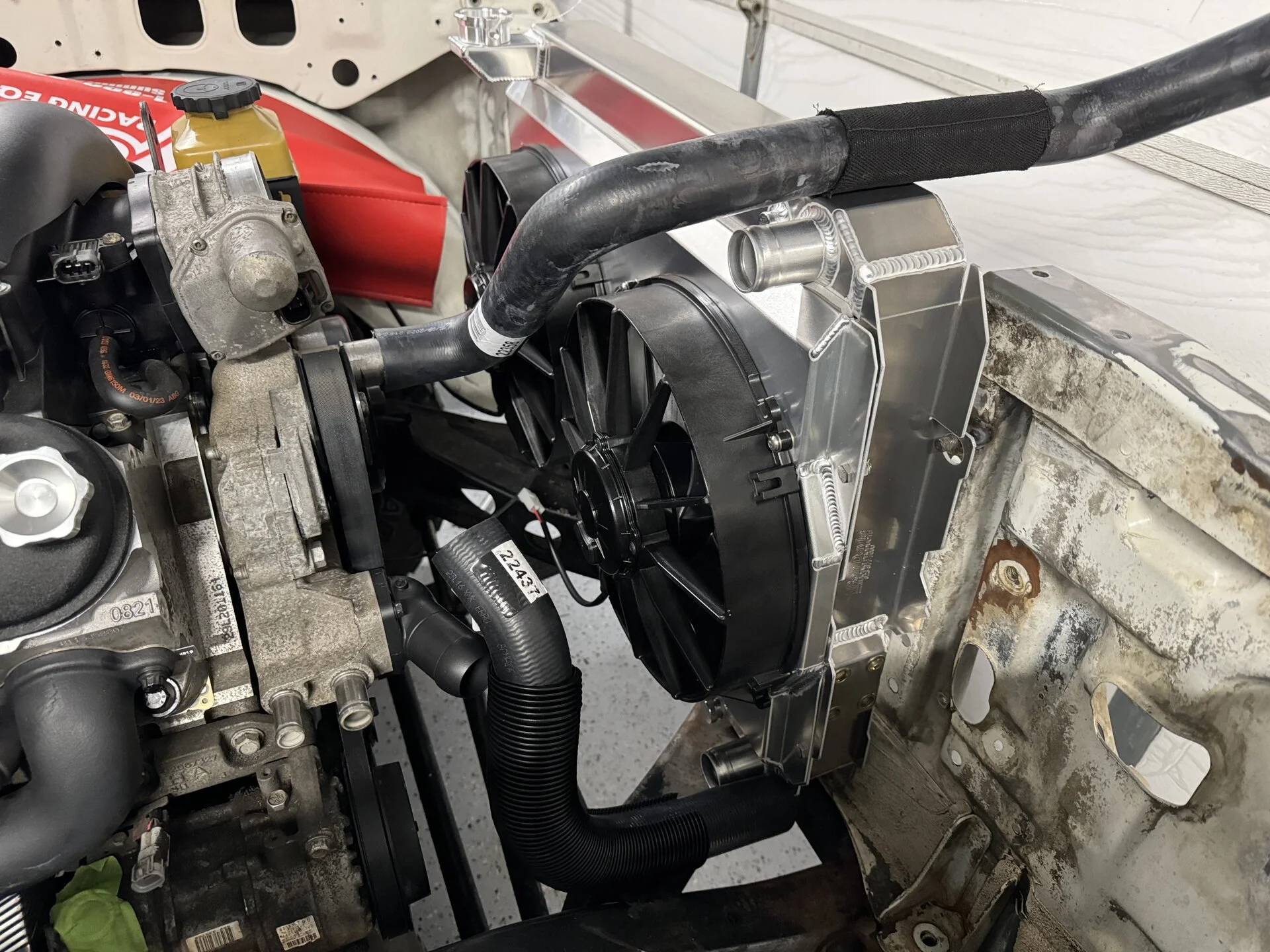

And this beauty arrived. Less than a week from talking to Ron himself to it arriving at my door.
Also found some hoses recommended online and they should fit nice when trimmed.
Gates radiator hose part # 22358 for upper radiator hose (with trimming)
Gates radiator hose part# 22437

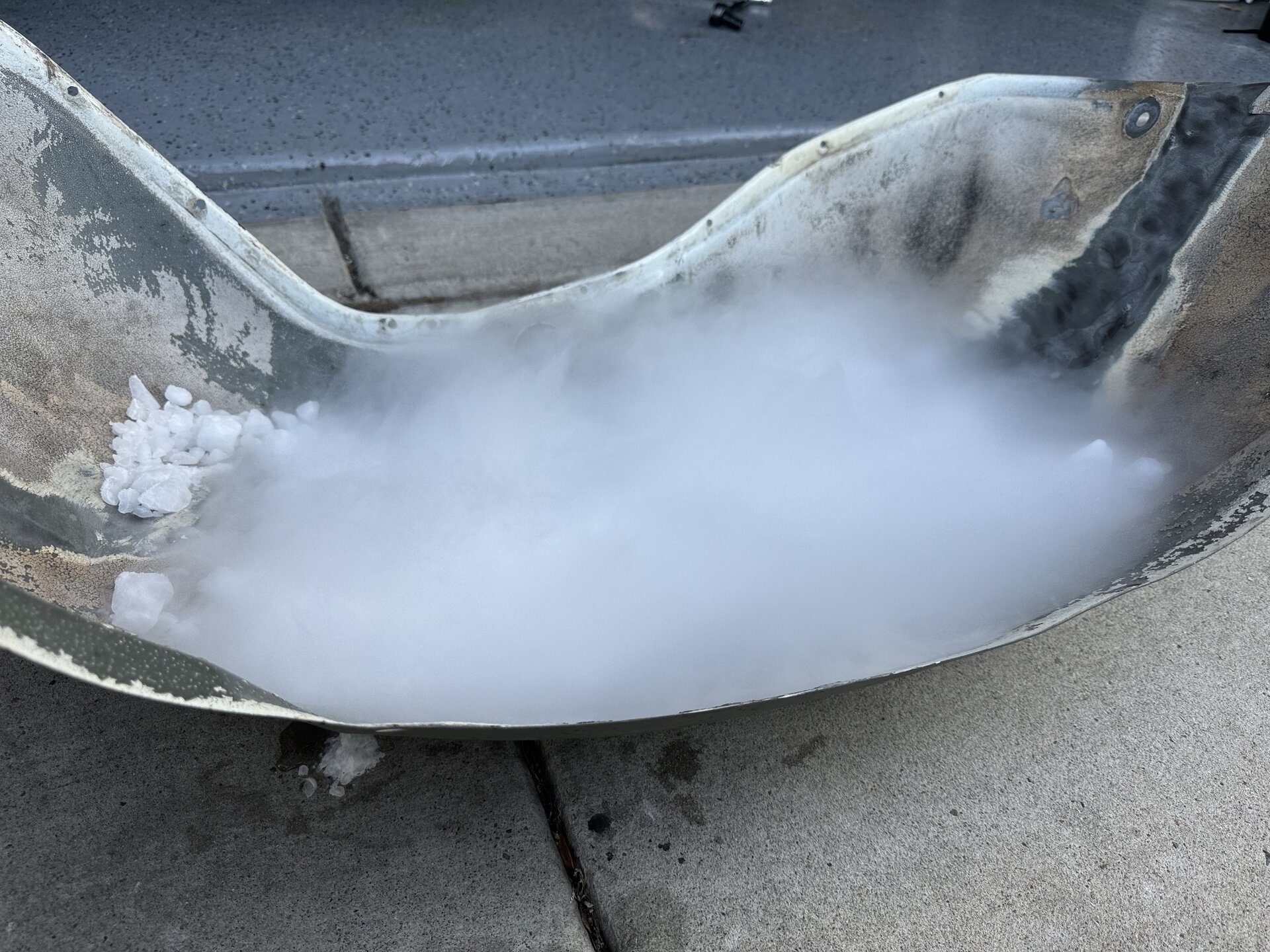

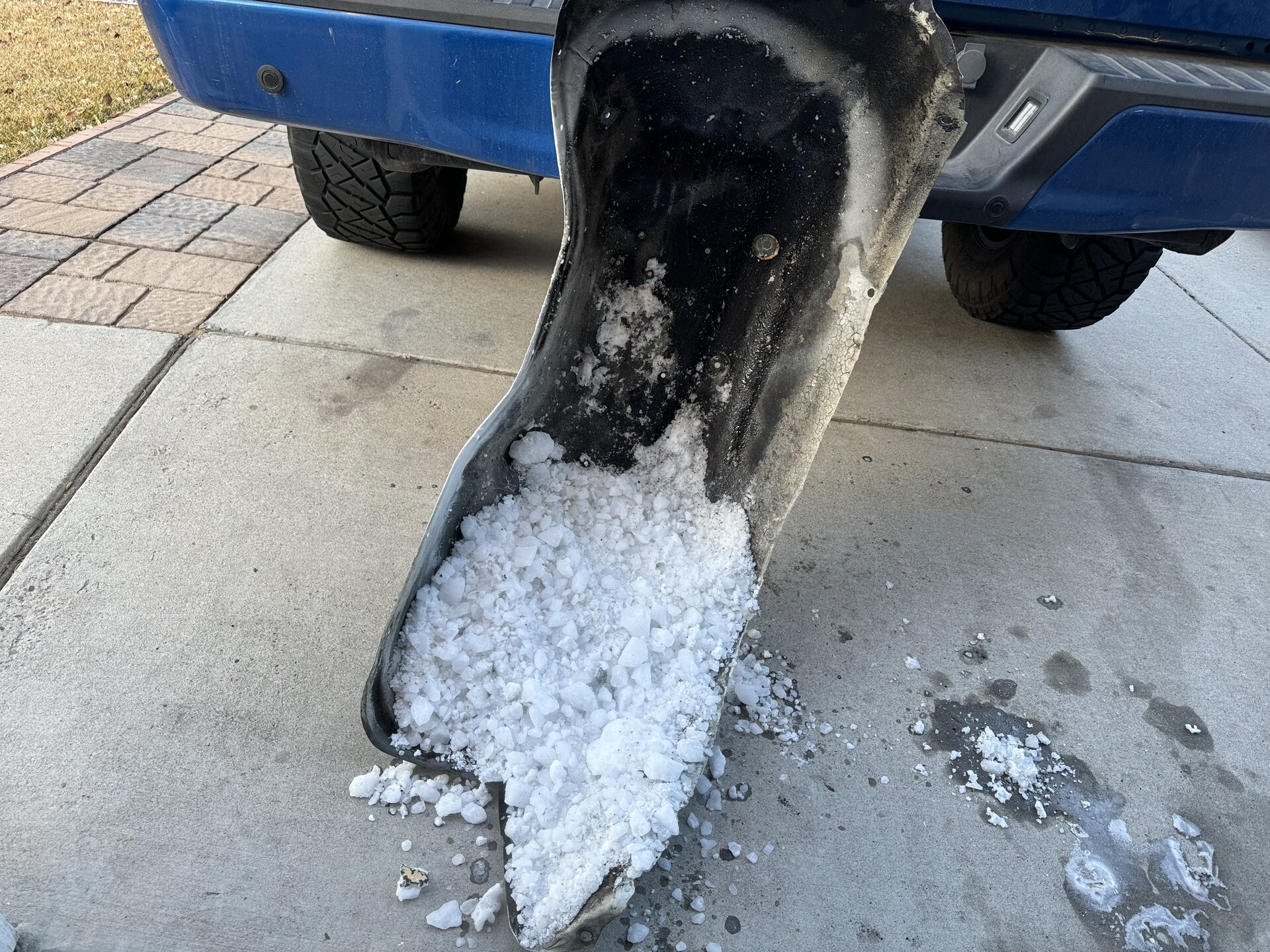

I saw this spray stuff a dude used but I can't remember the name of it. It was in a aerosol spay used it on sound deadner on the inside that stuff on the fenders is something totally different tho
