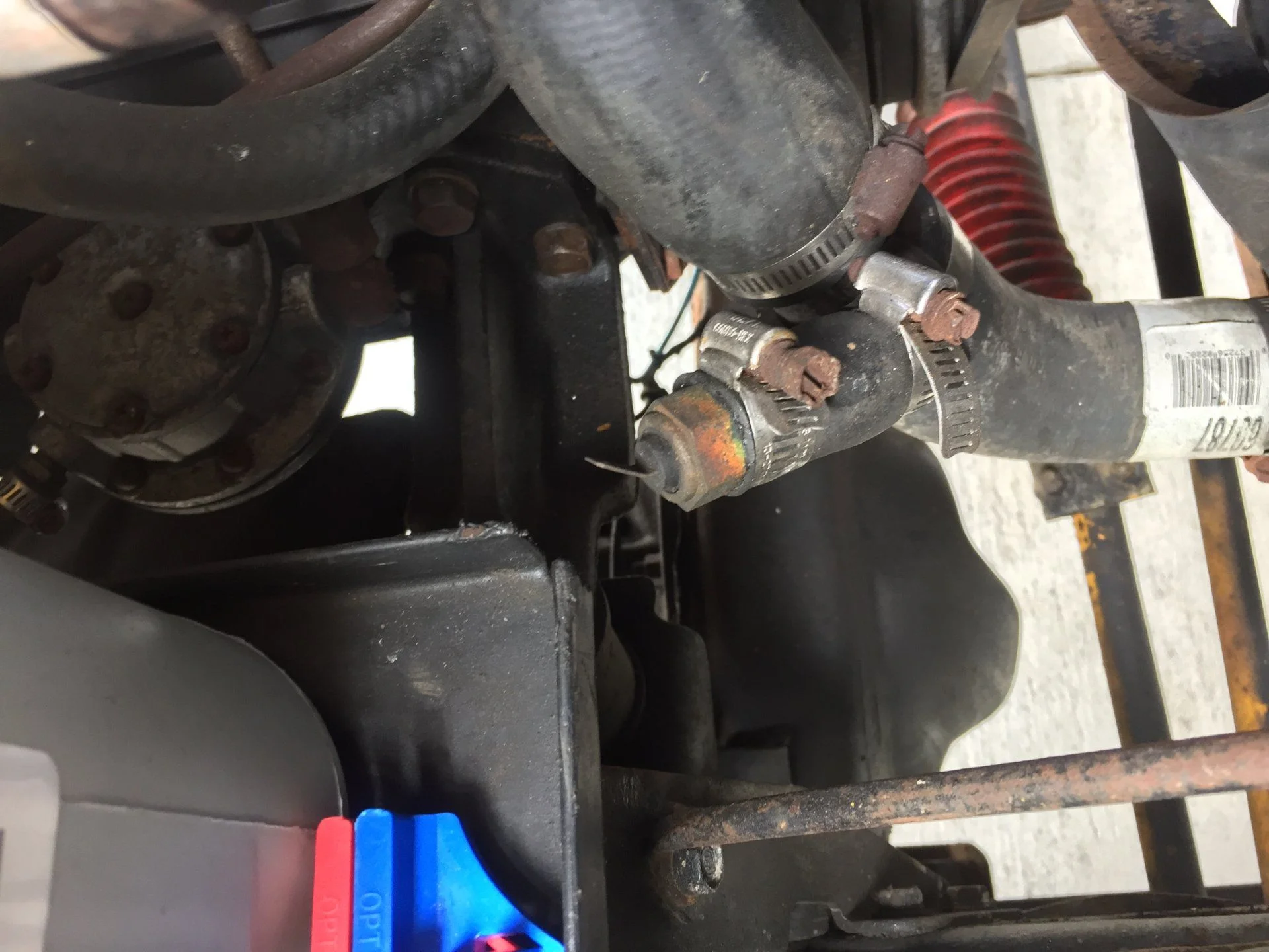

If you find your water temp gauge isn't working, I've circled where the PO added a temp sender.

If you find your water temp gauge isn't working, I've circled where the PO added a temp sender. View attachment 1987799

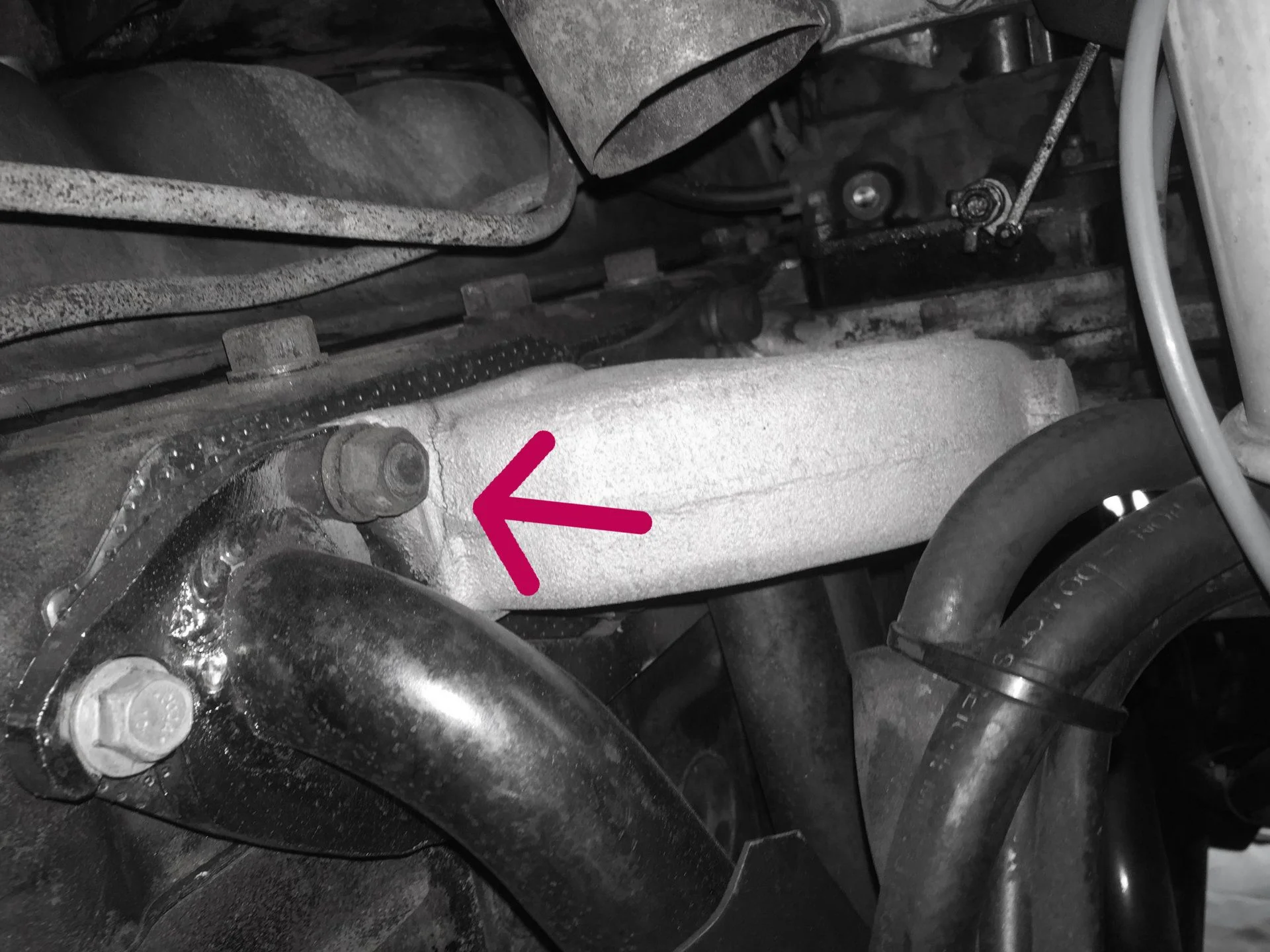

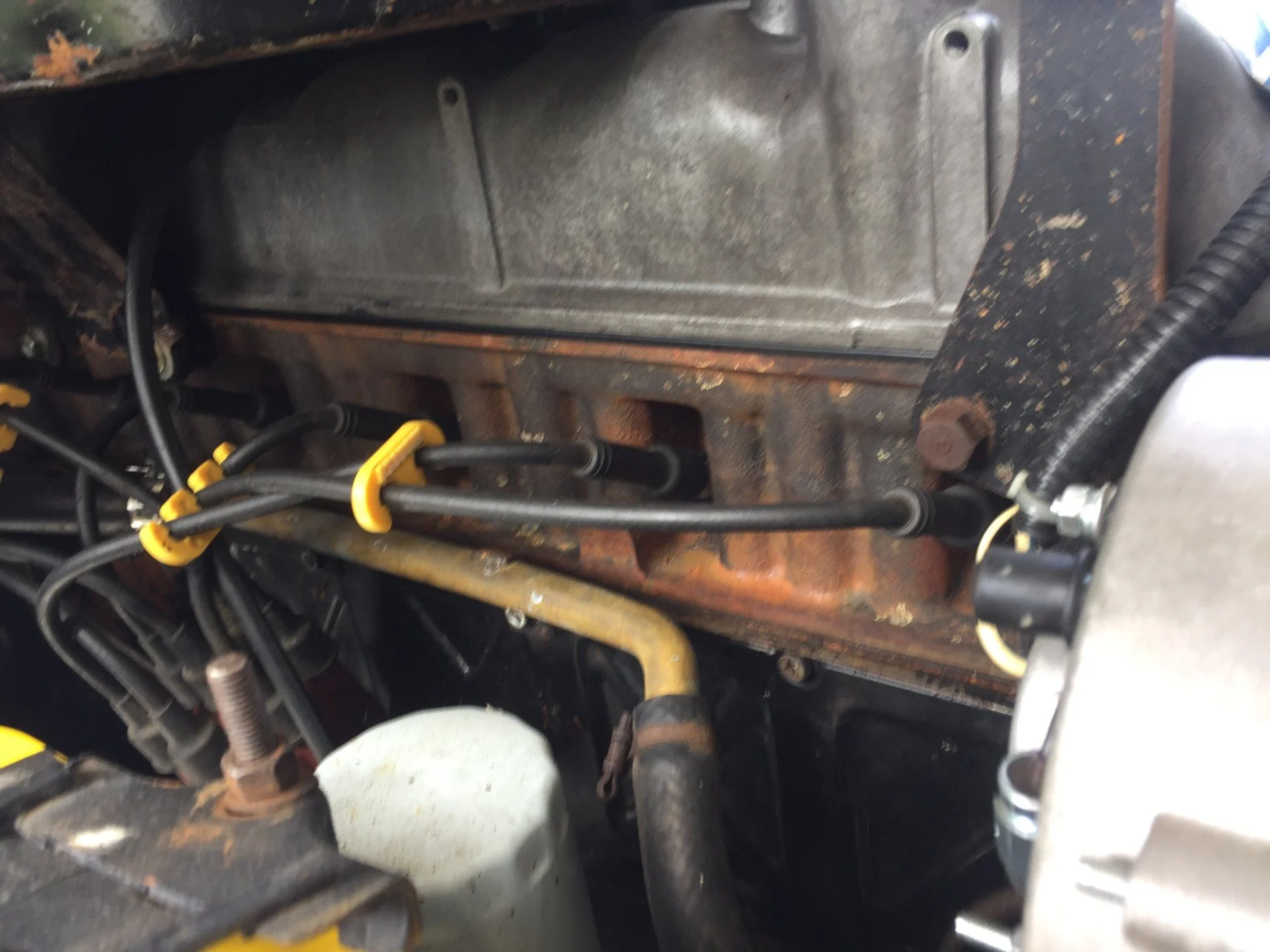

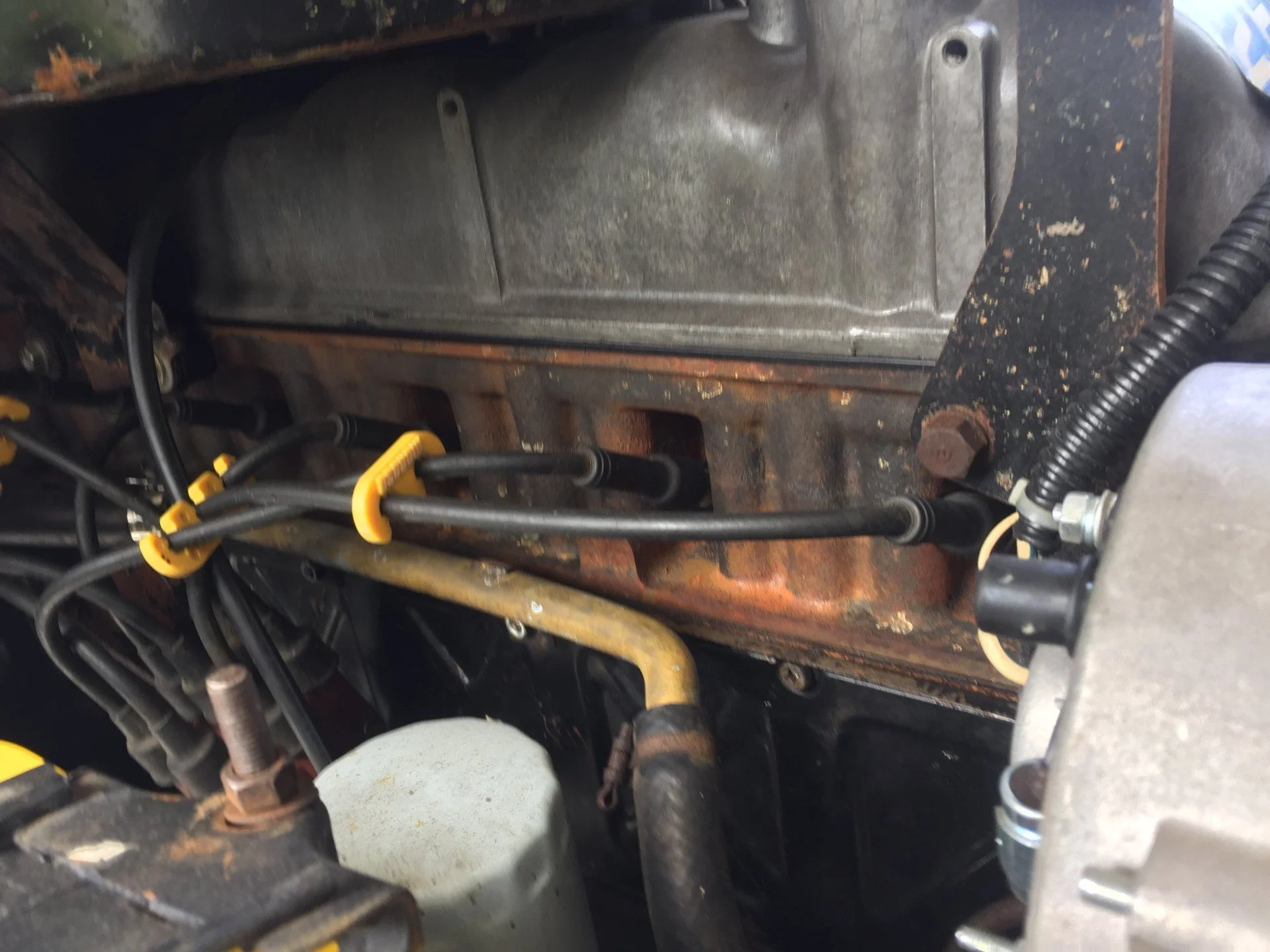

I think you said the previous owner unfortunately passed away. I wonder if he ever retorqued the exhaust/intake manifolds. The cracked ear on the intake makes me wonder if stepped washers were needed due to differing thickness between header flange and intake. There are posts on mud discussing stepped washers and methods of addressing differing flange thicknesses.
That's why you have to retorque the manifolds. ALWAYS retorque the manifolds.
Mark...
Correction to my previous post, I don't know what the silver K&N thing is on the drivers side of your engine is ???, no doubt has nothing to do with your engine problem. I did notice your Headers is very old school since the Header flange was flame cut, not laser cut, again has nothing to do with your problem. What I also noticed was you are using very thick washers at the Header/Intake mounting studs. In the old days we simply used thinner washers because they would easily bend and conform to any slight differences in Header versus Intake thickness, thus would tighten without cracking the slightly thicker intake manifold.
