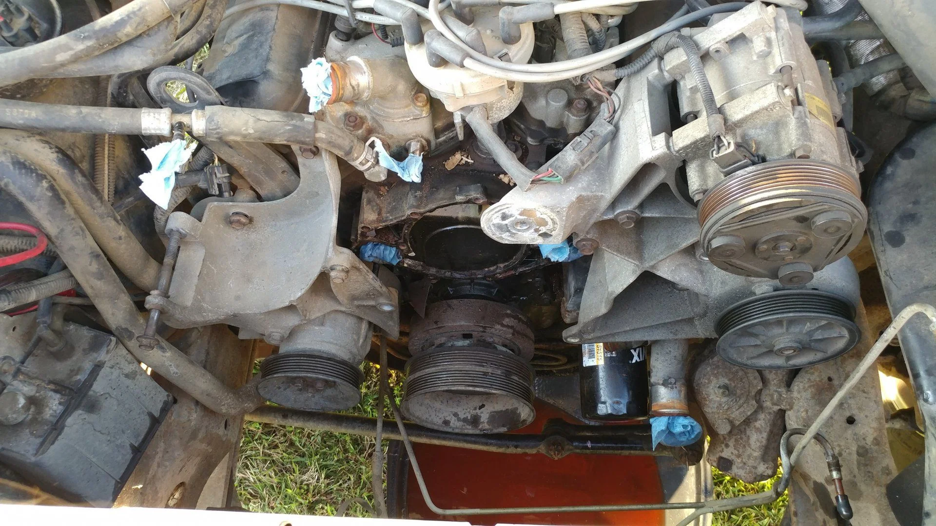

Well the old hands took a beating today. Getting the water pump off of one of these motors is a major pain. Pulled the radiator, fan and shroud out so I could get at the hoses and belts. Once I got all that stripped then I had to figure out how to get the pump out. So on this motor there is a big aluminum bracket on the right that holds the PS pump and the AC compressor that has to be unbolted and moved off to the side, then on the left side the alternator removed and then the aluminum bracket it and the air pump mounts to needs to be unbolted and pushed off to the side so that all the pump bolts are accessible. Got all the way to there and started loosening the pump bolts and that's when things went sideways...
First off the top 3 bolts were barely snug and one wasn't even finger tight, which I think may have been the root of the leaking, but wait it got better. 10 of the 11 bolts came loose with little effort, bit that last bolt, well it is still in the block, less its head and about a half inch of his neck.
On the left you can see the alternator bracket that I bolted back up so it wasnt hanging there over night. The broken bolt is right behind the cover. And d@mn did it cause a problem. Even after I got all the others out, that one was seized into the pump body. It took a lot of fighting and prying but I finally got it off.

The biggest hurdle is going to be getting that broken bolt out. Going to put the heat to it, going to try some MAPP since I dont have a torch set, then break out the MIG and try welding a nut on to see if that frees it up. If that doesnt work, then the sad reality is that the timing cover has to come off to get to the front of the block :(

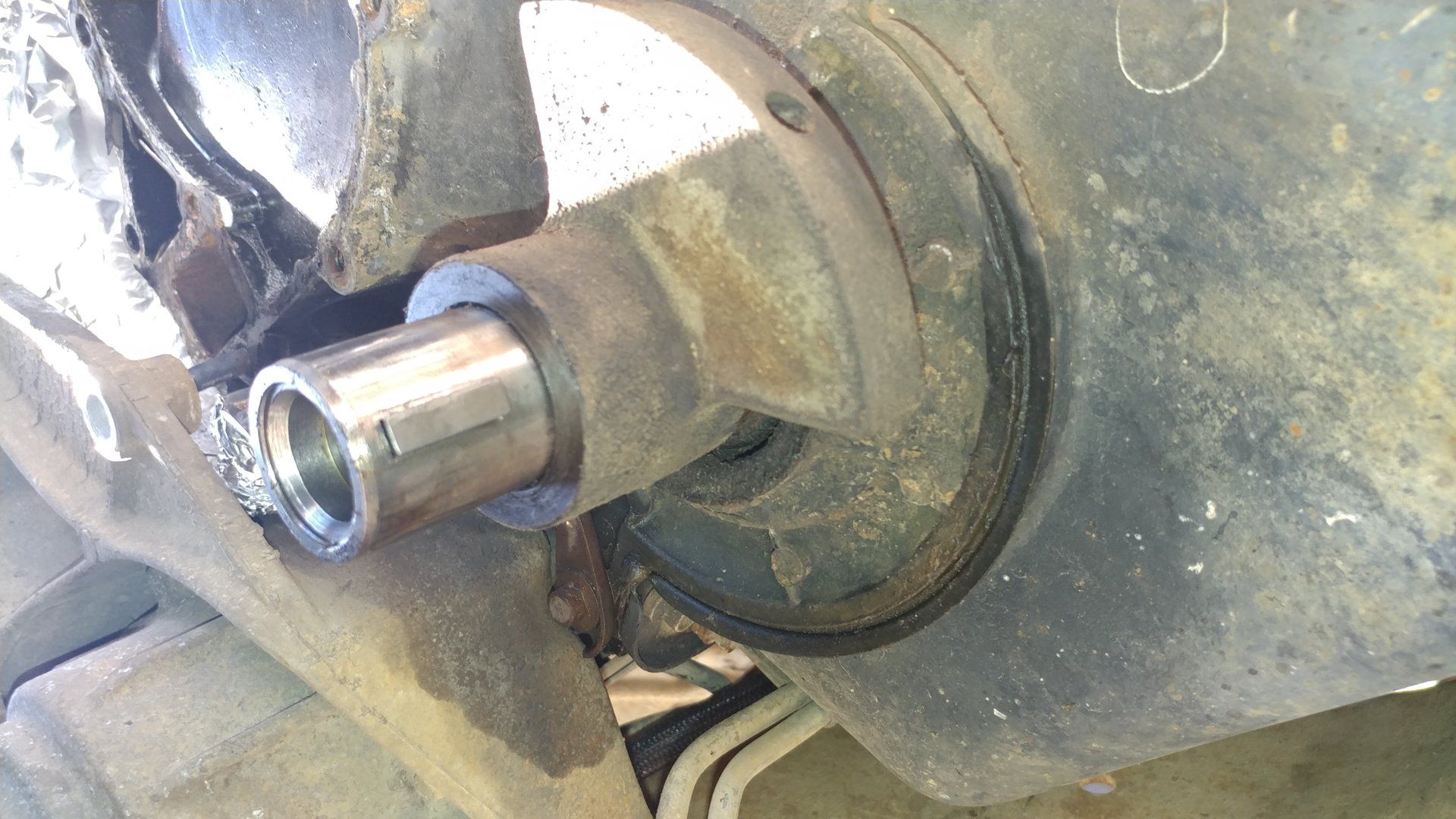

Anyway, with that one out I went ahead and unbolted the remaining 4 front bolts and the 3 that went into the oil pan flange. And then it was on to the next surprise....
I was worried about the crank bolt not coming out, but thankfully my 18v impact broke it loose with little effort. With it out I hunted around for something to pull the balancer. Lucky for me my steering wheel puller also doubles as a balancer puller, who knew :D
Then I had to drive out the keyway key so I could pull the external balancer-spacer
With that off I broke the cover loose and started working it off only to find that the oil cooler was keeping it from coming off cleanly. I wiggled and twisted to no avail so that SOB had to come off next.
So with that out of the way the cover came off and it was time to start scraping. Got the mating surface all cleaned up and put on the new Cloyes timing set. It is adjustable, up the 8° advance or retard, but I aint that far along, so it went on straight up.
