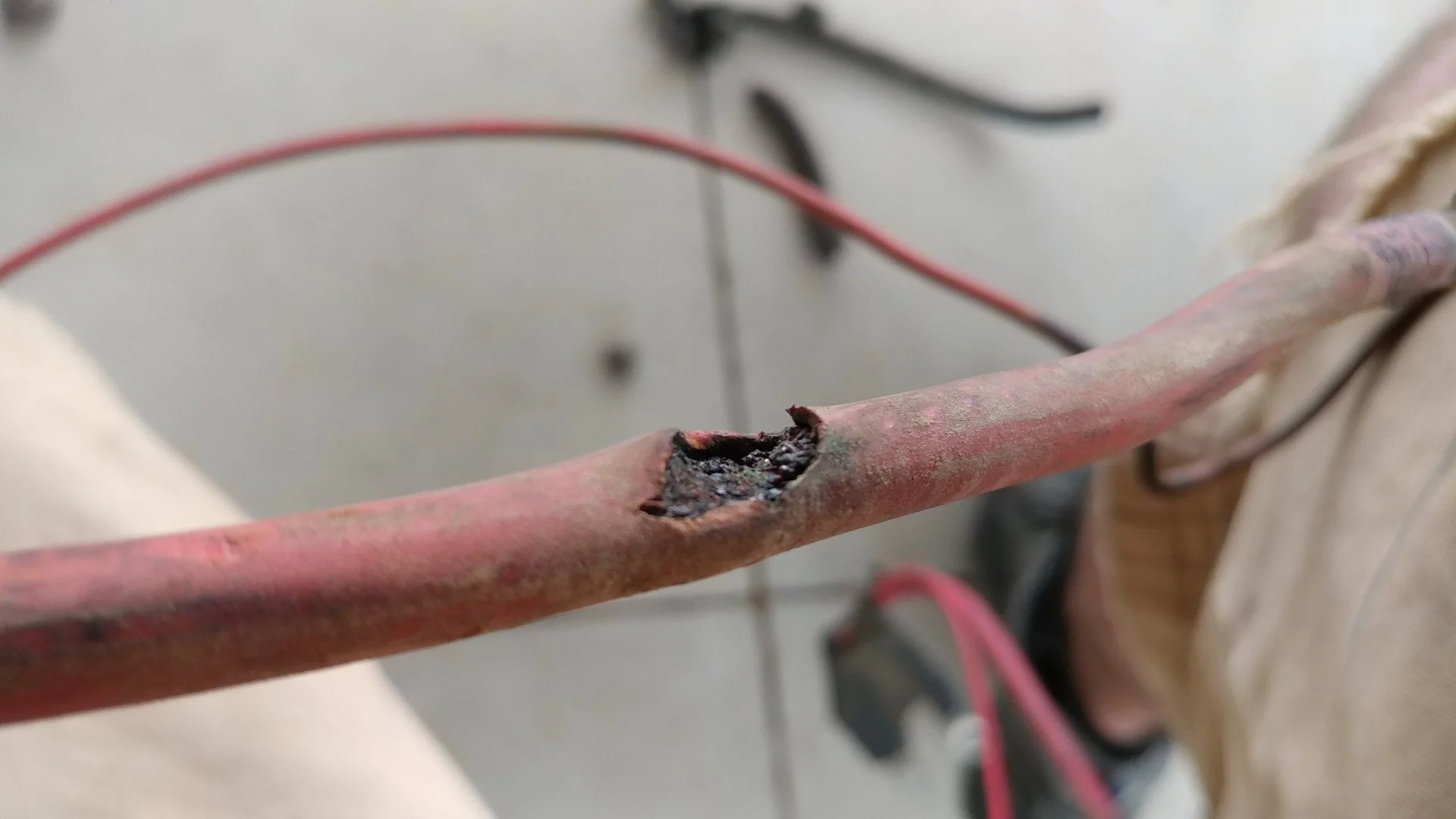

Well Bumble decided to kick up on me last Saturday and didnt want to start so I went ahead and picked up the usual suspects to try and chase it down.
First dropped in a new battery. The old one may be fine, but I had been getting some odd voltage drops when checking it with the multi-meter. That didn't fix it, so then I changed out the starter solenoid, still no go, so I crawled under and started pulling the starter. Well between this burnt terminal
And this beautifully aged cable
I think I may have found the likely culprits.
So I pulled the main battery harness out so I could change out the bad cable for a new one. While I'm at it I think I'm going to change out the battery ends for a military style set.

Finally got the Bumble back up and running. When I started, my torch was out of gas, so I got a new bottle of gas and got the cables finished up and then discovered that when I went to bolt up the new starter, one hole in the starter that was supposed to be threaded to accept a bolt was basically a thru hole. So another day and another trip for some new hardware. Picked up a new longer bolt and a nut to take care of my janky hole. So finally today after all the dots got connected, got him fired up and ready to roll.
