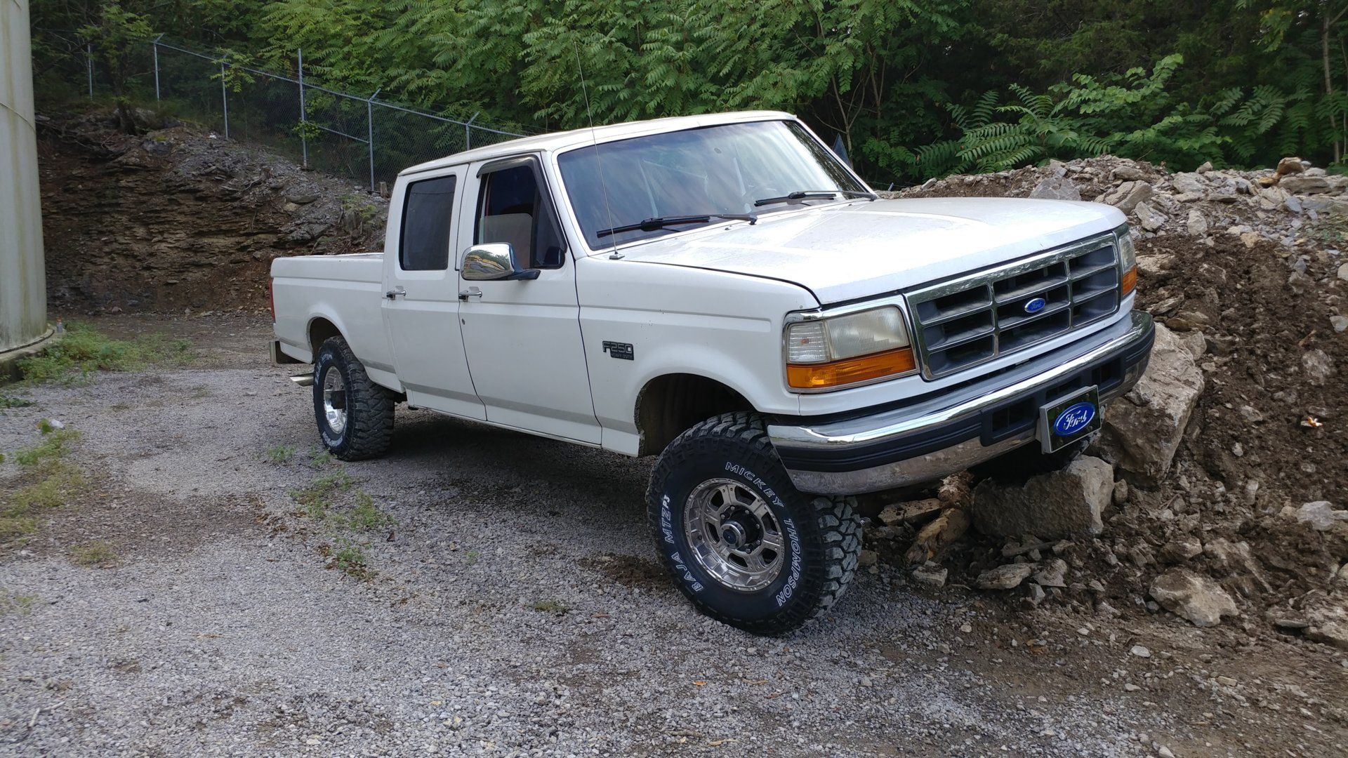

And just because there were rocks close...
Not much flex in those HD springs, but Damn that frame sure has some twist to it...
