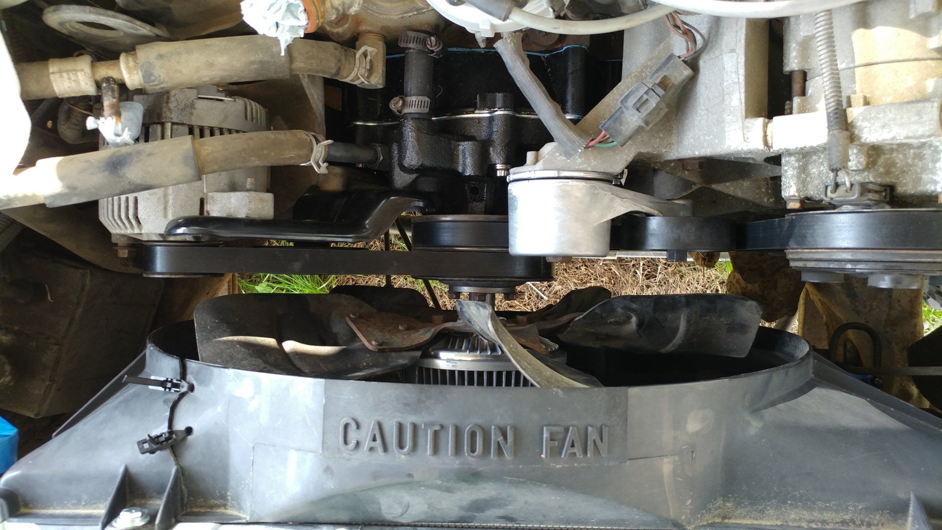

Closest we've been in months. Got the new radiator in, harmonic balancer on, crank pulley on, water pump pulley is on but cant put the fan clutch and fan on til the fan shroud goes back on. Need to pick up belts this week and an o-ring for the oil cooler bolt and that should be that other than coolant and oil.

Anyway, not a good way to take a picture, but here is one I did get.

Well I went ahead and picked up a new fan clutch today as well as the correct alt belt. Apparently I have the 95A alt not the 130A alt. Going to keep the other belt so of I want to upgrade to the 130A unit later I can, but dont feel like fooling with wiring right now.
Well, so dang close, but still didn't quite get there. Top end is done. I got the new fan clutch on and got the belts back on. Went ahead and installed the new cap and rotor, but didn't do the wires and plugs just yet. Got the upper hose on and got a new air filter in and got the intake tubes back on. So all I lack is getting the oil cooler back on and installing the lower hoses, fill it, flush it, change the oil and take 'im for a spin and try check for leaks and try to wear the flat spots off the tires.
