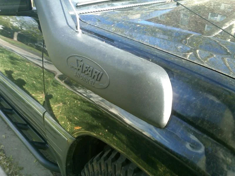

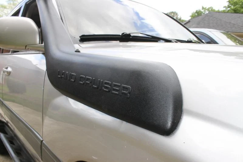

as close as the two designs look... right down to the drainage grooves, i think it's pretty damning. if that one posters information about plastics is correct, then the are probably the same material too. that is the only think i would research before i bought one. i lived in Colorado, i have seen what the sun can do to cheap plastics...
if i could find out that the ARB version is made from start to finish in Australia, then i will go with that one... on principal. Same with TJM. if they are made in China, then the clone seems to be a better buy.

As it relates to the 100 snorkel, the contours on the Safari are more defined than Nick's version. This tells me that (at least with the air intake component) the knock-off version was fabricated using a different mold and therefore not from the same line. If the rumors are true, then someone needs to find the source for the knock-offs made from the same molds. Once this source is verified, it would then become my 1st choice when considering a Chinese snorkel.
Huh?
They look way to similar to me to not be based off of the same mold. Changing from the Safari logo to land cruiser would not require a whole new mold
