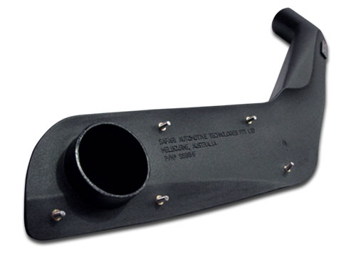

So the snorkel that Nick installed is a 100% knock-off/bootleg version of this snorkel:
Lexus LX470 / Land Cruiser 100 Series Safari Snorkel System
Judging, by this picture, even the templates should be identical, all the studs are in the same relative location to the one we installed. I know its just eyeballing it, but it seems unlikely that they would have redone all the mounts on the thing.
I can't imagine why they would change the template from a safari snorkel. If you're gonna copy someone, make your life easy and copy the whole thing. Why would you modify it and need to make a brand new template?
Also I find it funny that people were previously questioning the quality of the Ironman snorkels. Hahaha
I would think the templates would be the same as well... But you just never know with a knock-off.
thanks for that :lol:
yeah, the mounting is the same from what I can tell. Hardware was even the exact same on mine according to photo's. Does anybody have their Safari Snorkel template still? I'd like to see some pictures of it.

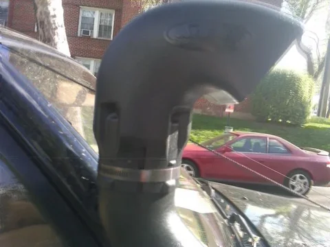

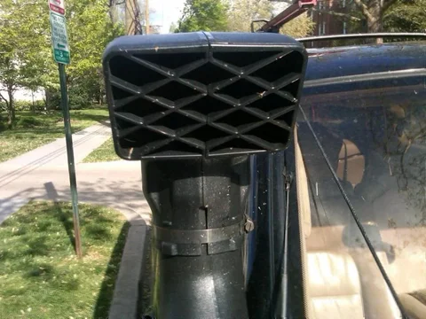

forgot I had taken these upclose photo's. If you have a Safari Snorkel please post up. I spent some time looking at the Safari snorkel head and mine does not have drainage holes for the water. I am planning on drilling the rear of the head to allow it to vent water during heavy rain. There isn't rain forecasted for the next week or so, I am not worried about it. I see no way for water to escape the snorkel body either, so I may drill the bottom directly under the intake hole to prevent water pooling in the snorkel body. I really don't want a half gallon of water sloshing around in this thing. That is the only issue I see with this snorkel. No way for water to escape once it enters.
I know pfran had the same question for the TJM. Thoughts?
Don't know what holes you're talking about but it looks the same as the Safari heads I had on my 60 and 80 as far as their "drainage slots".
Now that I look at the picture on a computer, you are right. There are no holes. :rolleyes: woops. I'll keep this hole free for now. ha, thanks for making me look at it again.

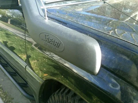

here are a few Safari pics for comparison. What is the metal piece on the side of the inlet on yours? That is not on the ARB
Looks like the metal piece you saw on the knock off intake is just how the in-let grill is mounted.
