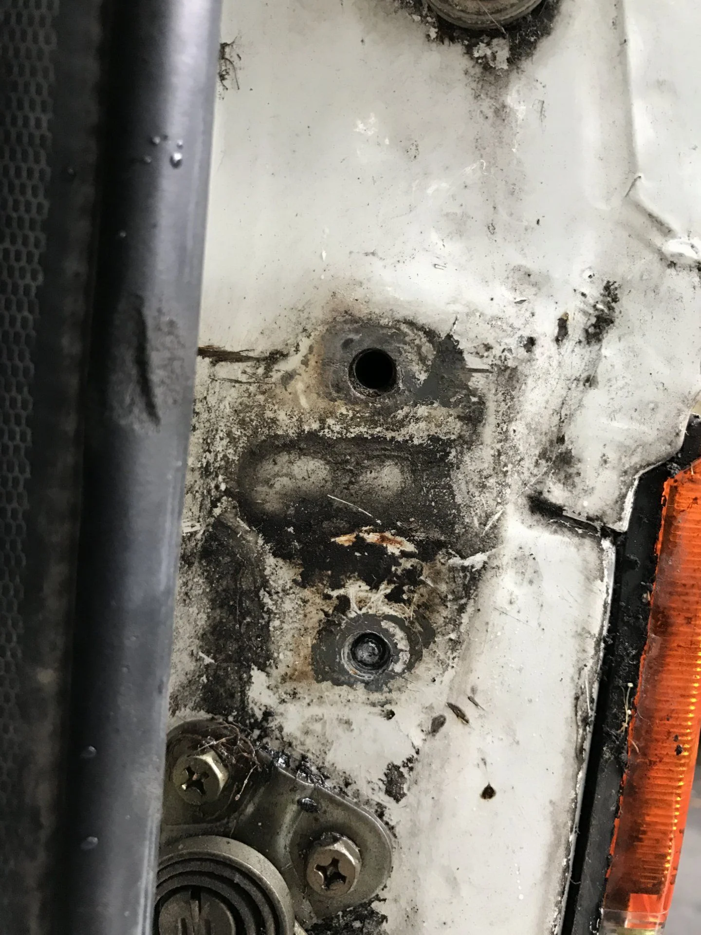

I was advised to tighten my rear brackets in order for my tailgate to be tighter and rattle less. While tightening, the screw broke. :bang:
I have no f**king idea what to do. I've tried to unscrewing with needle nose and I aint moving.

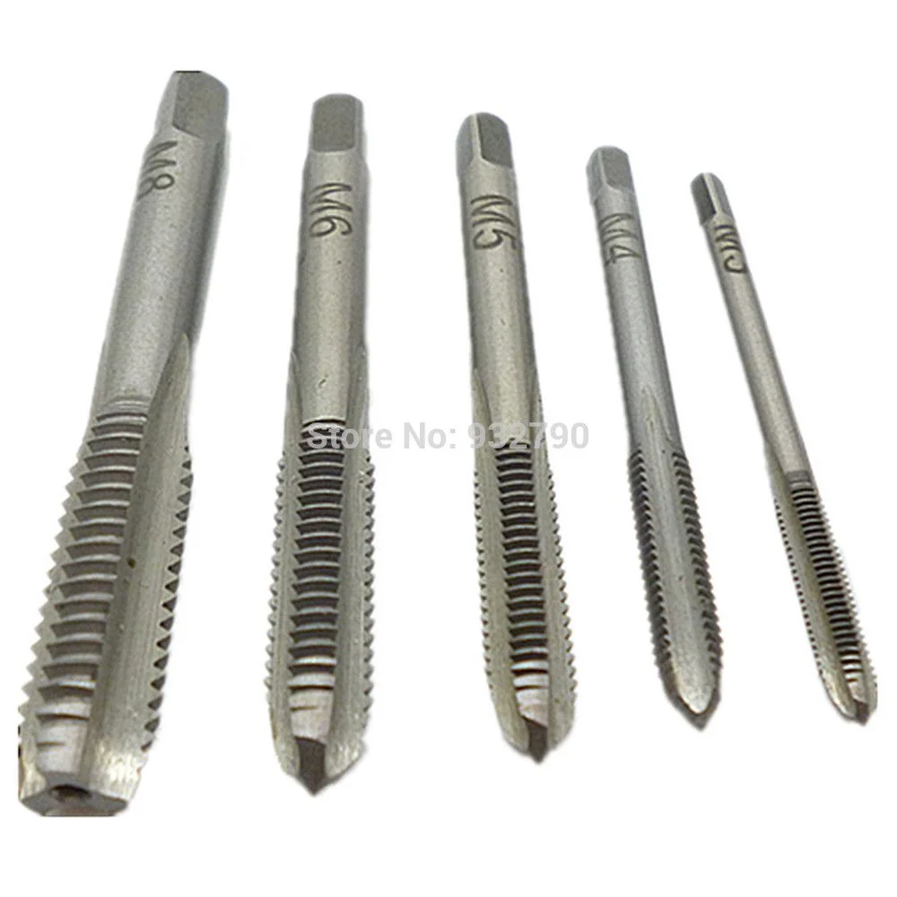

Sorry for my lack of understanding but what do I do with that? Does that go in the center of the drilled out screw?
Yes, the tap is what made the threads originally. The idea is to recut the internal threads so that the new screw doesn't break like the old one did. You can borrow (rent) one at NAPA or Autozone. It'll come in a set with a tap handle to turn it. Resist the temptation to use your crescent wrench.
Be sure to use some tapping fluid (it's really sticky oil, made especially for this purpose) and turn 1/4 turn in, then 1/4 turn out, 1/2 turn in 1/4 turn out, until you're at the bottom of the hole, or have gone all the way through. If the tap sticks, take it out, clean it, oil it with tapping fluid, clean out the hole as best you can, and try again. Do not force the tap into the hole; taps aren't screws. They are hardened steel and are brittle. If you break one in a hole, you'll do more damage getting it out than it's worth.
This may be a weld nut; I can't remember. If it is, you'll be done in about 30 seconds; if the tap sticks, and you force it, you may risk breaking the weld. I don't wan't to sound like Debbie Downer here, just trying to make you aware of what you're in for.
Remove the tail light and try to get at what's left on the other side...maybe. Vice grips, pub blaster.
Just spitballing here, I assume the screw turned, before it broke. If it did, you should be able to grind a slot in it with a Dremel tool, or something similar, and back it out with a really long screwdriver. If it wasn't moving, and it broke because it was rusted internally or from behind, you might have some luck with PM Blaster or naval jelly and penetrating oil, and then the screwdriver.
I mention this because if you drill the screw out, you'll have trash inside the body panel. I'm OCD; that would bug me.
