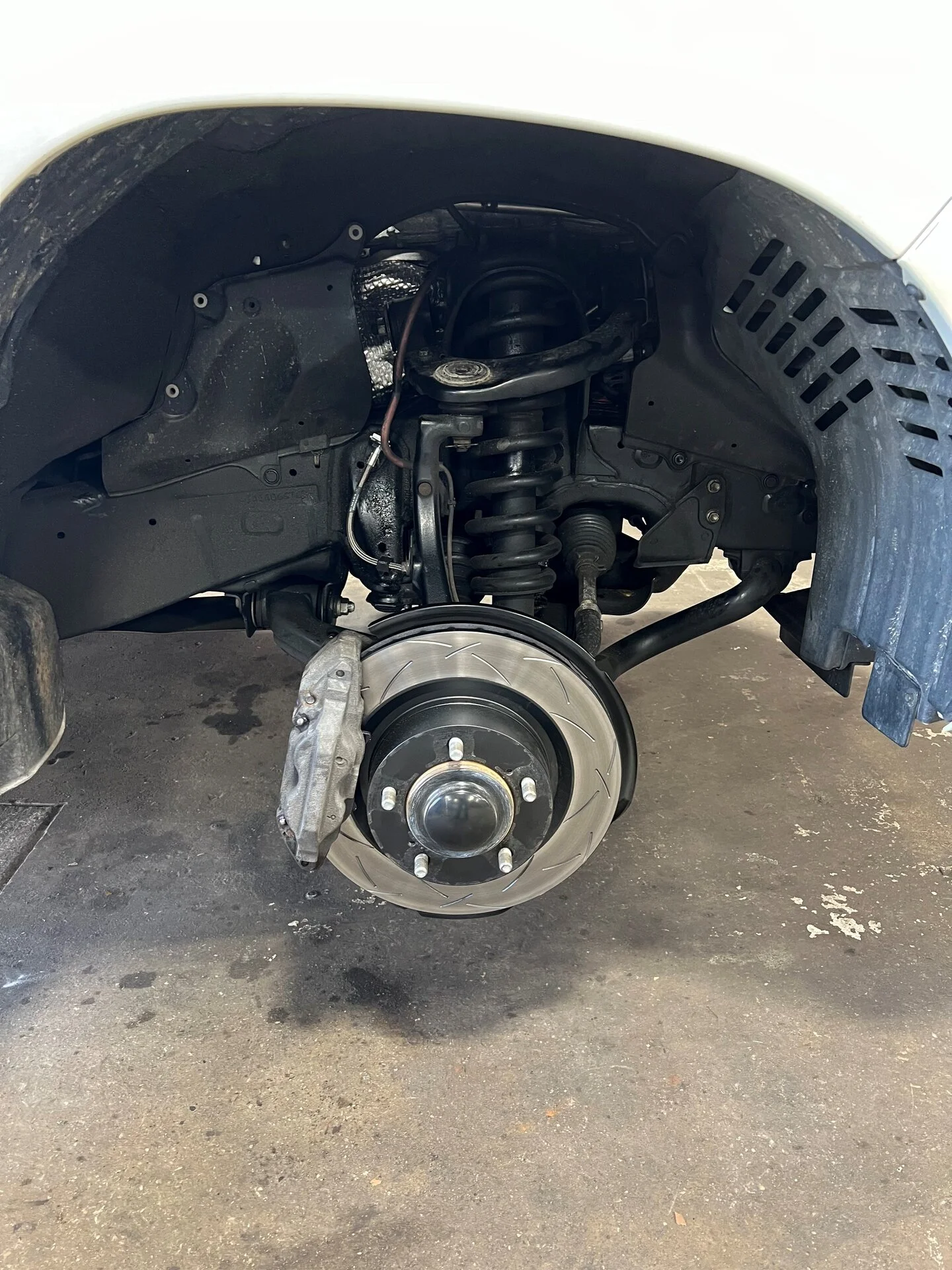

The brakes, rotors and hoses are done. It's still in the shop with the electrical upgrades. It's hopefully all done tomorrow.

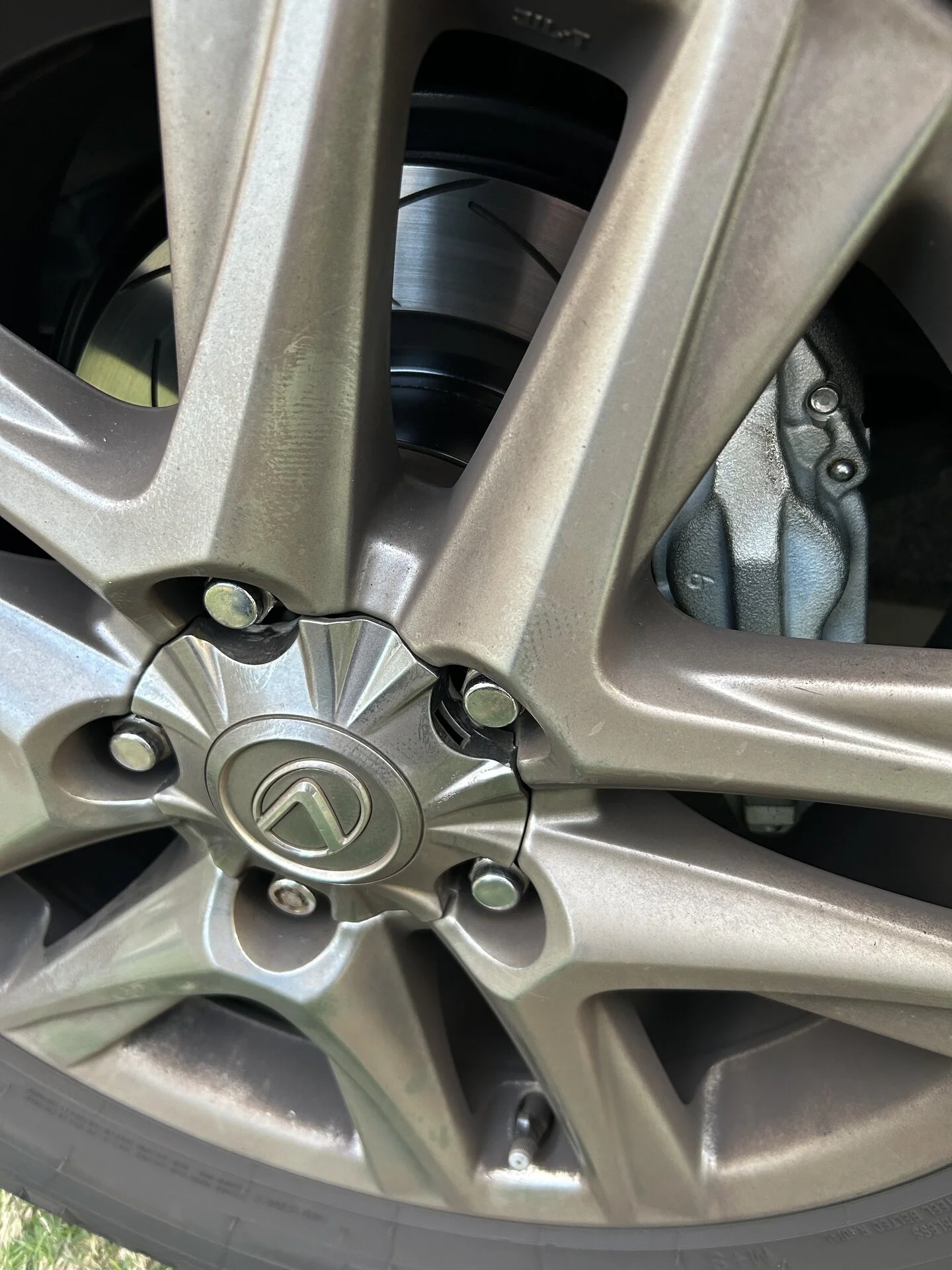

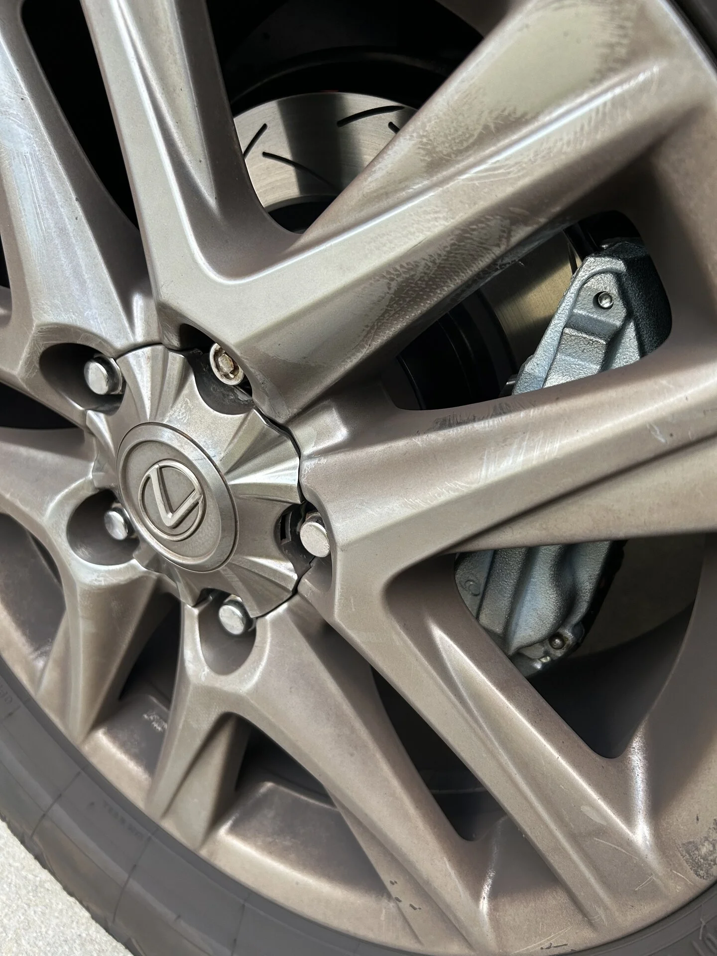

Very happy with my full DBA upgrade using 2016+ gear up front. To me this is how the truck should feel/brake from the factory. Have not towed or been fully laden yet but based on some tests coming off the interstate there is more than enough stopping power which should get me more life out of these than what I got with OEM equipment.
View attachment 3599690View attachment 3599692
