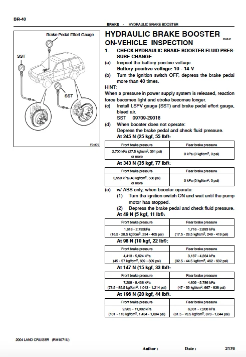

Before you spend money on parts & labor; have the booster pressure tested ( by someone capable and honest) In the FSM (service manual) in the Brake section (BR) (BR-40 in the 04 manual) Is the beginning page of testing procedure.
Roger that - great advice! Thank you.....

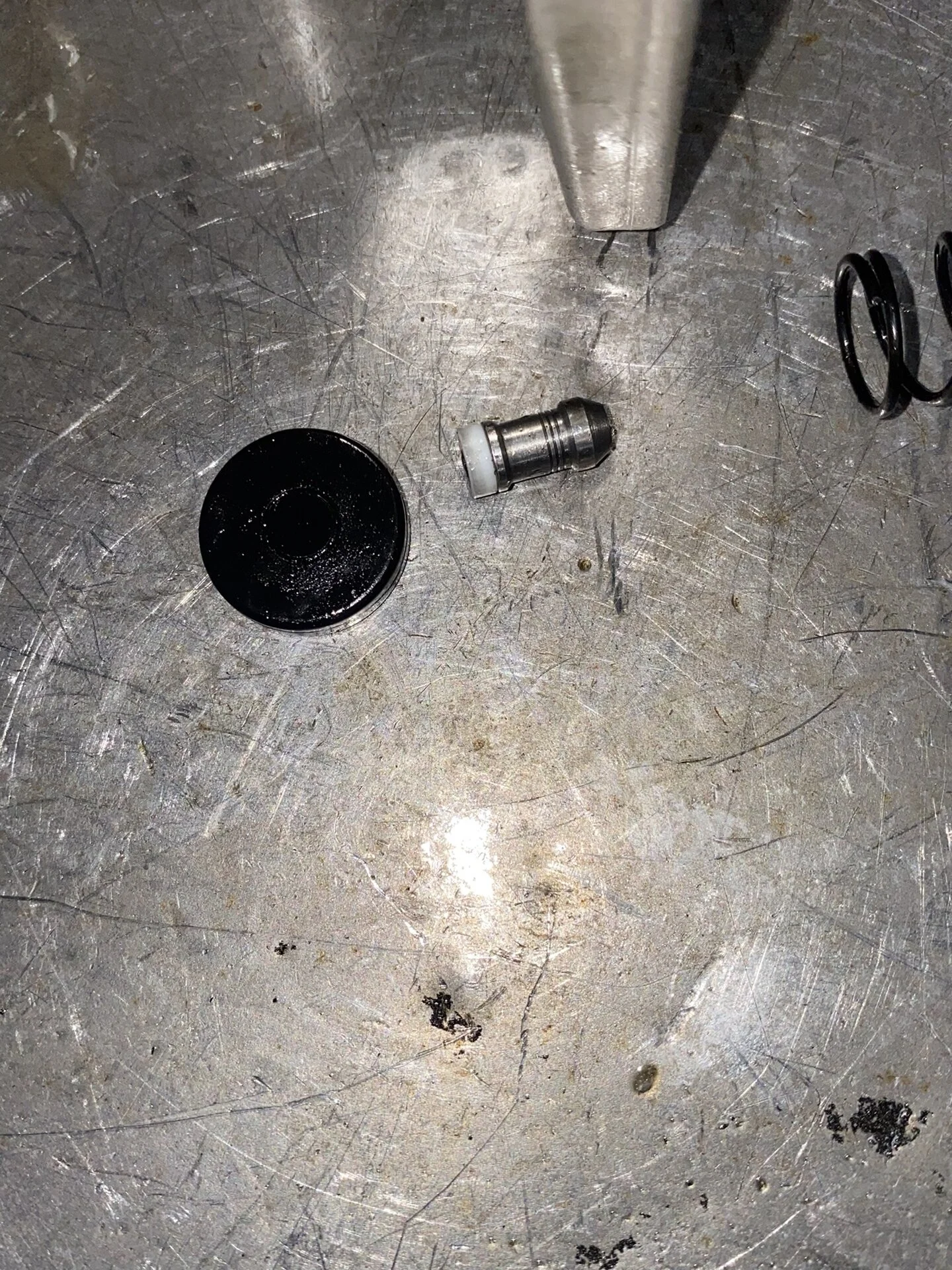

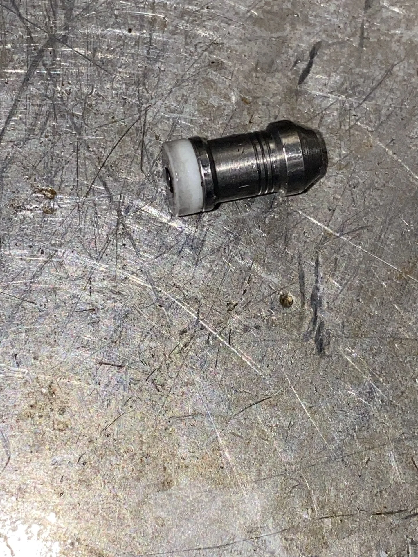

I updated post #2 with some pictures of internal master seals. I've never posted these nor seen anywhere before today. These are the seals, which any rebuilt master would need replaced. But to my knowlege, no one has. Which makes claims of a rebuilt master false IMHO, if not replaced.
Did you have to fab a custom tool to remove the plug for the inner seals?
Besides the one that appears to be a square cut o-ring, the others look like typical EPDM o-rings. Surely someone could put together a rebuild kit for one of these.
No, not for this tear down.
The manufacture locks in the thread end, by hits to the housing bending metal inward. I ground down the housing, not caring if damaging this one.
A way to unlock and relock, would need to be developed, first.
A few parts that may be harder to find than the O-rings.
