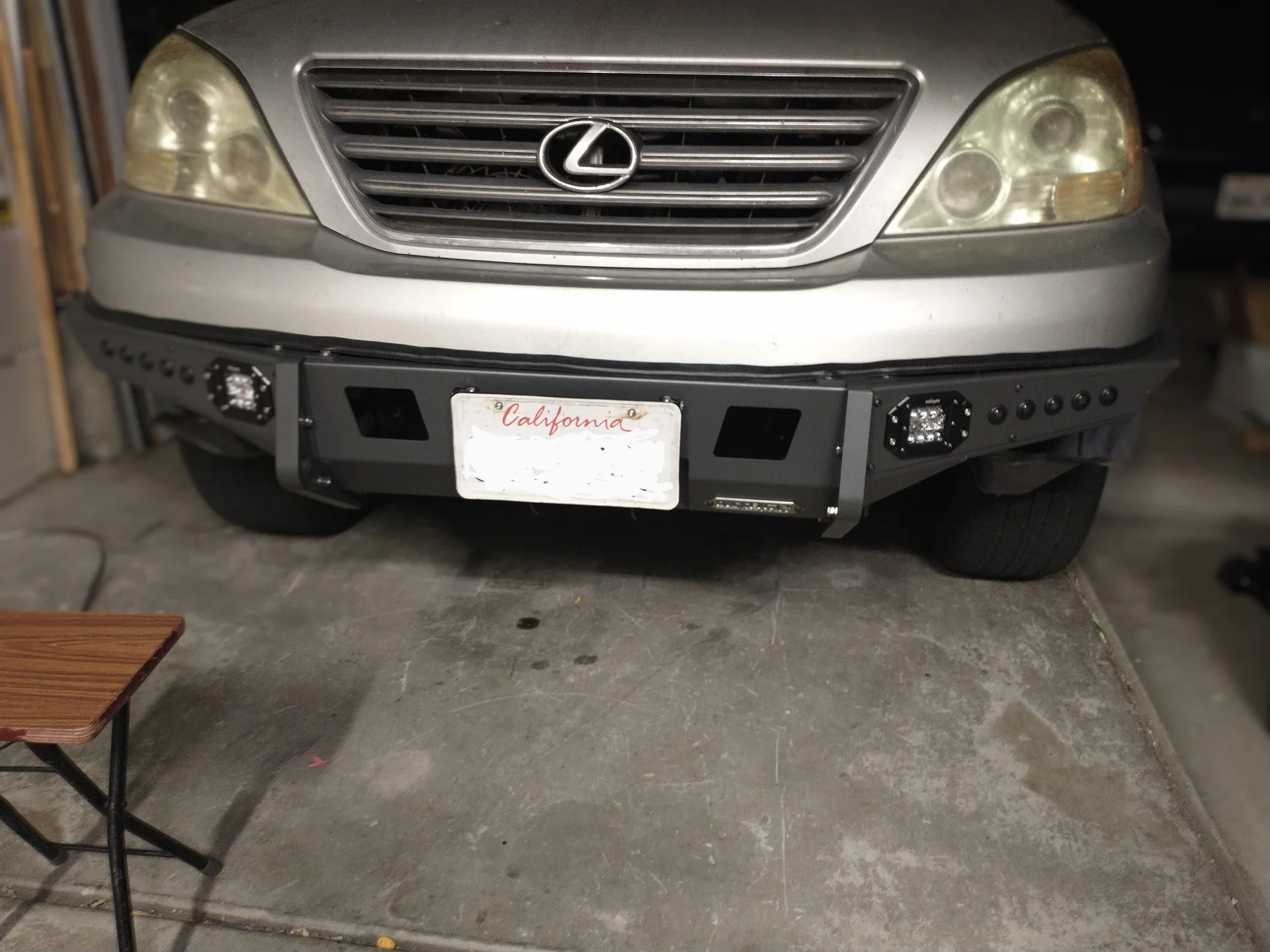

Dissent v1 front bumper installed with cheap nilight 3x3 flush mount and amazon smoked bullet lights 09/22

Added crazy expensive recovery points :p Need to massage up and trim the fender liners, get the rad rubber put in, relocate the windshield fluid and wire up the lights...was thinking about doing the 3x3 nighlights to the fog stem switch and then putting the DTRL on a switch with the bullets. Right now my DTRL only come on when the headlights are off.

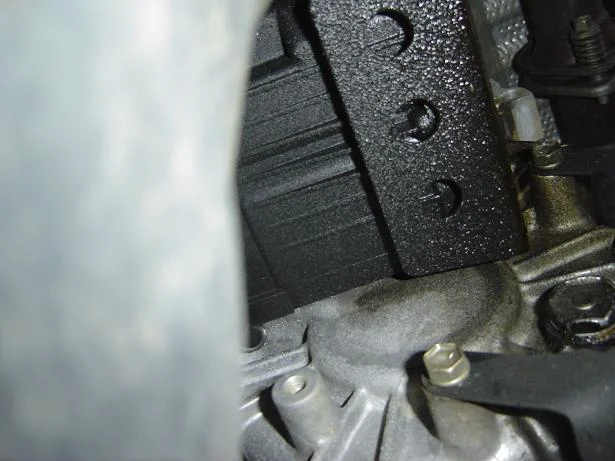

Did the o-ring replacement to try and stop the transfer case leakage from the actuator. Since the fluid is leaking from the transfer case itself, I am not optimistic it will fix the leak, but we'll see. Transfer case actuator was removed via the twist and pull method and was dry inside with no oil intrusion and everything was clean and free of corrosion and debris so I did not replace the shaft seal but have the parts from rocket seals.
