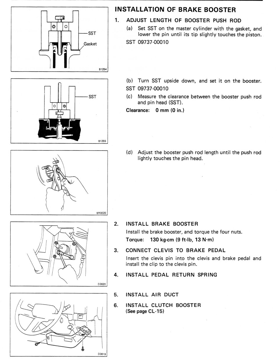

I have an 84 fj60 about 2 weeks ago my red brake light started flickering and the pedal went to the floor no leaking anywhere Reservoir remained full but I had no brakes I replace the master cylinder bench bled it first after I got it installed bled the entire system now seems like I Have partial breaks it doesn't go to the floor but I have to use quite a bit of pressure to get the truck to stop the brakes just do not feel the same any help would be appreciated
Did you adjust the booster to master pushrod length when you installed the new master?

no I didn't adjust the push rod wasn't aware I needed to do that any ideas and I'm also hearing a hissing sound when I press the pedal sounds like it's coming from inside the vehicle almost or right at the firewall
Hiss would lead me to check for a vacuum leak at the booster in the seal where the pedal pushrod goes through.

The 60's booster is weak compared to the 62's. '95 4 Runner booster is the same size as the 62's and the 80's and usually available at your LAPS (probably Cardone brand). The mod will require an external check valve (the 62's is steel and is exceptional) and, because it is slightly thinner, you will need to bend the brake lines a few degrees. Bench bleeding the master and checking the booster pin/master piston relation is essential.

can you explain the booster pin Master piston relation a little bit more do I need to make an adjustment first time doing this
