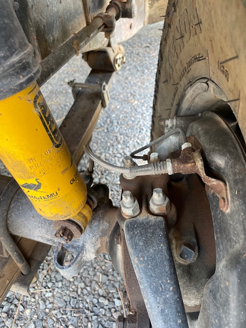

What OEM brake hose is everyone using for the front axle disk brake conversion to go from the axle to the backing plate.?
For my 1971 FJ40 I did the FJ60 knuckle and disk brake swap. I have searched many many threads for the disk brake swap and have not found a reference to a OEM hose that everyone uses. I took a guess and got the brake hoses for a later FJ40 (1980-84) with disk brakes (Part number 96910-32305) When mounted the bake hoses look a little short when at full turn . I assume that the fixed point on the axle where the hose mounts is different between earlier drum brake axles and the disk brake axles

Based on the photo you provided, it doesn't look short at all.
It really doesn't look too bad. Turn in your steering stops and check again.

I agree it isnt horrible but it does seem to me to be close to the limit for those hoses which is why wanted to check what others were using I will adjust the steering stops once I get the axle fully installed and see how they are at full turn.

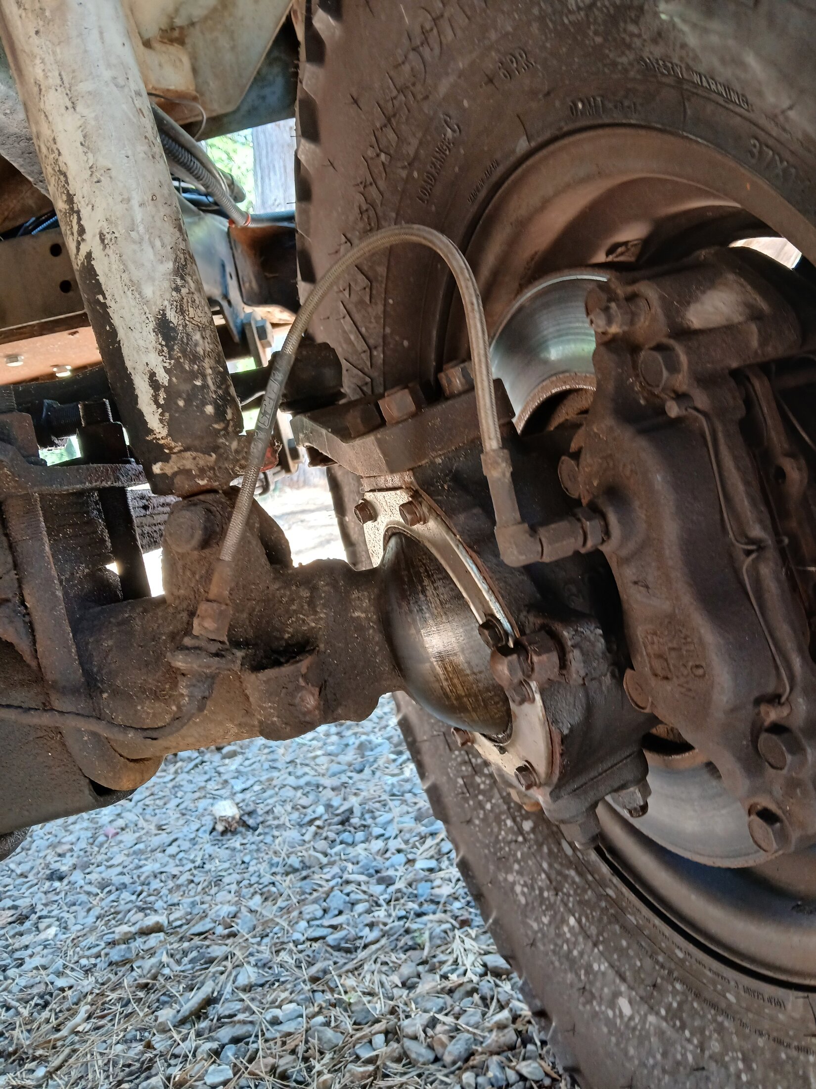

I think it depends what backing plate you're using, if any at all. Keep in mind, stk, the line goes to the plate then a hard line goes to the caliper. It is more difficult to remove the caliper. You need to remove the 3 bolts that hold the elbow to the plate. Then remove the caliper. It's sort of a pita. In Jim's pic, it's easy to remove. I run a stk 40 plate, hose and hardline. IDK about 60 plates.
The problem with +80 backing plates is they need an inverted flare style hose. Virtually all OEM inverted flare hoses use the 17mm hex mounting tab Vs the 14ish mm round like the pre 78 hoses.
To solve this I made these handy mounting tabs to replace the originals on the axle housing. You can locate them in the +80 location more on top of the axle housing instead of the side.

The 17mm hex vs 14 mm round is probably why I am having trouble getting the retaining clip on the brake hose. I thought it was that the POR15 paint on the tabs was a bit to thick. I will take a look at it later.
