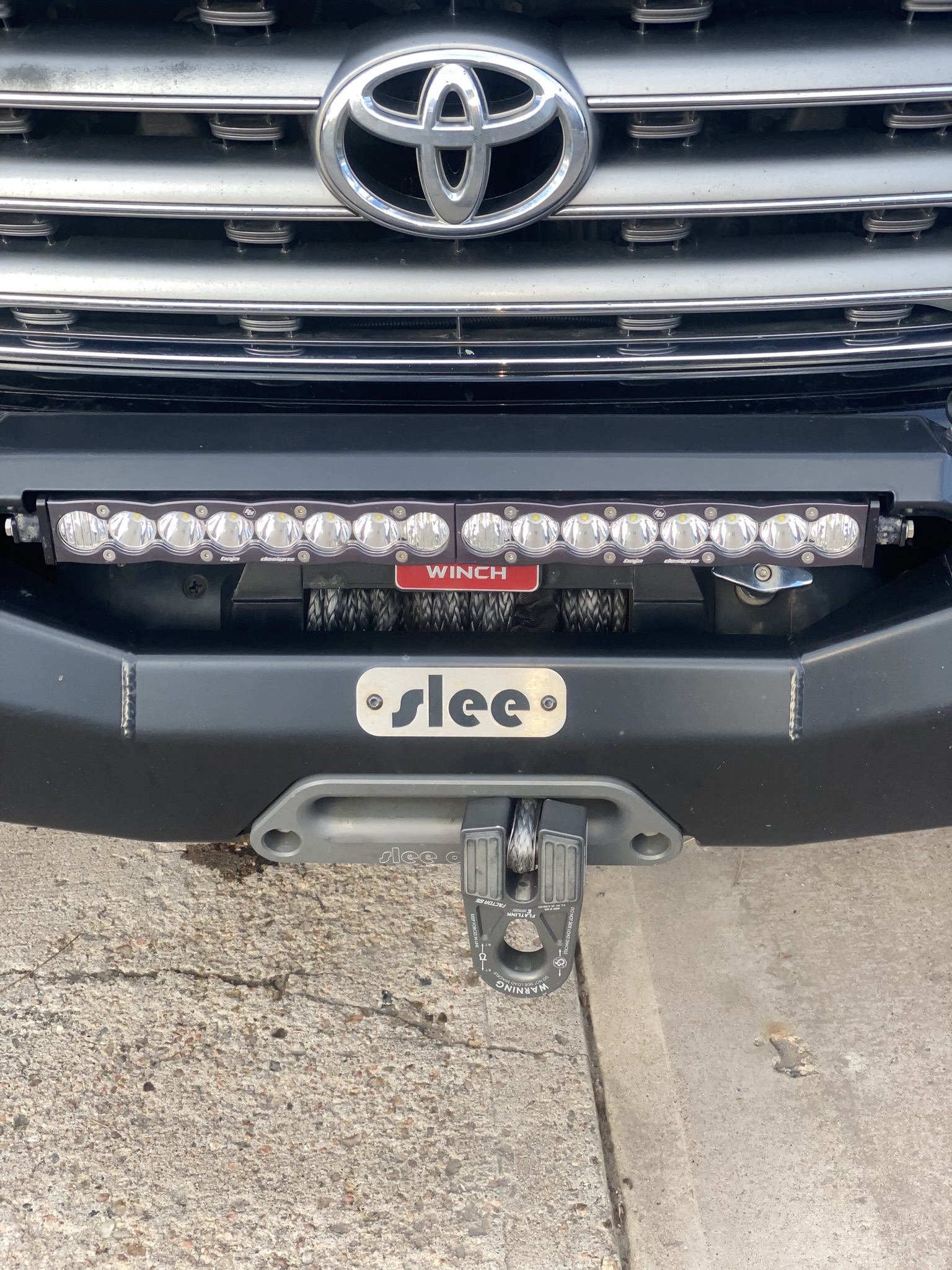

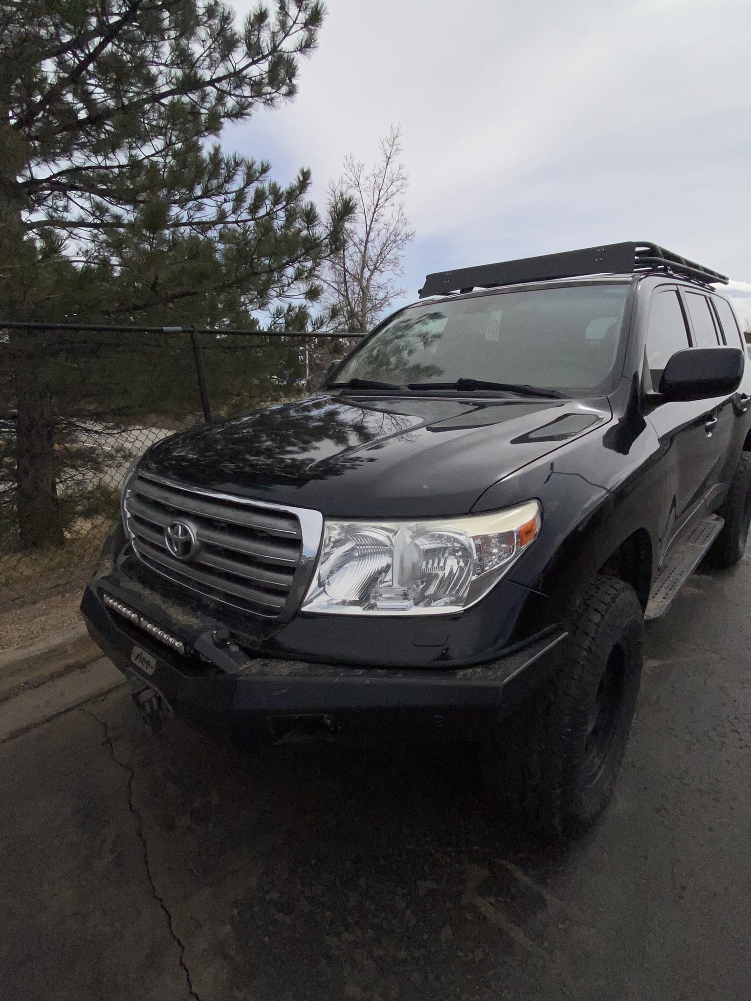

Meet BlackBeauty: ;)
I bought this Slee built 2011LC, with blown engine. After Dealerships quote PO, $35K R&R blown engine. It been sitting 3 months now. I've not even had time to buy an engine for it. I hope to have in shop before winter. I may just sell, as is!
This 3UR blew a piston out the pan, or parts of piston.

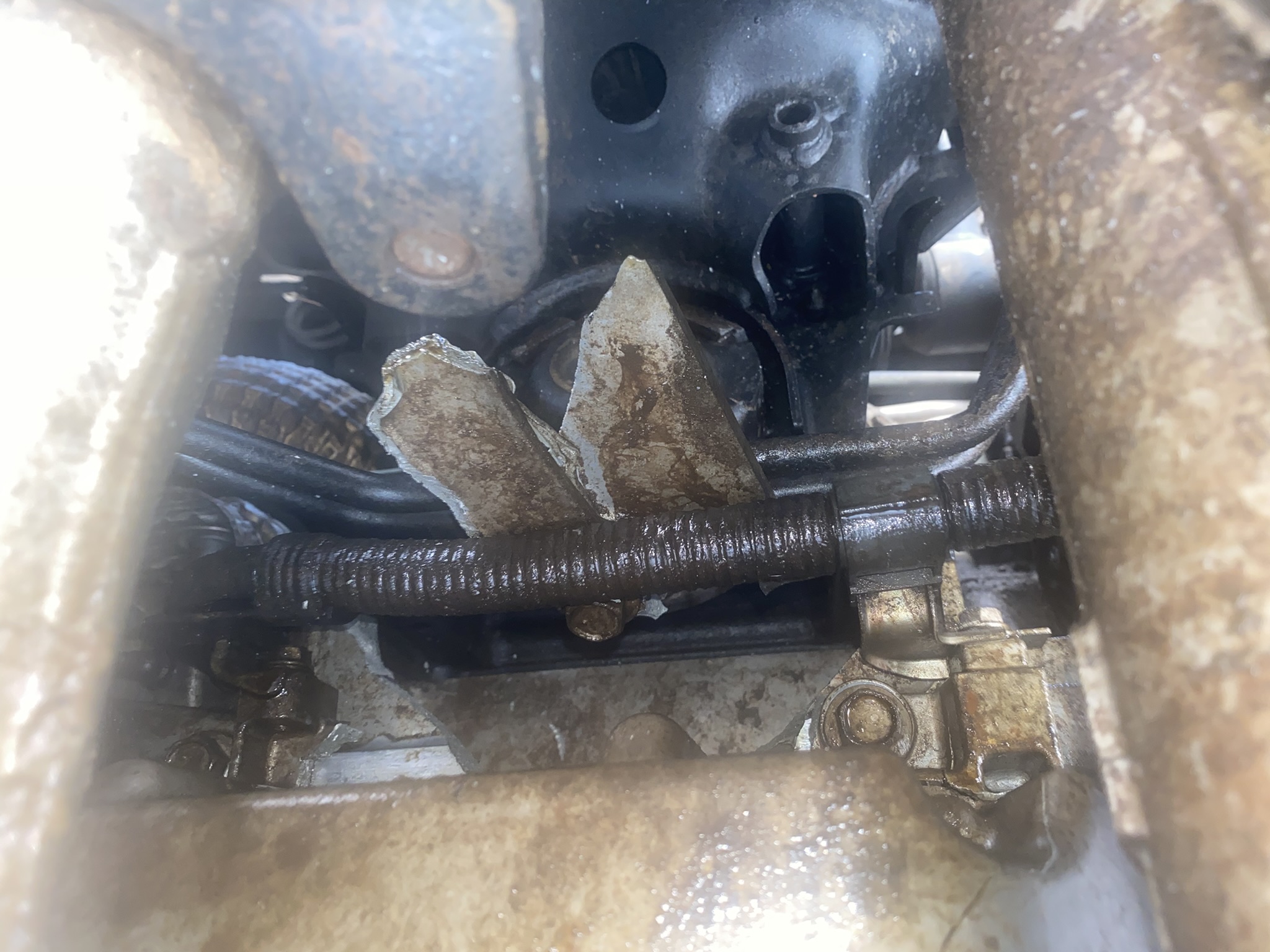

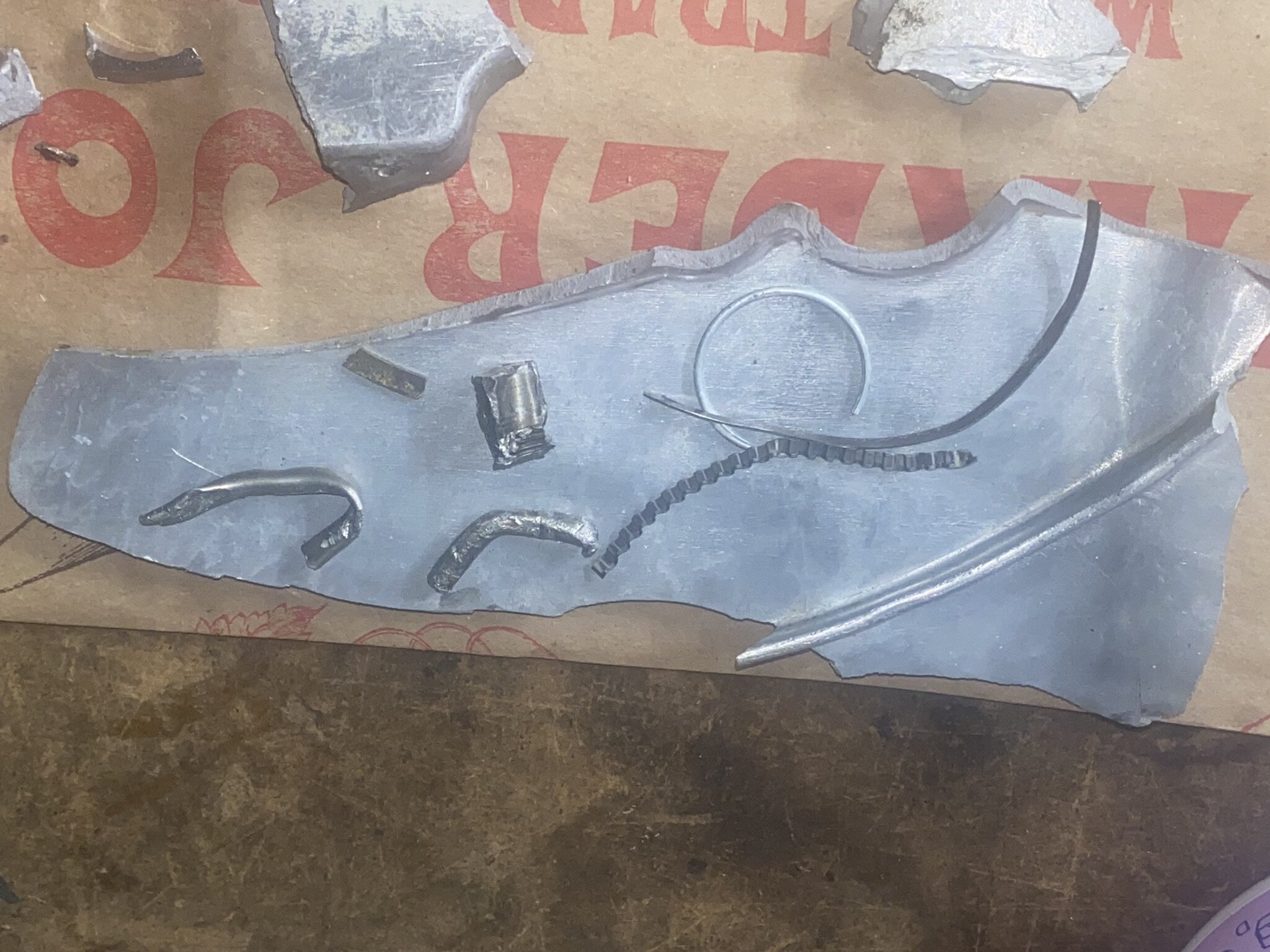

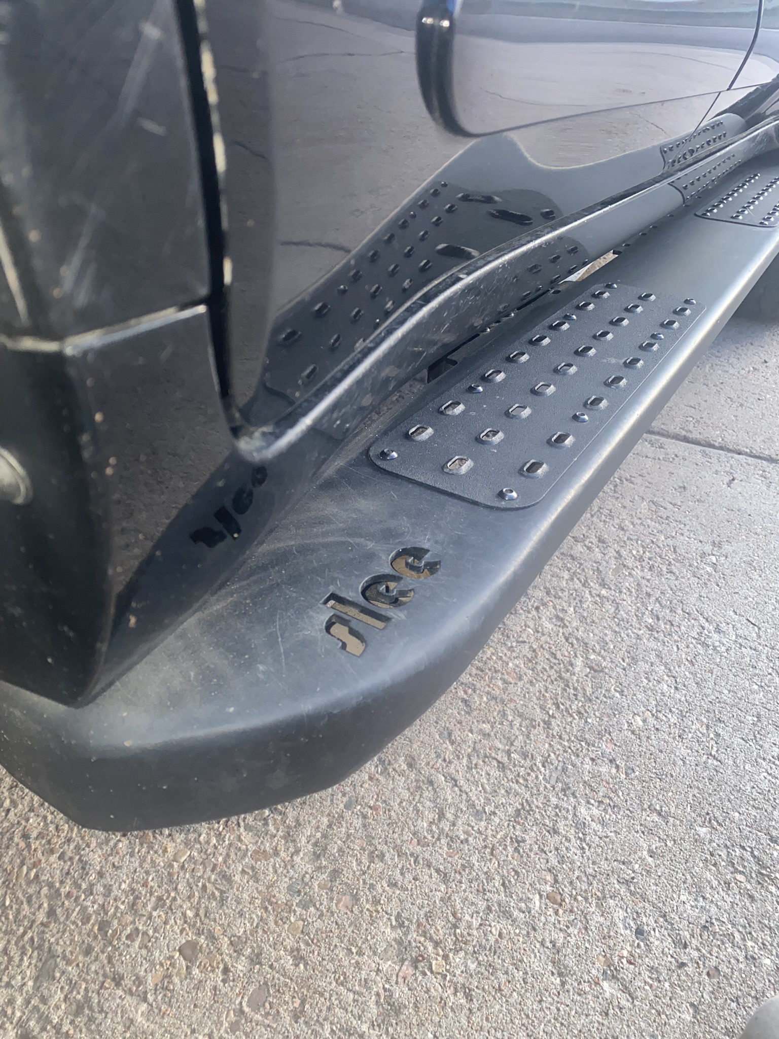

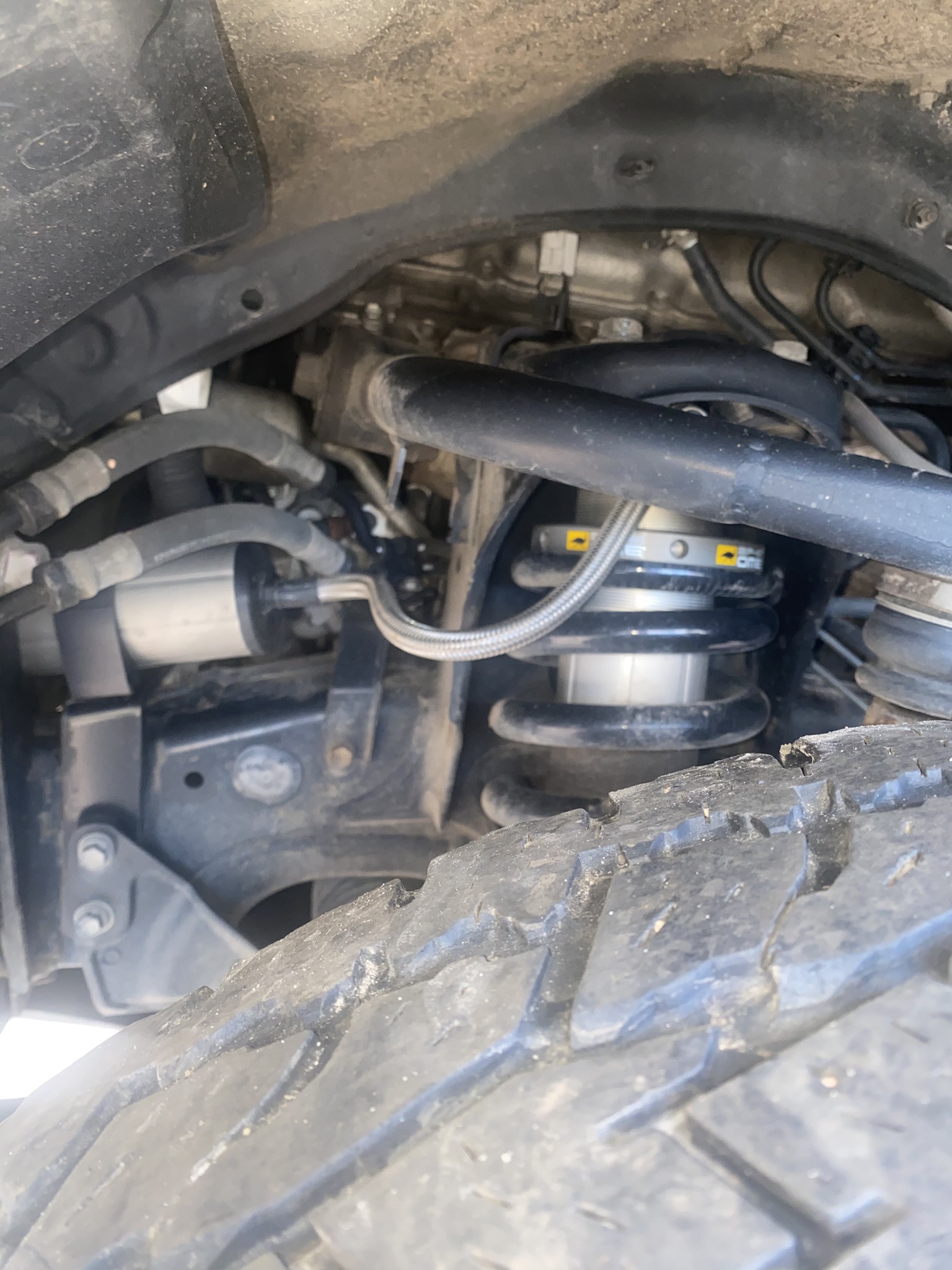

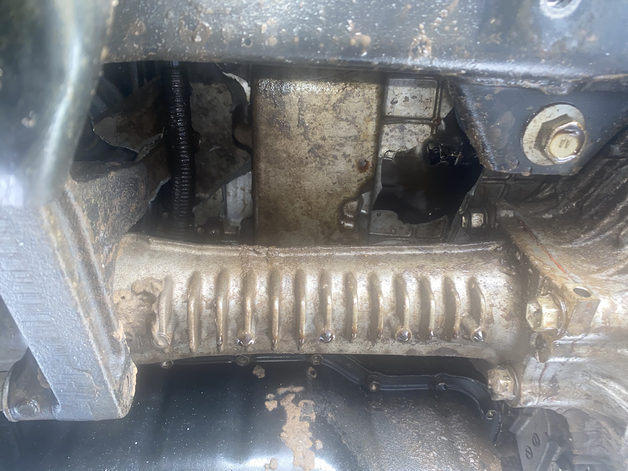

View attachment 3936008View attachment 3936007
.View attachment 3936009
View attachment 3936011View attachment 3936010
View attachment 3936015View attachment 3936016View attachment 3936014
