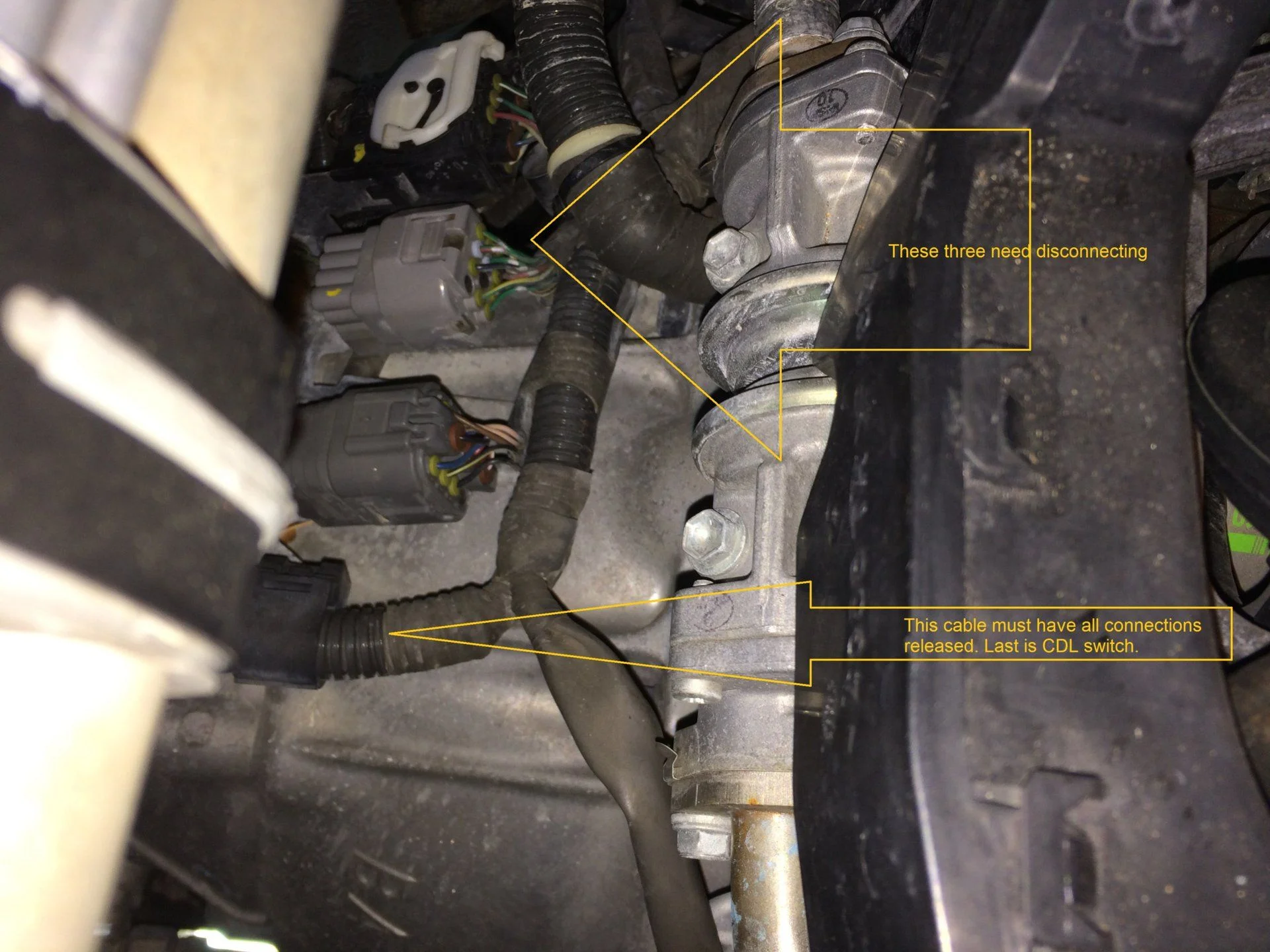

Was a pain getting everything disconnect from transmission while in vehicle. But traded off as other stuff didn't need to be disconnected, like linkage, propeller shafts, supports, etc. as would have if pulled w/trany. Separating at bell housing is also the way two shops I talked with do it.
CDL switch:

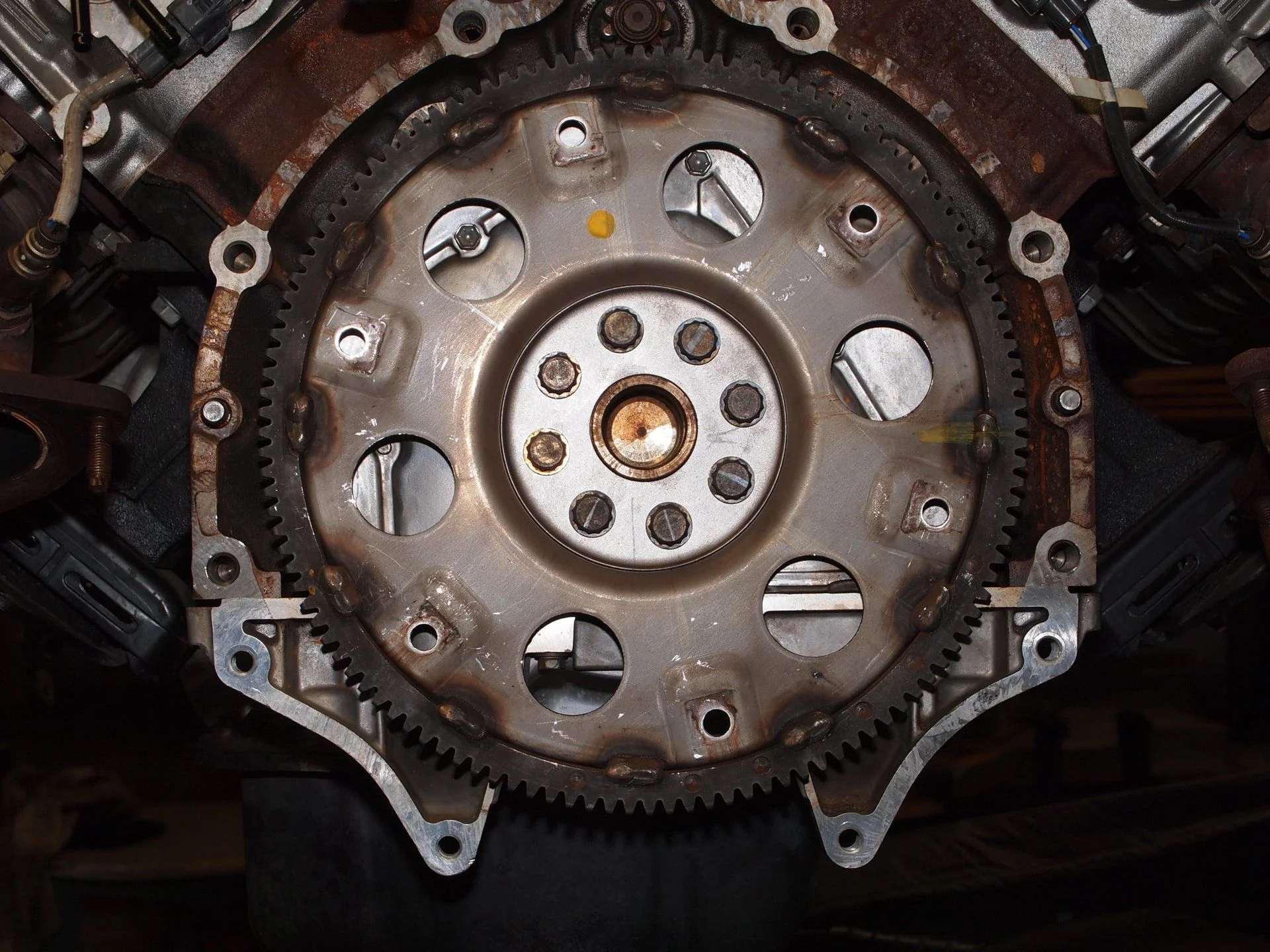

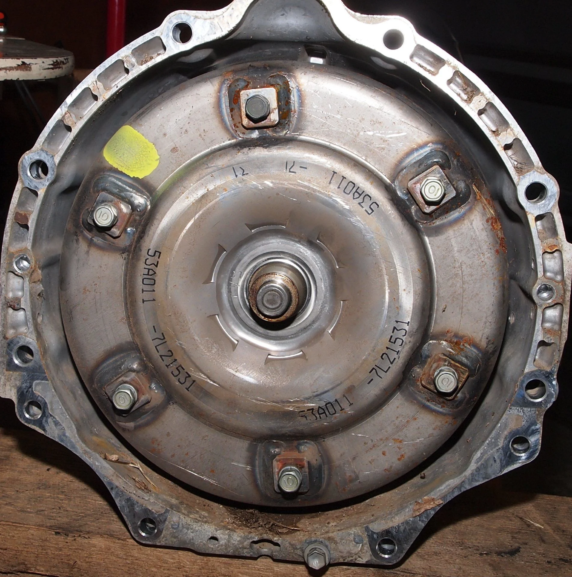

My biggest concern will be install. The concern here is lining up the pilot shaft of torque converter with pilot hole in crankshaft. This I've been told is a pain and bolts should not be used to pull engine into bell housing to seat, which can bust ears off bell housing. That it can take two or three man team to get aligned. For this reason I can see where having transmission attach to engine (as FSM directs) for install would make life easy. It will be a challenge.
Pilot shaft of torque converter must match with crank shaft and seat.
Example of transmission I have in the shop, with torque converter in place. You can see pilot shaft in center. A side note: notice dirt at bottom of bell housing. This was from water washing engine, flowing down into valley washing mouse nest attop valley into bellhousing. From engine of a 08 4runner I have.
Water runs out drain holes in back of block below starter mounting point into bell housing and out bell housing weep hole. You see the valley in some of my other threads for starters or A.I pump jobs. I'll post up a picture in this thread if anyone needs.

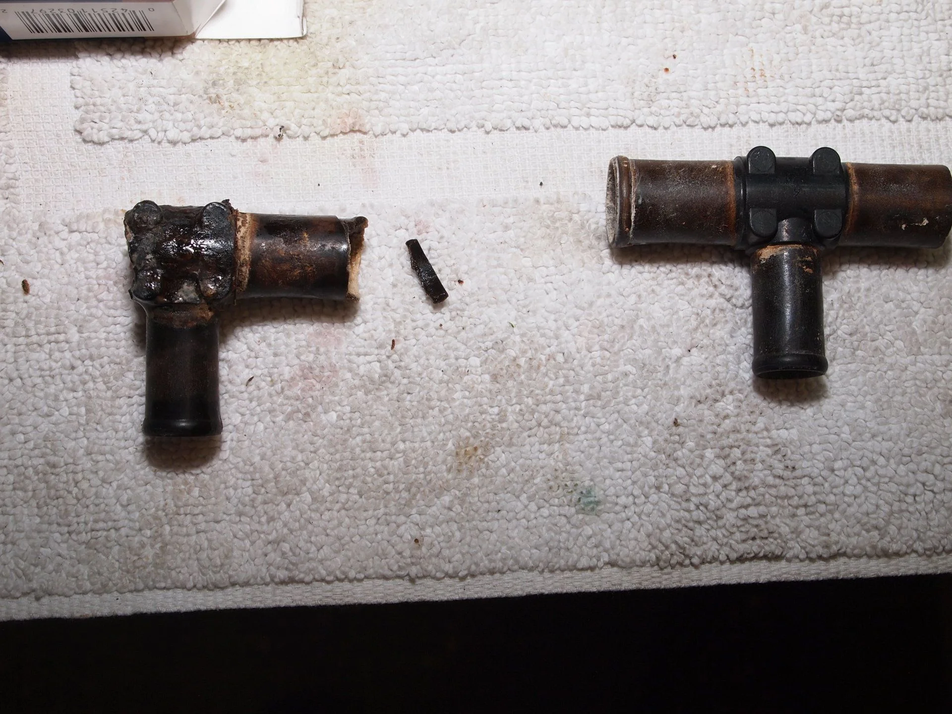

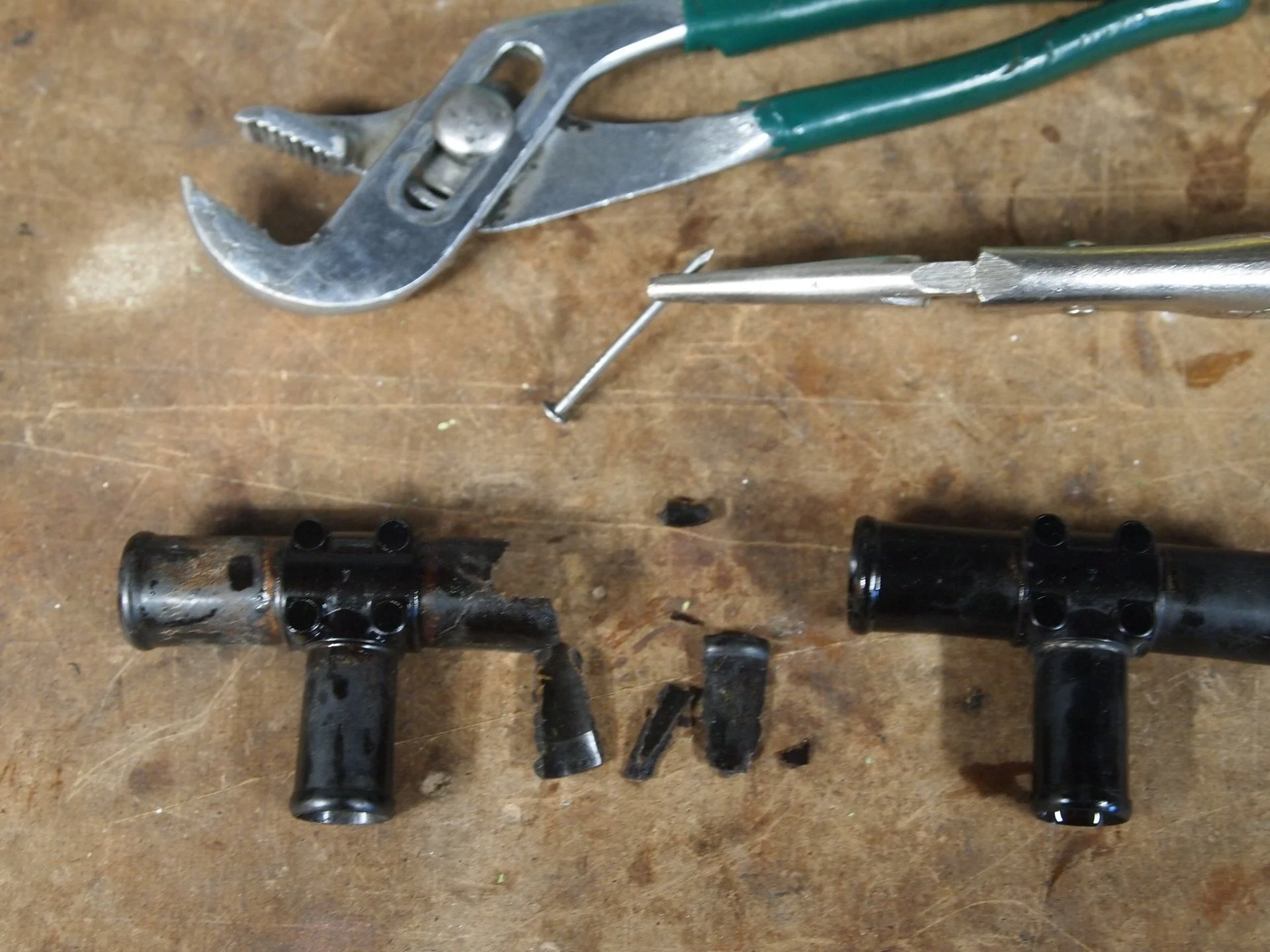

This is what the Tee's looked like on first inspection. It was obvious during inspect the plastic got very hot, looks as if melted. My first thought was heater Tee leaked coolant which lead to overheating. But, only 10 year old plastic tee breaking with relatively low miles leaking that much? Makes me wonder could sometime else caused overheating. "It's the chicken or the egg store". Interestingly my older 01 at~~17 years old Tee's looked better.

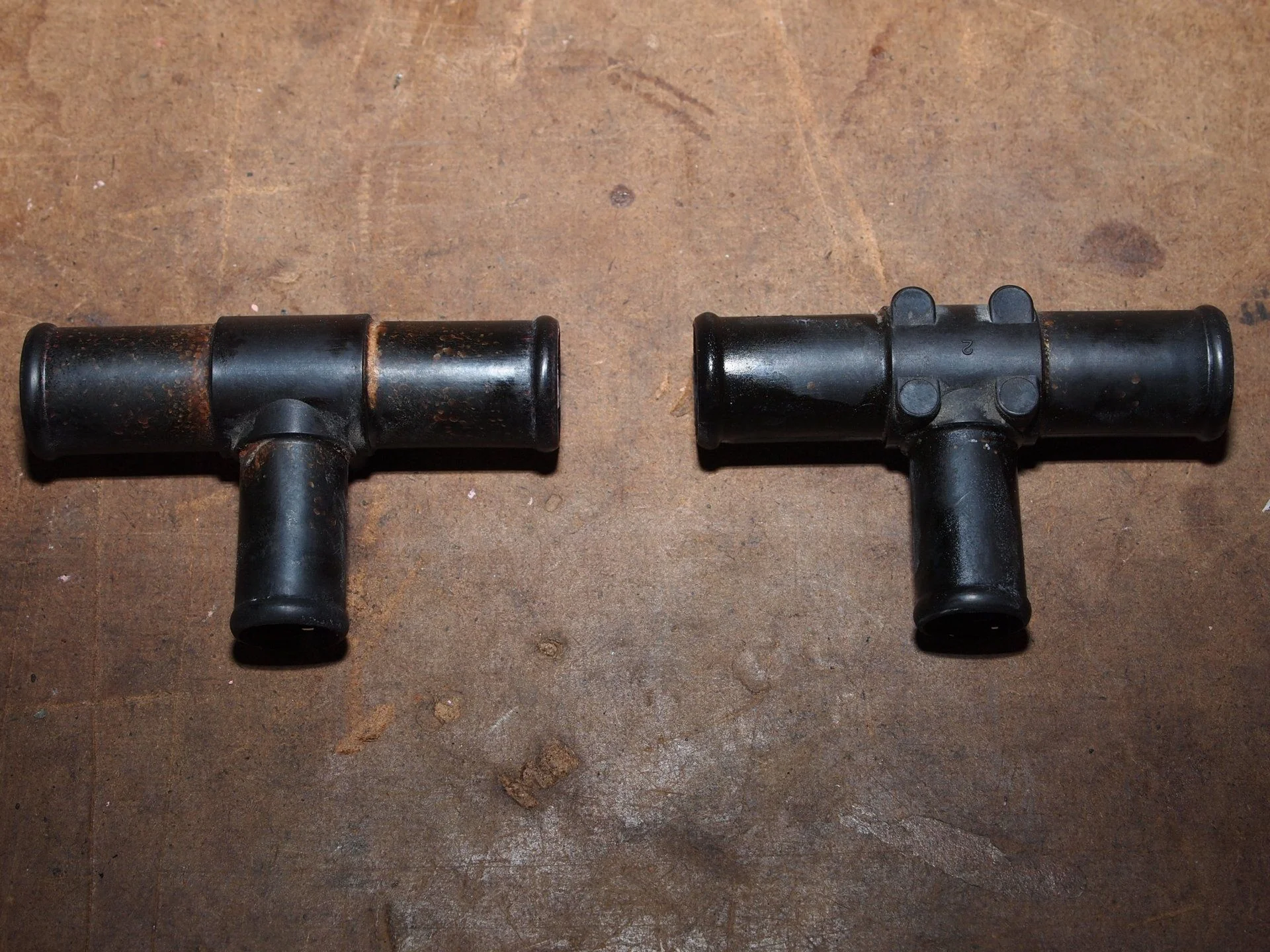

My thinking was, maybe something else happened, that then resulted in Tee's being damages. I mean, really they aren't that old.
But then I replaced The Black Knights (06LC) w/59K on them. Now I'm thinking either the Toyota SLL pink coolant is harder on plastic Tee's or the plastic is not as good as seen in the older systems that use Toyota LL red. Also the return side on the 07 Unicorn looked very aged also, more than I'd expect or seeing at 10 years.
A second possibilities as to cause:
Possible when Dealer did coolant flush 20k miles and one year earlier they didn't burp properly (air in system). Then PO drove, what was likely HWY miles, on low coolant. It could have been running hot for sometime taken out the heater tees then head gasket or visa versa. "Chicken or the Egg story"
The Black Knight 2006 LC with ~59K. (11 year olds)
The King 2001 w/165K (17 years old)

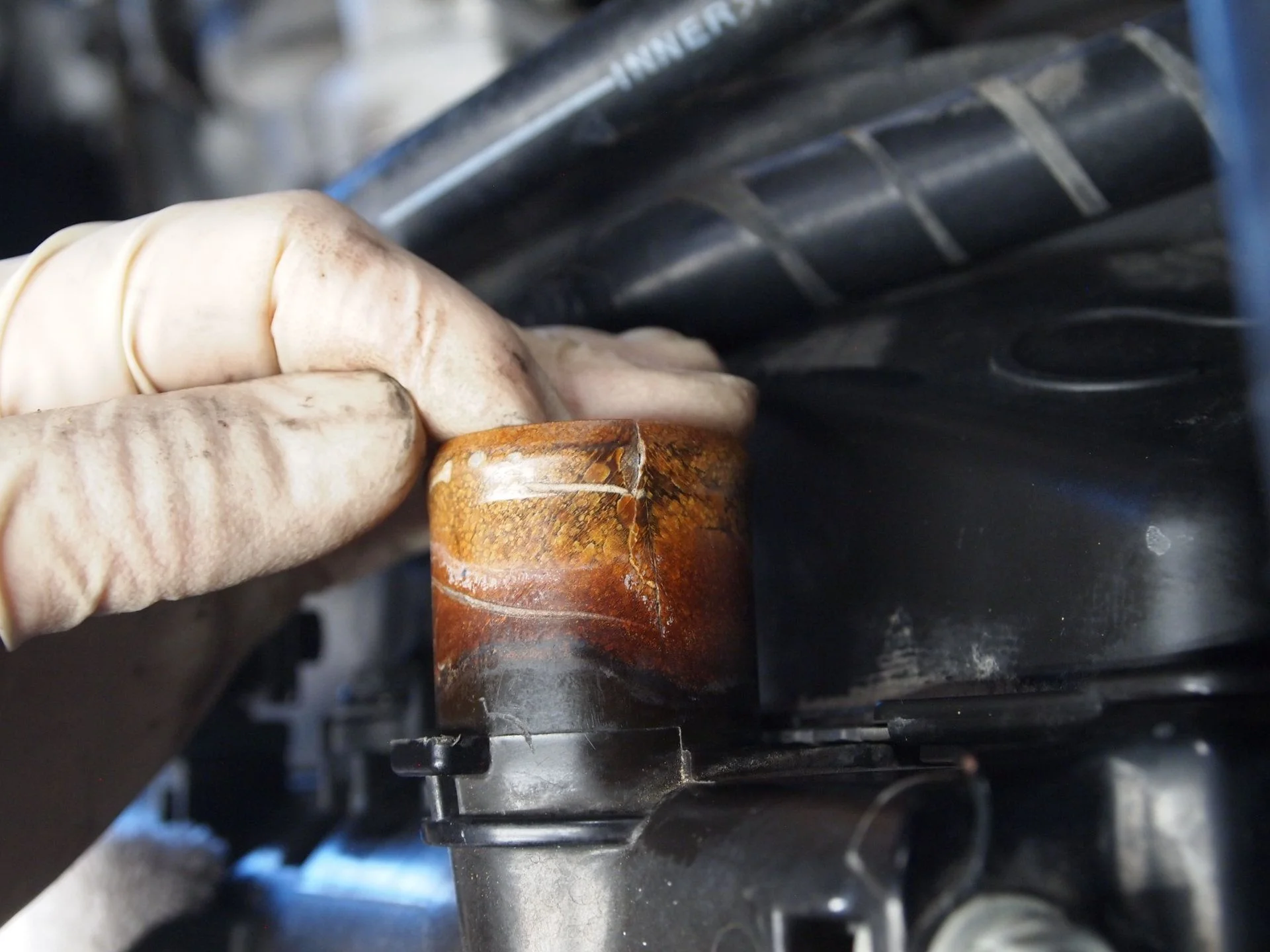

I also found Radiator upper hose gooseneck cracked presumedly heat of either fluid or from hot combustion gases??? looked very age?

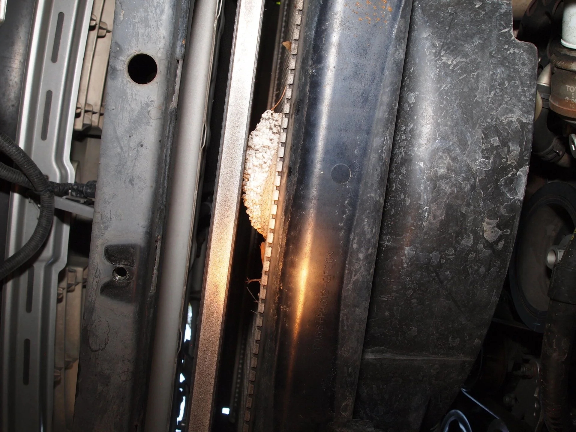

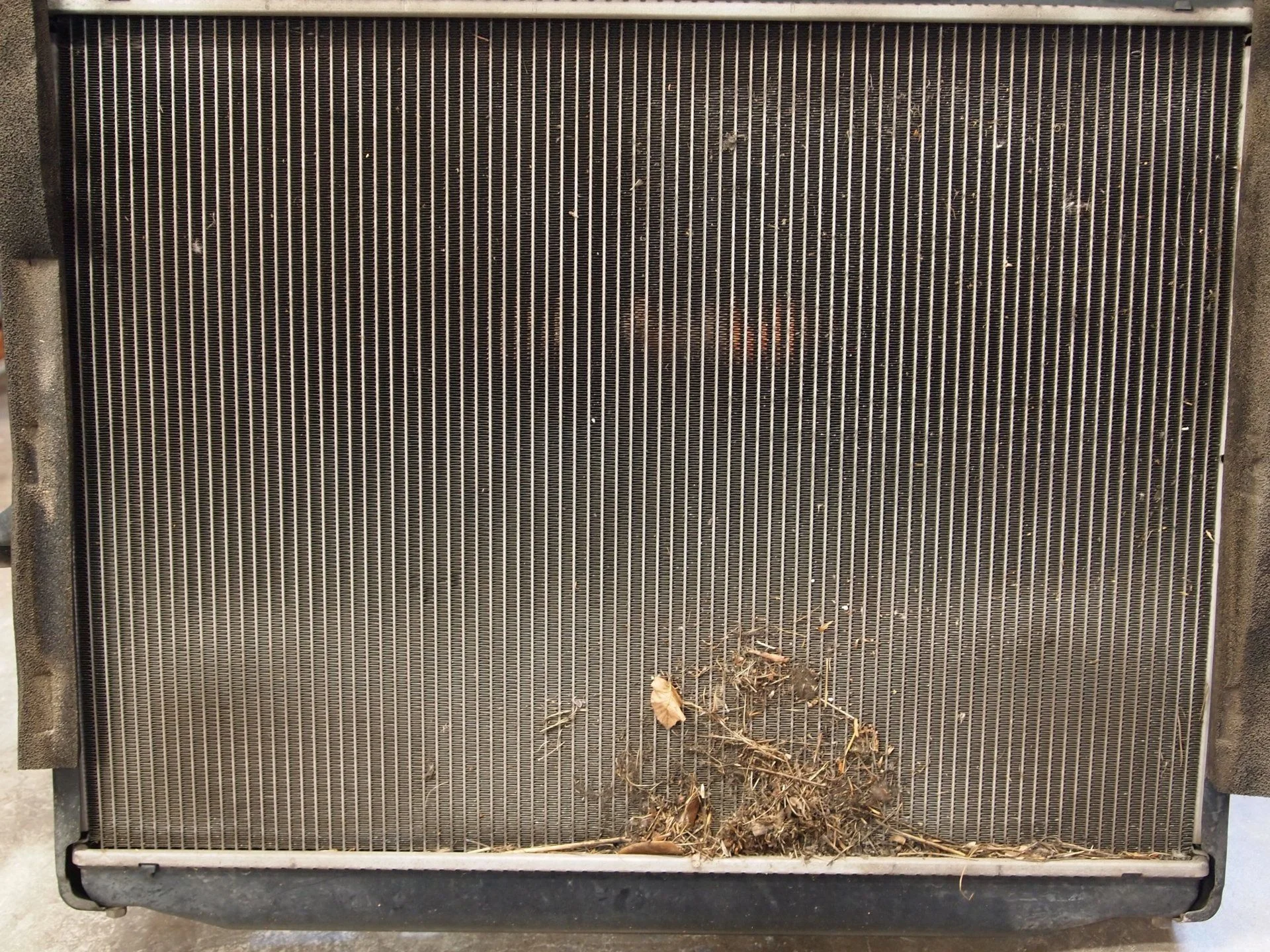

Additionally I found debris which included some styrofoam, on front of radiator and a shadow line indicating possible air flow blockage of lower ~25% of radiator cooling fins.
Clues :hmm: I've a few more it was running hot for some time.
So I can not say heater tee's was the start of the issue.
But I'm reasonably sure overheating took out the head gaskets.
