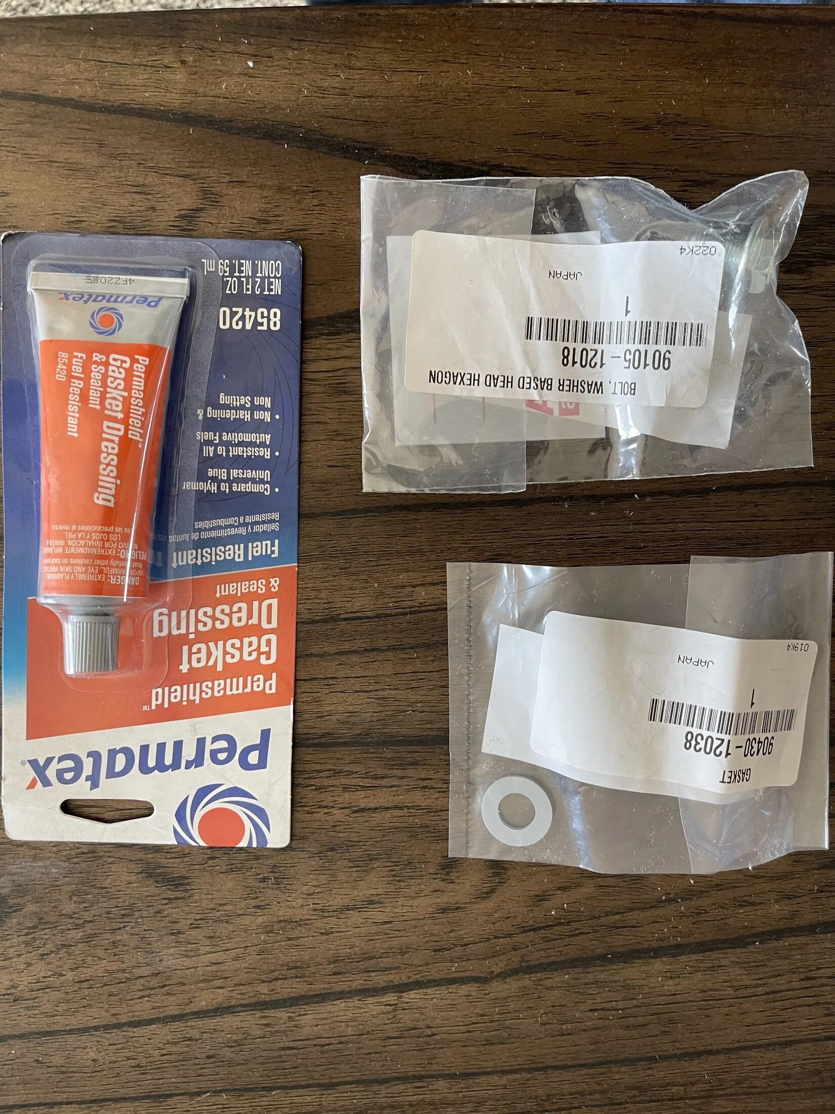

Thanks to @J Mack for permashield trick, had order that since O reillys doesn’t carry nor did Napa locally. Finally got plug and gasket from Toyota of San Diego thanks @PabloCruise.

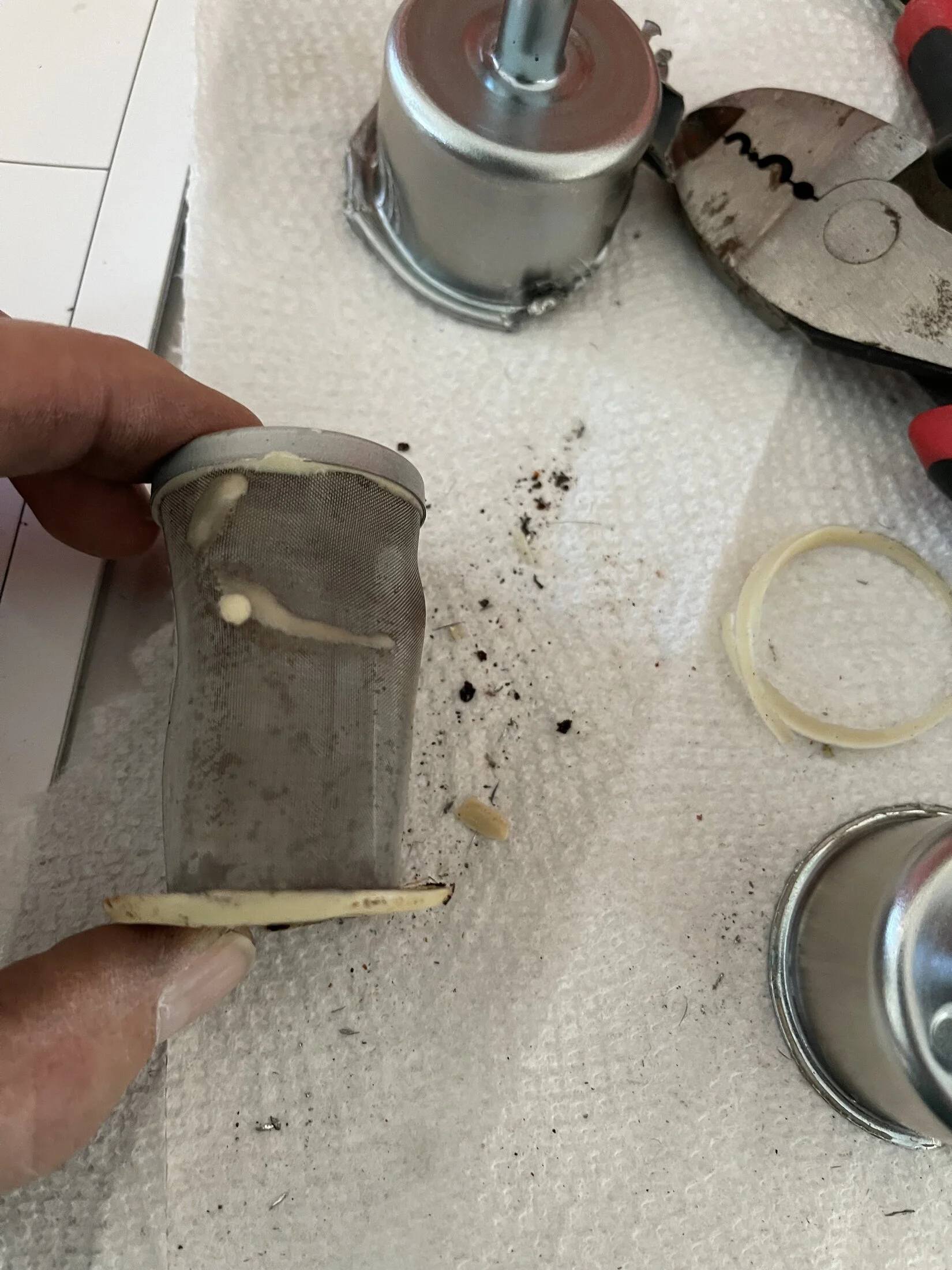

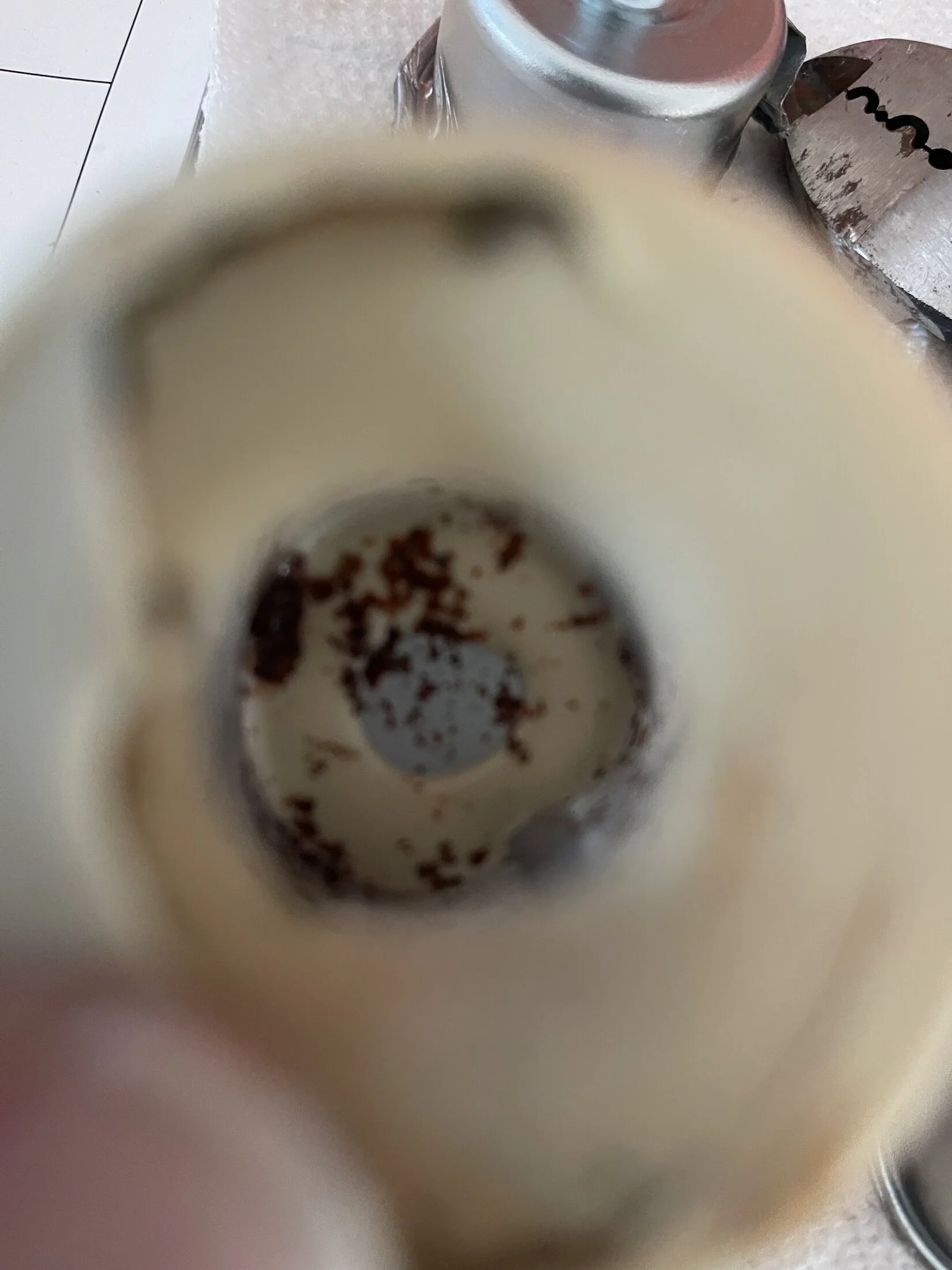

That’s a lot of junk for a new filter!
Is the Franken…, er, I mean, Bonnie, suffering from a rusted tank with plugged up pick-up line???
Seems to be a contagious disease going around the sty!
Hard to say if old or new tank since this filter was replaced when I had original issues.
I do anticipate some debris with new tank I flushed but figured I would get further along before changing the filter. Plan was full tank, run it low and swap filters for next few tanks of fuel.

Evapo-rust will do a good job on light surface rust but heavy flaking rust is something different, I don't believe it will break that down in the amount of time you would normally let it soak.
Those chunks in your filter looked large in that photo you posted and could be blocking a line in your tank. A speedometer cable will work in a pinch to "Roto-Rooter" out a plugged hard line.
Blow air backwards and it should flow freely with the cap removed.
