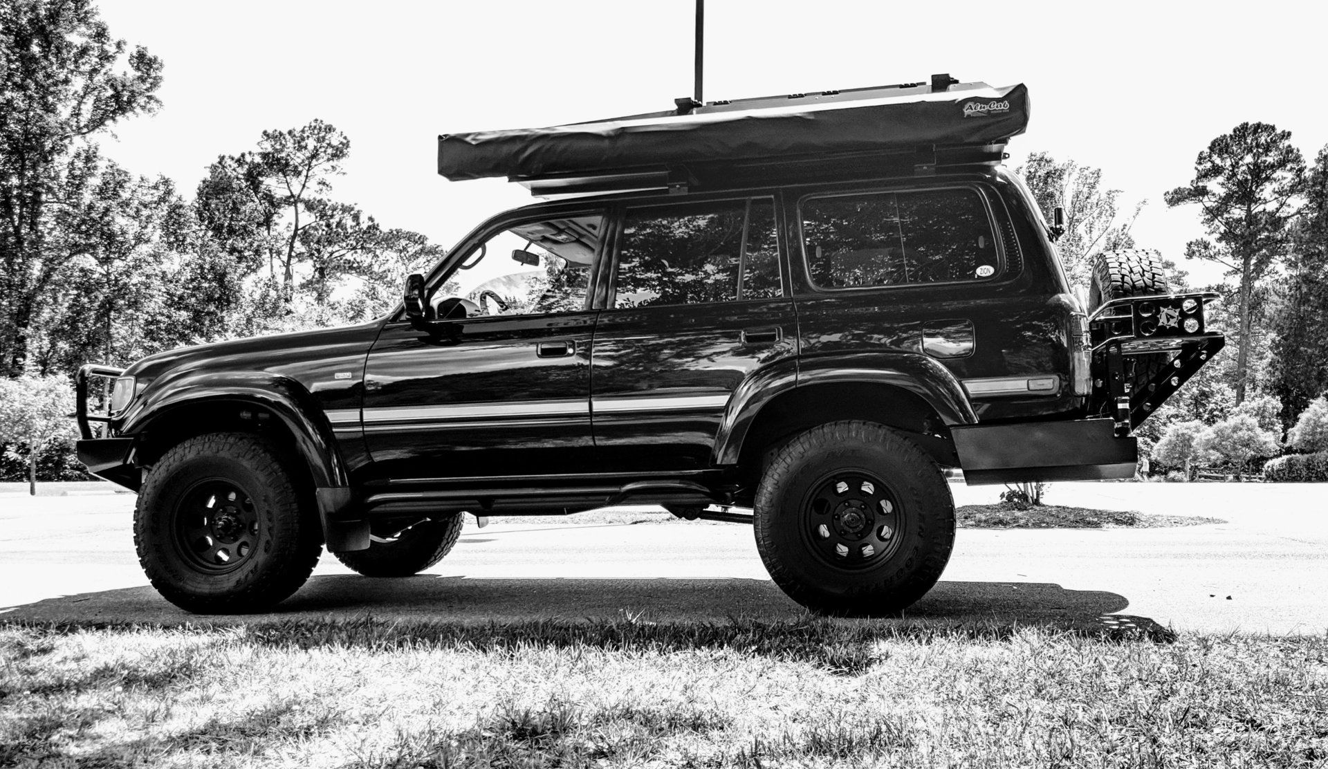

Well, Almost 2 years later I figured I should start a build thread on my truck. Seems I just never have time to sit down and document the progress. Apologies in advance as I'm sure some things will be out of sequence, but I'll try my best to stay on track of when they were completed.
I purchased the truck from a small car dealer in Georgia.. She was a one owner truck originally from New Jersey, then went to Florida until it was sold at auction. I was a bit concerned about the few years in the Northeast, but the truck had no rust. Luckily it was a typical Northeast LC and was undercoated.
Truck had 81,000 miles when I drove it home and it was in unbelievable shape. Ran like a top on the test drive, no codes and has never had a light come on since I've owned it, but as you'll come to see I tend to replace things before they give me trouble (as my avatar signature states). Thats what working in aviation will do to you.
I paid more than most "mudders" would have, but I've seen too many $5K-$8K trucks that needed $10K of work to get them up to snuff. 1997, 3X Locked, Collectors Edition, 6M1, Super Clean Interior, Everything Worked, Dry - No leaks anywhere and 81,000 Miles.
Drove back to Birmingham AC blowing, cruise control set at 75... Smooth .......
Here she is when I got her home. 6/13/2013
Circa 2015
Circa 2019
2001995
If your interested, stay tuned and I'll document the progress over the last 2-years ..... Hopefully it won't take me that long :)...
