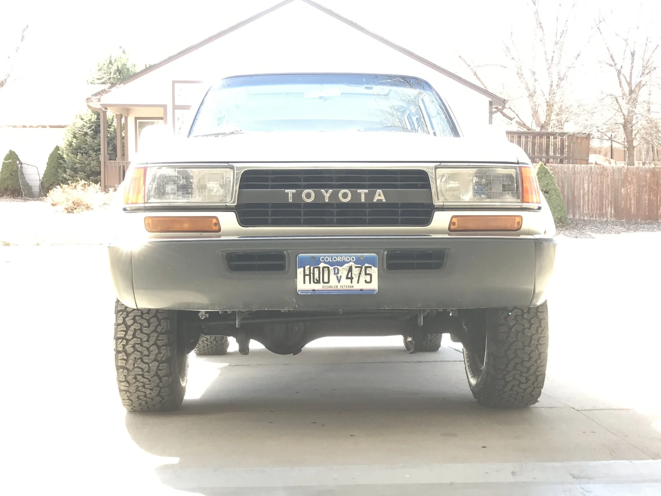

~2016 "Upgraded" to KO2 31x10.50R15LT - honestly they have been great and are lasting forever. Such a wild difference in the snow! I really regret not getting 33" though more for the looks as these have been great.

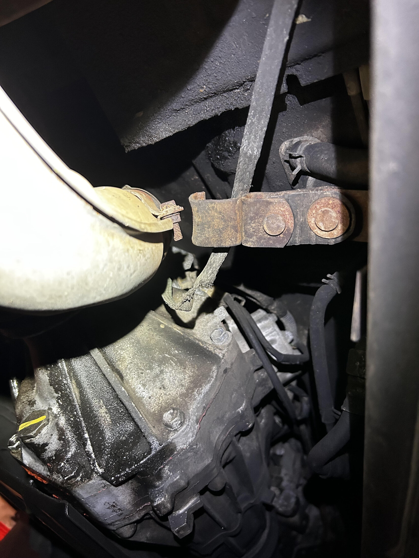

Does anyone know the part number for:
-Coolant Reservoir cap
-Tcase weaved ground that is holding on for its life
-whatever hangers/mounts/soft things I need for exhaust mounting? One is broken and its basically touching the driveshaft...

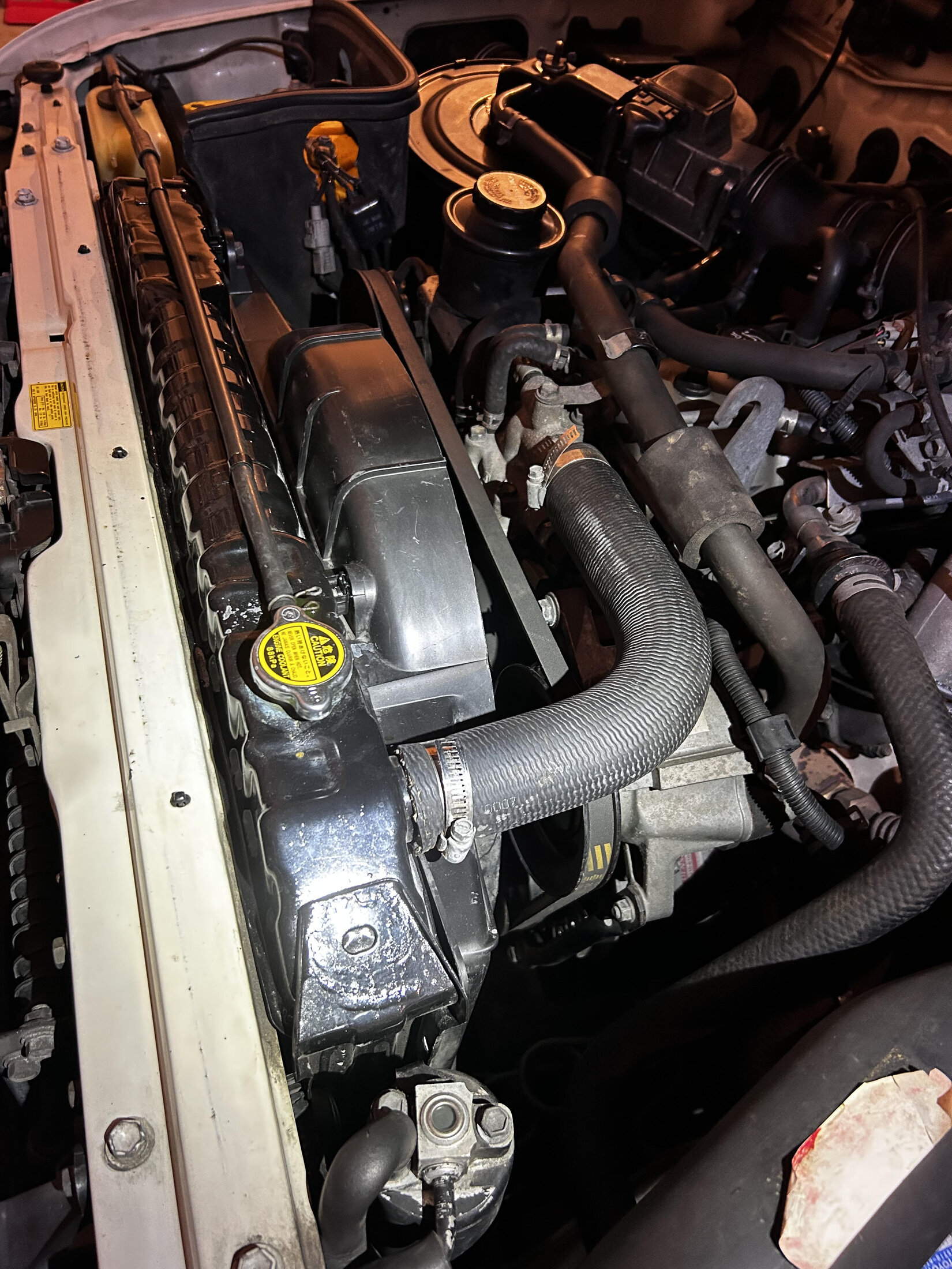

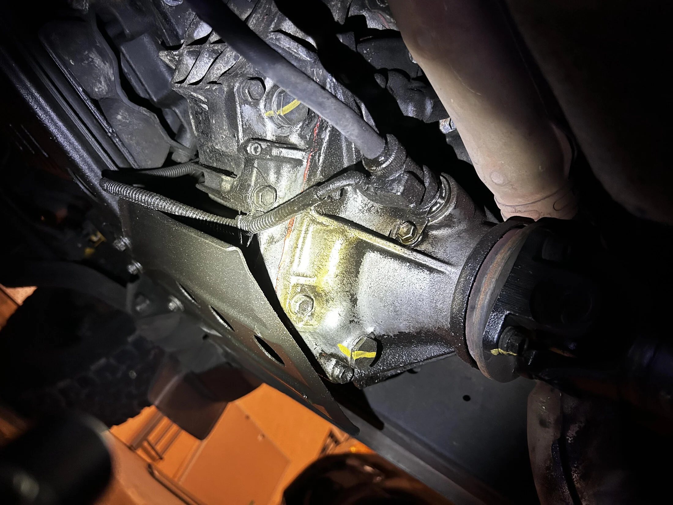

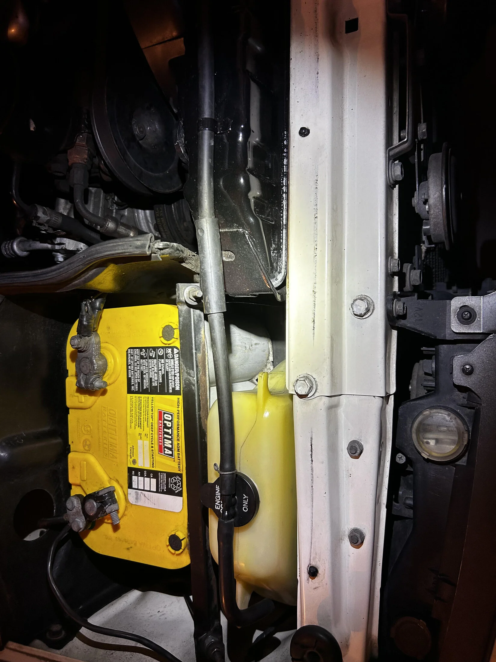

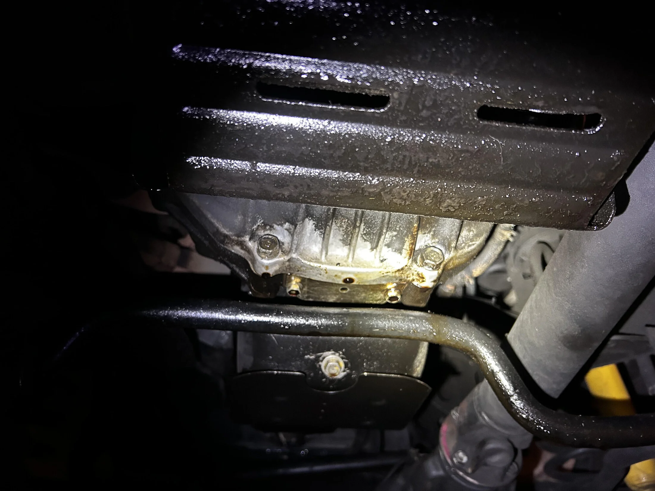

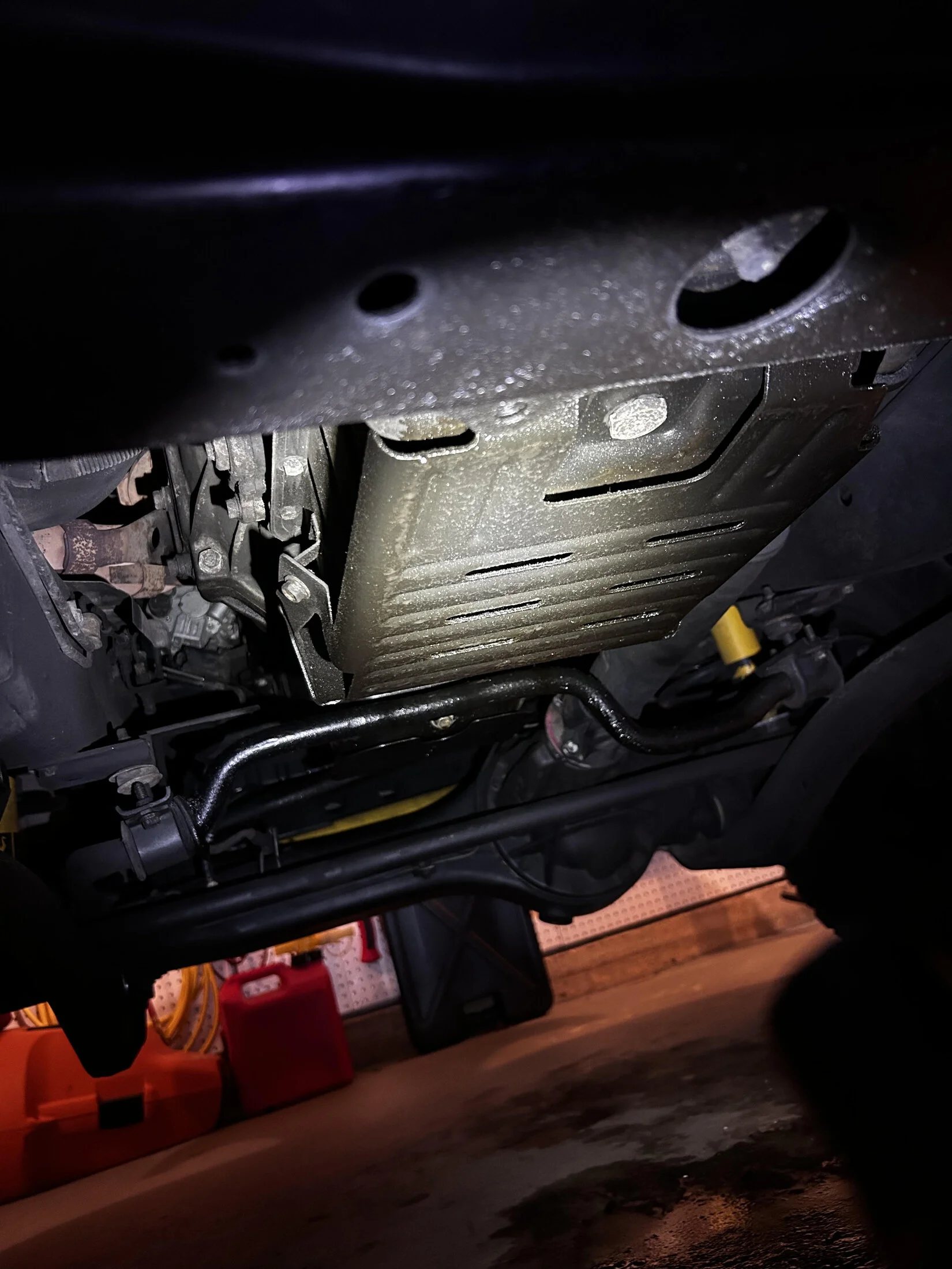

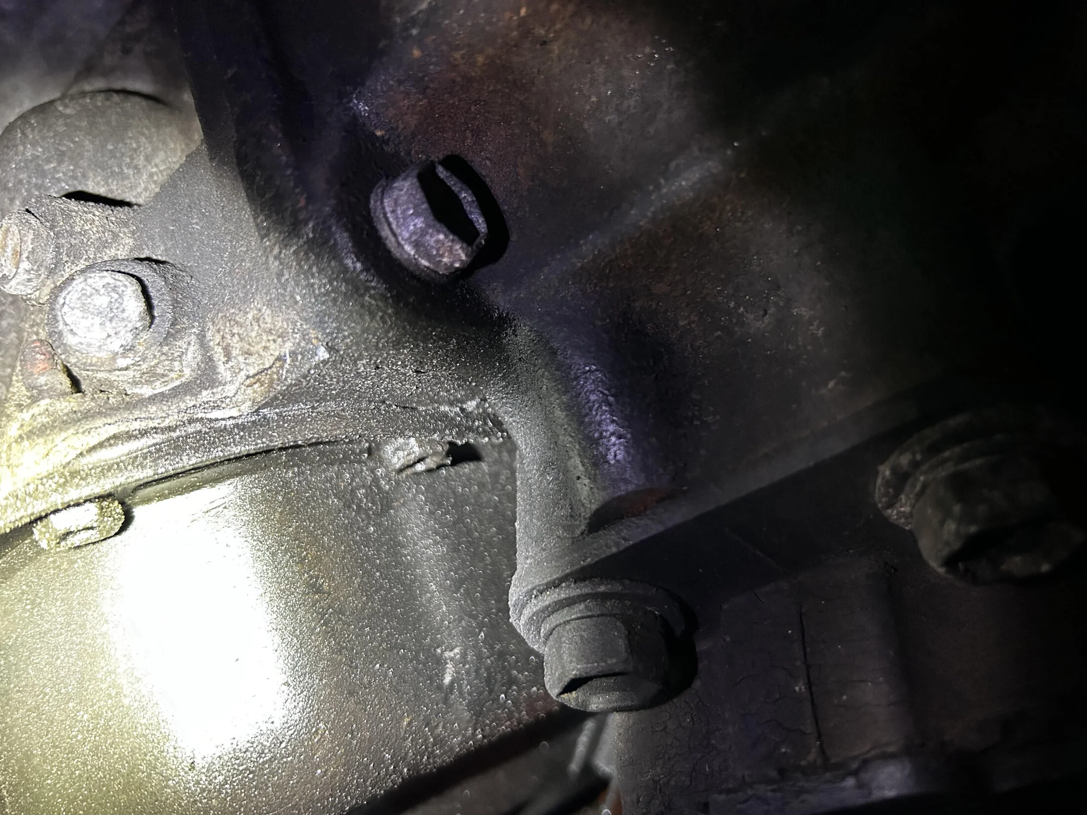

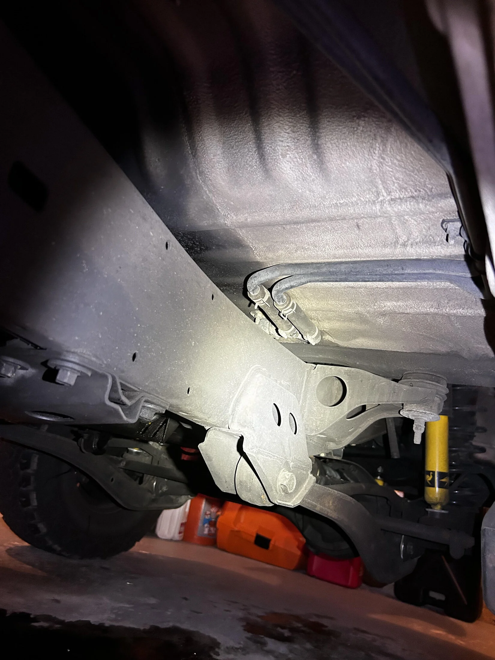

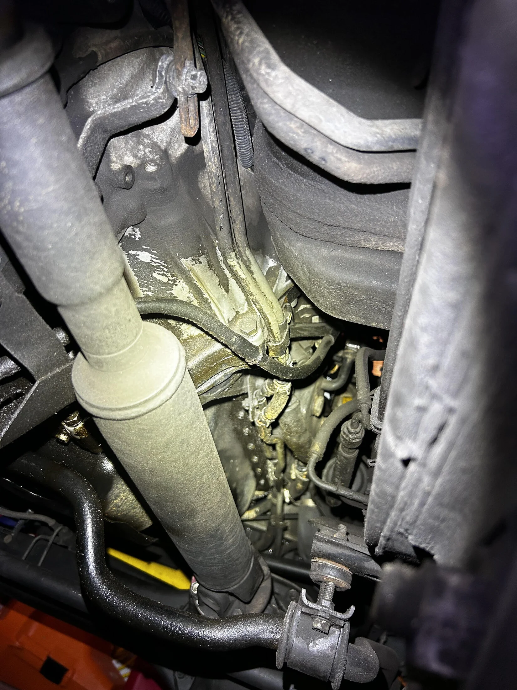

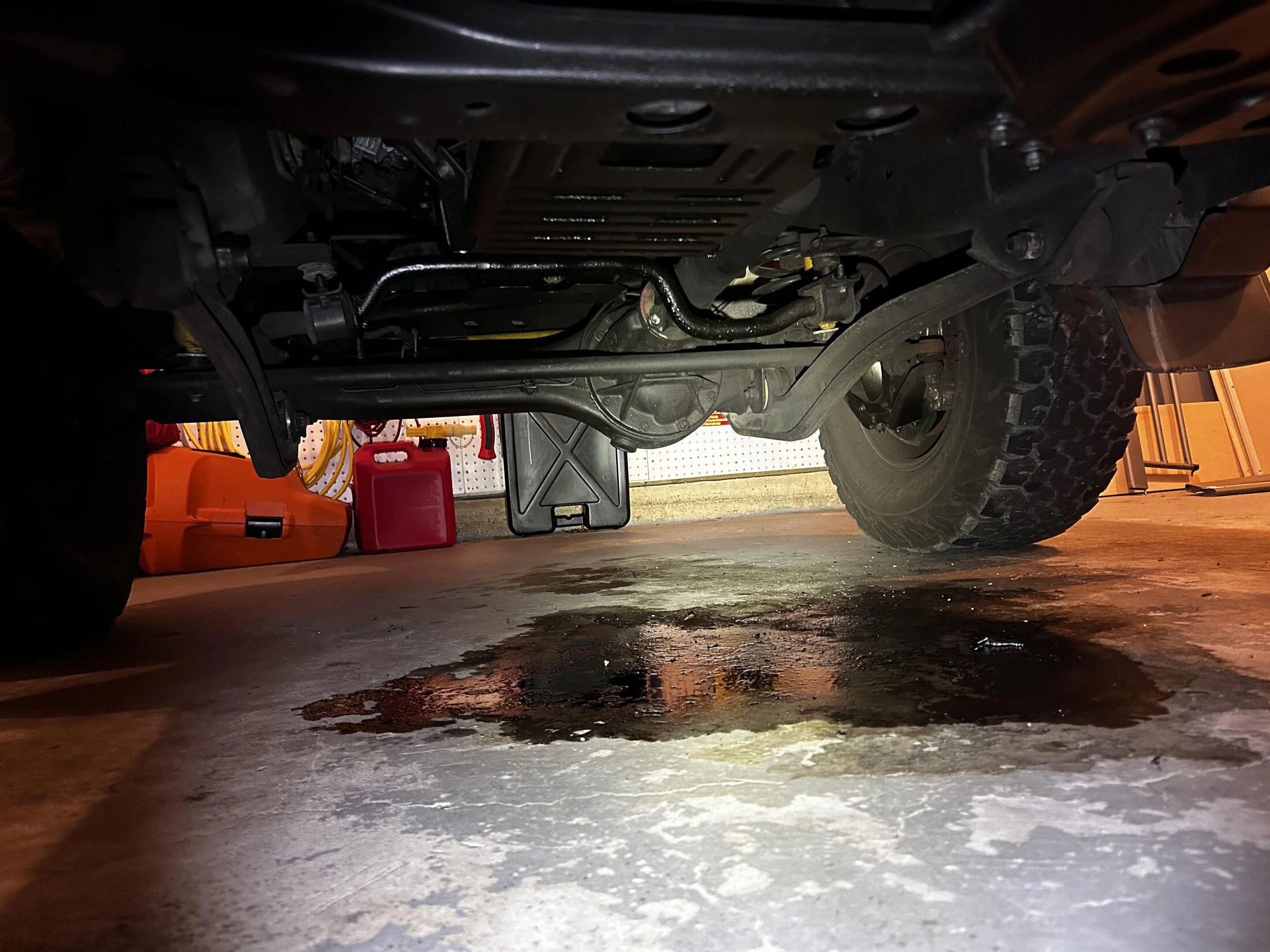

I am also trying to figure out what is happening with a leak. I think its coolant only (though honestly there is some small oil leak too I am less worried about. Burning maybe .5 quart every 2 months.
But I have added 2 gallons of coolant over the last few months. I want to pick up that reservoir cap as that is the last thing not new around that area and there is calcium build up or something in it.
Leak shots, sorry its dark:
lots of fluid on this... plate I don't know the name of. Looks like coolant.
Some drippy buildup on that bolt in the center
puddle
Looks like coolant dripping around this general area
continued
new rad, new toyota cap (small leak evident, cap was replaced after)
Note some residue. Also under reservoir only small amount of moisture.

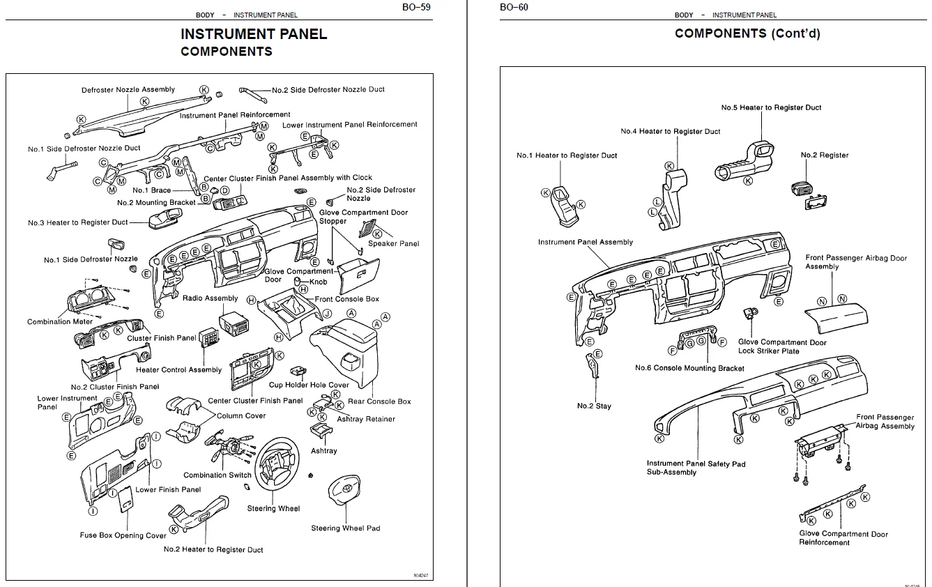

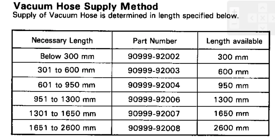

Dash screws. I am actually not sure if these are all the same. Seems like people just grab one and match it as hardware store but I was going to pick up 93568-55014 x 5
And again, may buy some of the "92003" vacuum lines but have not figured out if that is needed.

-All the vacuum lines I could find in 90999-92002. Also I noticed afterwards that maybe I was supposed to use 90999-92003*?? Anyone know the difference as the "2*" seemed to work well.
I always buy the -92004 (one yard-ish).

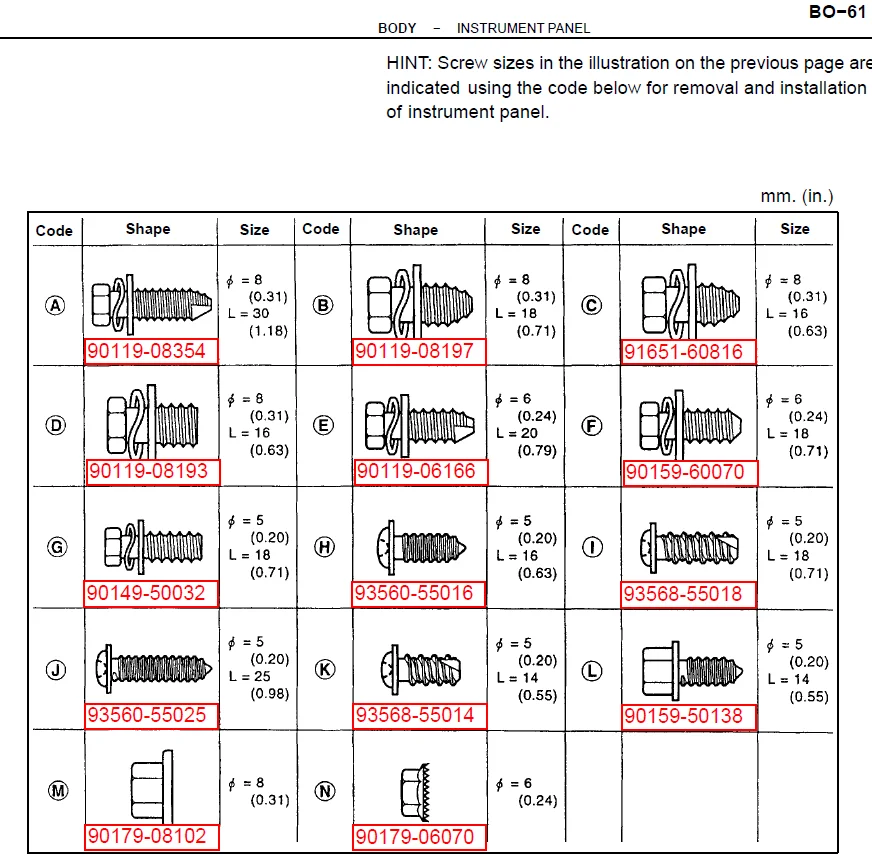

The -02006 (gren cap) bulbs are the same as the -02005, just without the green cap on them. The bulbs (actually the lamp assembly -bulb and socket; you can't remove the bulb) come with the cap on them, or you can use a sharpie.

Dash screws are a joy:
This is from the 1995 serivce manual and EPC; you'll need to check this against the 1991 service manual (It's in the Reousces section) and EPC (use PartSouq, if you don't have any other, better, tool, and you VIN).
I have a box of these; I pick them up every time I'm in a salvage yard. They are common 90's vintage Toyota interior screws; not specific to a Land Cruiser.

The best advice I have is to clean it all off very well (degreaser, car wash, etc.) and see where it starts leaking again. This is a big mess, and it is hard to guess what the root cause is.
Hey now that's premium patina and rust protection right there. Hard to tell but I actually did start this(top side). Have any recommendations on products?
Oh s***, see I just bought like 9x 92002... The parts person over here is nice but not super helpful and had no idea what I meant when I asked if they had a spool or larger amount. Good tip!!
Thanks for the dash and screw part#!

I feel like this is some hose I can do myself. Just have not found it yet. All oil/tranny fluids look clean as far as I can tell so I am not in a need situation yet.

Went to change out my belts today, and come to find that the Alternator adjustment bolt is bent. Not sure if this was me or a shop visit. Maybe I am looking at the wrong diagrams for part numbers but some seem partially incomplete. I want to just buy new adj bolt and locking bolt and the block.
-Locking Bolt: 90109-08205
-Locking Bolt Washer: 90201-08135
-Block (the two bolts meet at): 16381C ???
-Locking Bolt end part: 90445-11054
-Adjustment Bolt: 90119-08626 (But I also found a 91651-60820(3) )

Probably going to take this in to a friends shop, my brackets for my exhaust are old and one broke, so need to get it to stop being millimeters away from the drive shaft. And still looking for the coolant leak.
Currently, really debating refinishing the wheels and continuing to limit my tire options or getting something else. I was kind of shocked how nice the sequoia 5 spokes for like 2003 looked on the 80. I am also always a fan of a traditional steel off road wheels. Open to what you have found success on as it always gives me a headache figuring out what is actually going to fit. I am not interested in spacers.
Additionally, picked up a bunch of random parts thanks to all of you. Soon my dash will be secure!
Note for others looking to replace the step plate clip 90467-04017-E1 this is the brown one (oak). Additionally I found this on mud with a file, though the link is not working now 3D Print for Rear Step Plate Clip - https://forum.ih8mud.com/threads/3d-print-for-rear-step-plate-clip.1349251/. Luckily I already downloaded it.
