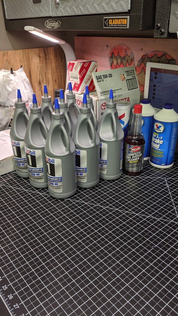

Was time to change out fluids in the truck so we did Front and Rear Differentials, Transfer Case, Drain and Fill transmission, Brake Fluid, Fuel Injector Cleaner and Power Steering Fluid along with an oil change, tire rotation and prop shaft service for good measure.

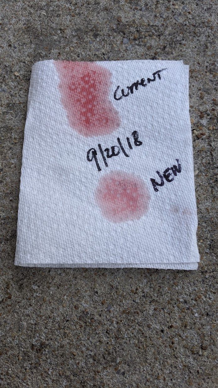

I sue Mobil DTE 24 Light Hydraulic oil for the power steering.
The darker fluid is after a years use compared to new fuuid.
After the flush it looks good....
