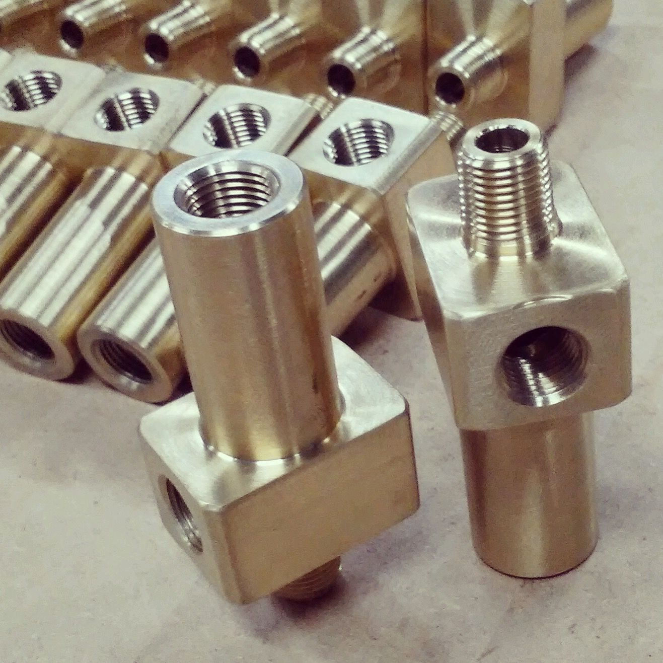

The Wits’ End umm... #FourWayPeacePipe For the #1FZ #Turbo and a big batch of them are done. These will get black zinc plated and then of course...laser etched
Wouldn't it be better for the mark of shame to be on the top of the 'T' (wrong term I know) so you know you've screwed it on the correct way? Or can you install the original sensor before you attach the 'T'?

The mark is more for me. I'm going to be laser etching this thing to make sure folks don't muck it up :P

Been going thru production hell on several other non-turbo parts so I haven't given this thread much love lately. BUT in the chaos I did manage to complete one part. The Peace Pipe is now done. I will be ordering up a slew of pressure switches from Toyota and the sender for the oil temp gauge I've decided I am NOT going to include but will instead include a 1/8" NPT plug only because any temp gauge you folks decide on will already include a 1/8" NPT gauge so zero point wasting money on another one.
These are all black zinc plated because brass will start to look like ass in no time. And of course...laser etched :flipoff2:
