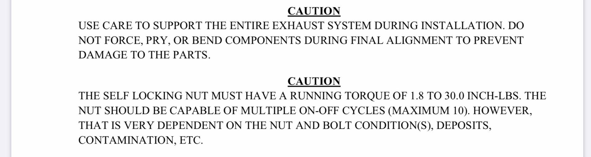

Anyone know the torque spec on the turbo/downpipe Vband? Curious if i cranked it too tight. Didn't think about it til this morning.
If you want to learn all about v-clamps:
