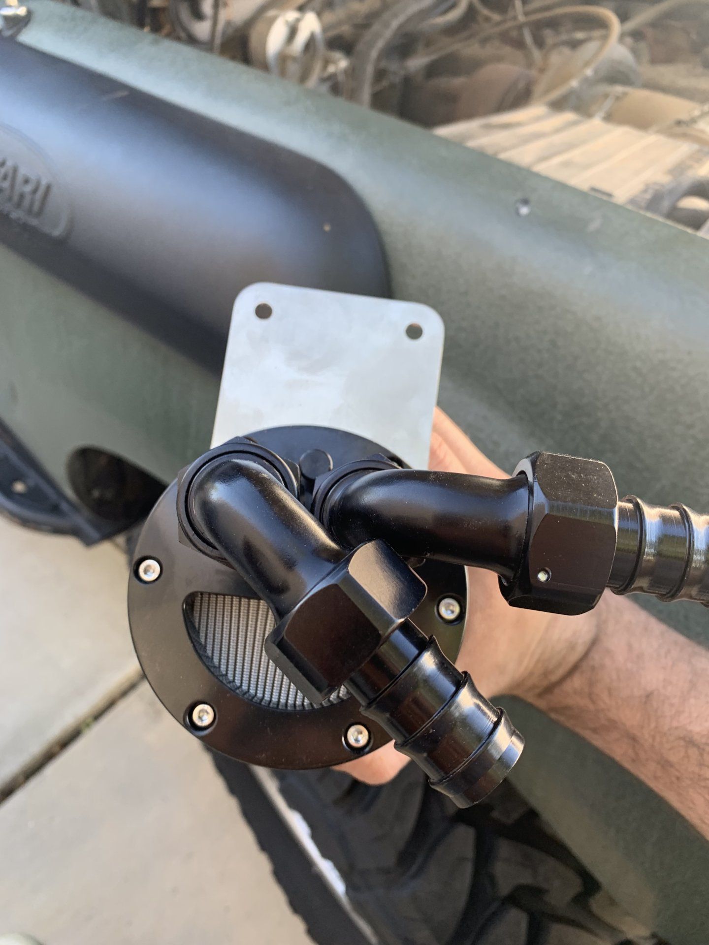

can you post an installed pic for figment?
howdoes it disassemble for cleaning? Do you have to fully remove to get it apart?
Is there a sight window or indicator of fullness? Or do you just have to guess?
If I can find a pic ill post one up. I put it ins the rear passenger corner so that I could drain it without having to remote it. The lid had an o-ring'd dip stick built in. The lid can be unbolted and clocked any direction and all parts can be pulled apart and cleaned.

Can you show a closeup pic of how you mounted your catch can? Did you end up going with a vibrant or some other model?
The color looks just fine.
Yep wasn't worried about it. I like watching the steel change color over temp ranges.
Ended up just using the one I had on the shelf. Cheapo Amazon one with fine steel wool inside to catch vapor. I'll snap some photos in a bit. Only running from pcv to intake. Didn't route the other hose through it. Still debating that.
I meant the mounting bracket...looks like you bolted it to the side of the intake.
Oh yeah, my bad. Read that too quick. I just slotted the included mounting bracket and have it on the manifold ground bolt. I'll get some pics this evening.
I'll be waiting for pictures. I just got my oil catch can and been looking at ideas for where I want to put it. I like where yours is at.

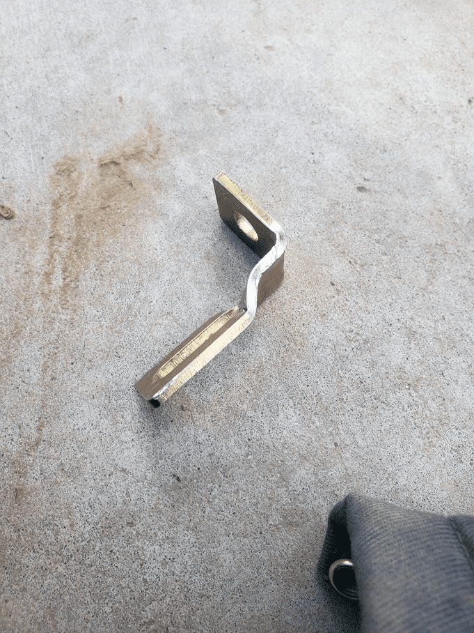

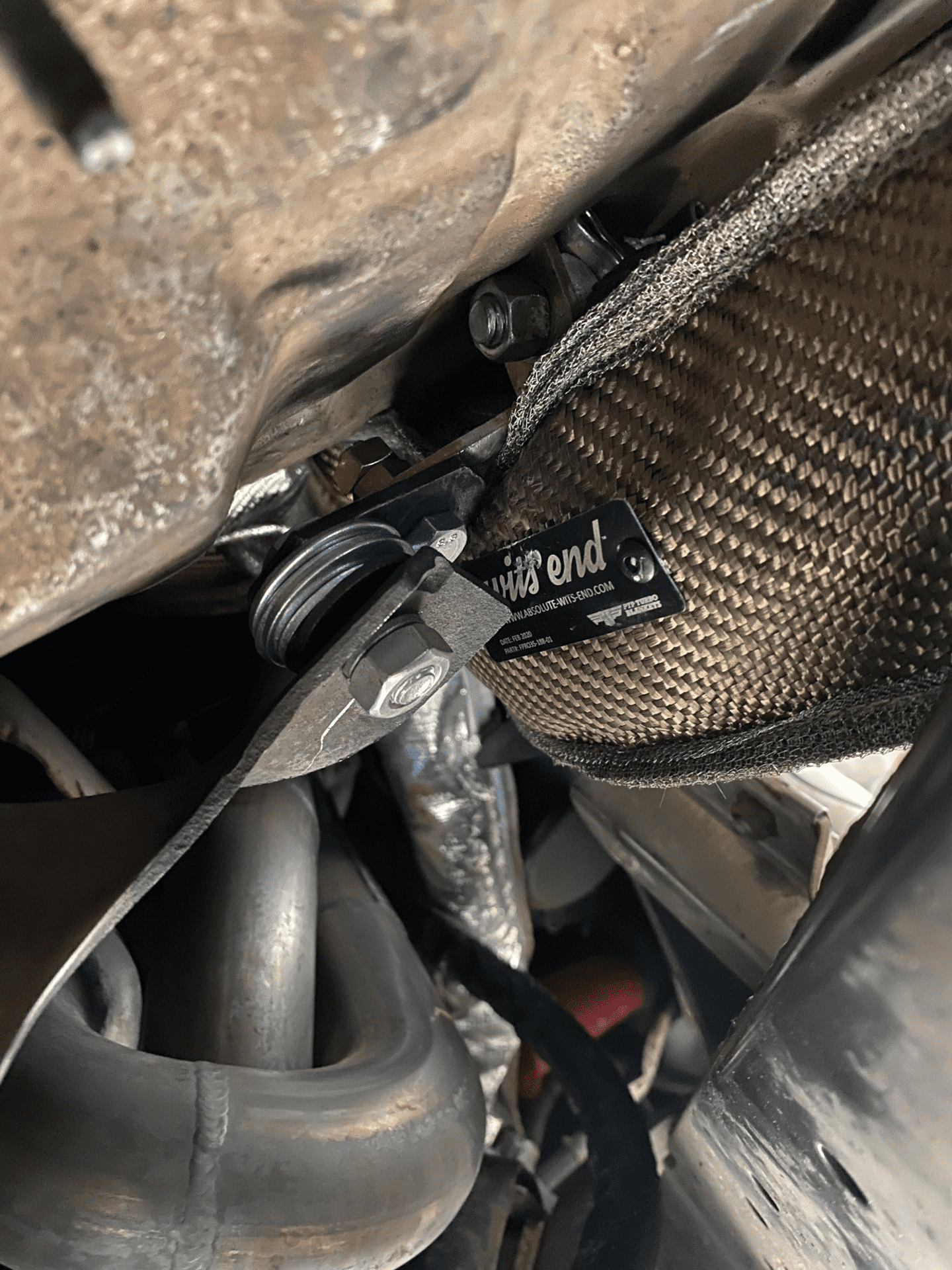

Can i see a pic of the area where the bellhousing connects to the downpipe band clamp deal? I messed up and didn't install that band before the DP blanket. Everything is in the engine bay so I'm thinking i'll have to remove that DP, undo the blanket and install the band clamp. :bang:
edit: made contact with @Wompom, got pics and yeah, that DP is coming back out and then in and then out and .......:bang: Looks like the bracket needs to be bent 90deg in order to connect to the bellhousing oem bracket.
Hopefully these pics will help others. I stole some pics from @spyduh's turbo build thread as well.
Here's how my bracket ended up being. The slotted part is attached to the bellhousing bracket and it allowed for easy adjustments (left/right).
