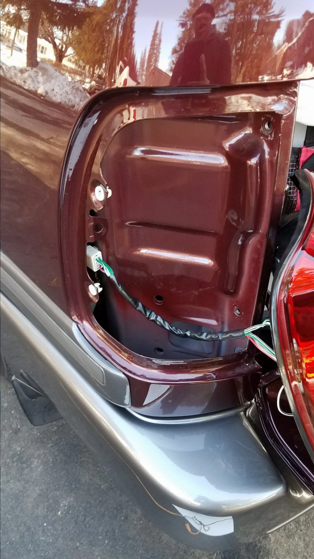

In these instances I'll usually pull the headlights and tail lights to get a coat of wax into the cavities behind them, plus, it lets me inspect the interior of the body panels for any water ingress or other damage. The rear quarter panel on my friend's truck had started rotting from the inside out and he would've never found it if we didn't pull his tail lights.
