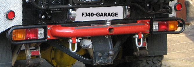

I did a 2 inch lift when i had my 40 done in 1989.
I welded 2x2 steel on the body shell and did go trough them with the bolts when i did put the body back on the frame.
The body rear area was filled with a u shaped, bumper like, steel and covered with diamondplate, on the side below the doors is a 10x2 steel welded to the body and covered with diamondplate, the steps are welded to that 10x2 and do a good job as rocksliders
The FJ40 can be liftet with a Hi Lift or Forklift anywhere now.:banana:
If you compare with a non lifted 40 you will realize that my number plate fits between frame and body.
Below the doors its hard to tell that this area is a bit lower than usual.
Usually i would have just cut that back to the minimum but........we need a TÜV approval here in Germany and i had to keep it street legal.:hillbilly:
From my point of view its very hard to tell that it has a 2" body lift but i might be still blinded by my own work.:D:cool:
