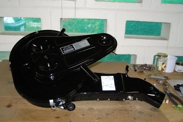

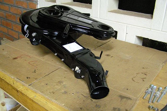

All the threads that got painted will be cleaned out - like this... That AC housing is looking pretty nice. The replacement labels from Shane and others are a great finishing touch!
New gaskets inside the AC housing and stainless hardware are a nice touch, too.

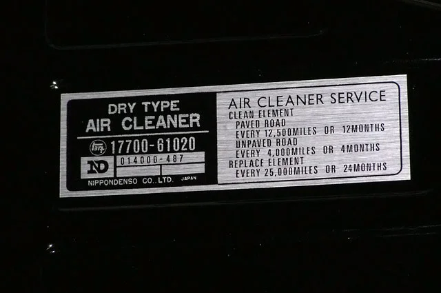

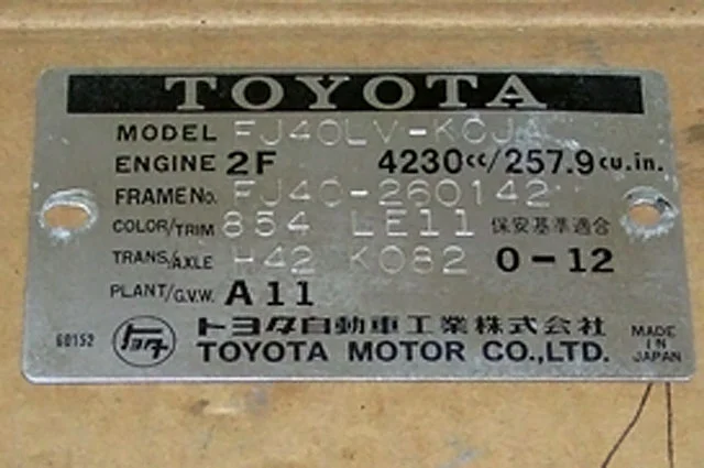

Also found the nomenclature plates I removed moths ago and cleaned 30 years of yutz off of them - they actually look pretty good :D

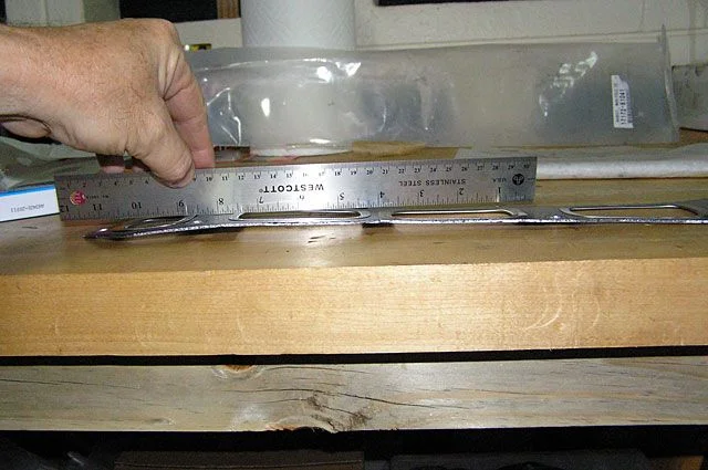

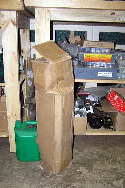

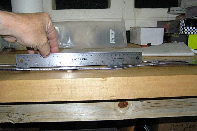

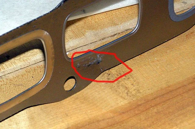

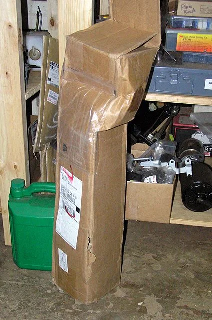

And then there are the little things that make us unhappy. Here's some of the shipping damage from yesterday's mail delivery:

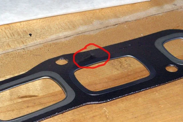

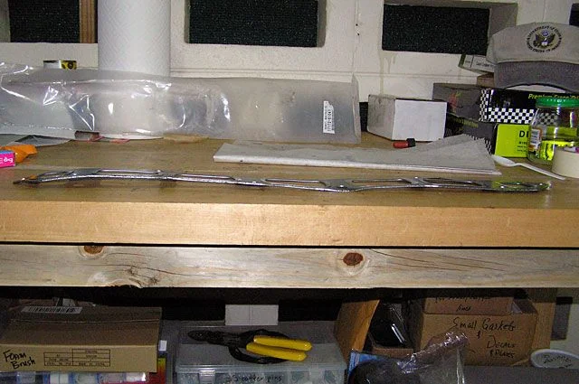

I reckon this OEM exhaust gasket is not gonna be usable. :frown: I'll have to check with the local dealer to see what might be available. Or I might be able to source one out of S Africa. If not, then I'll have to try again from the States.

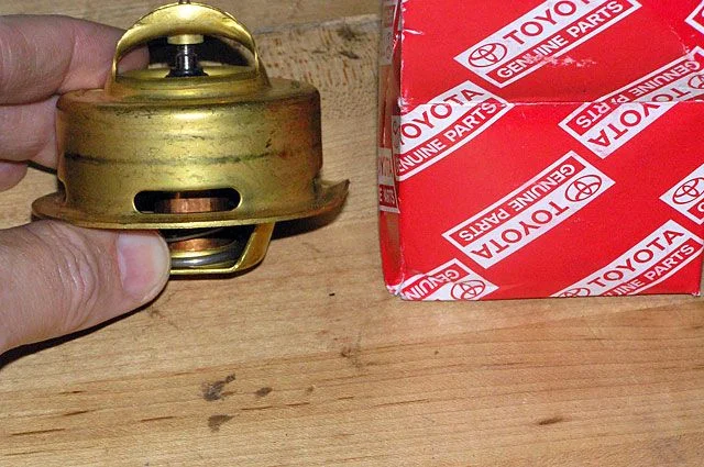

I'm not sure about this new thermostat. Any ideas? Will if work OK if I can flatten the bent lip?

Good thing you held that ruler up to it, kinda hard to tell anything is wrong. What is that, a few thousandths off? :D
I just couldn't believe that thing was that ummm.... warped. Without heat :D
